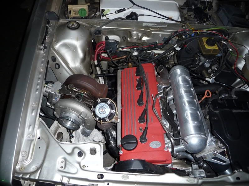

yeah i thought the same thing about that rear bar... seems like it should go the opposite way.
Re: Ed's 1991 CQ
It's just a pain to mess with
I'd think that it would be more effective near the top of the tower; maybe not.
I'm still tempted to sell the pair and make some after the turbo stuff is 'done'.
I'd think that it would be more effective near the top of the tower; maybe not. I'm still tempted to sell the pair and make some after the turbo stuff is 'done'.

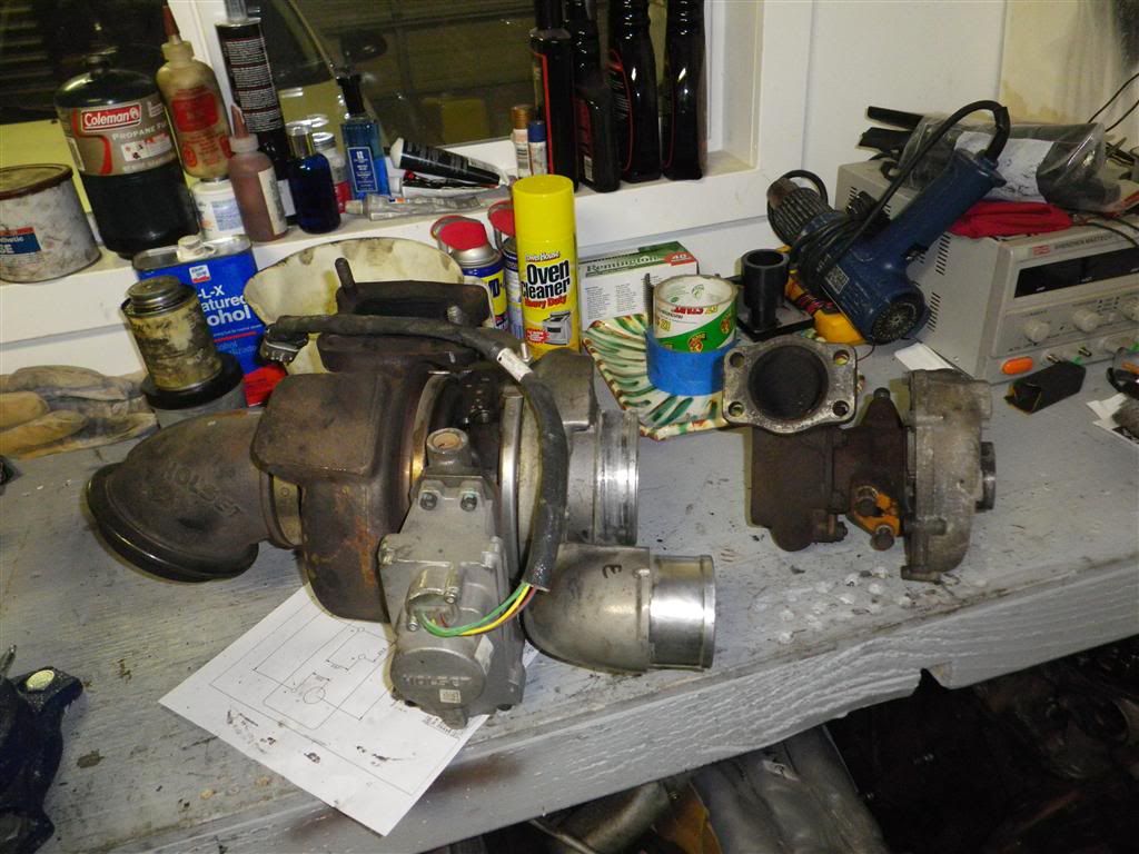

Fiddlesticks! Goldfarb thought I wanted an HE351VE not the 341. They do not have a 341.
Now the question is do I suck it up and go really big (make an adaptor for the 351's non standard flange) or KISS and try an internally WG'd Holset?
:frustrated:
:frustrated:
Re: Ed's 1991 CQ
I'm using the he351ve, but it's...um...big....especially that variable hotside. I'm planning on running an flange adaptor to space and angle the turbo where I want it, and would also like to port the wastegate from the adapter. I have a 034 T3 log manifold to mount it to.
Here it is next to the K26:
I'm just now starting to mock up the pieces, so not sure how it will all go together yet.
Hard to say what to do, as it is hard to justify having to redo stuff. You can probably find a 341 from elsewhere for a reasonable price.

The thing with the HE341VE is that, afaik, it was only on 2006 Fords with the Cummins ISB.
Putting the WG into the adaptor is a consideration I also had.
The 341 is not much smaller but enough to make things a bit easier.
Re: Ed's 1991 CQ
Wow! That IS a big turbo! 8-O
Re: Ed's 1991 CQ
cbrydon wrote:I'm using the he351ve, but it's...um...big....especially that variable hotside. I'm planning on running an flange adaptor to space and angle the turbo where I want it, and would also like to port the wastegate from the adapter. I have a 034 T3 log manifold to mount it to.
Chris, Where are you going to put the engine? You know there is only so much room in the engine bay and I'm not sure by the looks of the size of that turbo that you are even going to get the hood closed with just the turbo, let alone the engine. :wink:

I was wondering if you'd need a cherry picker to hoist that turbo on to the manifold lol

LOL, rear mounted Holset!
Anyway...
Holset HE351Ve
Compressor
Exducer: 86mm
Inducer: 60mm
14 blades
Turbine
Inducer: 70mm
Exducer: 60mm
12 blades.
Total weight 47lbs
Holset HE341Ve
Compressor
Exducer: 76.5mm
Inducer: 53mm
14 blades
48 trim
Turbine
Inducer: 69mm
Exducer: 59.4mm
11 blades
Total weight 39lbs

There is a core HE341VE on Ebay but I think I'd spend a mint to rebuild it. Thinking I'll either go HE341cw (fixed geometry IWG) or suck it up and go HE351VE. The risk with the latter is not getting it installed for B.B.Q. and not having a good solution to, what I believe is, the problem of keeping the WG closed when the rack is contracted and backpressure is increased.
