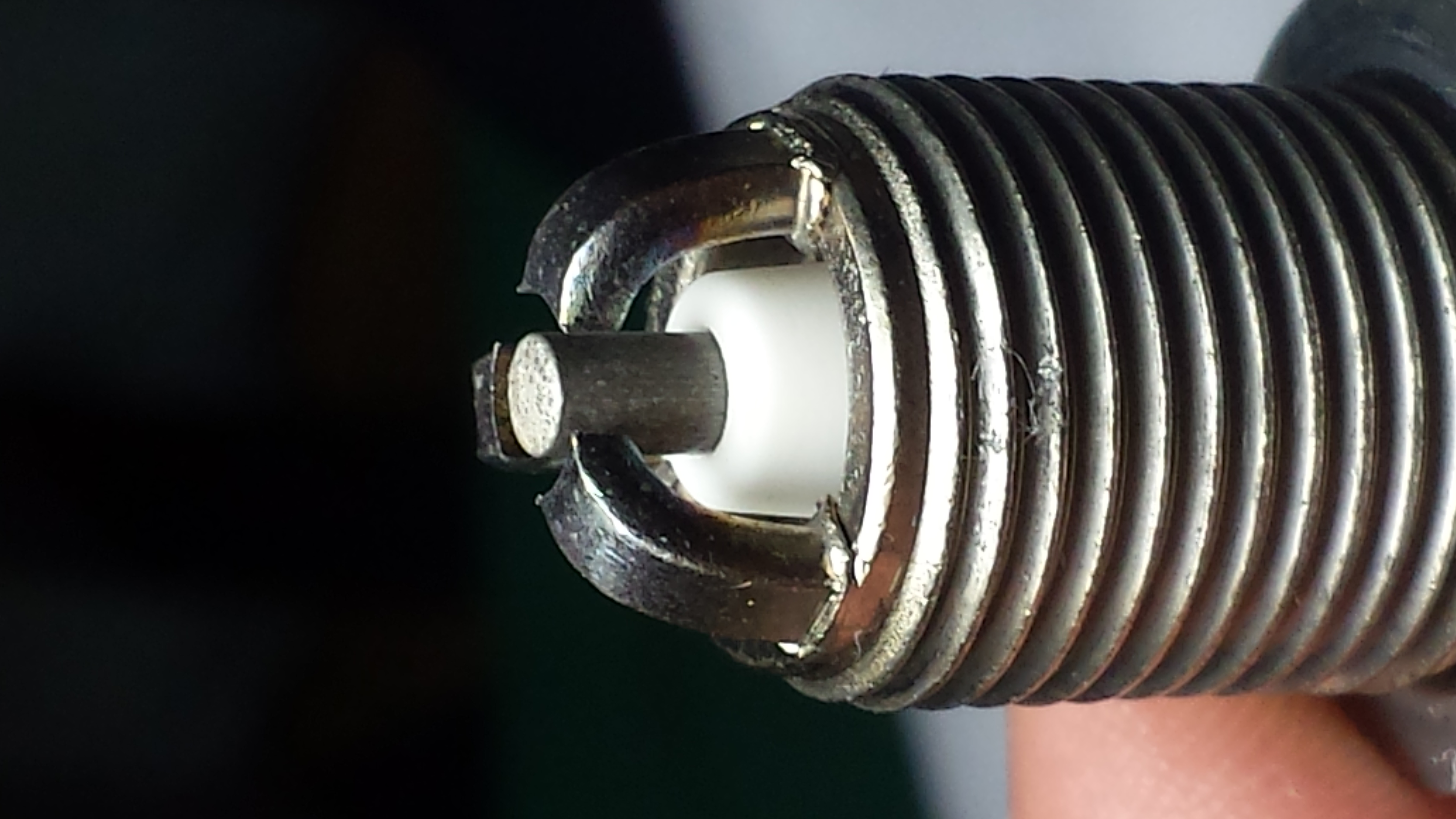

It doesn't matter how much you clean your plugs. You have to have new ones because you're trying to read the ground strap as it becomes heat treated by the spark. You're also looking for specs on the plug. Cleaning might help that lol.

Ok I ordered 2 more sets of FR5DTC tri-strap plugs (for Porches incidentally) and then I can move forward with this testing. I'd never Co sidereal the heat treatment facet. Must be to do with the heat range, where you want the bluing effect to reach no more than half way down the ground straps IIRC. Interesting stuff fo sure.

Yes, that's the idea. You want the heat mark at the bend. Amplify that signal a bit if you can and you should hear the knock sensor better.

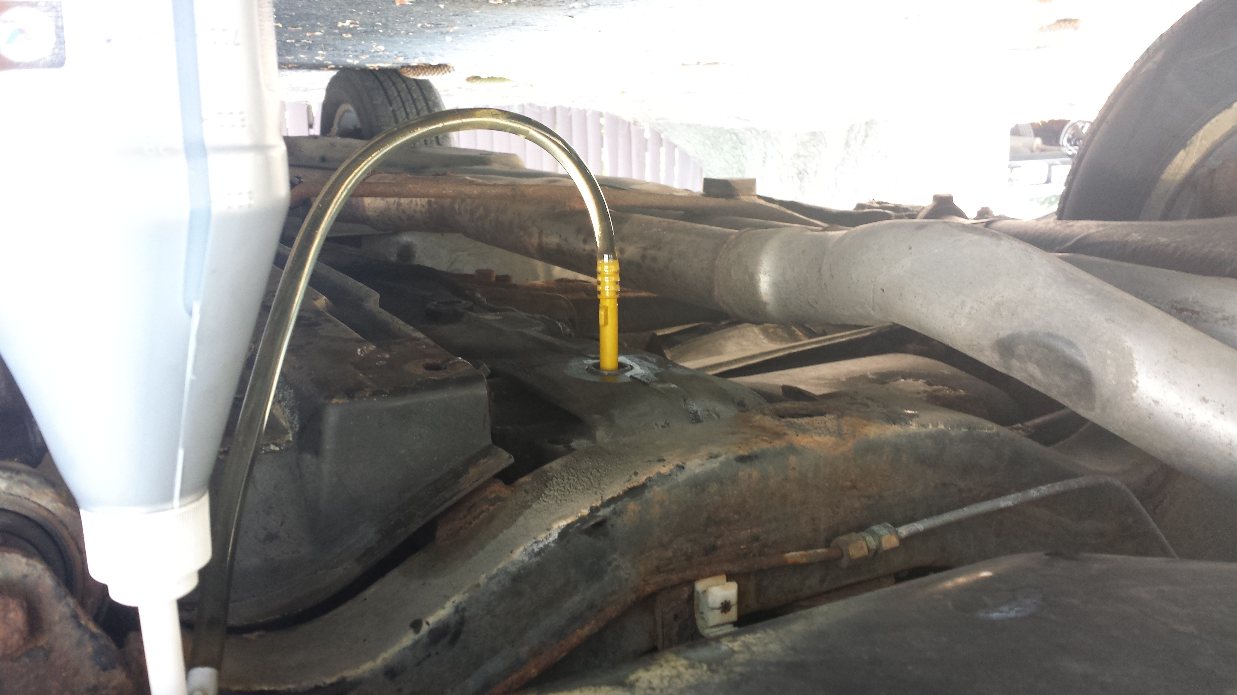

If you're all embarrassed of my methods, please comment lol
AaanannnD it's upside down haha
Filling the rear diff from the drain?
Good eye Dave. That's the pump I got when I did the 5k's. I love finding tools from the past. It's only $10 for the pump but still, savings.

How did you fill it from the drain without it all leaking back out?
Drilled/tapped for my Walmart outboard motor oil pump. It has a threaded Yamaha motor fitting which I plugged with an identically threaded hex head bolt. Works like a charm. I put an oil resistant oring on the bolt and then cover in ultra black sealant to prevent tampering or leaks.

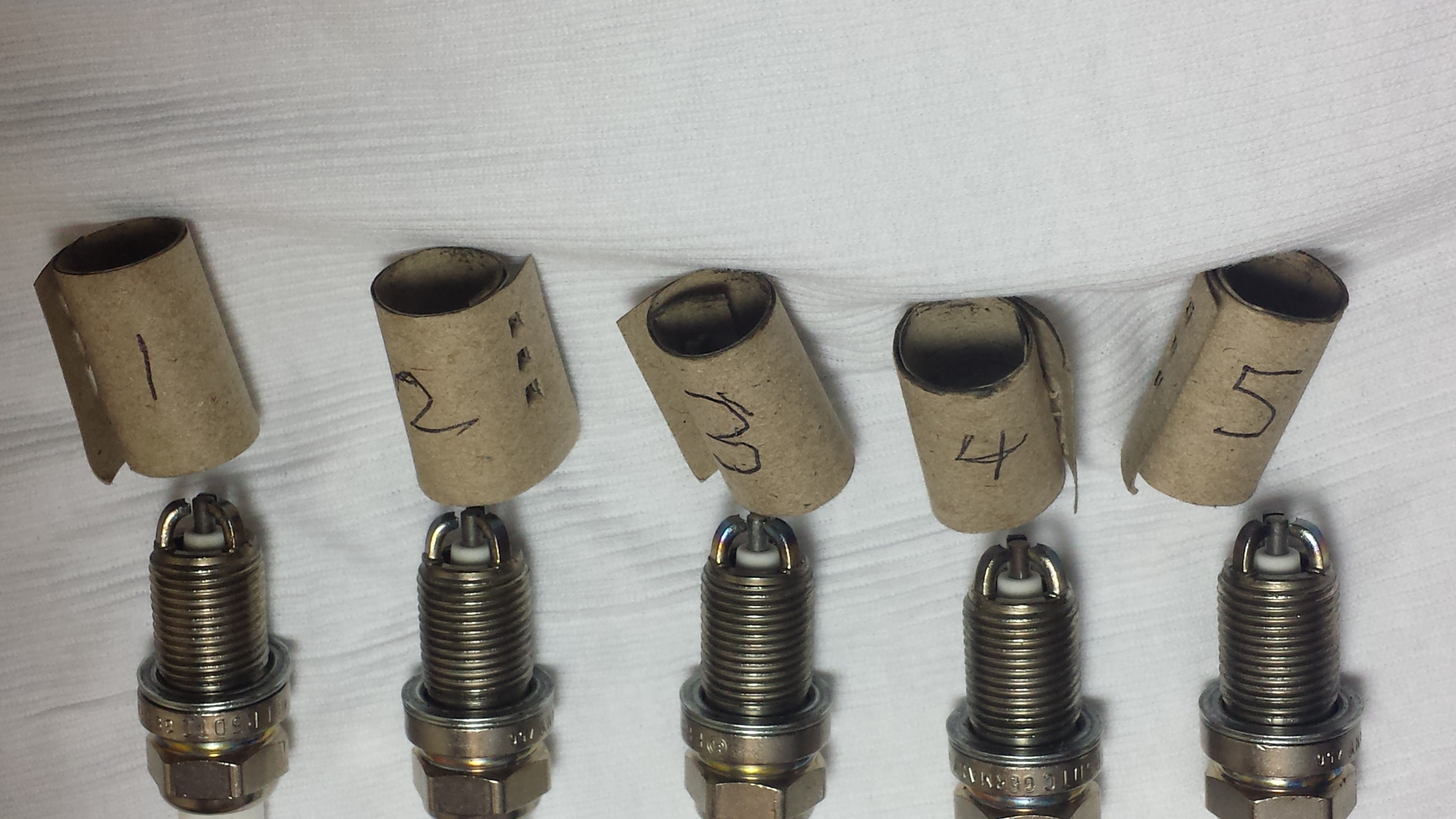

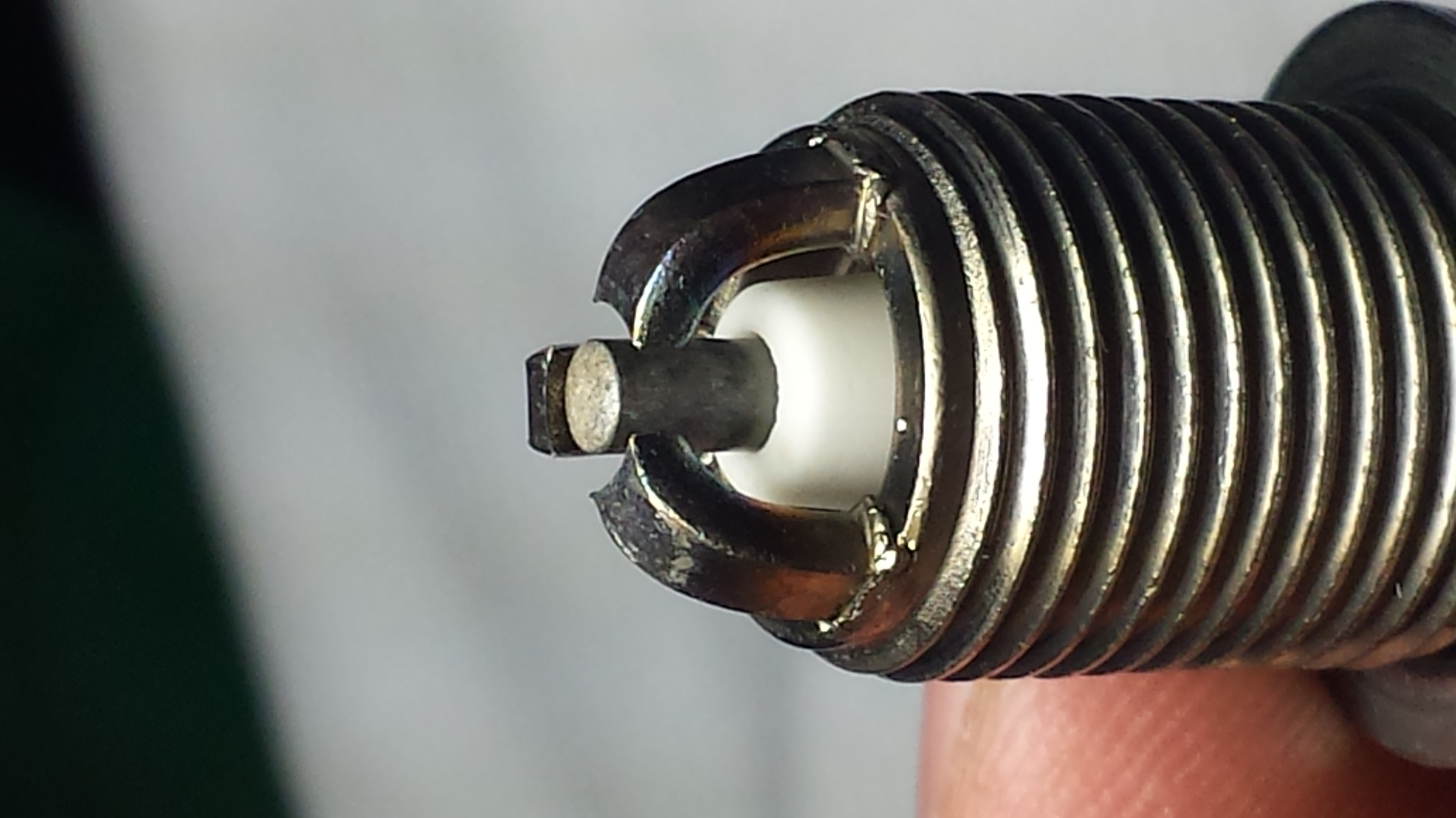

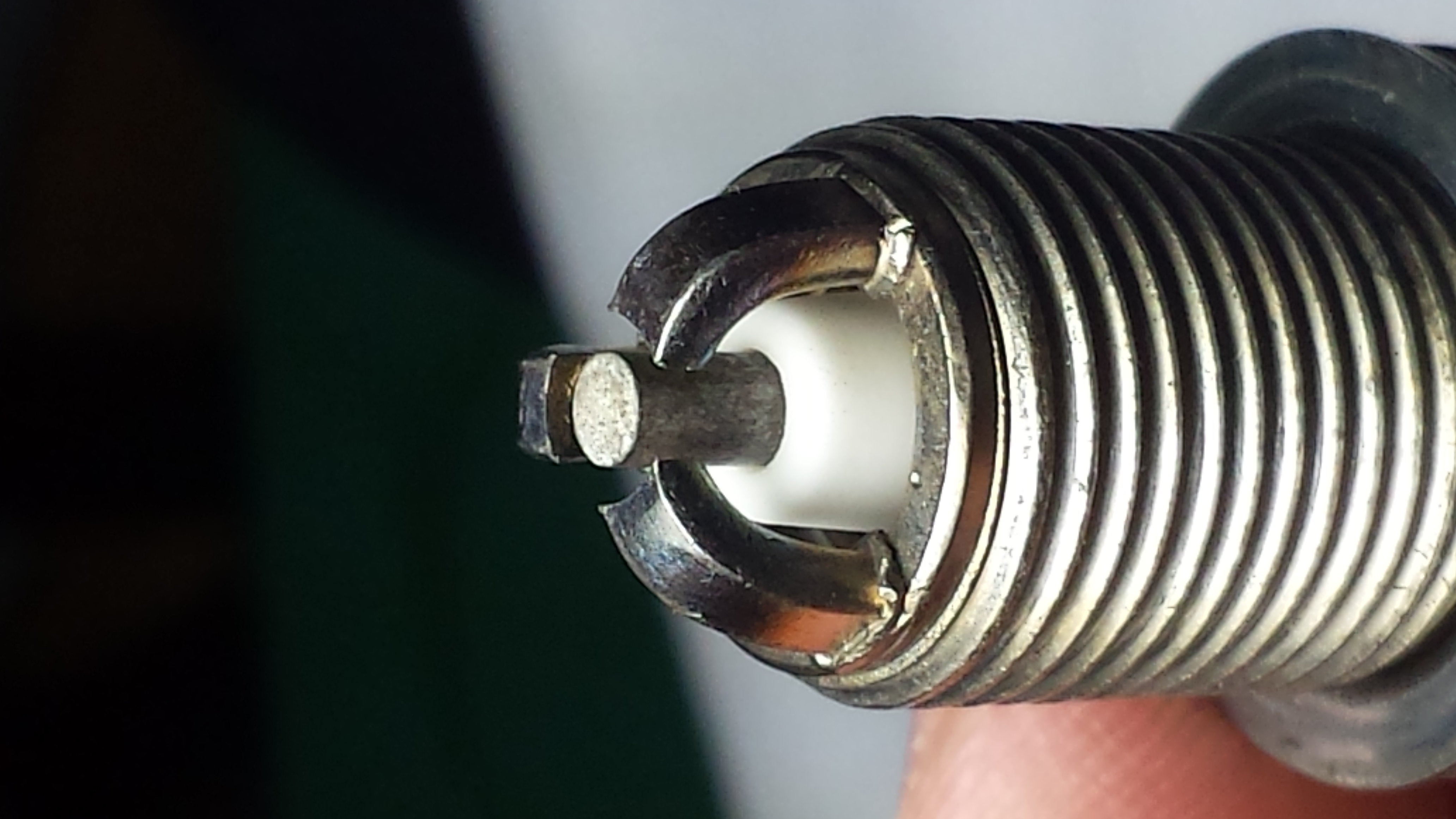

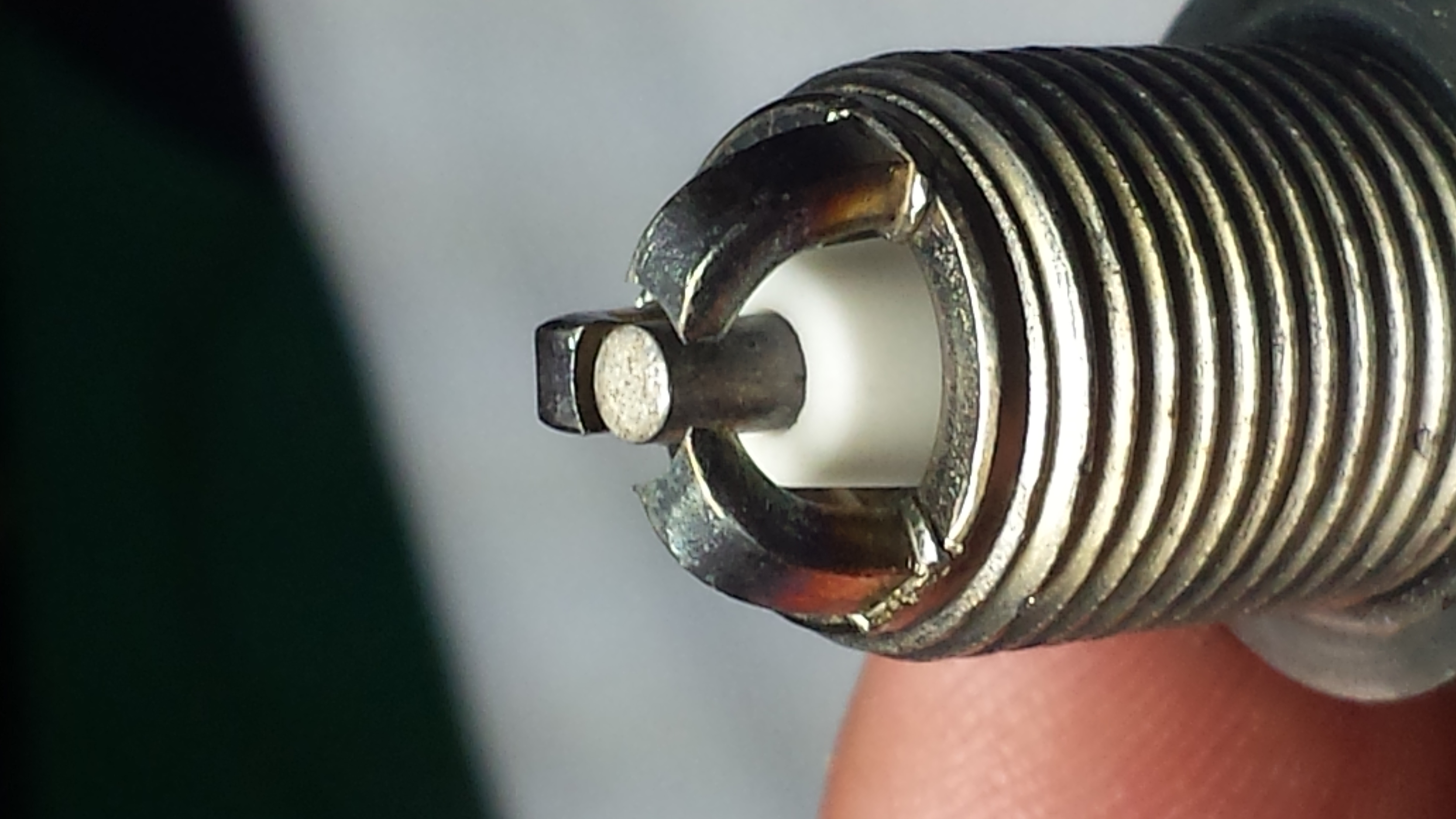

My Internet is down today on the laptop and I don't think I want to take pics using my phone. I did the 3rd gear pull with new plugs, drove a mile and then stopped to switch them out. Of course I warmed the car up before putting them in. Ran beautifully in my opinion. I've never done the brief run and check before so I don't know if the ceramic is supposed to still be white like my chops. These FR5DTC plugs obviously have 3 straps and 2 of them have the heat treating marks half way down and the 3rd (possibly from physical placement) has the mark on the tip of it closest to the electrode. My quick look at all 5 makes me think all 5 were like that. Nothing out of the ordinary except for my MAP being unstable. Alot of variation between 4800 and 6400 RPM. Nit sure where to go concerning my PID. I will put up shots tomorrow as well as a log for the 10 seconds in question.
Here's the plugs and a nice family photo in the next post. Kind of funny how only 5 photos are allowed per post. 1 per cylinder
So yes there's 3 ground straps. 2 are the same reading of in the center for the heat range but the 3rd has the heat marks at the tip by the electrode. My guess is its from its position in the cylinder in reference to the meth injection mist and somewhere in all this action is some correlation lol. Opinions welcomed.

- 5
- 20150819_185111.jpg (1.33 MiB) Viewed 28191 times
- 4
- 20150819_185040.jpg (1.33 MiB) Viewed 28191 times
- 3
- 20150819_185005.jpg (1.3 MiB) Viewed 28191 times
- 2
- 20150819_184943.jpg (1.35 MiB) Viewed 28191 times
- 1
- 20150819_184924.jpg (1.31 MiB) Viewed 28191 times
