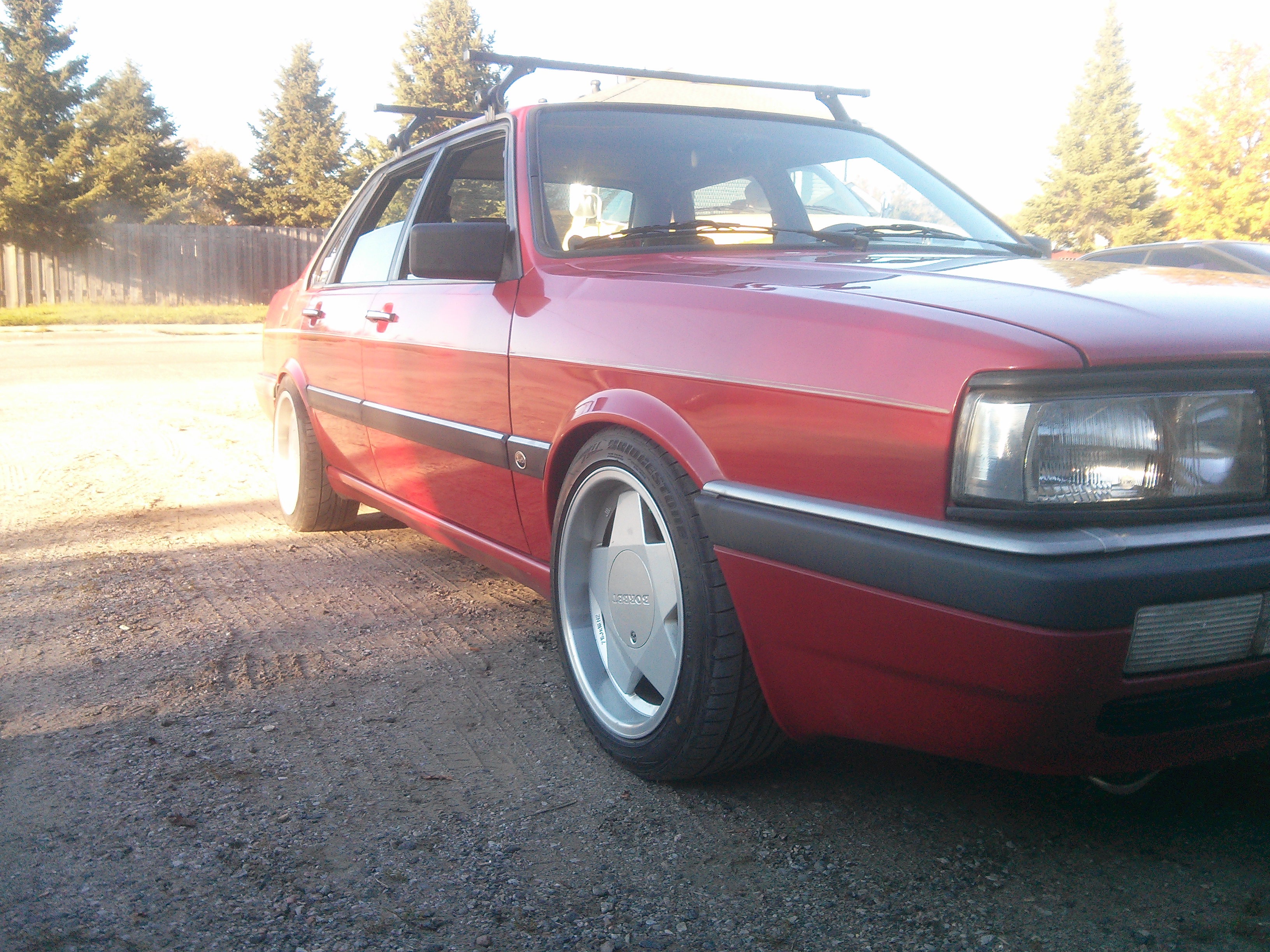

Rolled the fenders today with Andrew (okay, andrew did the rolling, I did the grunt work). no rub! even over big bumps

Looks fantastic man!
Re: Matt's 87 4ktq -
Definitely looks very nice!

absolutely love the car dude the type A's couldn't look better on your car - hopefully you resist the urge to keep turning things up

What a nice car... but DAMN do I hate those wheels...lol

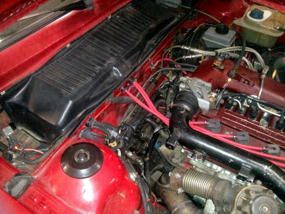

So I put my ignition under the rain tray. Really cleans it up back there and gets the coils away from the heat. I know it didn't look like it in the pic, but it's way better! Also hooked the speedo back up and figured out that I need a new alternator. Replaced the voltage regulator and it didn't do much of anything so I'll be putting a new alt in tomorrow or Monday since I have to dd this car a little more (cam for TDI was wrong one... good day today)

I really think that the coils being under the rain tray away from the heat helps a lot. I also moved the coil ground from a chassis and engine ground in one to just a chassis ground. And the new plug wires from Marc and better/cleaner routing. The trigger drop appears to be totally gone. So whatever did it, I am happy. Siiiiiiick yo
