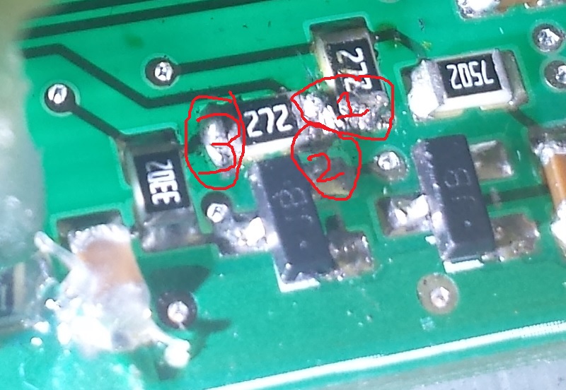

My Iat sensor reading SHOT to 150 C and settled down to 79 - 83 C quite suddenly while on a 15 minute drive... maybe I need to warm up the IAT sensor resistor sauder joints?
Thanks tho dave. I always thought it was in the # rating of the springs that would prevent roll.
EDIT: after parking and starting/driving again, the temp ranges between 60 and 130 C. I'm gonna warm the R joints shortly here...

I'm beginning to think it's this knock off sensor. Disconnecting yields a reading of -40 C and connecting reads 82 to 154 C!
Riiiight so I don't want to mess around with failing sensors any longer so I bought one locally for a exorbitant price (~$72) with a lifetime warranty. I bet the meth injection somehow kills it off more quickly. I should also mention that I cleaned the sensor and tested it again only to see the same impossible temps fed back.

Not sensor I guess lol. Gonna warm the sauder joints

anybody have any insight concerning the following picture and questions. Below is the IAT circuit section that needs modified for using the 1.8t iat sensor. My temps have gone haywire and when I attempted to reheat the sauder joints of the left 272 resistor, I ended up losing the connecton entirely and am stuck with 154 C.
VEMS IAT Circuit.jpg (133.75 KiB) Viewed 29715 times
Spots 1 and 3 were all warmed with the sauder gun. Are the legs of the 272's both supposed to be melted together in spot 1? In spot 2, is the leg of the JB (3 legs) component allowed to touch the 272's leg?
:idunno: :idunno: :idunno: :idunno: :idunno:
TIA!!!

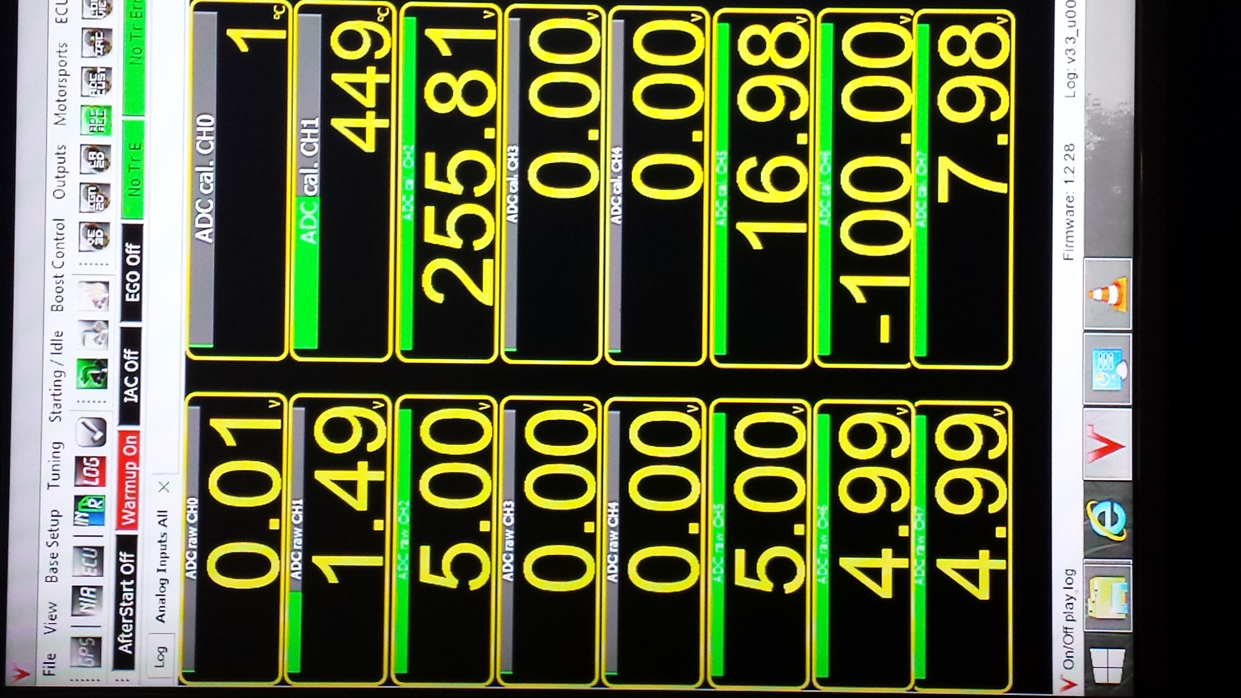

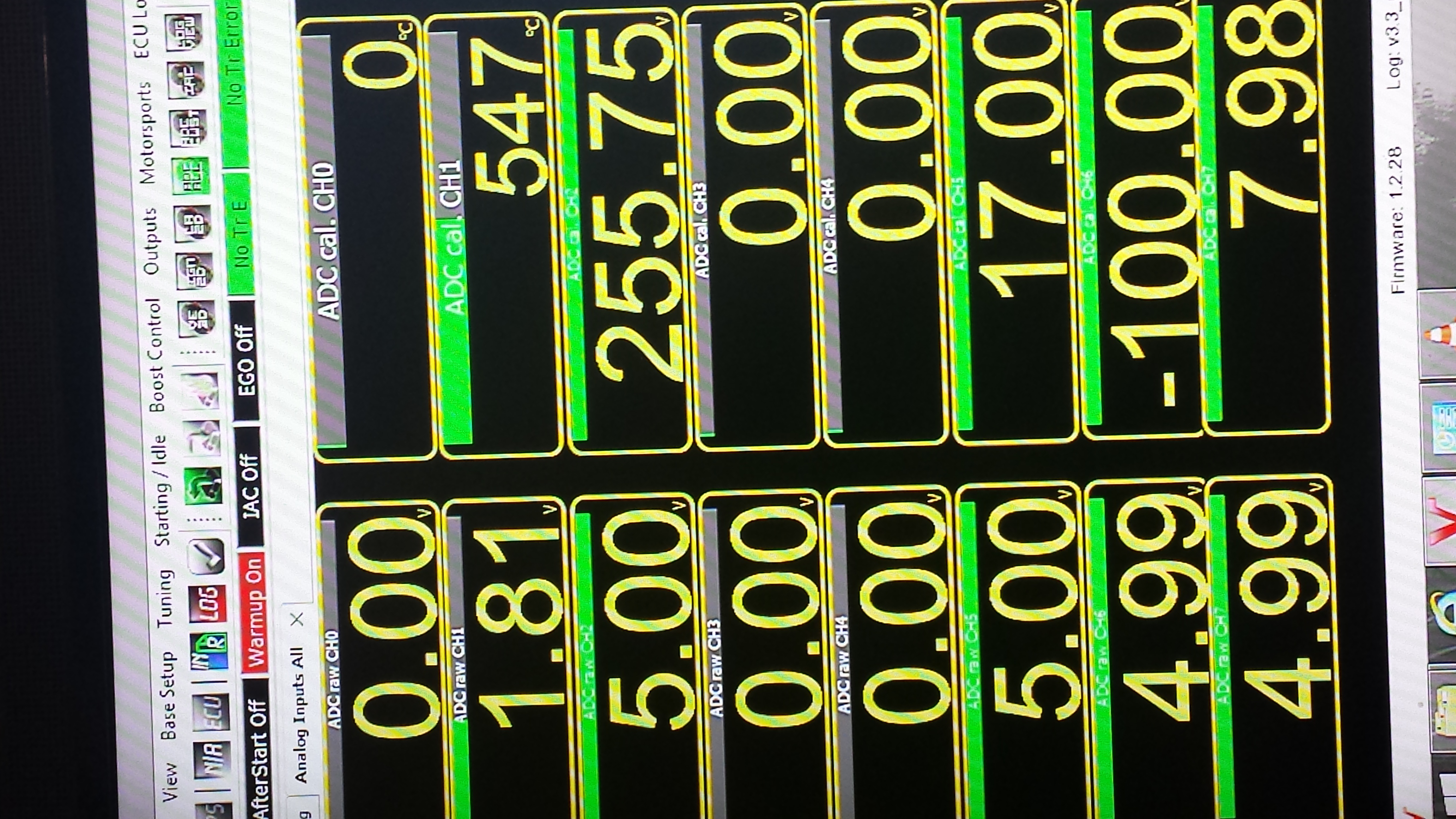

Marc helped me with the circuit above. I went back to review my log when this all went crazy and found that the only things that changed on my ADC ALL page was that ADC raw CH1 slowly rose to 1.81 v and ADC cal. CH1 went up 100 C. That 100 C seems significant. Idk.
Before:
After:
88a5tq
Posts: 1553
Post by 88a5tq »
I feel like Marc deserves some big time credit for his work today. He repaires my IAT circuit and got 3 gauges working again and all since the ecu left my hands yesterday from PA! Seriously awesome support folks!

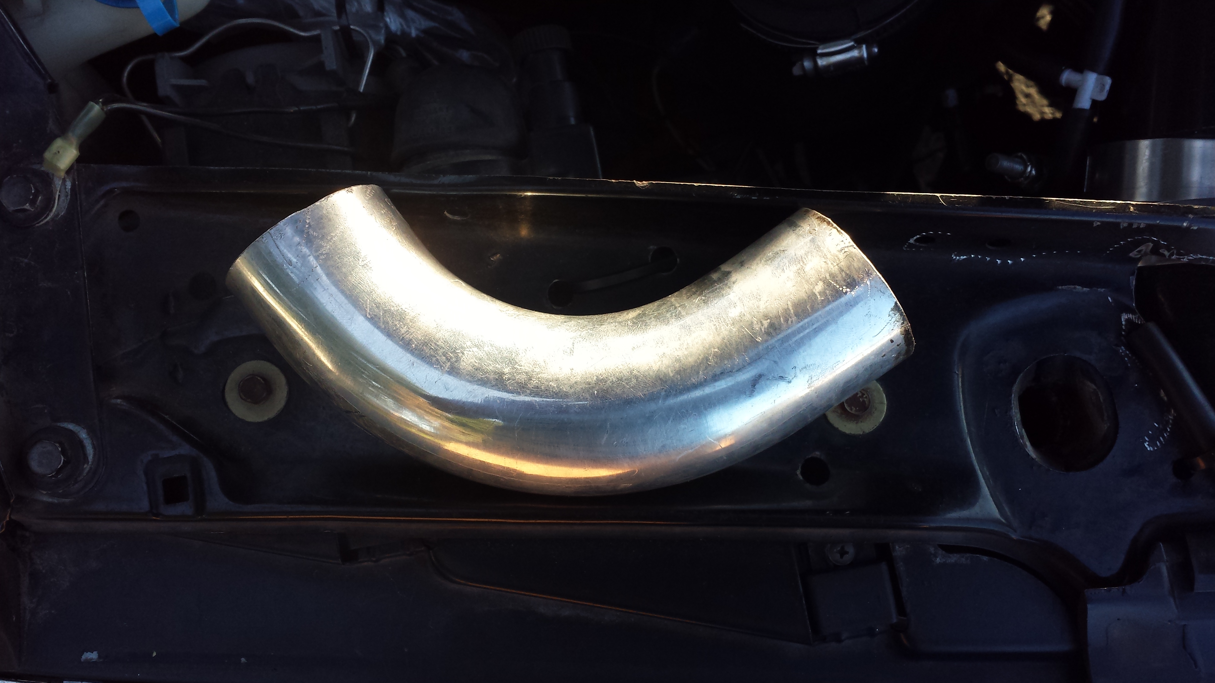

All is well ATM. Actually I had to pull this aluminum elbow back out after it was choking up my top end. Couldn't flow as much as the old silicone elbow (cut down stock turbo-IC hose)
Seems to flow much better. It's strange because the wall thickness is only slightly thicker than my other 2" OD pipes. ID is slightly less but OD of the Chinese-source elbow is small enough that the pipe can nearly fit INTO the other IC piping that 2". No I didn't bother measuring any of the pieces lol.

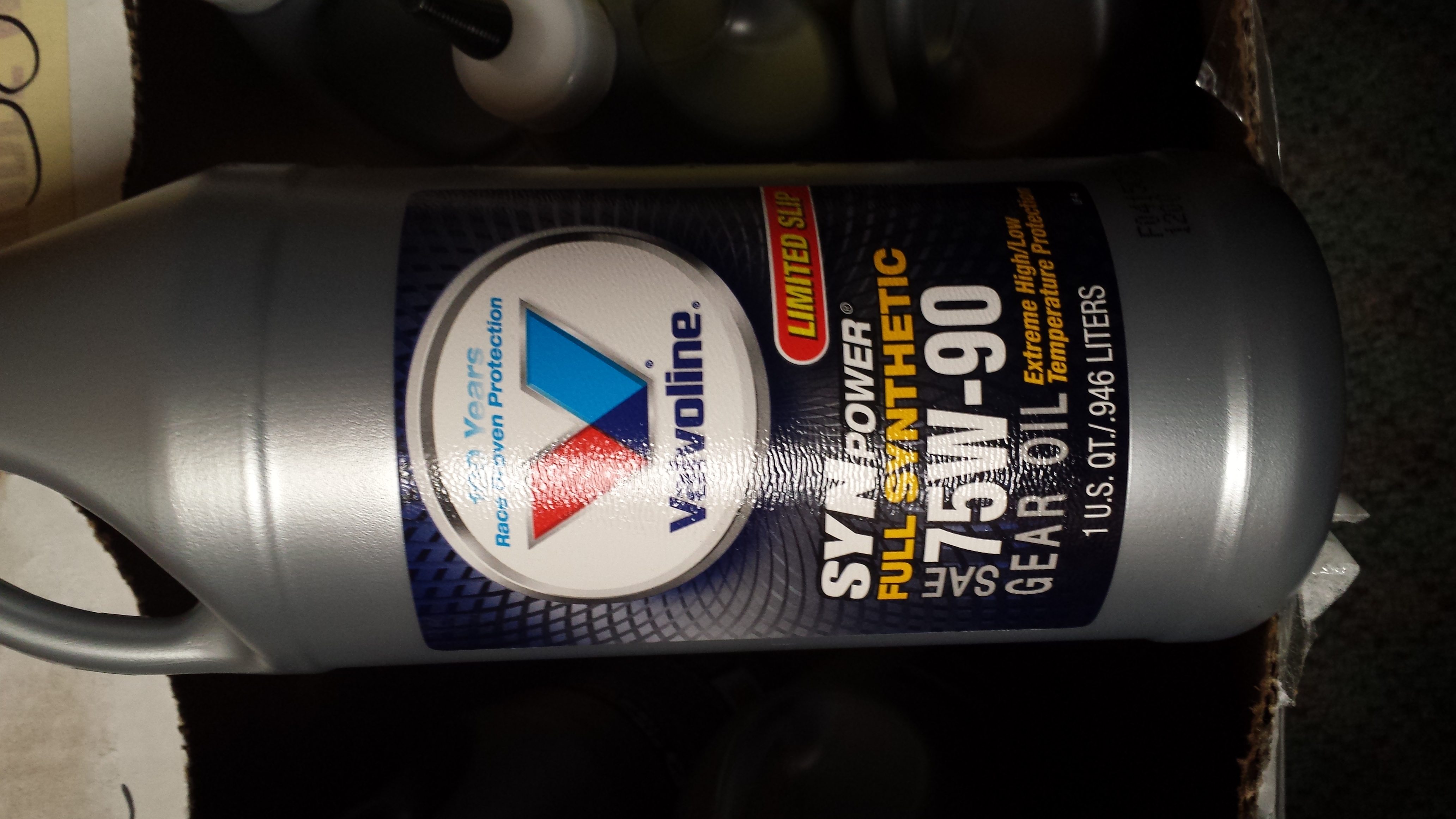

I bought 6 qts of this synpower to do the trans and diffs.
Made an appointment for it for Wednesday next week when I decided to try doing at least the trans myself. Got the fill and 1 drain plug loose but the one for the center diff has me nervous. I want to skip it actually bahaha! Can I ya think?
Anyway it's $65 labor back in my pocket if I do the trans like I want to tomorrow.
Chris, do you have an opinion one way or the other of that synpower? I believe I used it in the trans of the 5000 yrs ago... looks like it's similar to the redline mentioned on sjm. Also, I think I skipped the 2nd drain plug on the 5k's center diff as well :hide:

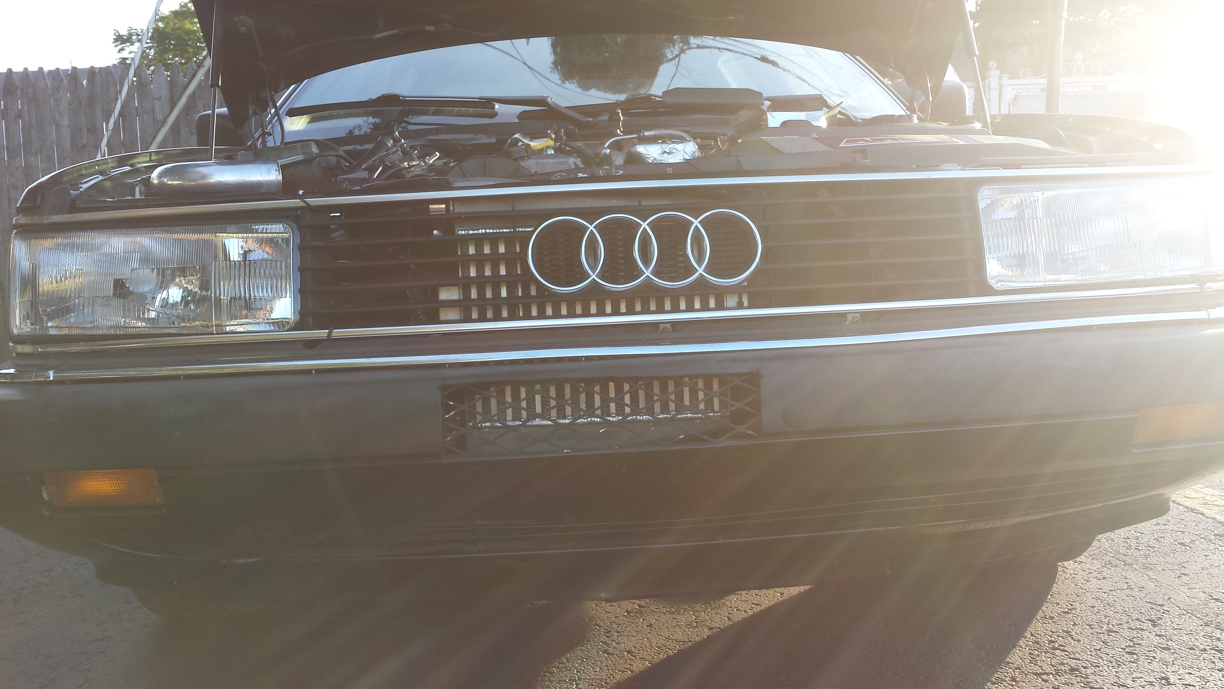

And now for a quick photo carpet bombing
That's the IC with a flat black painted grill to keep birds out.
