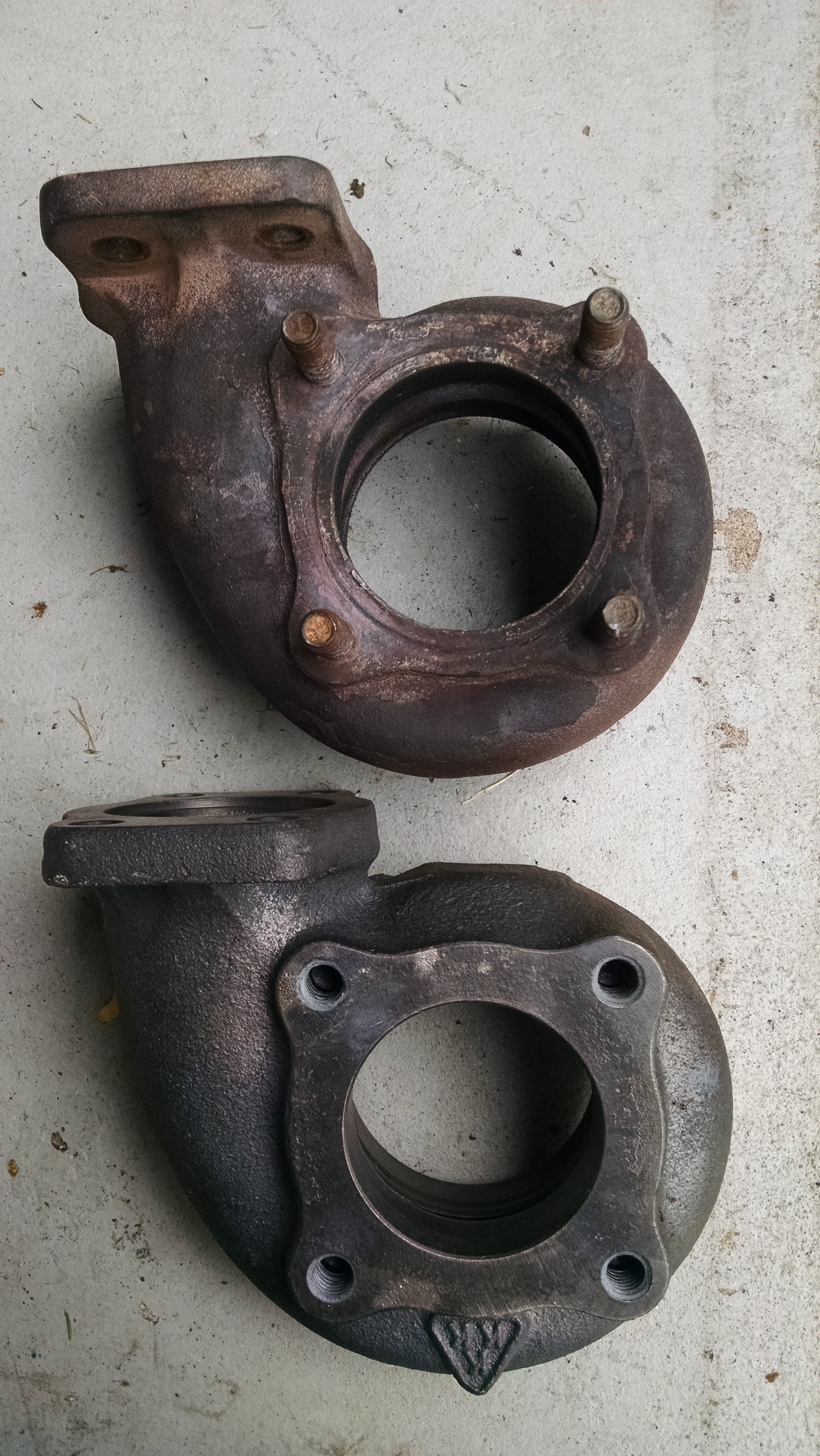

I did it again... I have another turbo on the way. This time I will be putting it in! Anyways, it was listed as a Porsche upgrade, but the seller wasn't interested in giving any details. The only thing in the description was "excellent condition". It has obviously been heats cycled many times, as the turbine houseing appears "peeled". That's ok though, I'll get it cleaned up and checked out. I can't find much in the brand though, ITS comes up as a turbo rebuilder in the UK. Anyone have any idea? I'm thinking To4 based.

As for the mystery turbo, I'll have to spec it out, and figure out what turbo it is when it gets here on Monday. I figure I'm ringing out this K24 to 20psi+, so need something different to go more. :drive:

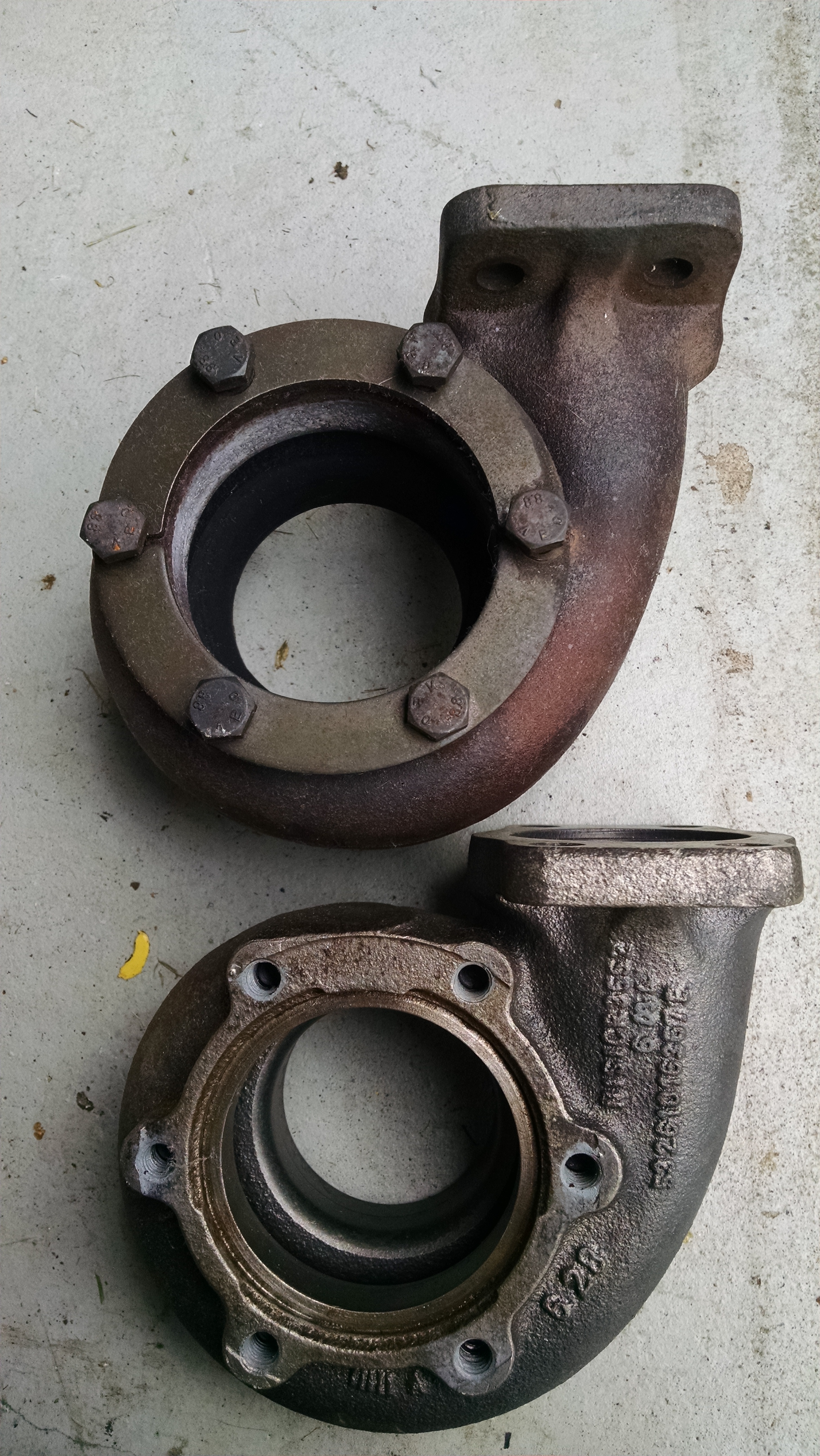

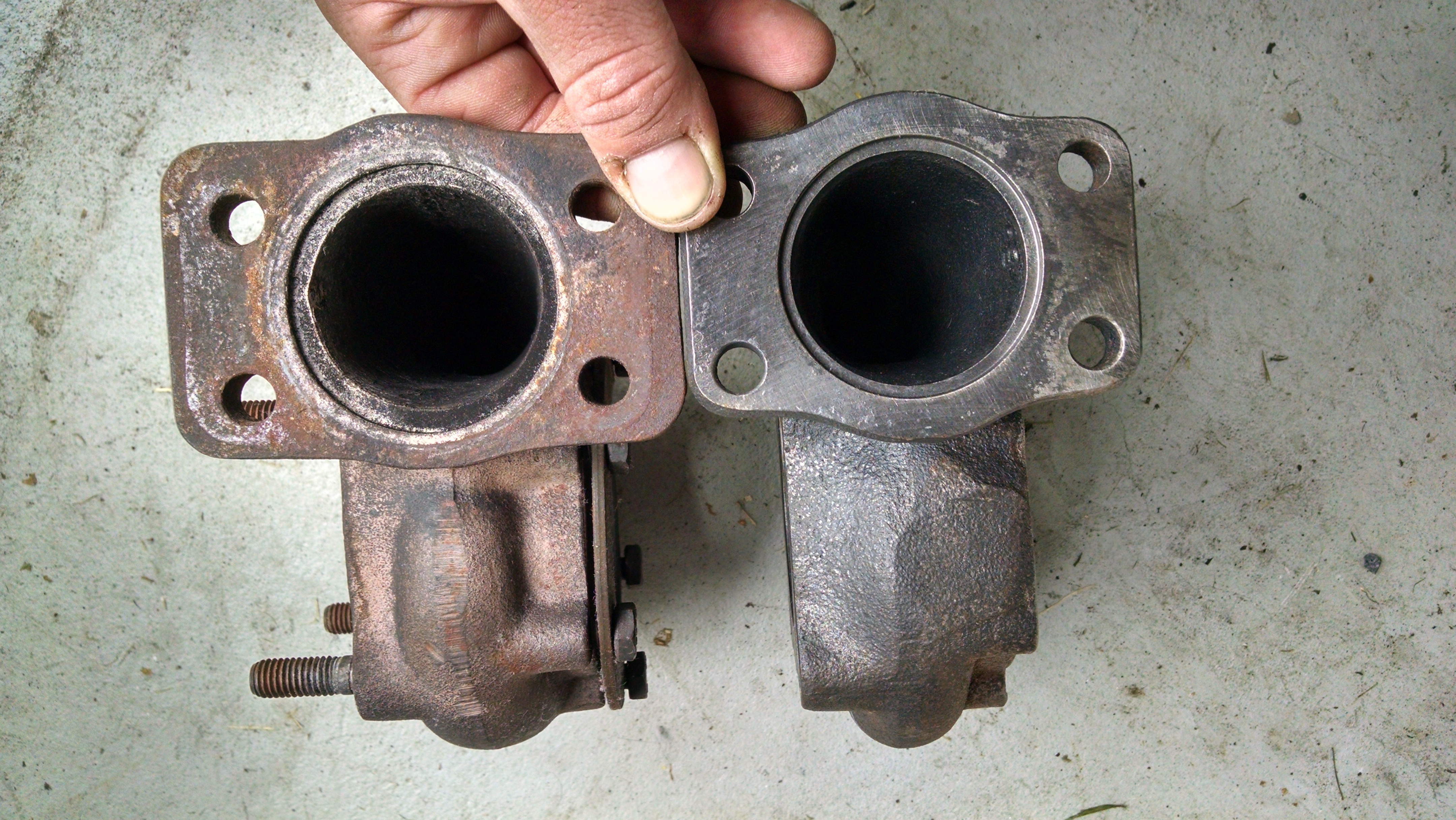

I decided to take some comparison pics of a K26 Vs the new turbo. The exhaust housing is an Audi K26 #6 housing, and I think the compressor housing is from a Porsche K26/6.

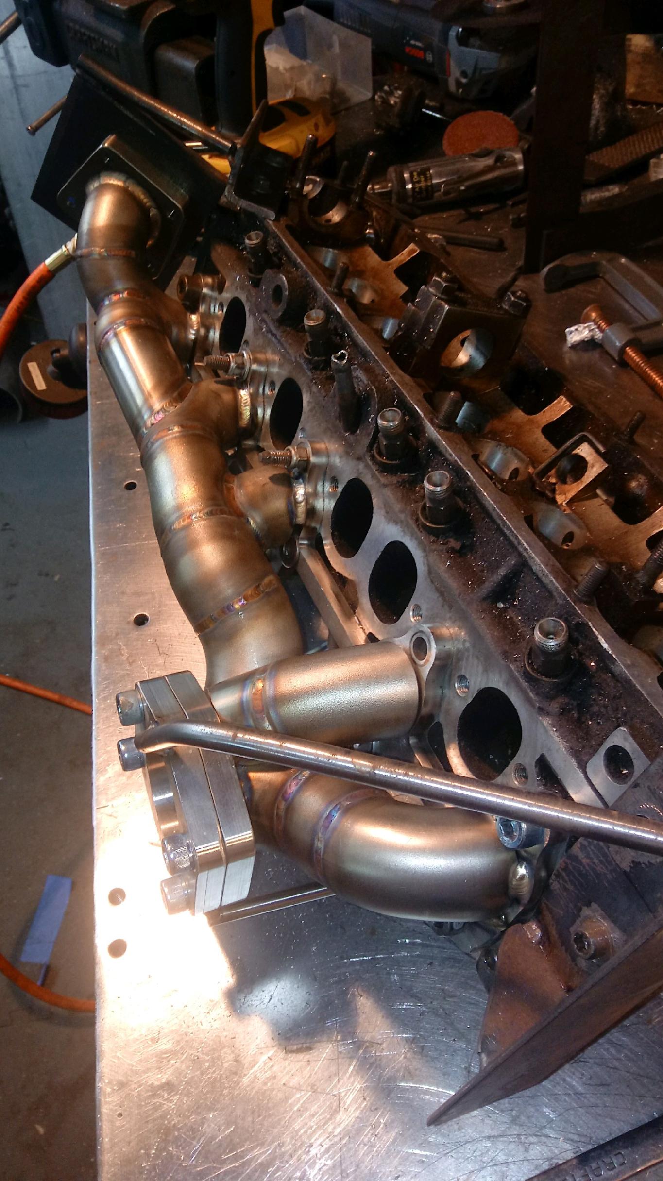

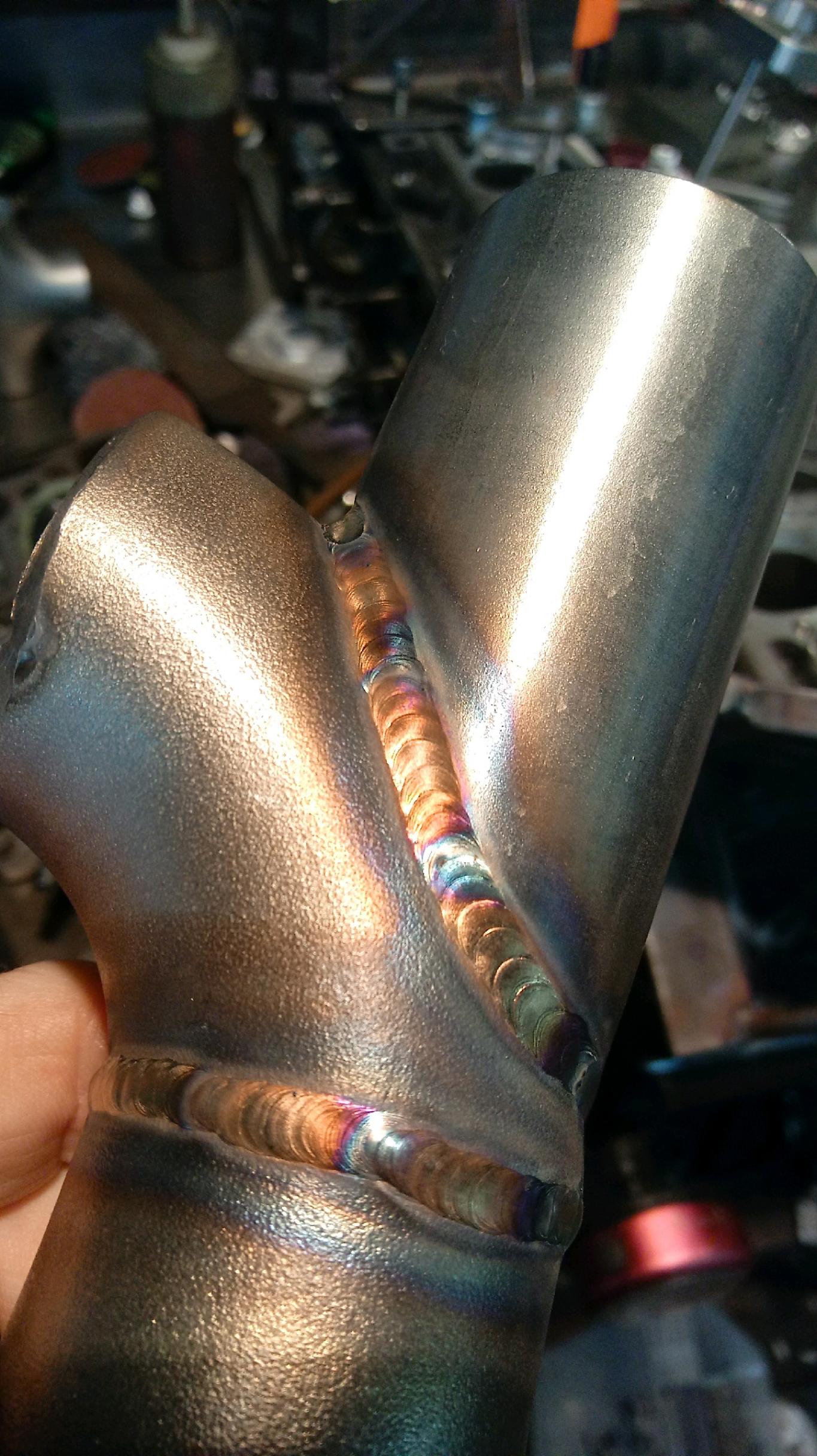

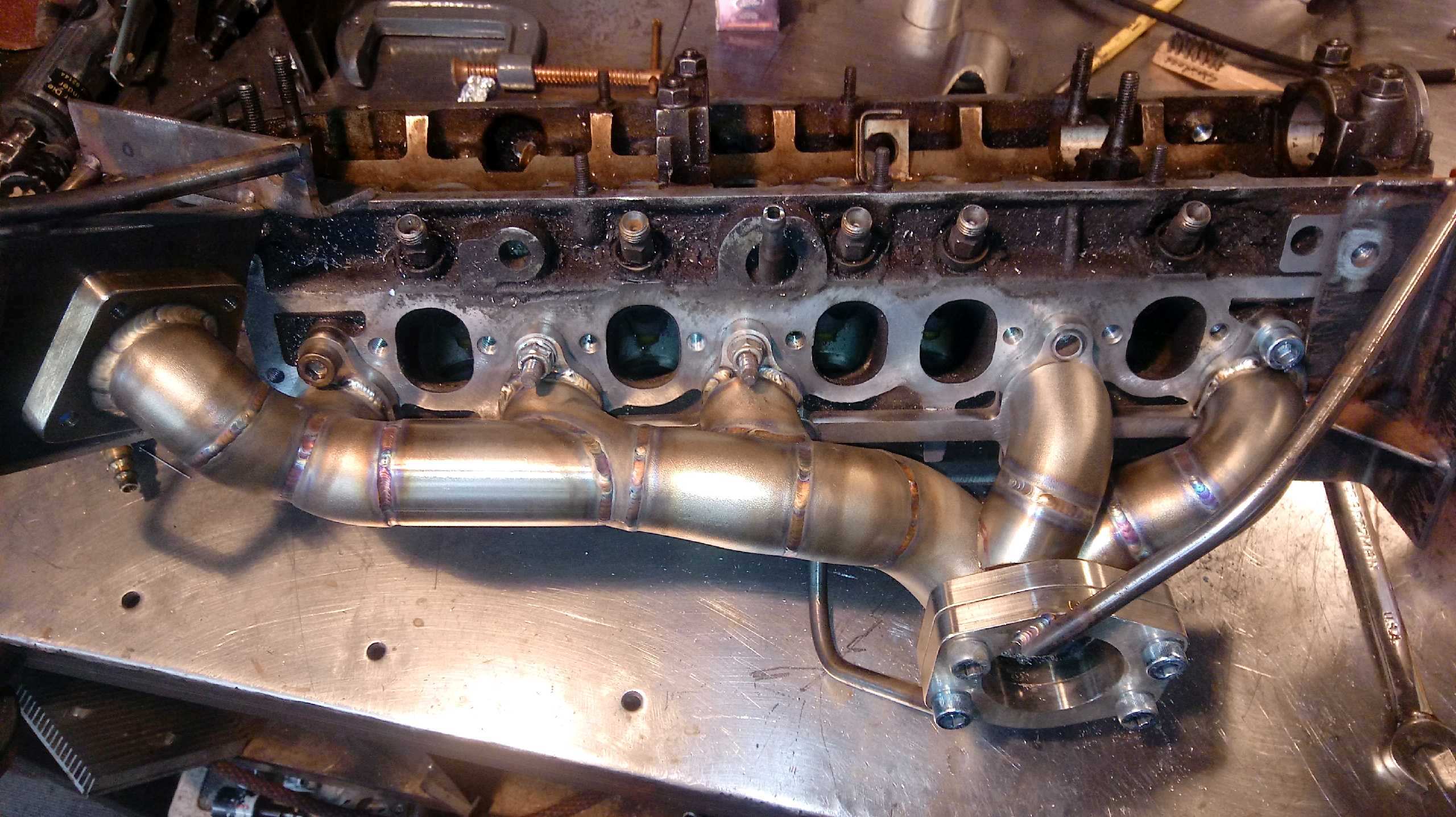

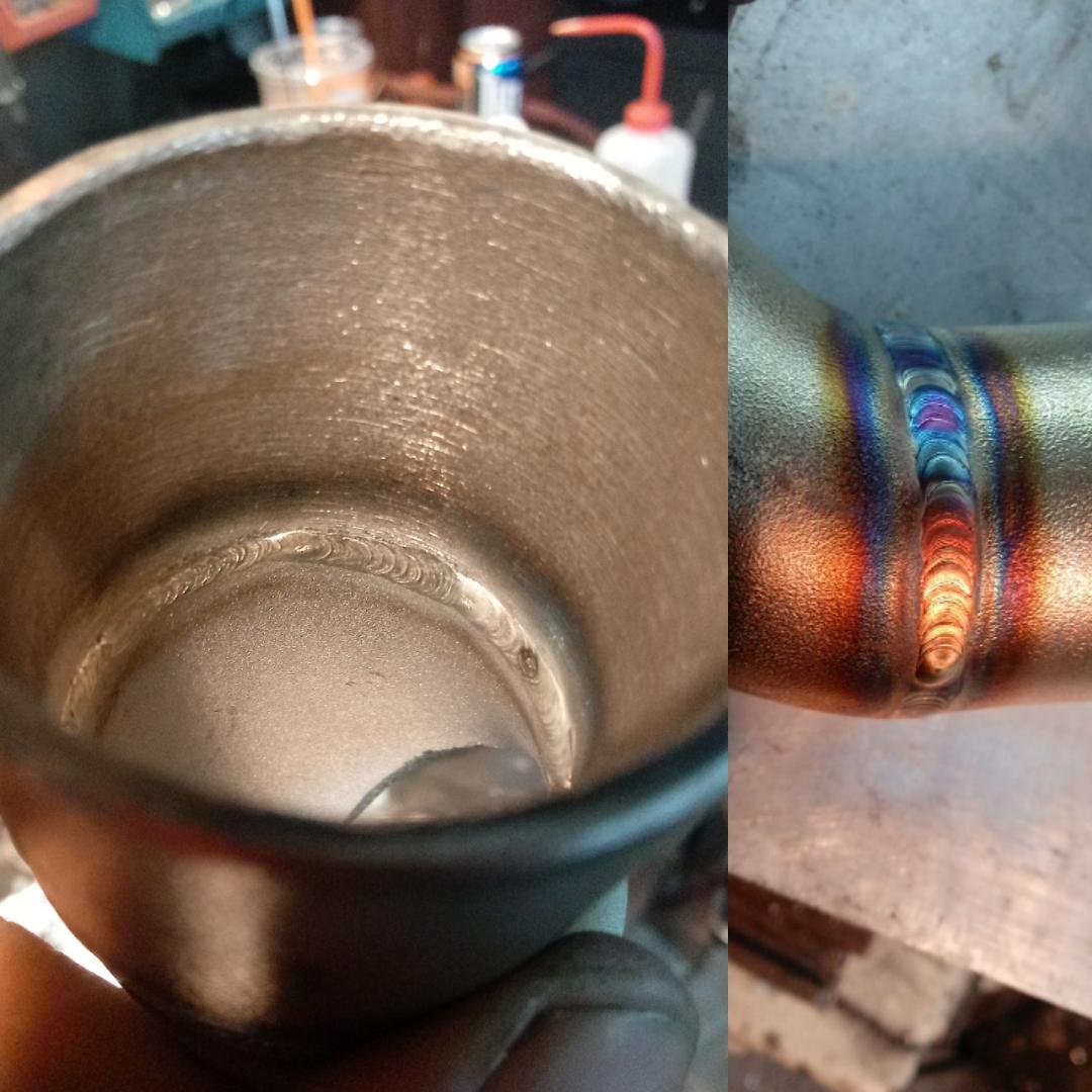

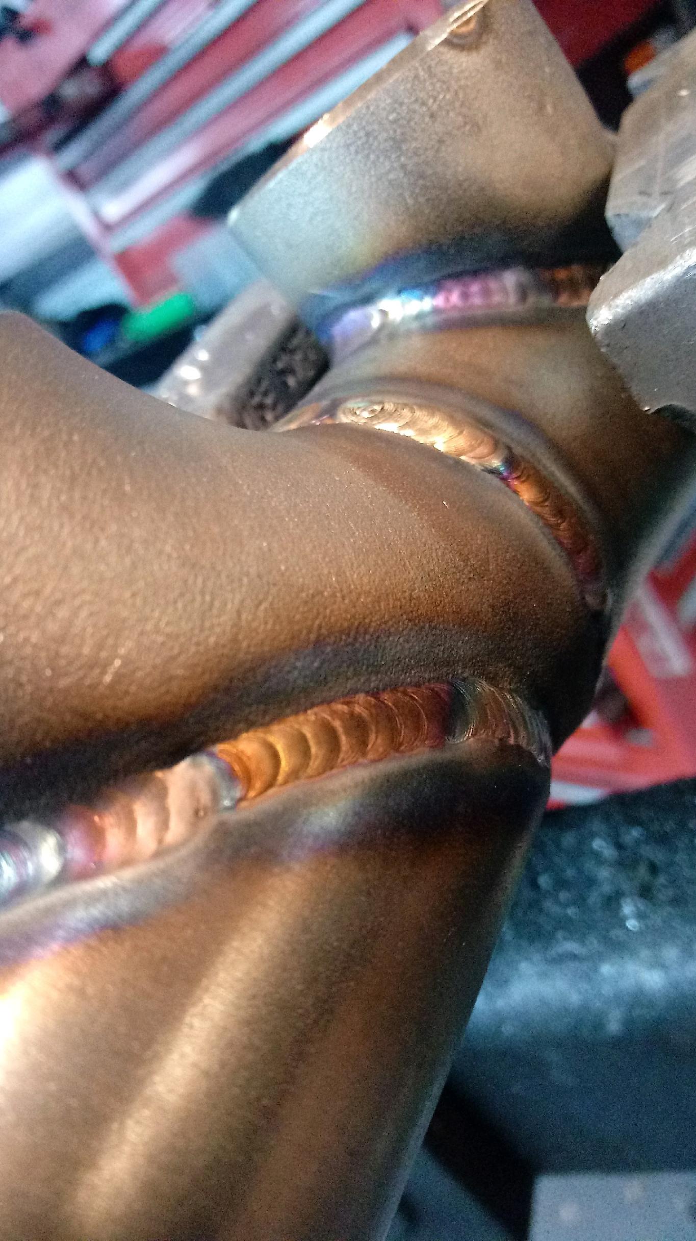

Well, I can finally let this one out the bag. About a month ago, I had a lengthy discussion with Tim about making a higher flowing, factory placement manifold. Over the past couple weeks, I've been getting some pretty neat pictures of his progress. It almost done now, just one last tube to make for the wastegate. Figure at this point, I can start sharing some of these pics. Tell me what you guys think.

I think that looks fantastic. A real nice and tidy package. Also curious as to where you got the wastegate flange or if it was made. I can't find one state side for the manifold I'm building.
Re: 20vt B3 (The Bandit)
Tim made some 304ss ones for the manifolds he was making.

Dang that’s going to be awesome . Not many tube header 20v’s around
