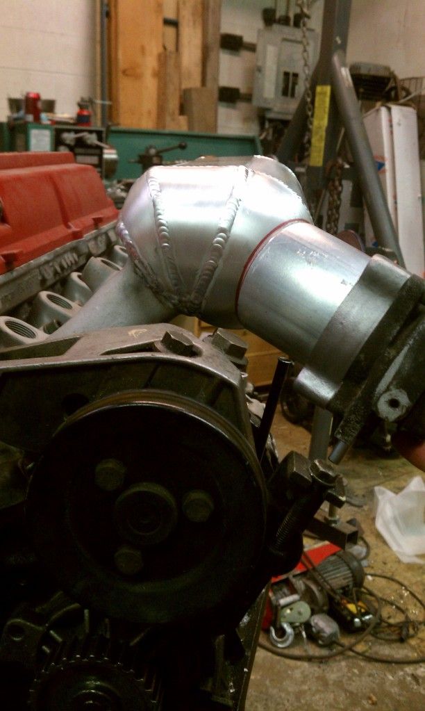

Now we're well into May and the car isn't quite finished (oh well) but I'm still shooting for Carlisle. I have moved the car once again to a new location to work on it since my garage is no longer available (again) and I've been plugging away at small items which aren't much to look at. In the mean time, here's some teaser action from Hank

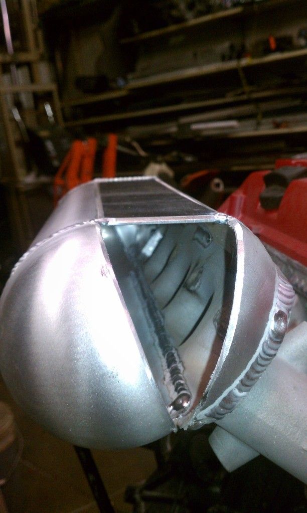

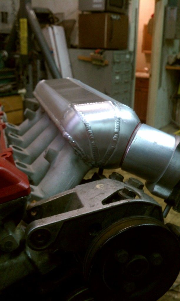

How does that work with the radiator? I'd love something like that but never thought it would package. Or, do you just put in a shorter core to clear the intake tubing?
Re: Casey's 200 20v: Intake teaser
I think he is using a shorter core so that there is more room. Now that I have this one made though, I think you could sneak it over the top of the PS pump in the stock location without a lot of problem. Most of the issue is with the clearance of the hood, becasue of the low slung hood in the type 44. This intake is no taller than the AAN valve cover, so I am hoping he won't have to lower anything to get it to fit.

Yep, using a shorter core, but 3" thick. I'm pretty convinced that it's not worth trying with the stock radiator - would probably need a thin oval like inlet to the IM123quattro wrote:How does that work with the radiator? I'd love something like that but never thought it would package. Or, do you just put in a shorter core to clear the intake tubing?
Yes, the thin oval is what I would recommend coming into the IM. Kindof a pain, but doable.

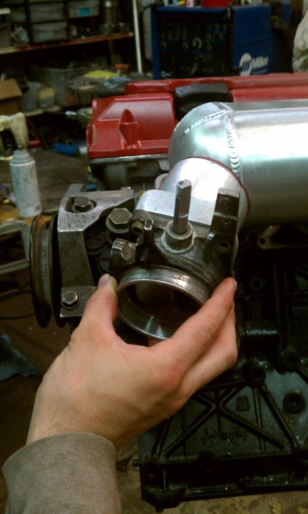

Did the clocking of the TB change?
It would appear so!
