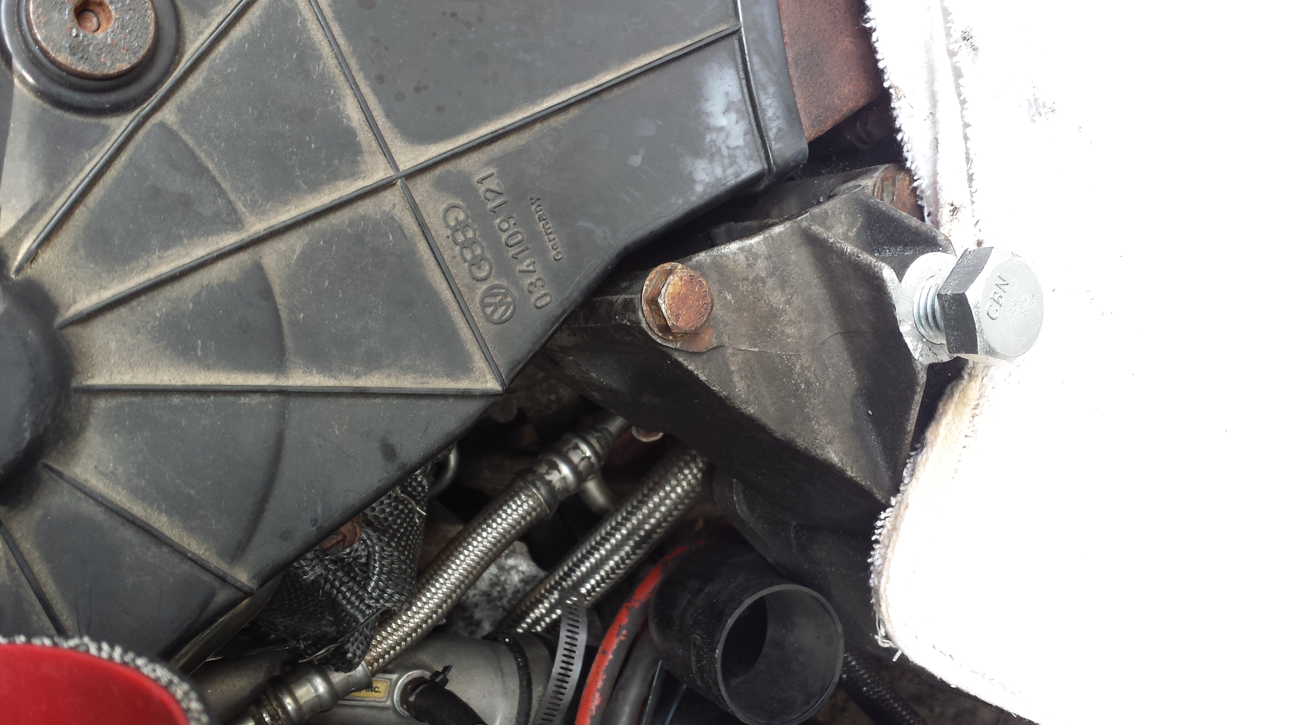

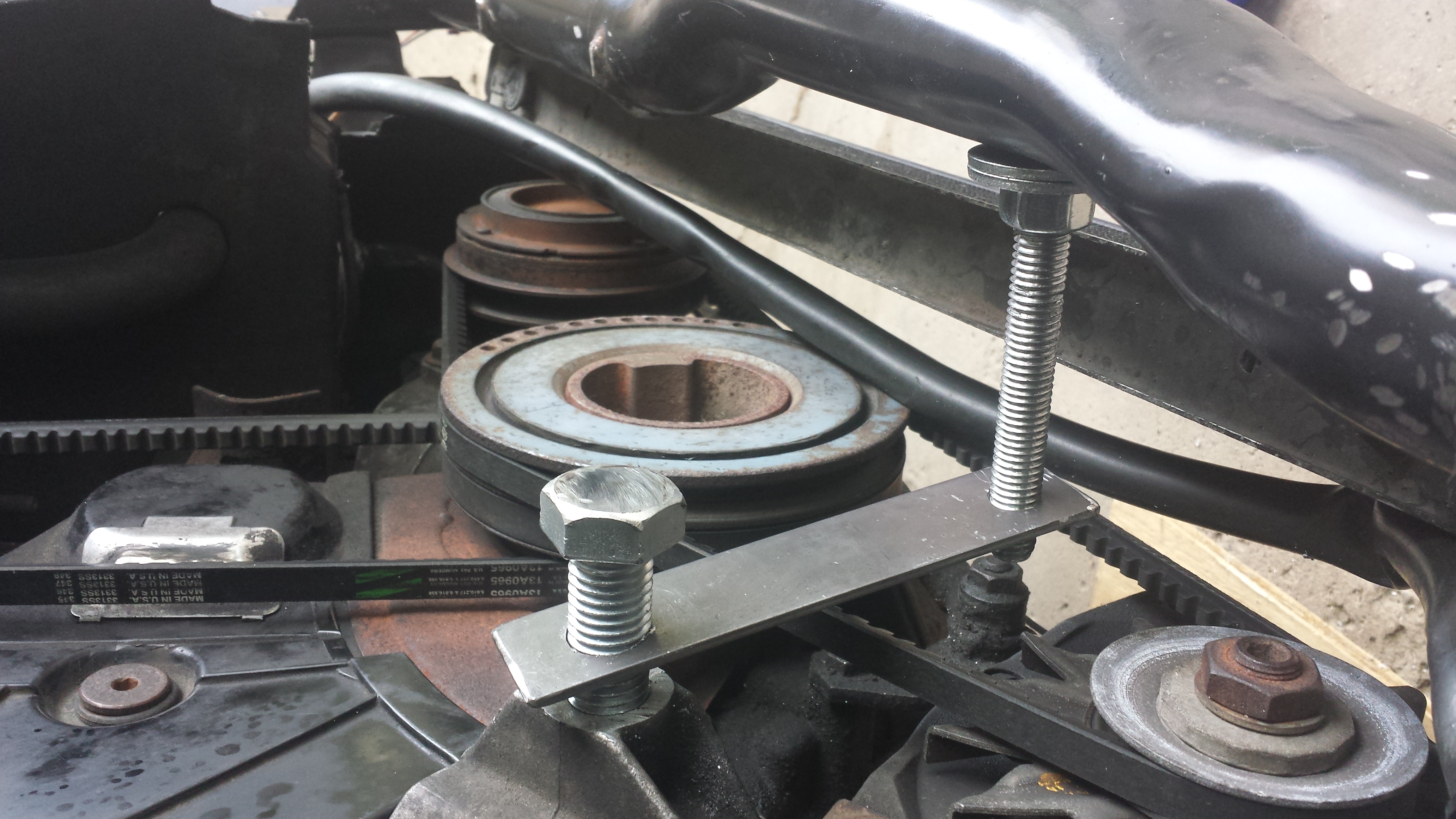

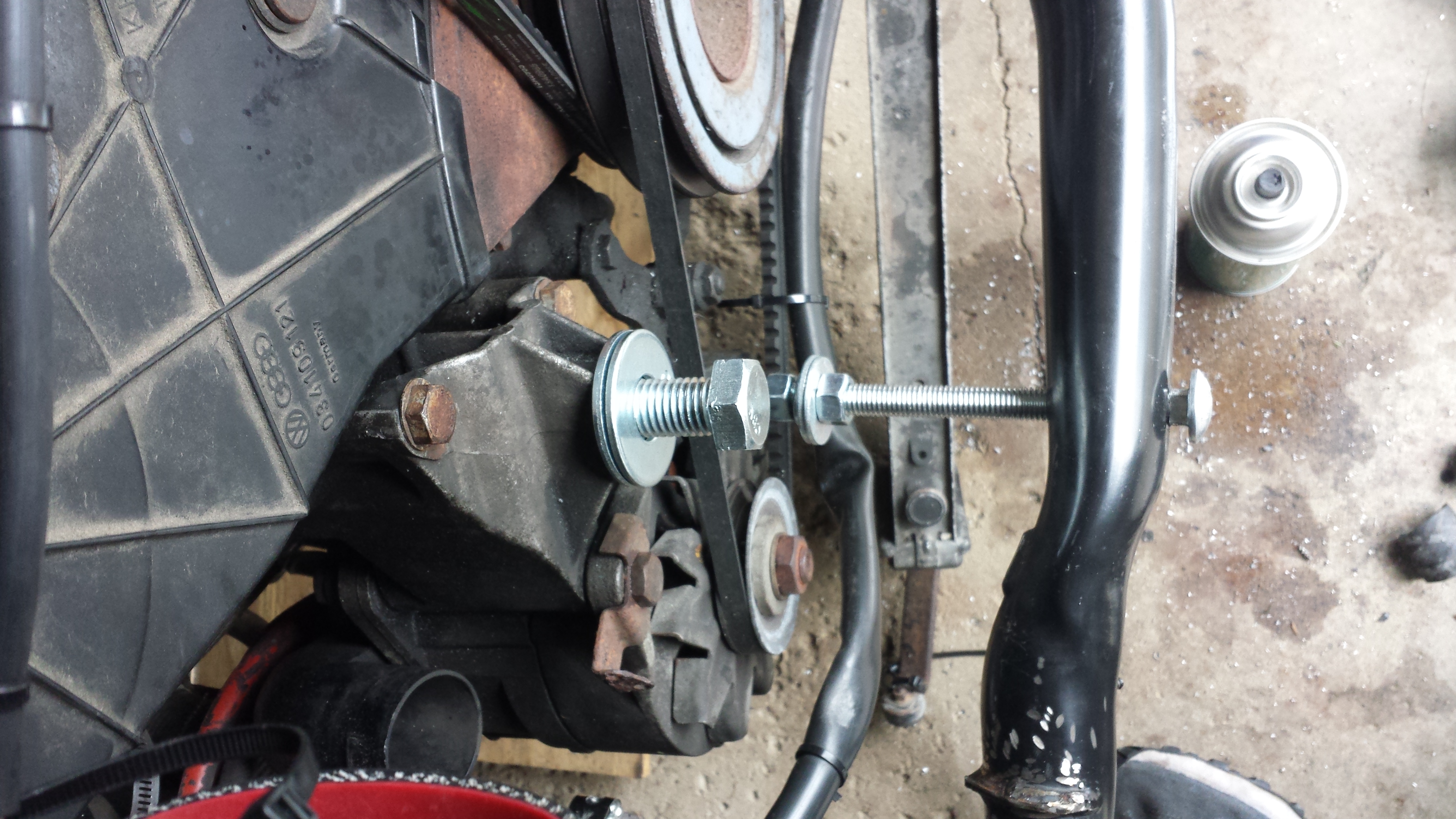

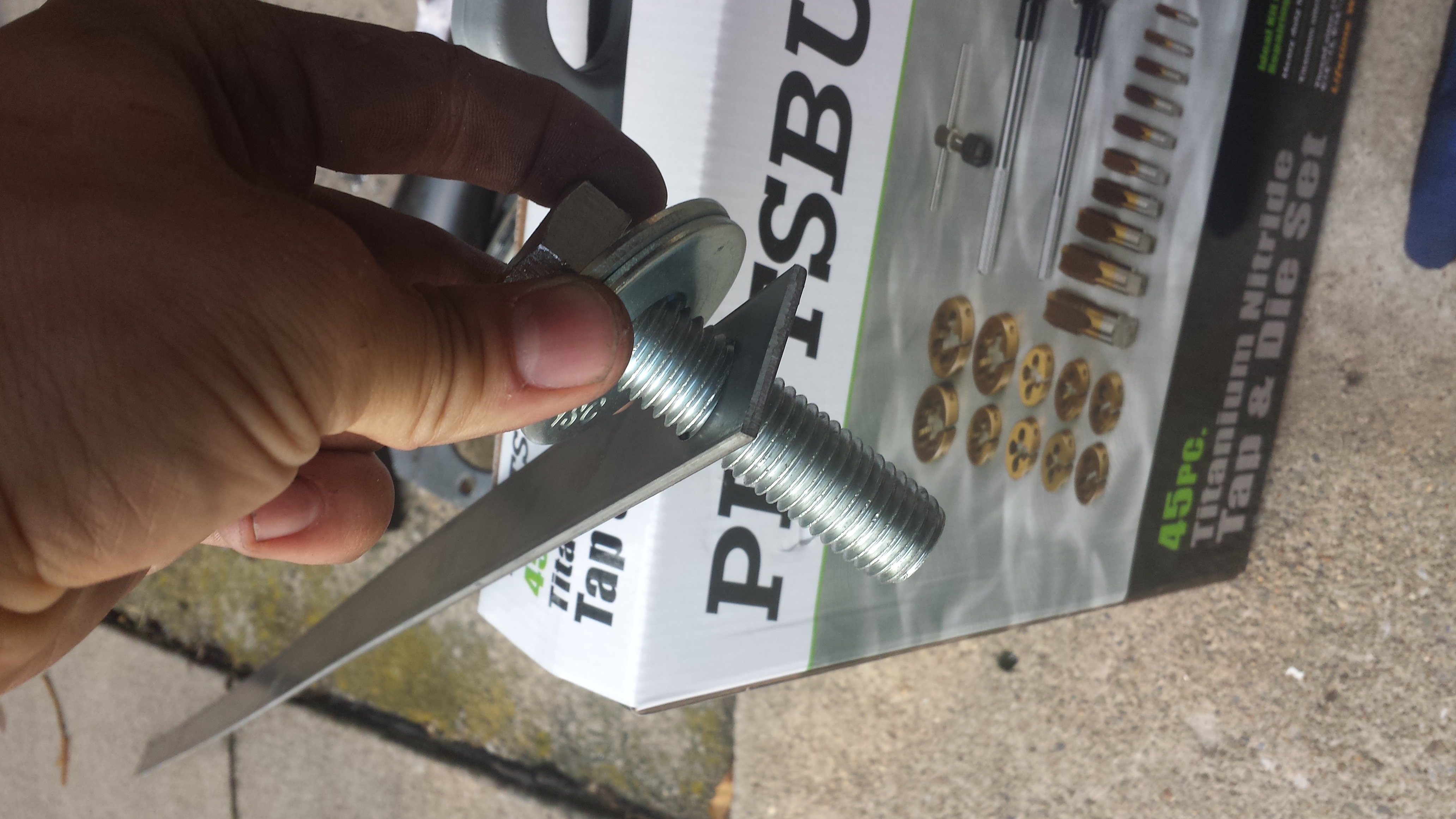

I got all the stuff together to hopefully accomplish this ghetto snub linkage. Got the the 3/4-10 tap courtesy of the harbor freight rental program
got all the hardware at home Depot including a 1/2" bolt of 6" length that will go through the cross member and run under the IC and just above the now-lowered aux rad. Hoping to get mostly done tonight
It's starting to take shape

Another.
Do you naw mean now?
Thick ass steel "link"
- 1436483205262-1525454038.jpg (2.62 MiB) Viewed 32270 times
- 1436481493046973026436.jpg (3.02 MiB) Viewed 32275 times

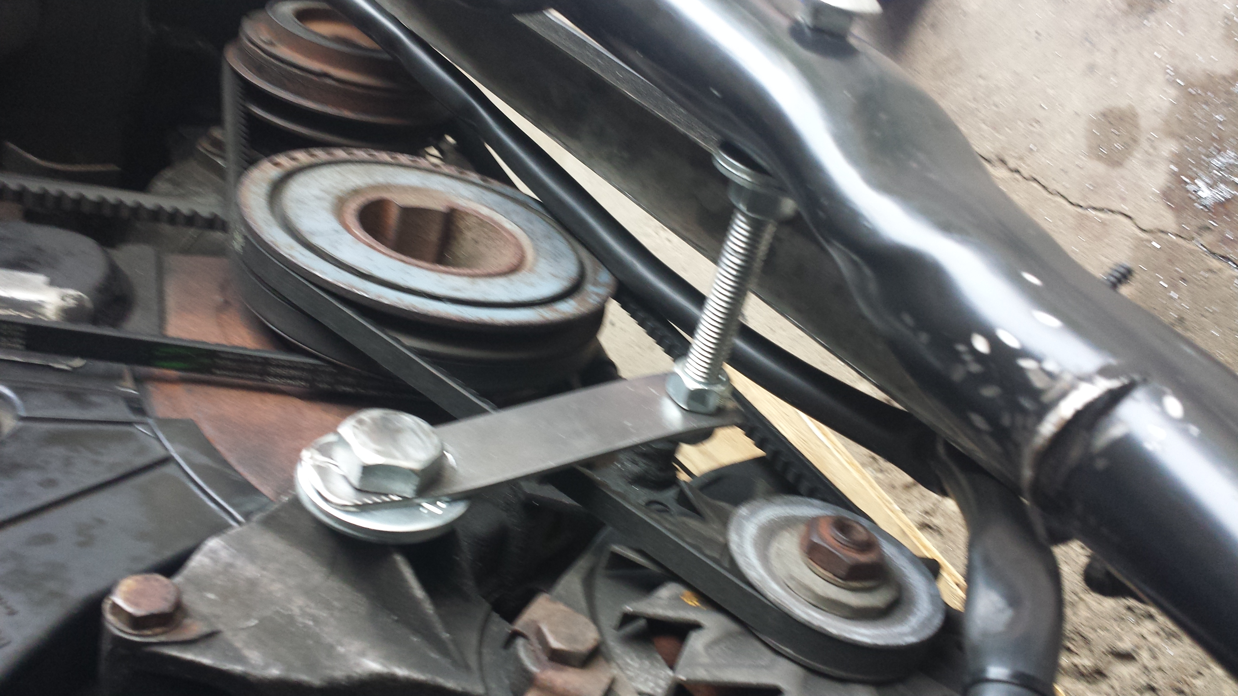

Nearly done
- 14364845831531740179498.jpg (2.89 MiB) Viewed 32268 times
Finito
Thoughts
Thoughts
- 1436485701793-1331512636.jpg (2.85 MiB) Viewed 32278 times
Lol its not as bad as I thought it would be.
From an engineering at any point, you should never put a bolt in shear, but those are thick enough that from a redneck standpoint, it'll work just fine! Of course, you're only stopping movement in the up direction, but that's probably what's needed most anyway.
Lol I suppose I mispoke when I said ghetto. Thanks for the compliment. Car drives GREAT with that mount solidified. I was concerned about shear and tearout for the bolts and sheet metal and that was the reason. I didn't use the thinner sheets I had leftover as well as the much thicker bolts. The 1/2" bolt might even give enough elastically to take some of the shock out of the worst of scenarios.

No issues during the drive yesterday and the IC has just enough room behind it to prevent contacting the 3/4" bolt's head. Wasn't even any new vibrations!

Sleeved the 1/2" bolt through the crossmember for her pleasure

Glad to hear that. I would hate to see the bolt rip through the cross member.
Threads can be vicious in metal/metal environments
my biggest fear was it actually failing and throwing my bolt and that sheet metal around violently and punching a hole in the new IC and maybe even being as bad as destroying belts. God forbid it take down the timing one. Solved!
