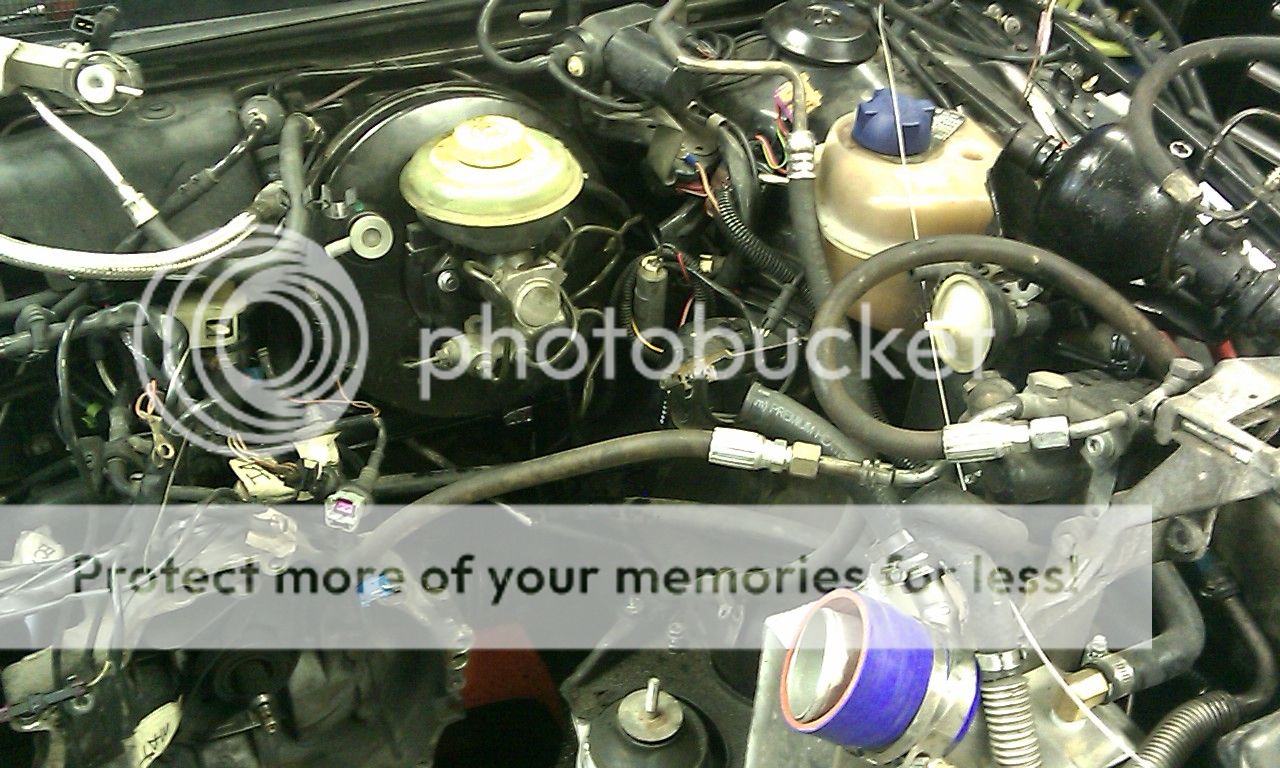

Dave is helping me figure out what parts to get so i can do the vaccum brake swap.

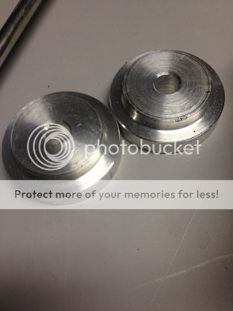

waiting till the 25th and i can get those used 034 Aluminuim subframe bushings for front and rear, (doesnt count as me supporting 034 cause i bought from another person.
Traded my B4 strut bar plus cash for them. pretty sweet deal.

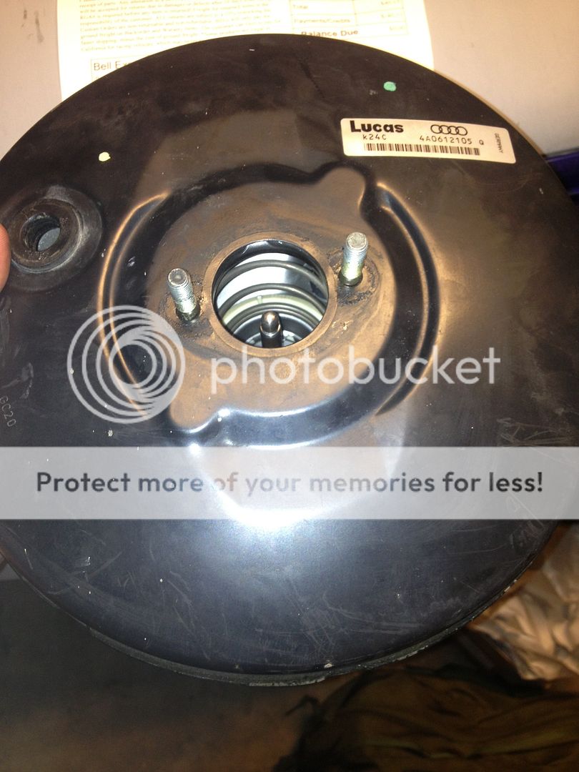

i got the brake booster for my car from a B4 audi 90 V6. such a shame because the car only had 90,000 miles and it had the interior destroyed because someone left the door open. but the engine bay was PERFECT. oh well.

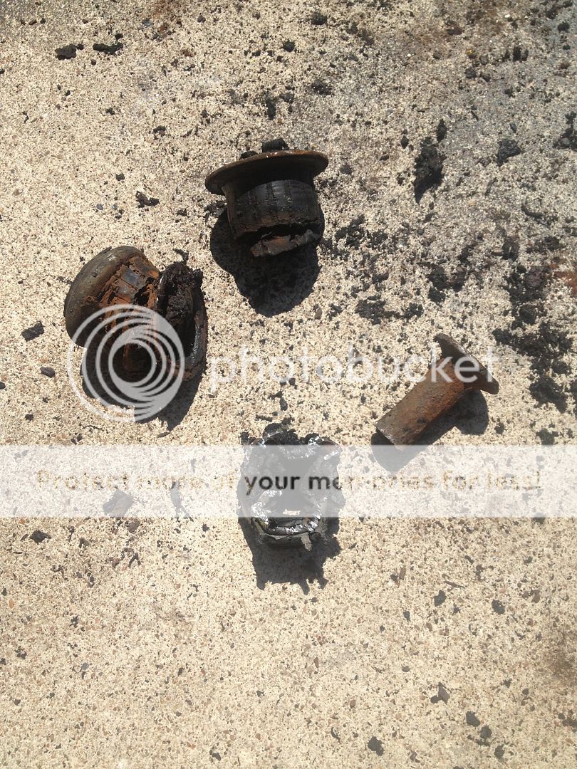

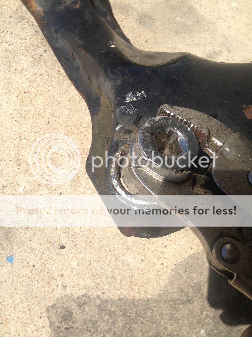

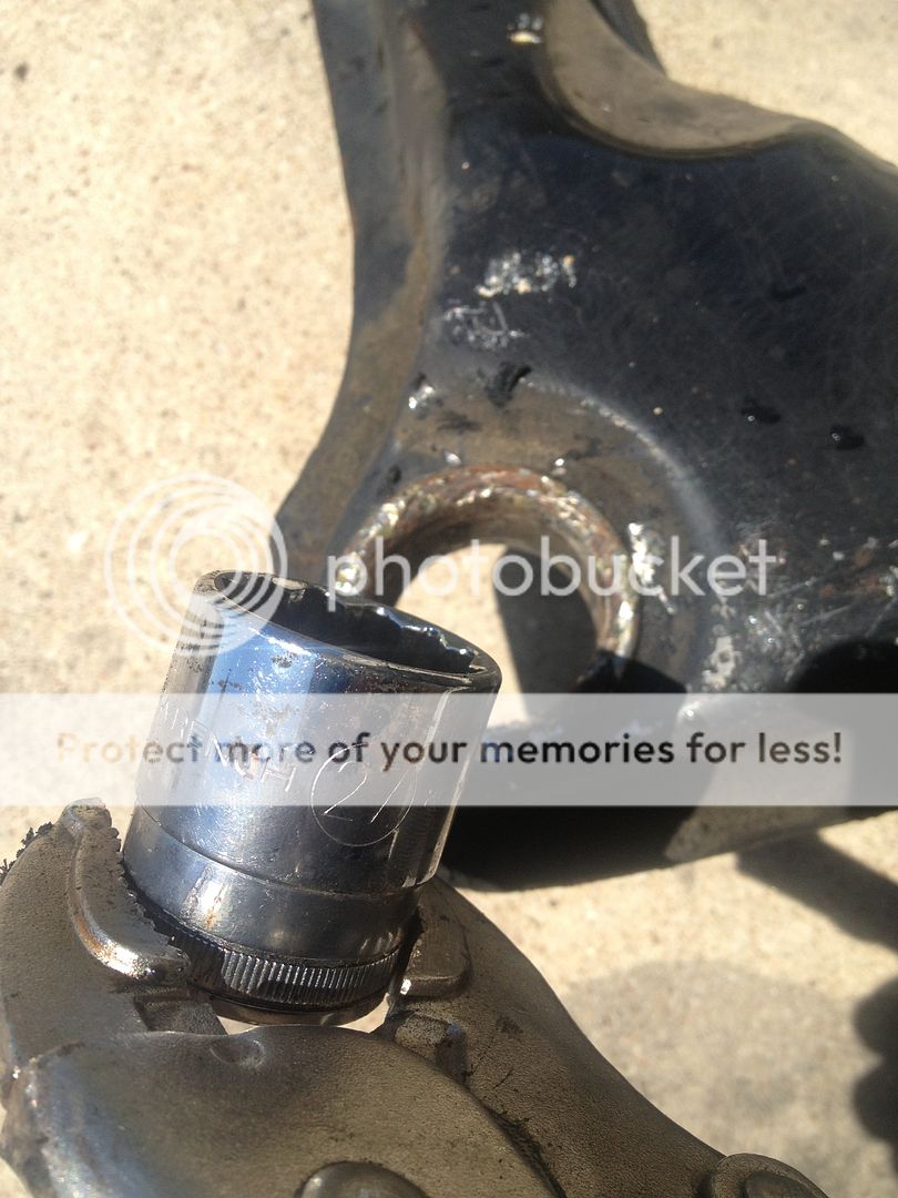

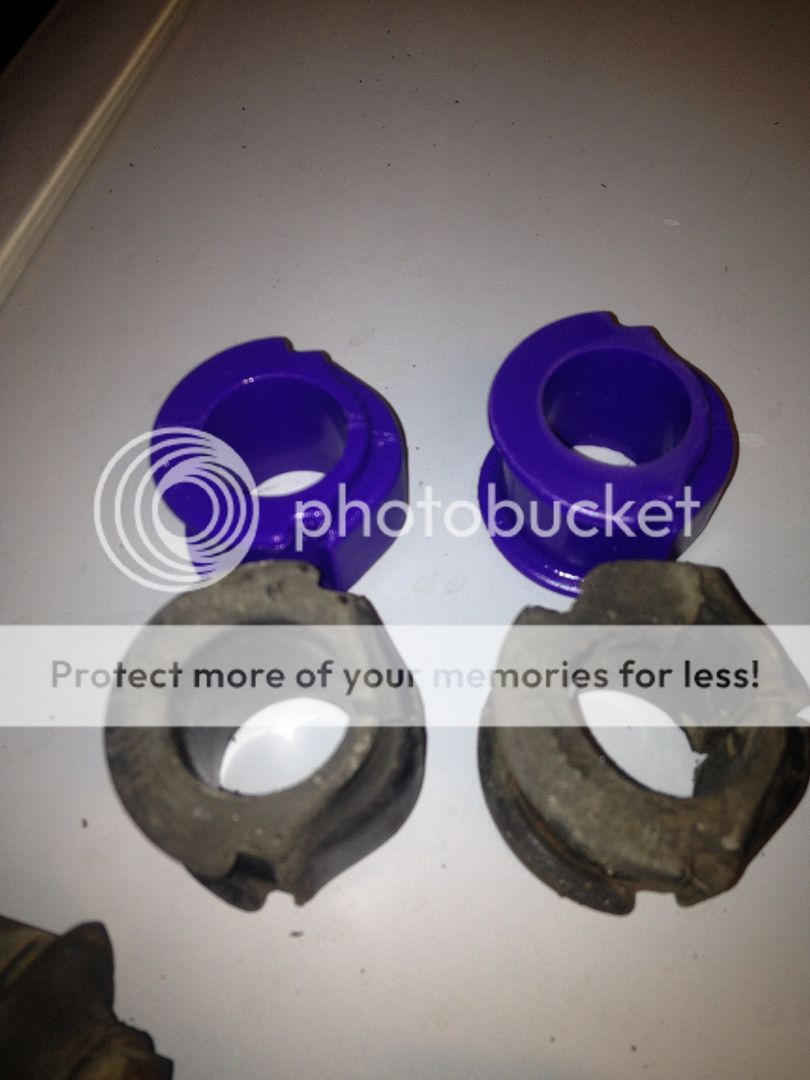

the subframe bushings in front! mostly just fell out saving me the trouble of drilling those.
A 27mm Socket and a Vis Grip work nicely to punch out the old bushings and rings.
I got my Powerflex bushings in the mail the other day.

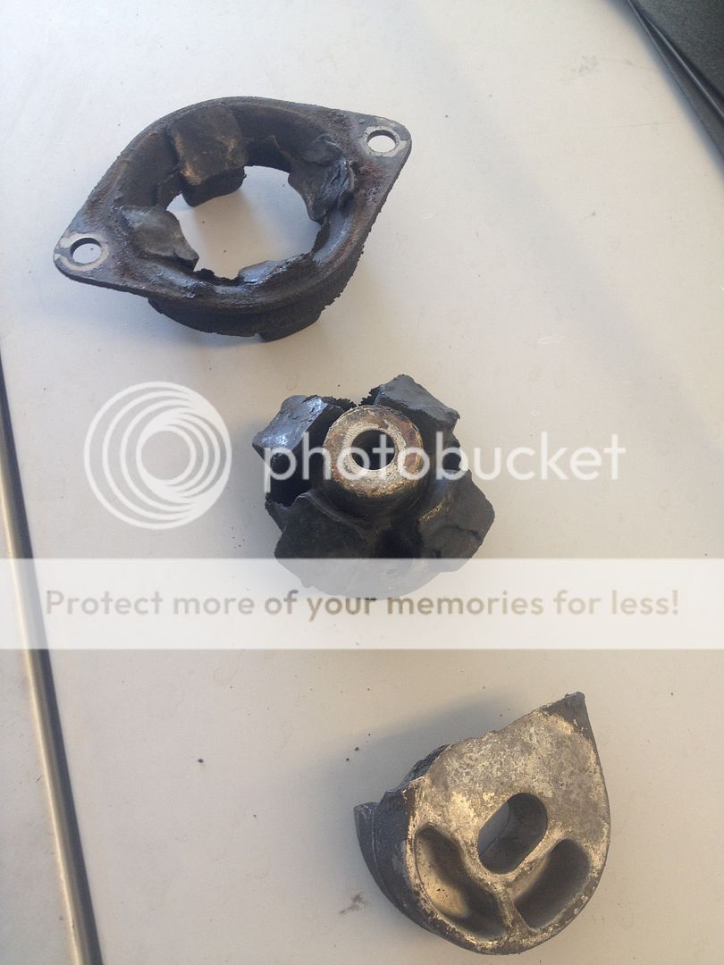

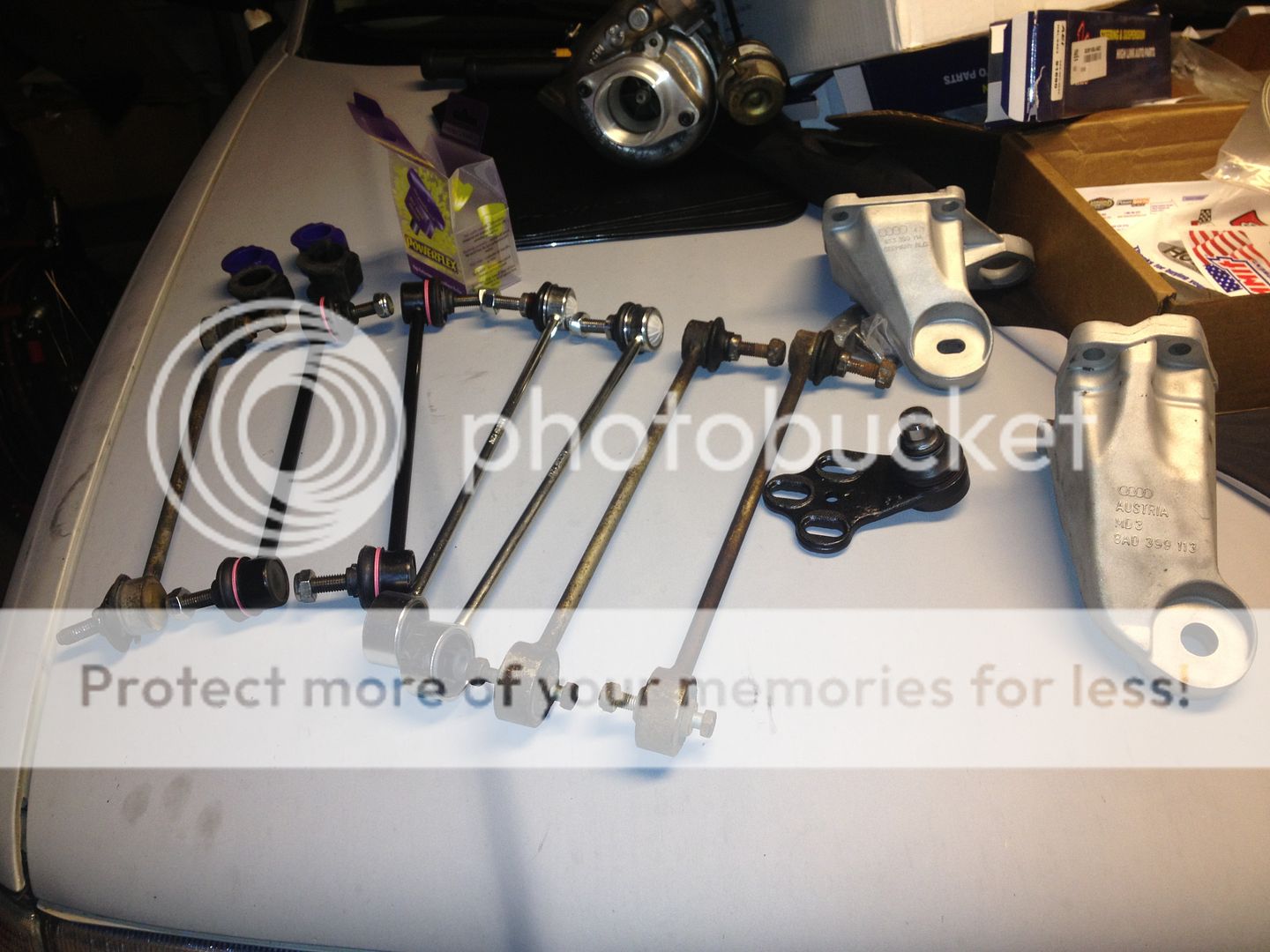

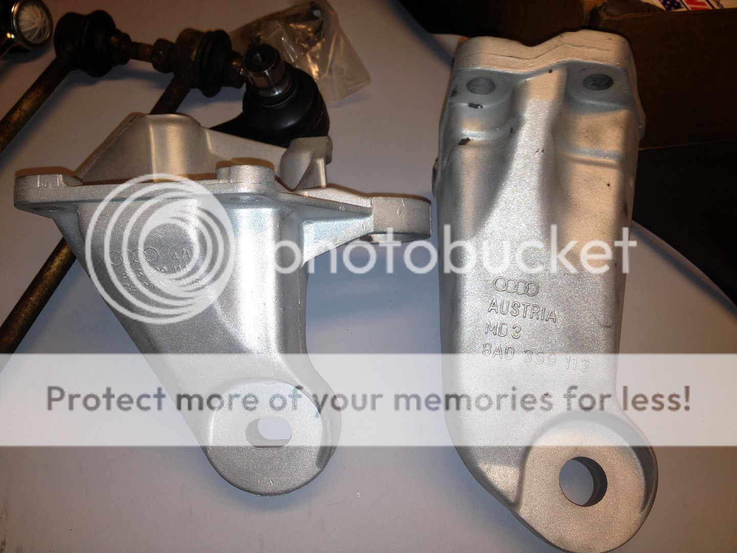

Dave K sent me sand blasted trans mount brackets since mine are broken...

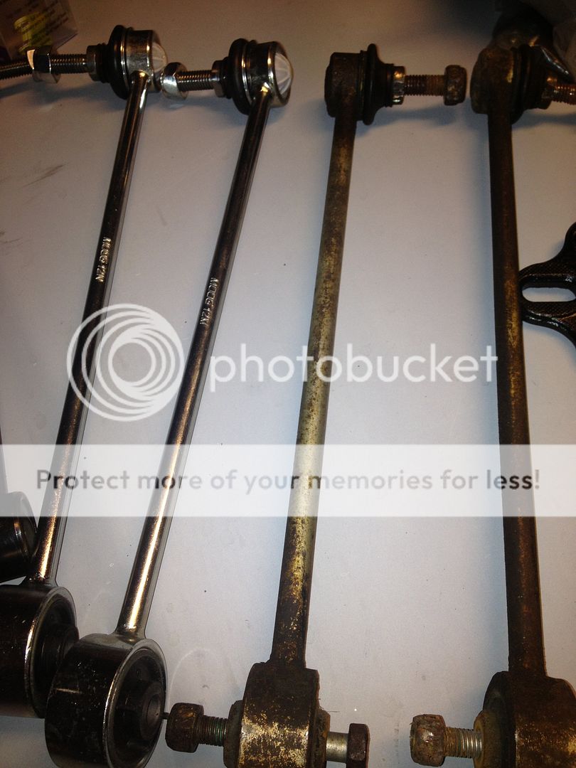

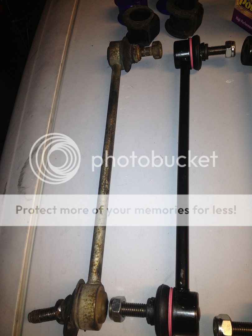

here are my new links with the old ones
new front links
new front links

As for those subframe bushings, coat them with some lithium grease, as well as the tube in the subframe. It will help keep things from rusting and corroding

Fuck you broken trans bracket!!!
