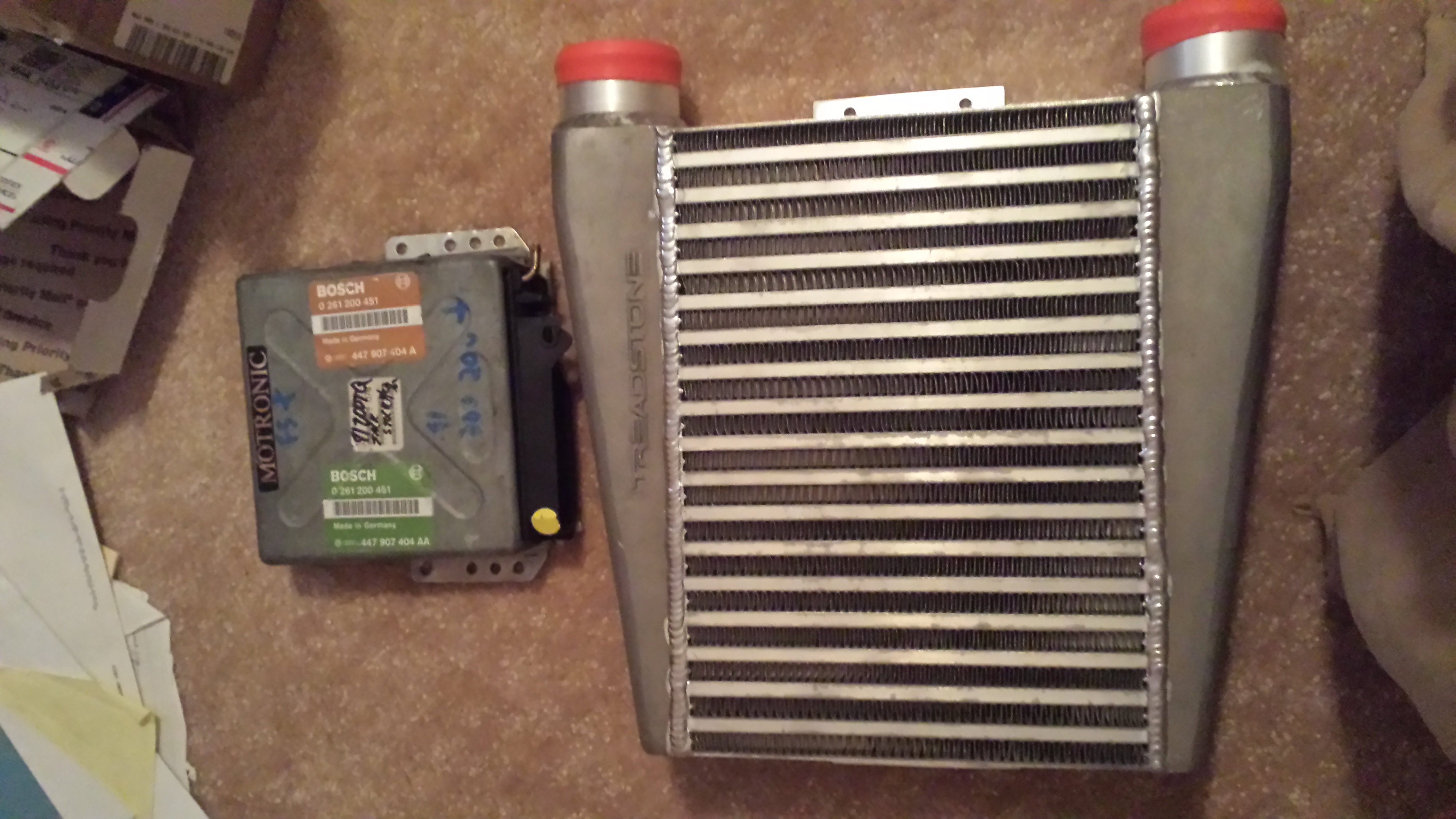

Thanks Chris I'll check the spring out in a half hour. Got this awesome treadstone today. Included ecu for size comparison
incredible quality for sure. No I have to wait on the piping to build the prototype.

- 20150626_174846.jpg (2.09 MiB) Viewed 28996 times
I was pretty happy with the construction of my Treadstone. Especially for the price.
That's pretty wide. Is that the one you ordered? or did they send you the bigger one on accident? i thought you were going with the smaller one?
confuse
EDIT: I guess going of ecu size that does look like the right size. Looks large for some reason
confuse
Ya it's the 9 inch long core not the 6 inch. It's smaller than the oem one I believe. When I opened it was like "wait this is big enough for 500 hp?" Lol its so pretty
