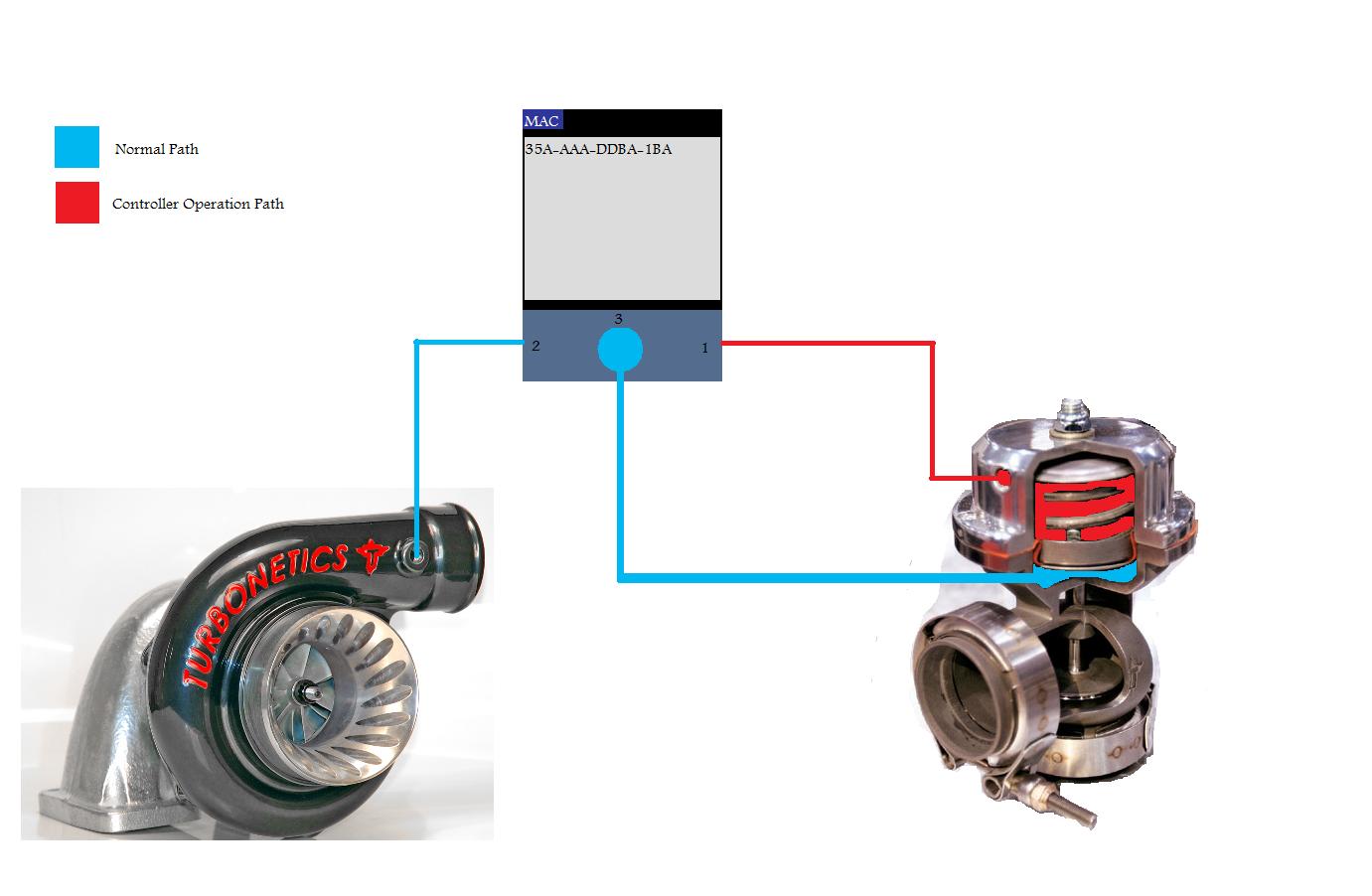

On a side note, really hoping the extra travel of the stock IC has something to do with my difficulty with controlling the boost (restrictive? ) but I did come across this illustration which I'd never seen before but believe it somewhat makes sense. the port numberin isn't representative nor did I make this picture. Does it seem logical for serup?
- EBC.jpg (76.81 KiB) Viewed 31083 times
