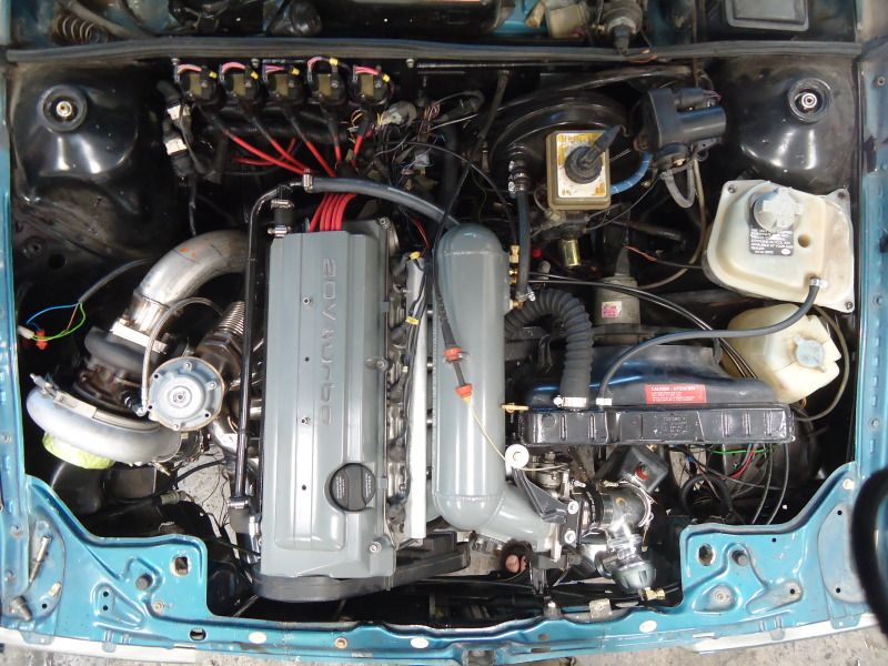

Ok, update time. Before anyone asks, no the car isn't going to be running tomorrow as per my previously stated goal. Being short a computer, fuel lines, FPR, WG, AWIC set up and oil cooler will do that to a guy. :) BUT! I do have a half decent update with plenty of picture whoring as always.

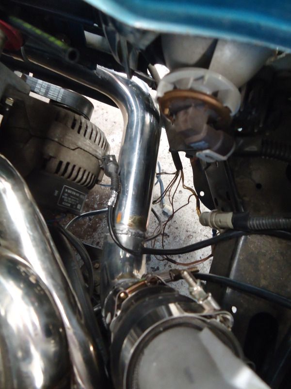

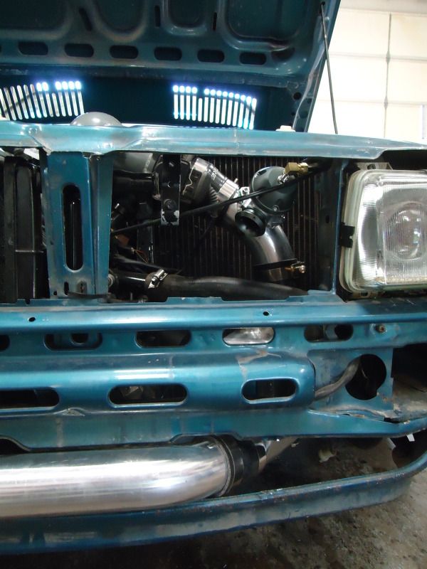

I finished up my Intake piping and got it all mounted (minus cleaning off paint pin marks)...
OH and please don't mind the EBAY BOV. :P

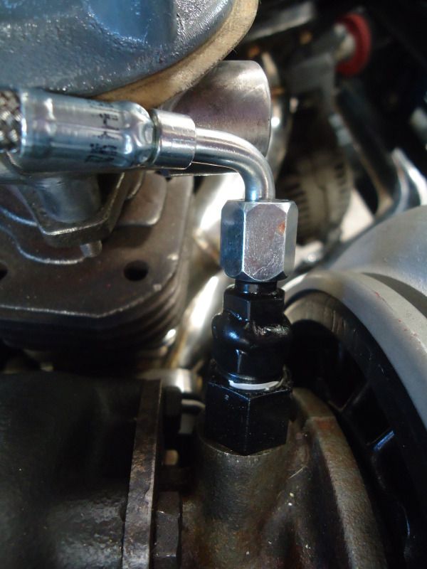

I also am almost finished up with my turbo oil feed lines with my crazy home made adapter. (Thanks derracuda for picking up my feed line for me!) OH and my adapter goes from : Random metric -> Inverted flare -> NPT -> -AN. :D ... ridiculous.
