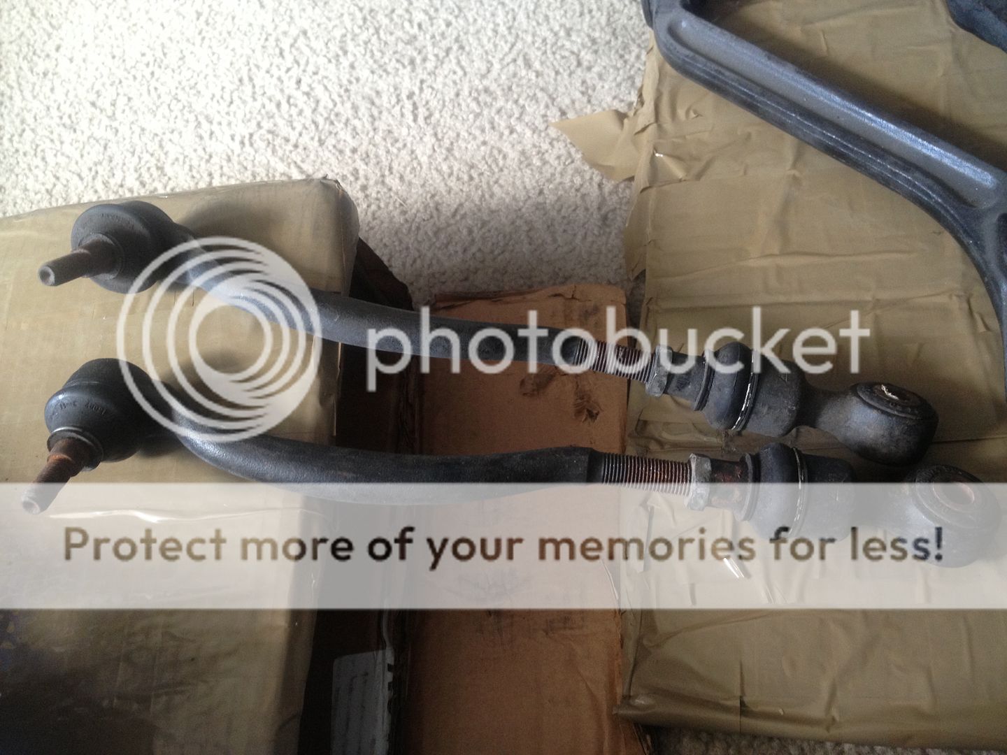

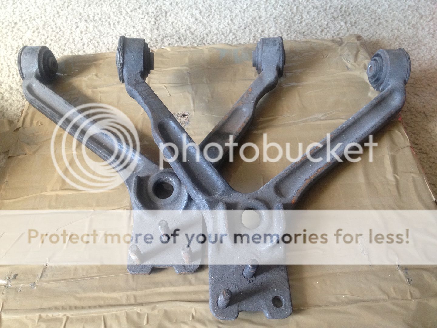

Got my front control arms and tie rods and my rear control arms in the mail today!!!! and i just ordered the Moog ball joints from Rock Auto that Nik sent me the link for. Thanks buddy.
now i can repair my squishy suspension.

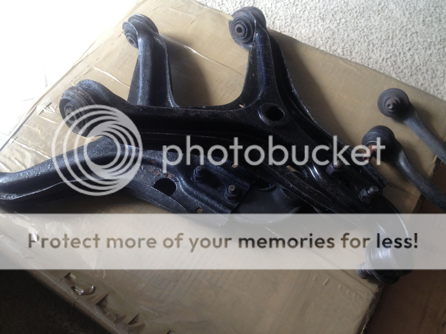

Got my suspension pics taken. Here you go guys.
supposedly has 5000 miles?

Re: 1990 CQ-Did a smoke test and found a leak-REPAIRD!
Looks more like 50,000 to me.

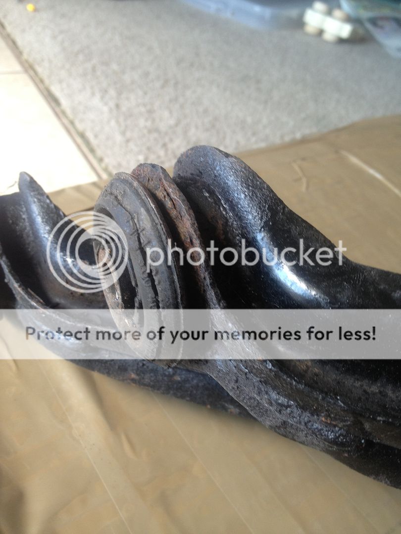

Re: Suspension and Vacuum leaks, built a Smoke Machine
So, are you planning on having those rear arms cleaned up at all? That is what the ones I did for Mike (audisport4000) looked like before I powder coated them.
Post by Kuma »
I would love to... Lack of funds is my constraint. I did However contact my senator and congressman. They called back!! Hopefully my social security gets expedited now.
