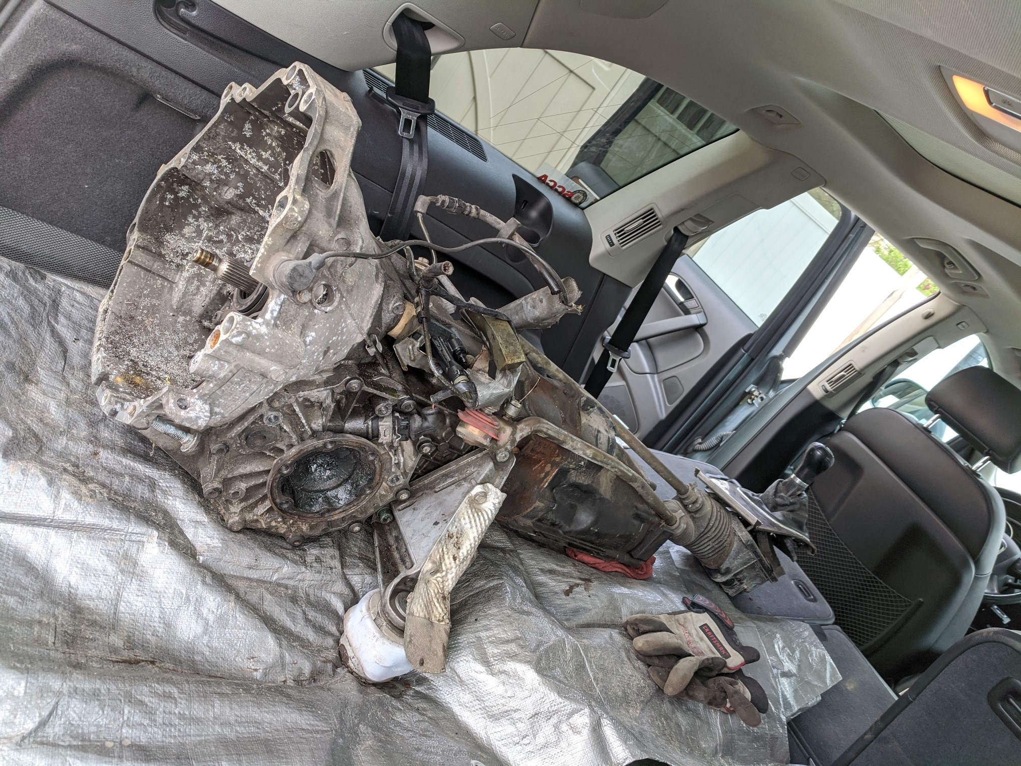

Might have found a local 01E 6spd for this thing....Fingers crossed...
Re: Eric's V8 CQ
Score! That will make a huge differencecuatrokoop wrote:Might have found a local 01E 6spd for this thing....Fingers crossed...

Yeah, for sure. It's literally about 10 minutes from my house. I've looked it up the best I can, and it seems that the A6 2.7T uses a 4.11:1 just like the CQ. A yard supposedly has a basically complete 2002 2.7 car, so I've got a message in to them and will call them tomorrow. I'm still working from home for at least this week, so I'll have time to go snag it and many of the needed parts (it has the correct rear drive flanges, score!). Or I could grab the whole car and strip it myself. At least then I know nothing would be broken. We'll see what happens. I've also located the A8/S8 calipers, but not the carriers, necessary to upgrade the rear brakes.

Just put half payment down to get the yard to pull the transmission, shifter (complete) and entire rear diff. They wouldn't just do the drive flanges. So, guess I'll scrap that diff out at some point. I'll have to call the other yard that has the 4kq drive shaft next, then order the mounts from Marc.
Re: Eric's V8 CQ
I don't think you need the rear diff. just a 4k driveshaft
the B5S4 rear diffs are b4 sized - not coupe sized

So, I need to call the yard first thing in the morning. I figured out that the diff has 108mm drive flanges, not 100mm. Don't need those.
cuatrokoop
- Posts: 271
- Joined: Thu Mar 07, 2013 11:27 pm
- Location: Findlay, OH
Re: Eric's V8 CQ
So this happened today...
- 01E 6spd
- 01E.jpg (979.53 KiB) Viewed 187694 times
