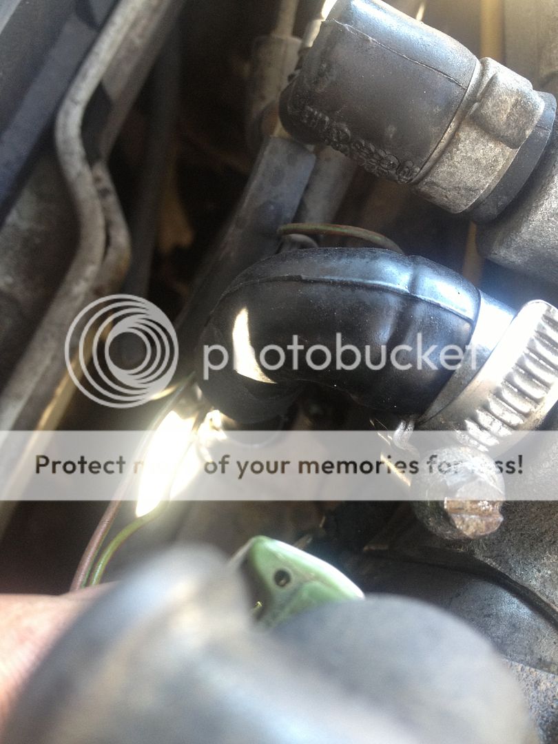

Found my Vacuum leak.
Well, one of them. i am going to replace this part first then i will redo the smoke test.
So far this is my only update.
but yay!
but yay!

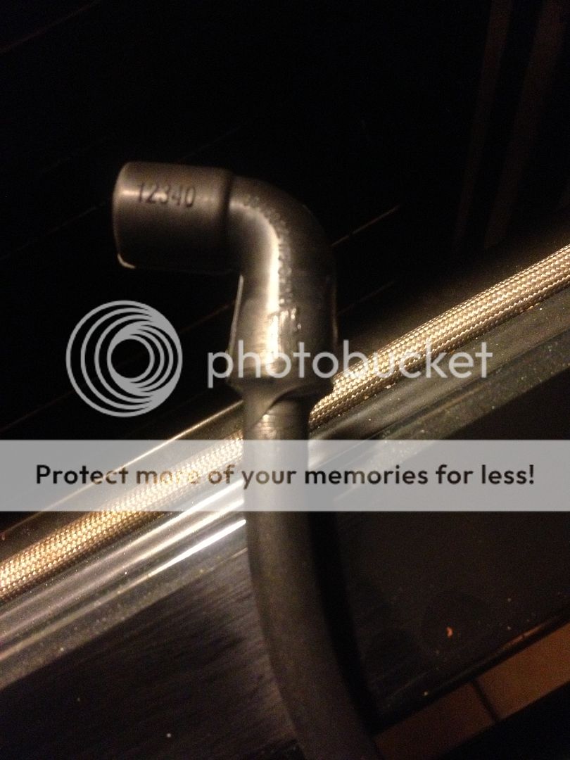

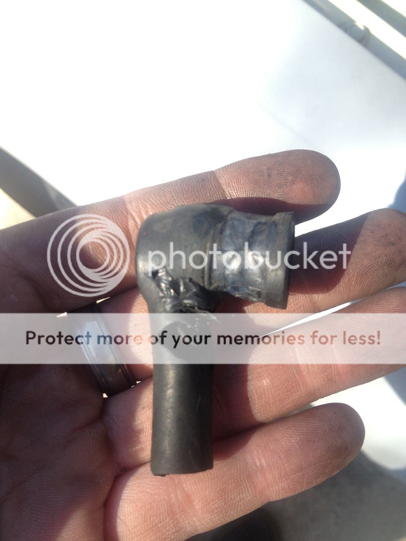

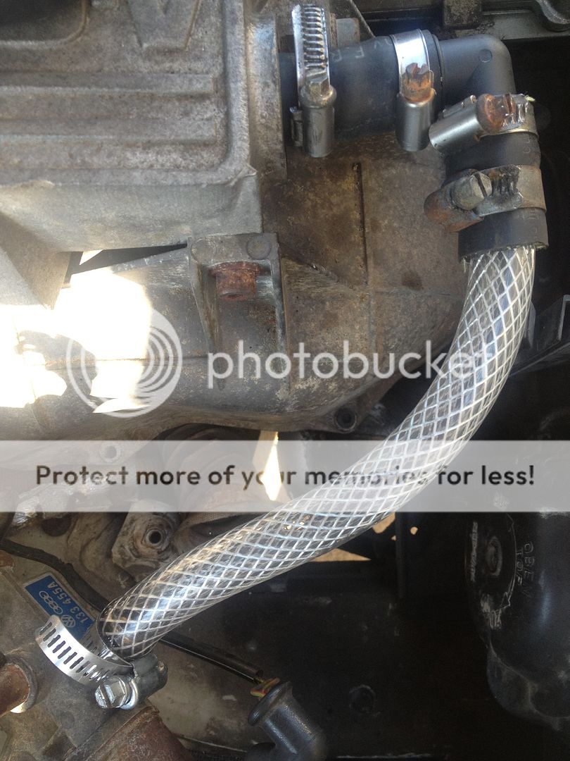

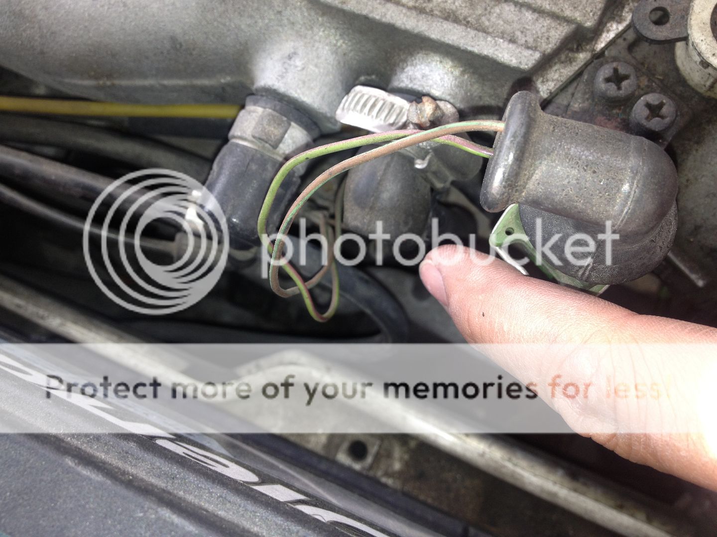

Re: 1990 CQ-Did a smoke test and found a leak, Yay.
this is the culprit. Dont know what its called. I repaired it with the one i made and bam. i have great idle.
after i installed the new hose with new clamps.
had to make a new hose for temp until i can get more time to work on the car, but here ya go. Dont worry, i already got the talk from Dave.
