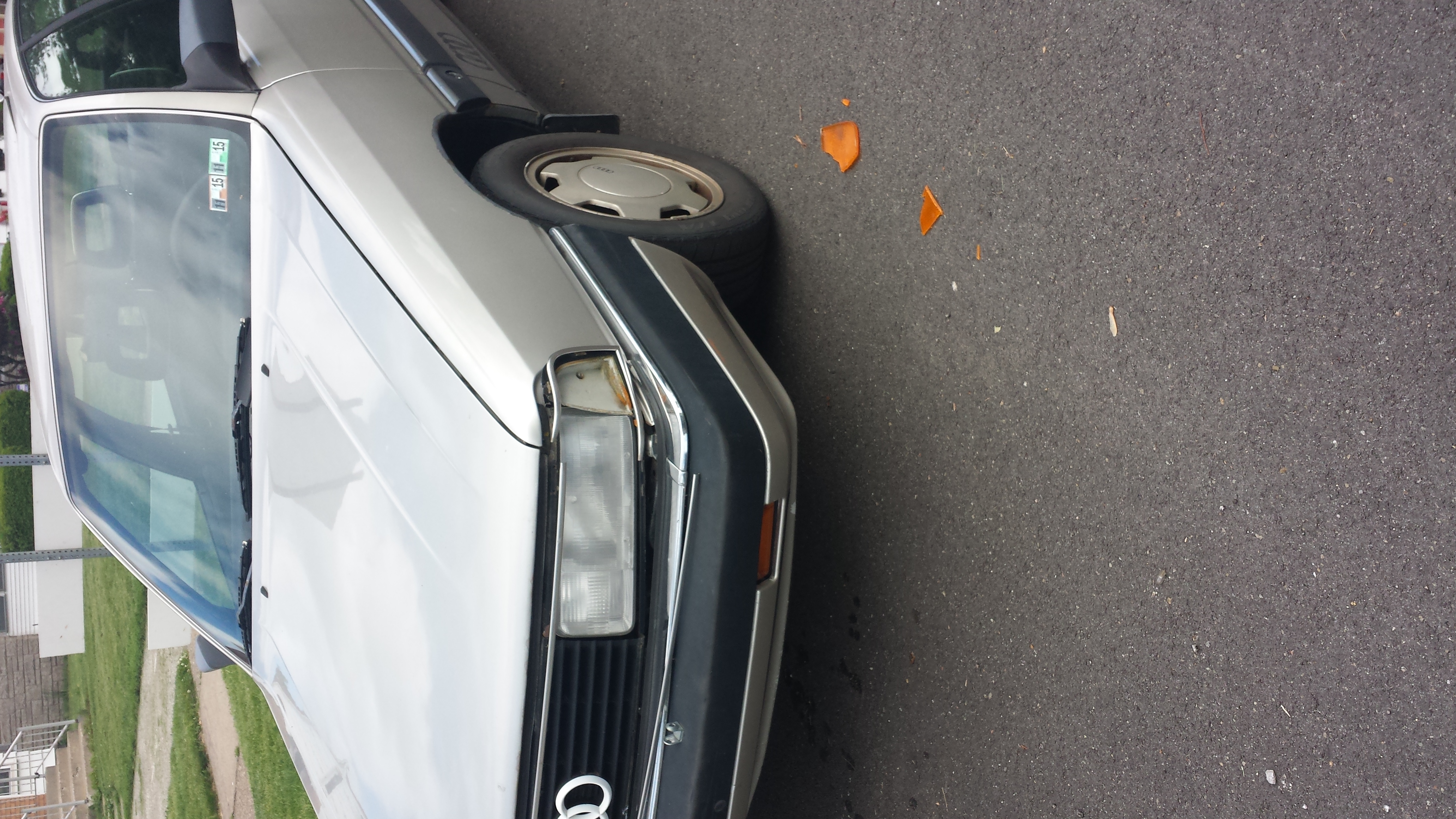

Ever so slightly off subject. My degenerate neighbor did this. He parked his trailer backwards for the first time in his life last night, probably after doing this.
Below us 20 minutes after I found it lol :D

Dang that was quick! I was about to say I have a spare headlight you can have, but it looks like you've got your bases covered.

Lol thanks. Maybe I'll park it by the guy's driveway and pm you next time he hits me :)
I fixed it where it happened so the guy could watch me while he was home. He's a dead beat divorcee with the 3 worst children I've ever had the displeasure of overhearing fight each other in their front yard and through their thin walls. No hard feelings tho :D
