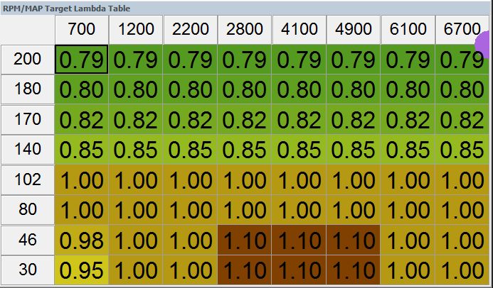

I've been getting boost pretty solid. Convinced myself that ~18 psi is only 14 psi at sea level (~200 kpa) so I should be good. Last week was a pretty solid 175 kpa.
The downside is that I am seeing >70% inj DC at times so I am wondering if I can trim out some fuel...I've read a bunch of different ideas about lambda targets but I'm still not 100% on where I stand as far as boost, compression, and protecting the cast pistons.
Here is what I'm thinking (the 1.10s are for my commute, pretty smooth), thoughts?

Way way way too rich. Shoot for 0.9 up to 200 kpa. 0.85 if you really want to be conservative.

So I've heard similar numbers, am I over thinking that 10.2:1 compression shifts the curve a bit? It'd be great if I'm being stupid and have plenty of injector for E85 and 200kpaloxxrider wrote:Way way way too rich. Shoot for 0.9 up to 200 kpa. 0.85 if you really want to be conservative.

Well, I'm not exactly an expert on tuning E85 just yet as I haven't done it myself, but consider that Hank is running .8-.82 lambda at 40 psi on E85. If anything, he is running higher lambda values with it than on gas. That chart does not seem to take boost into account either. For example, if you try to run .85 lambda on gas at 30 psi, you might have some issues. It would indeed probably make the most power there, but it'd likely be pretty hot.
So my point is, wait for others to respond since I'm new at E85, but I say you can lean it out the way I mentioned. I think 0.9 everywhere (possibly even leaner on the really low boost side) will do you good up to 200 kPa to be on the safe side.

So, I've toned down my lambda targets and things seem to be working fine. Still looking for slightly better spool but I think I have a few leaks which are hampering that effort.

Remember, not that it matters a bunch, but I am quoting lambda on the gas scale, not on the ethanol scale. If you do lambda on the ethanol scale, it is not .8-.82 lambda on the scale, and not quite as lean as it appears. This is the same reason .71-.75 lambda on the gas scale is rich misfire city if you are using lambda on the gas scale.
Lambda is lambda as long as it is 1.0:1 lambda.

FWIW, .89ish at 200ish seems to be doing fine.
