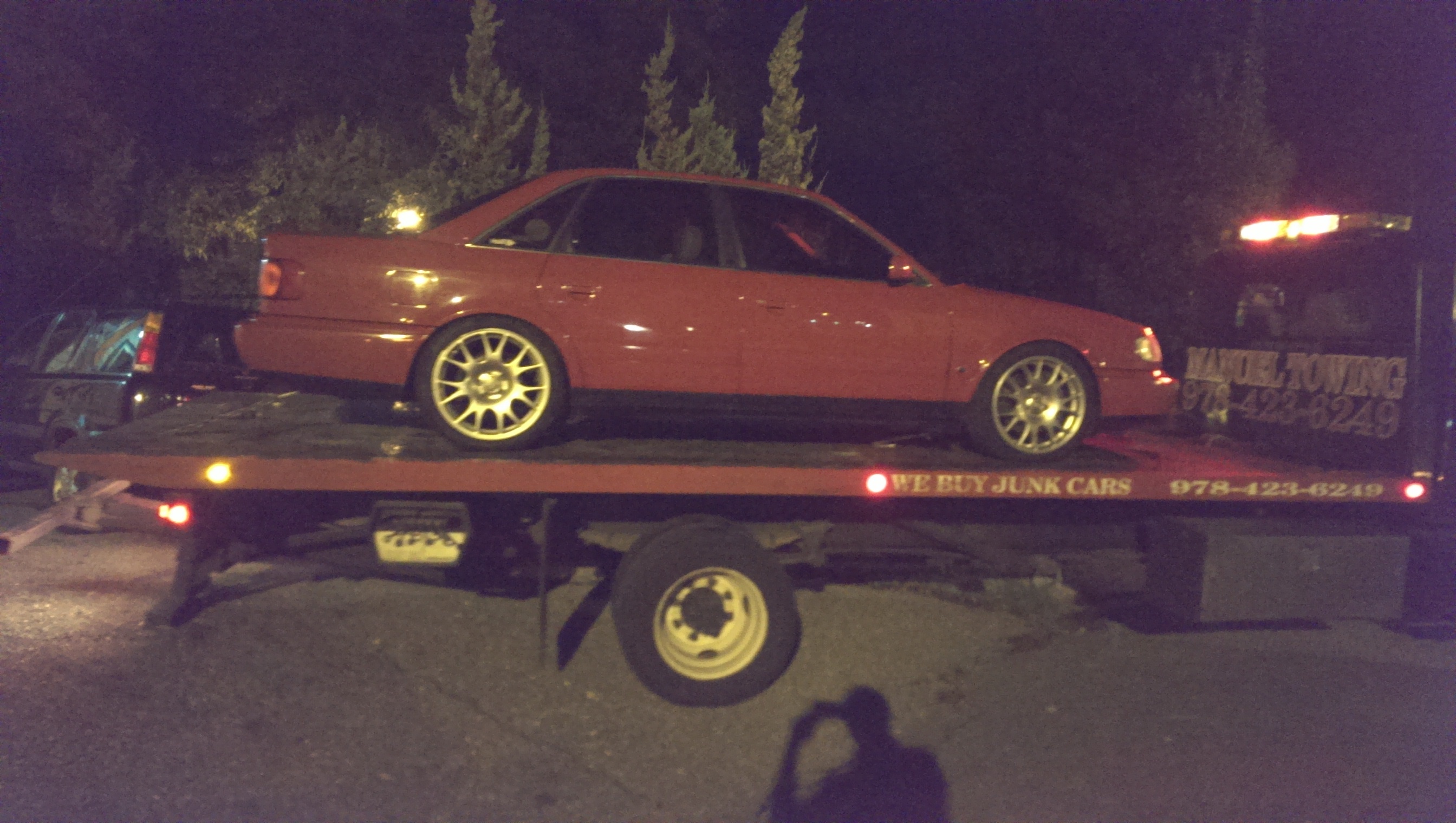

Re: A tale of Rubí... Late night transport...
Ruh roh
This better stay on...
Sent from my HTC One using Tapatalk 4
