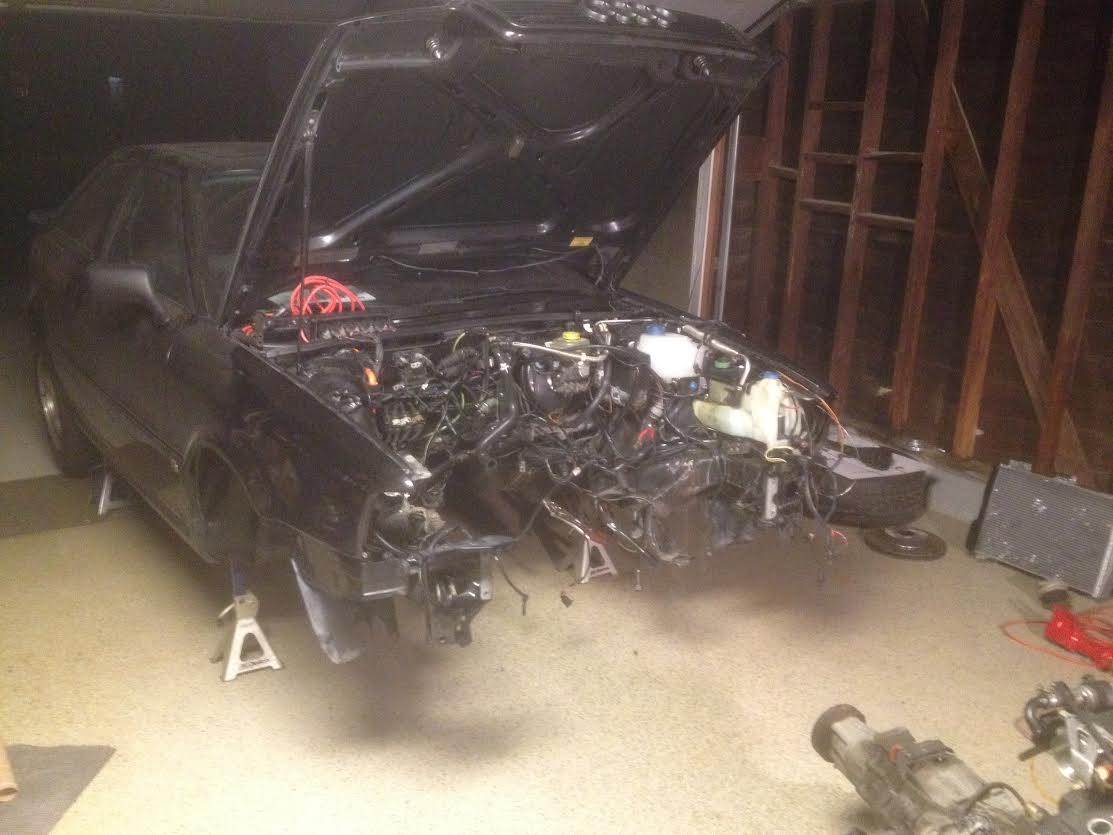

Re: another S2 conversion
Posted: Wed Aug 19, 2015 11:32 pm
by varia
i pulled the engine out. now i can work on the exhaust/turbo swap and the crank seal/sensor
I have to really wrench on it, cos that guy, Dave he is really pushing it :D

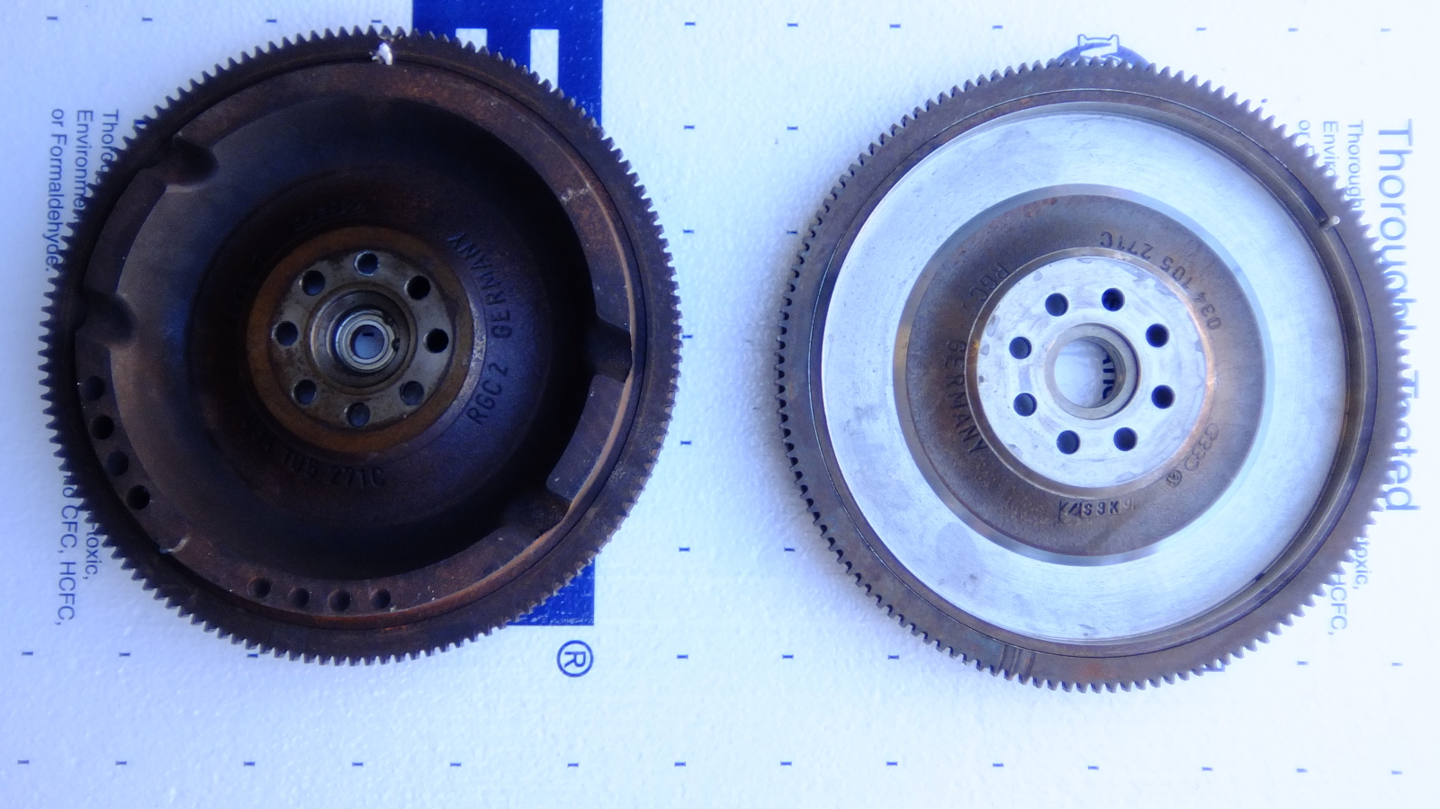

Looks like my flywheel and turbo housing will be done, so I can continue working on it. I hope it will be running by the end if this week.

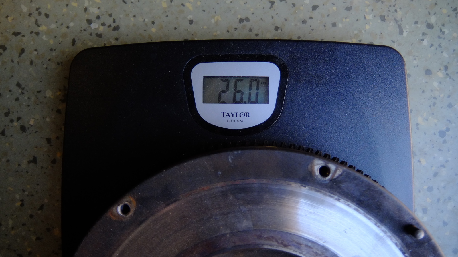

Posted: Thu Sep 03, 2015 5:33 pm
by varia
Thank you Jim!
Got the flywheel back, it lost 8 lbs.
Not the biggest diet ive ever seen, but healthy enough for my setup
Re-surfaced, balanced.

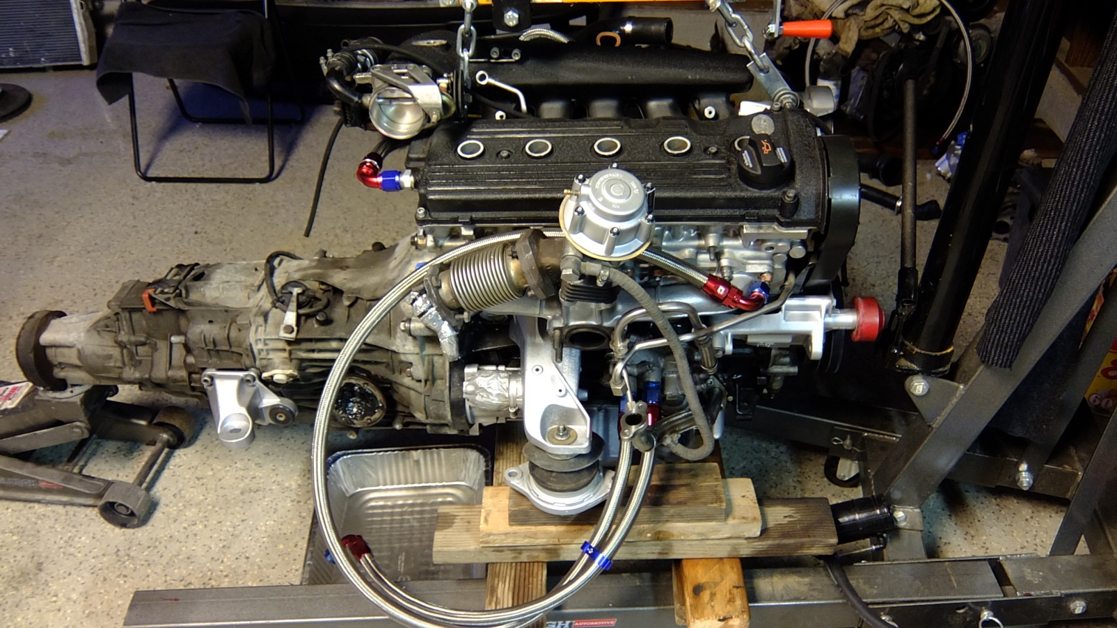

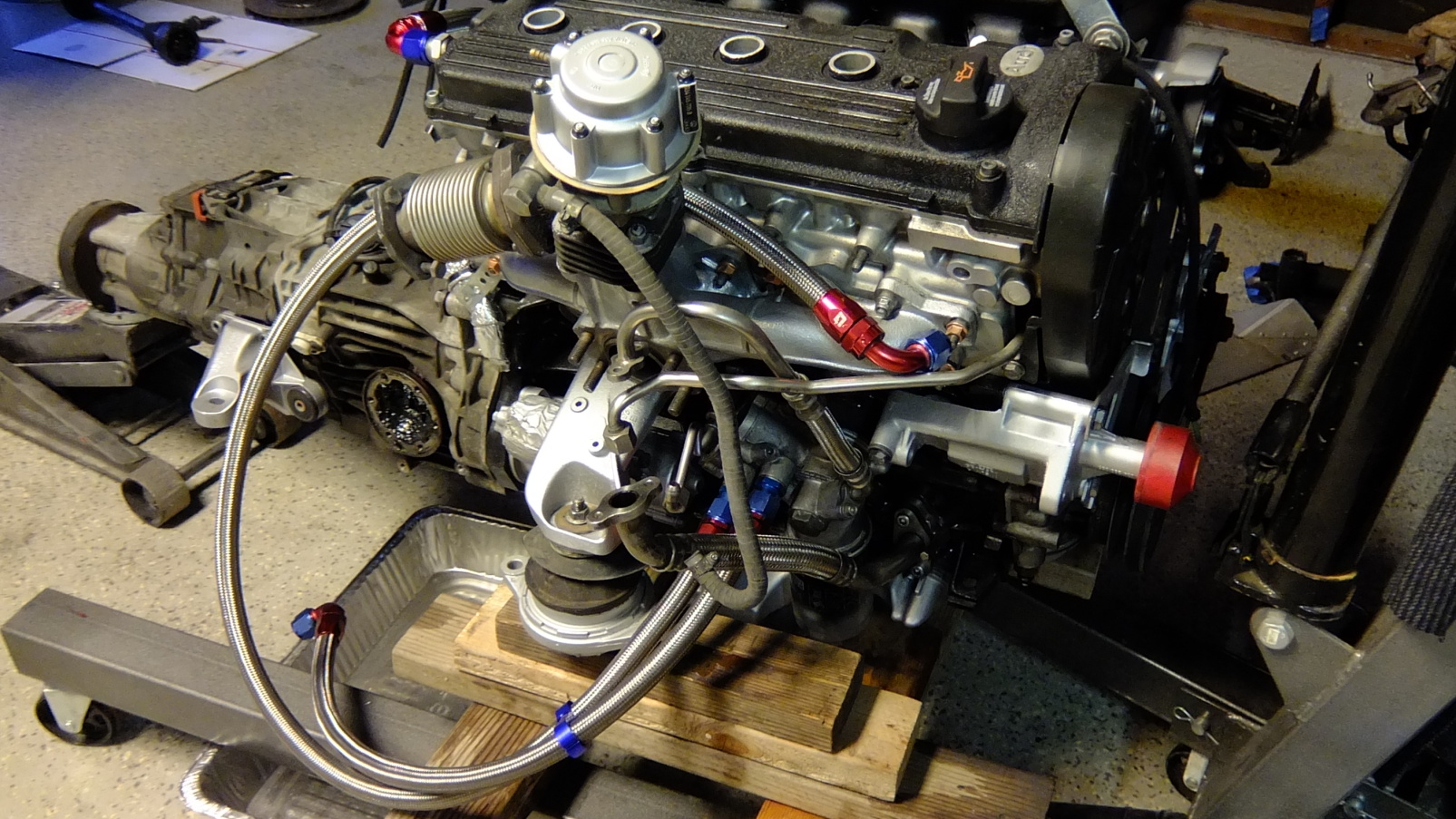

Posted: Sun Sep 06, 2015 6:54 pm
by varia
installed a new NTC IAT sensor, had to tap a tread
Cleaned and painted the tranny
Not much i could do....
Posted: Mon Sep 07, 2015 2:51 pm
by 90quattrocoupe
I like the bracket for the crank sensor bracket. :D You might want to change the plastic zip tie out to stainless ones.

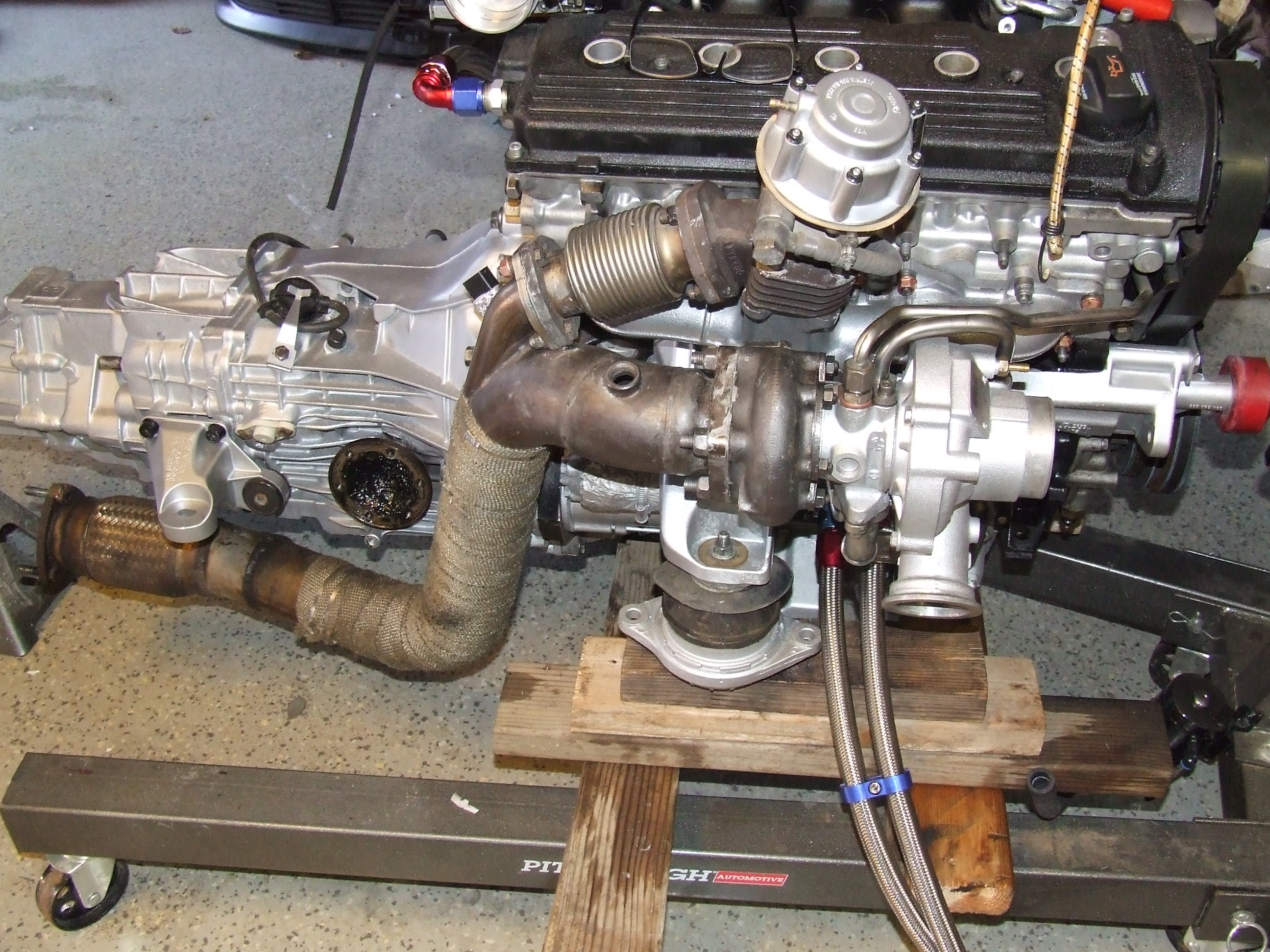

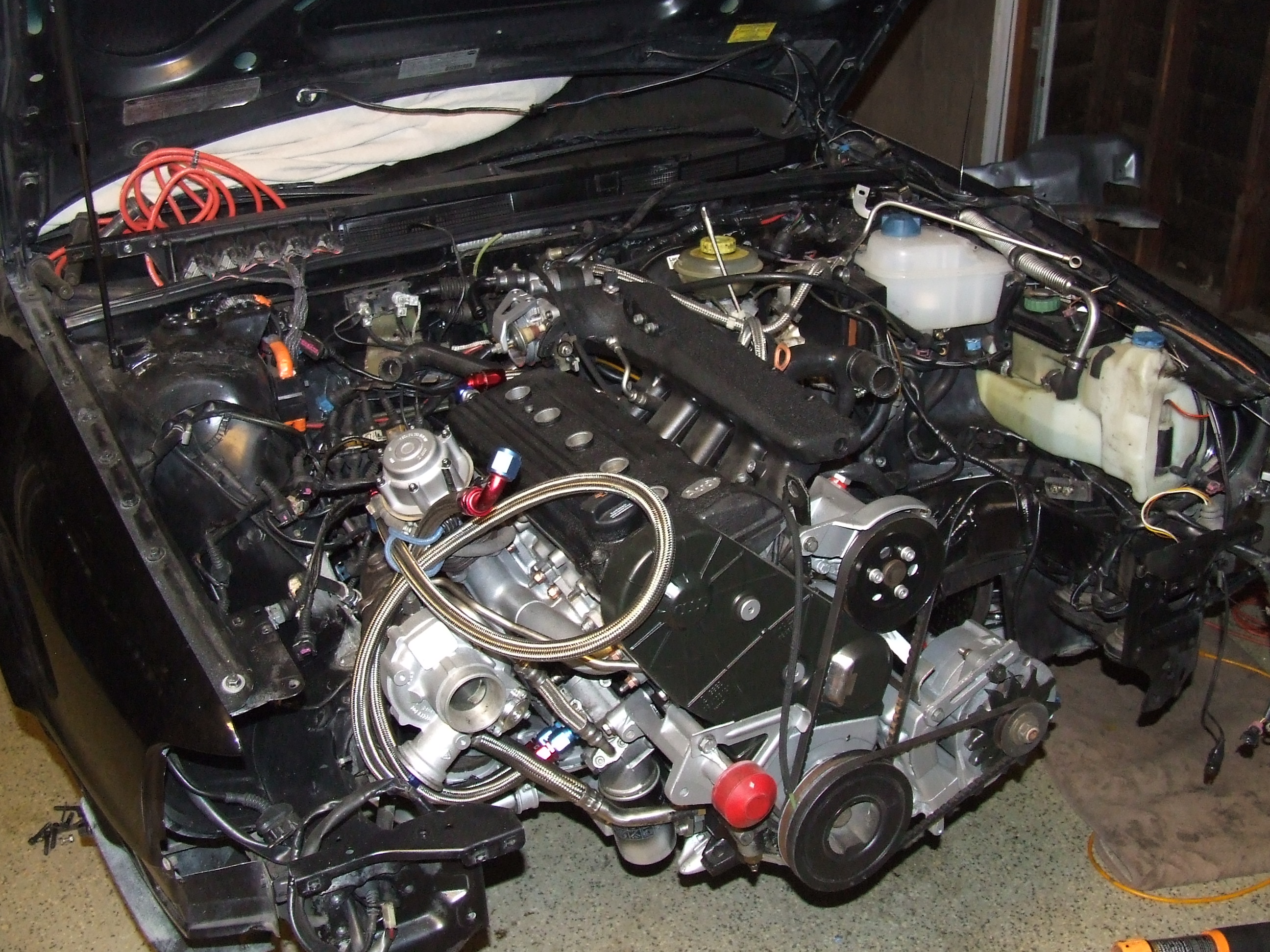

Posted: Wed Sep 09, 2015 1:34 am
by varia
Turbo bolted on:
engine bolted on:
