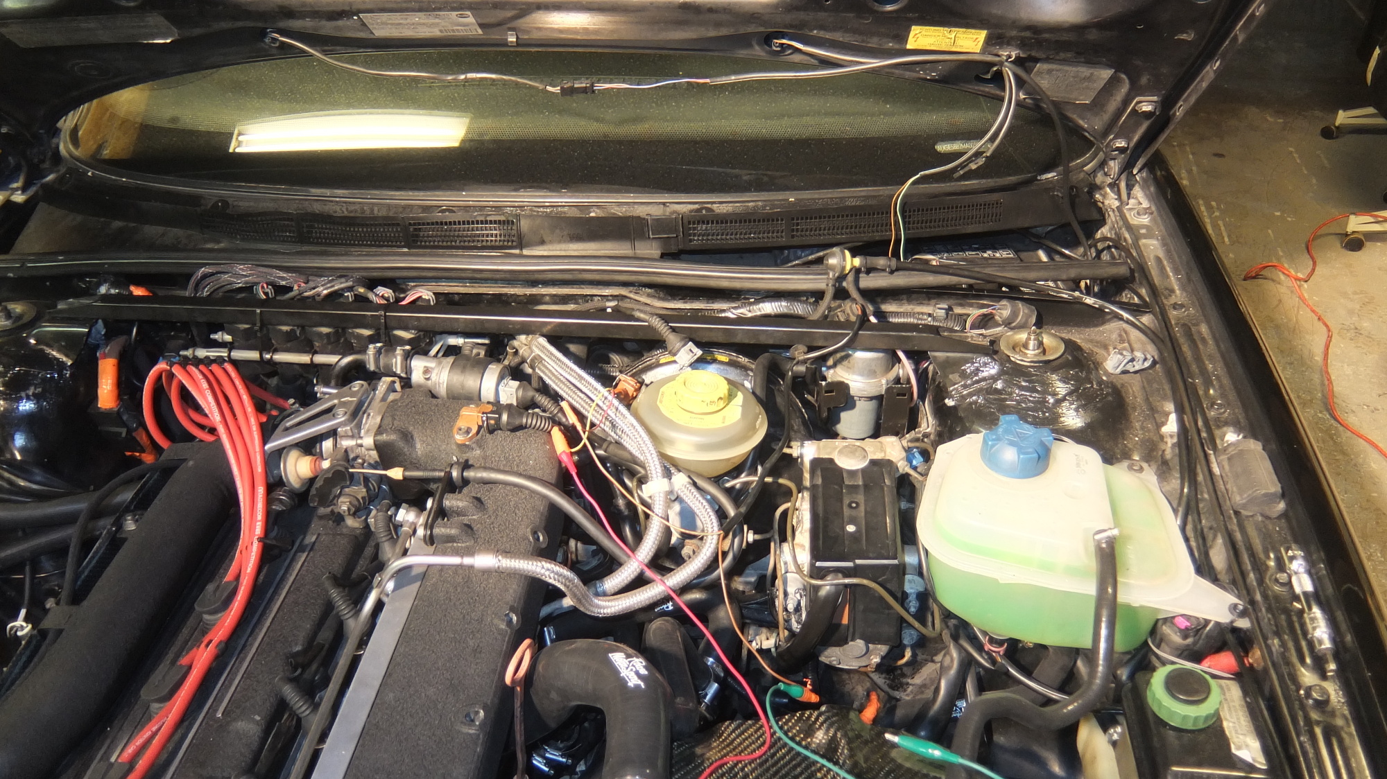

Still dealing with the vacuum booster leak (new is coming) but till i did a vacuum pump test setup.

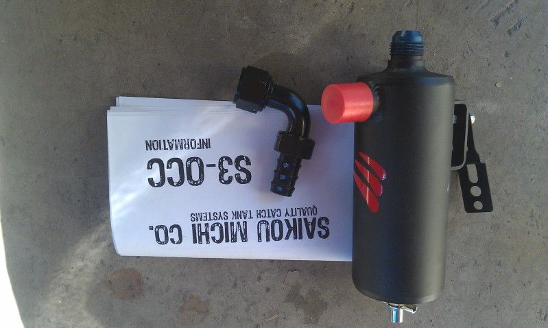

While im there i will install a new 19 rows oil cooler and a new catch can (saikou S3-OCC) and re-routing my breather system.

I've looked at those cans before, seem like a good product.

Mcstiff wrote:I've looked at those cans before, seem like a good product.
I think so too. I wanted a simple but good, and affordable solution. Talked a lot with JP Jnl about it, and with this, later i can upgrade it to the next level.

Saikou makes nice stuff, lots of 944 guys use their catchcan. I'll have to order one in the future.

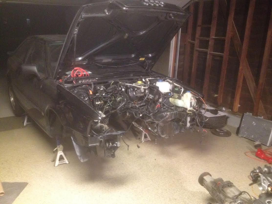

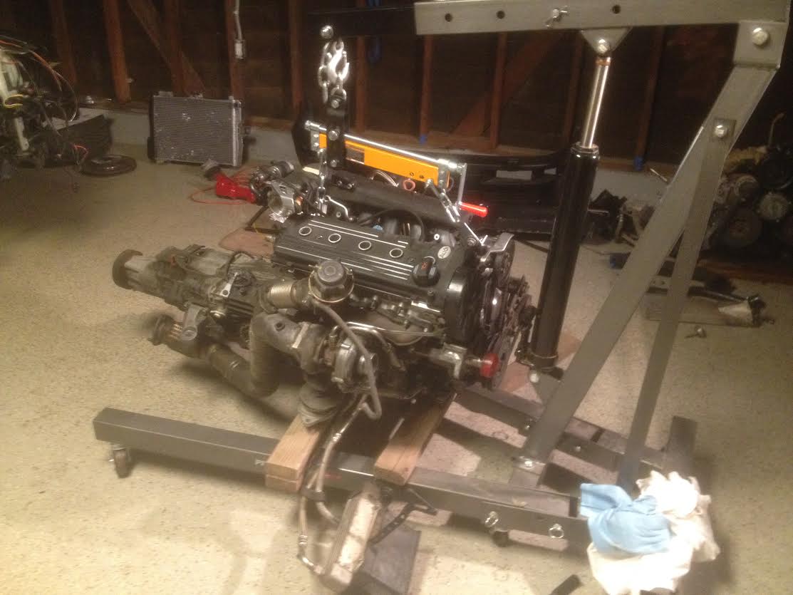

i pulled the engine out. now i can work on the exhaust/turbo swap and the crank seal/sensor
I have to really wrench on it, cos that guy, Dave he is really pushing it :D

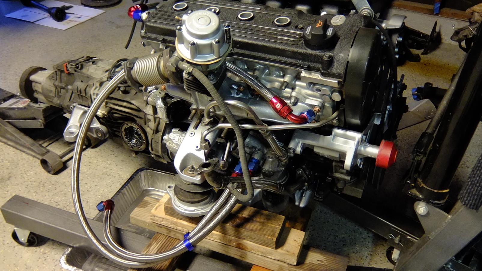

Made some progress:

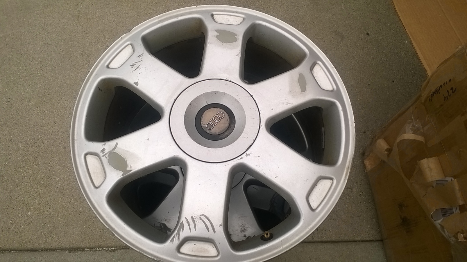

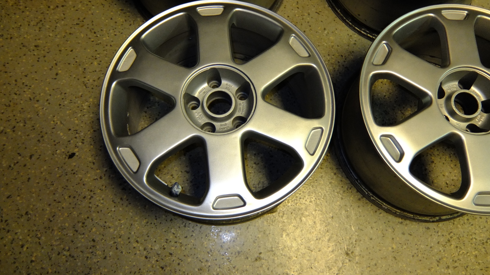

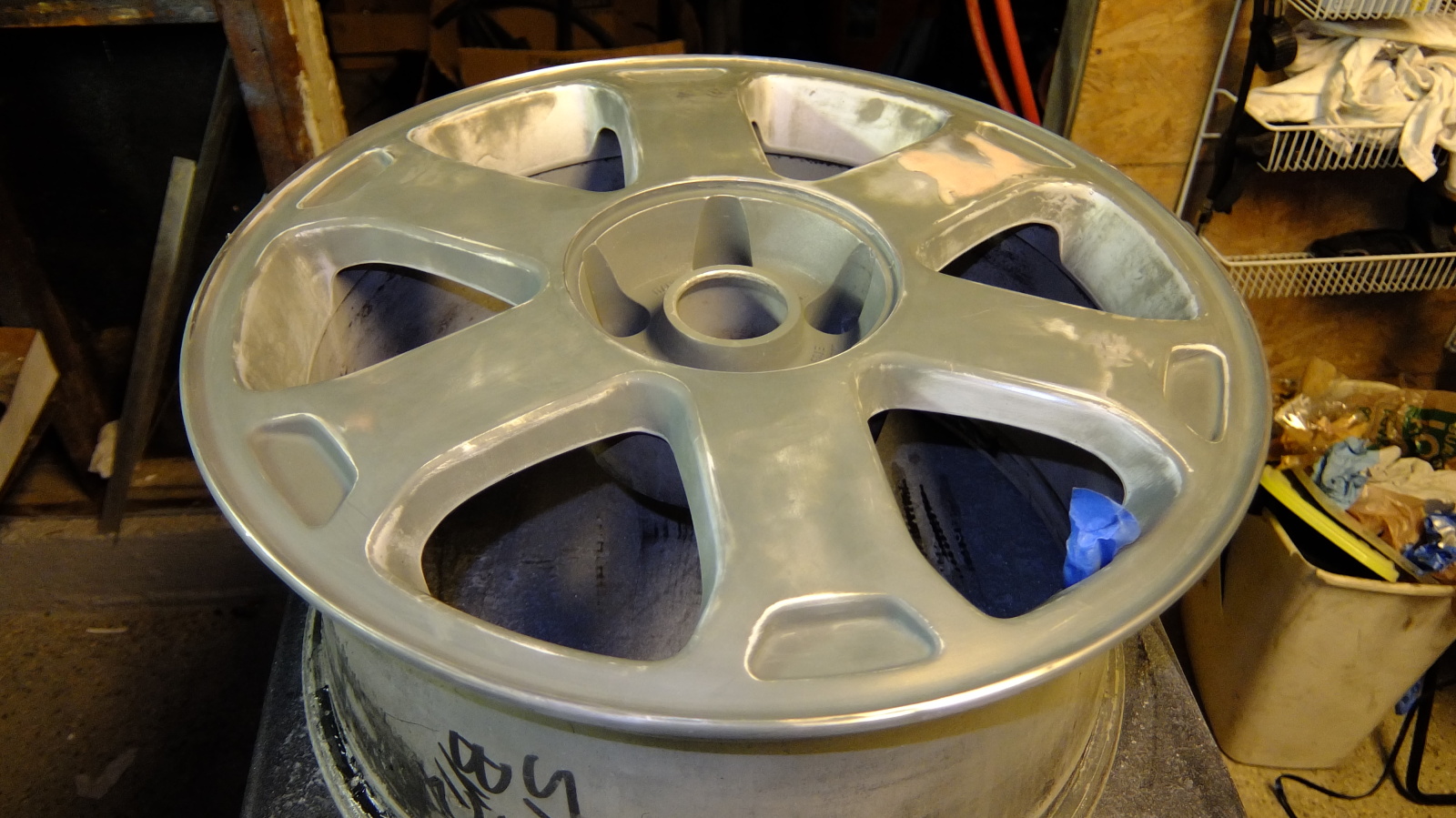

I got a pretty abused set of S6 avus wheels
i had a few hours, so i refinished them
¯\_(ツ)_/¯

90quattrocoupe
Posts: 269
Location: Long Beach, CA.
Re: another S2 conversion
Post by 90quattrocoupe »
Wheels look good, Chris.

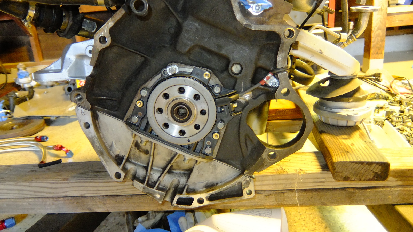

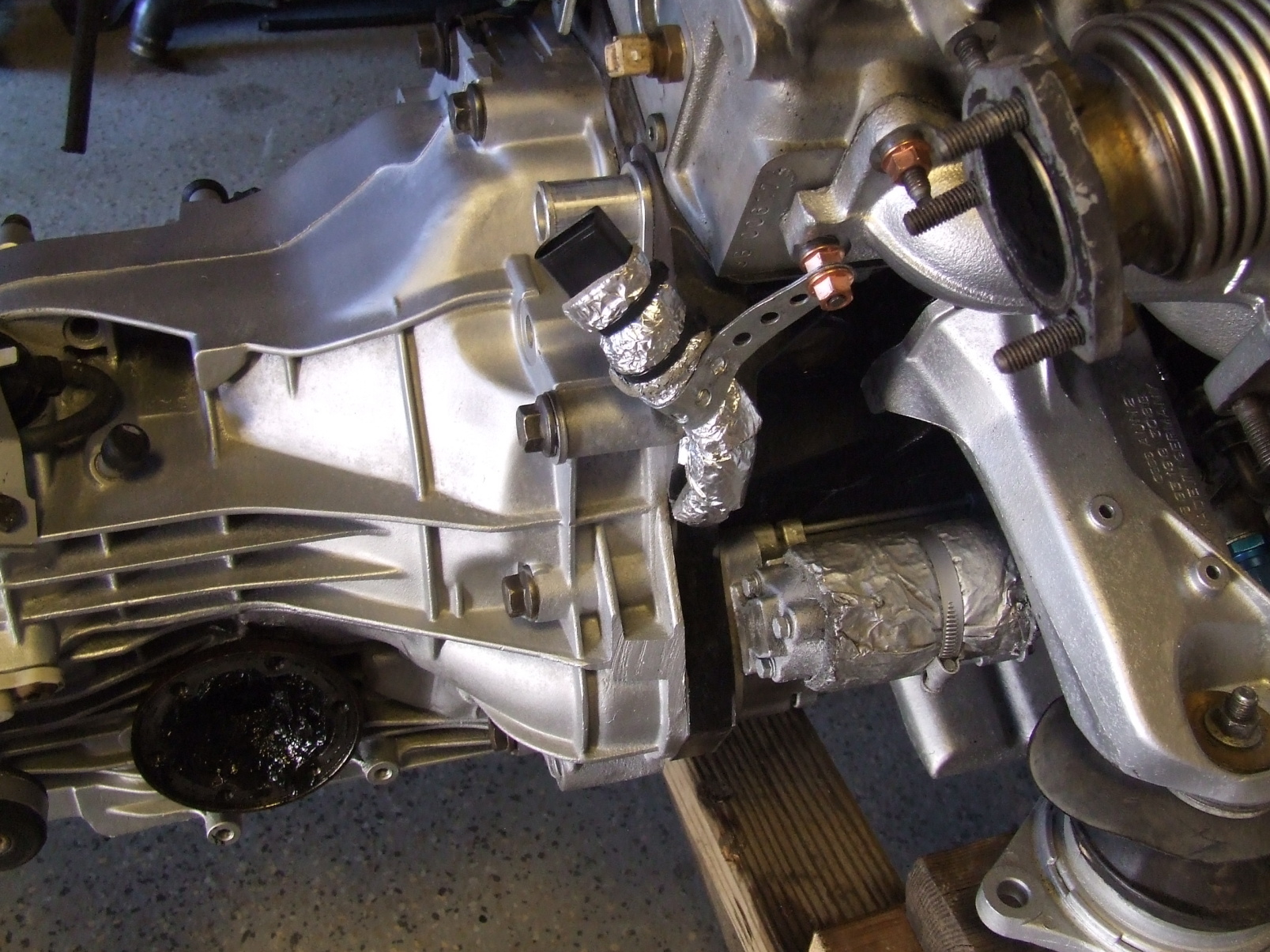

Posts: 2144
Now that's a crank trigger. Nice work.

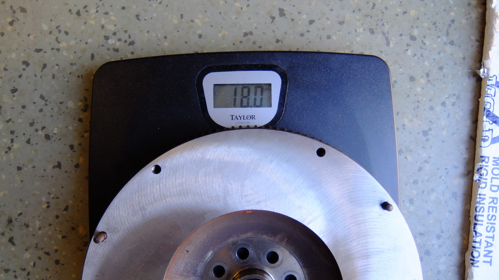

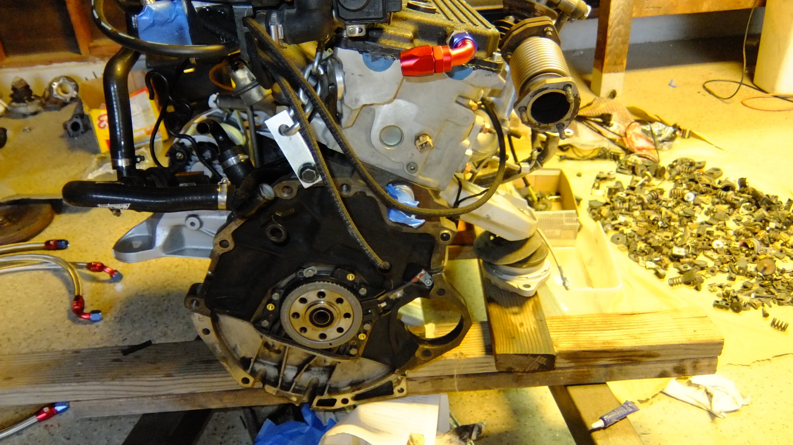

Got the flywheel back, it lost 8 lbs.
Not the biggest diet ive ever seen, but healthy enough for my setup
Re-surfaced, balanced.
¯\_(ツ)_/¯

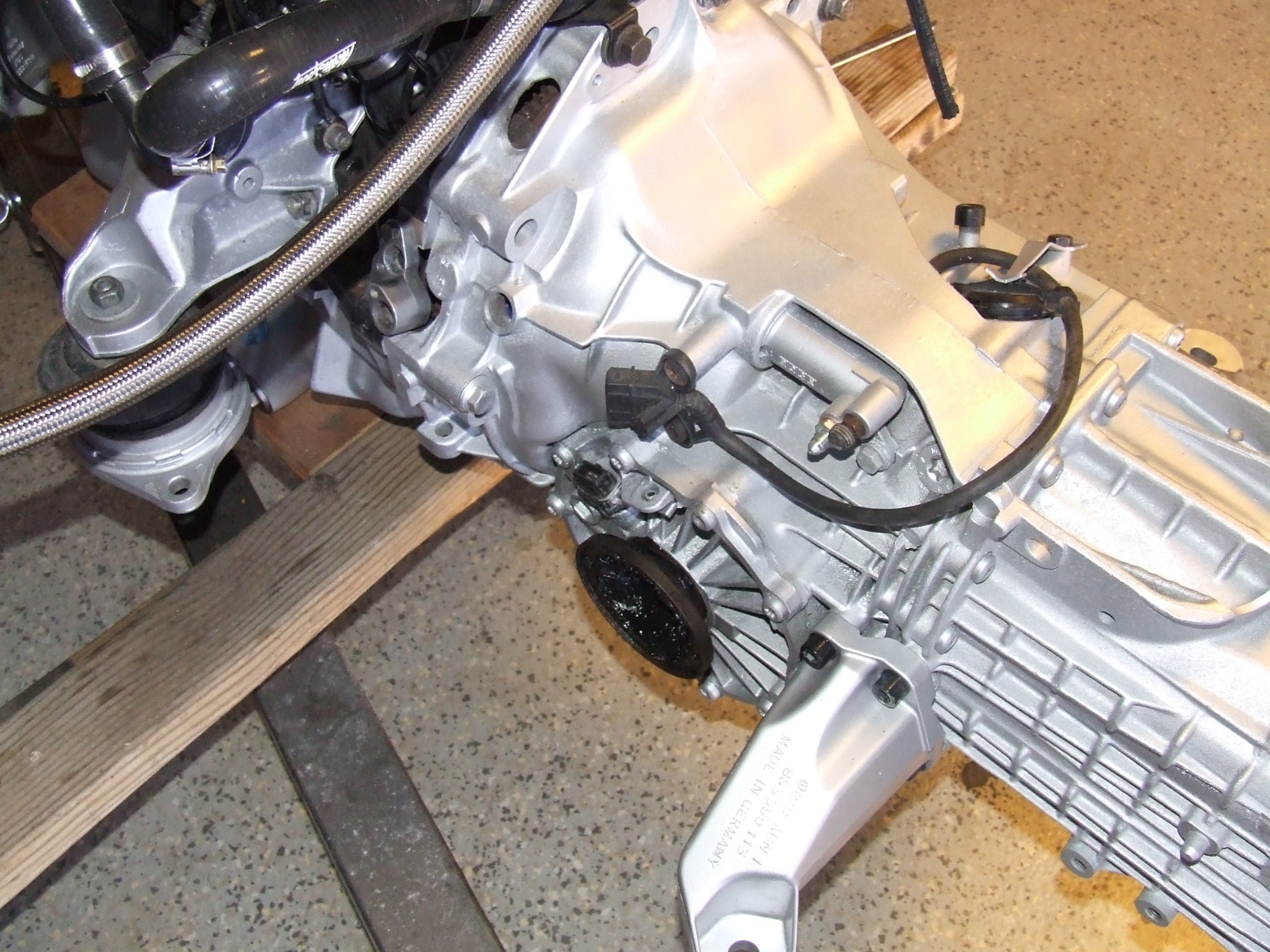

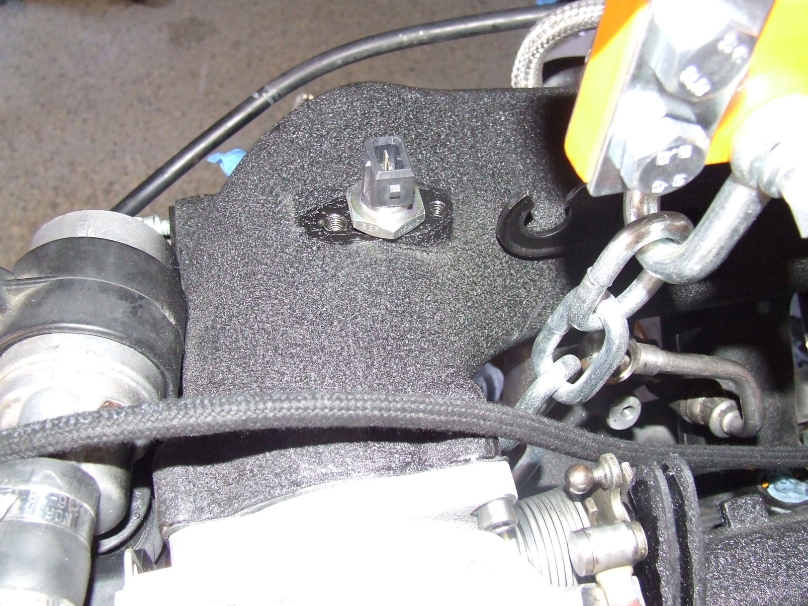

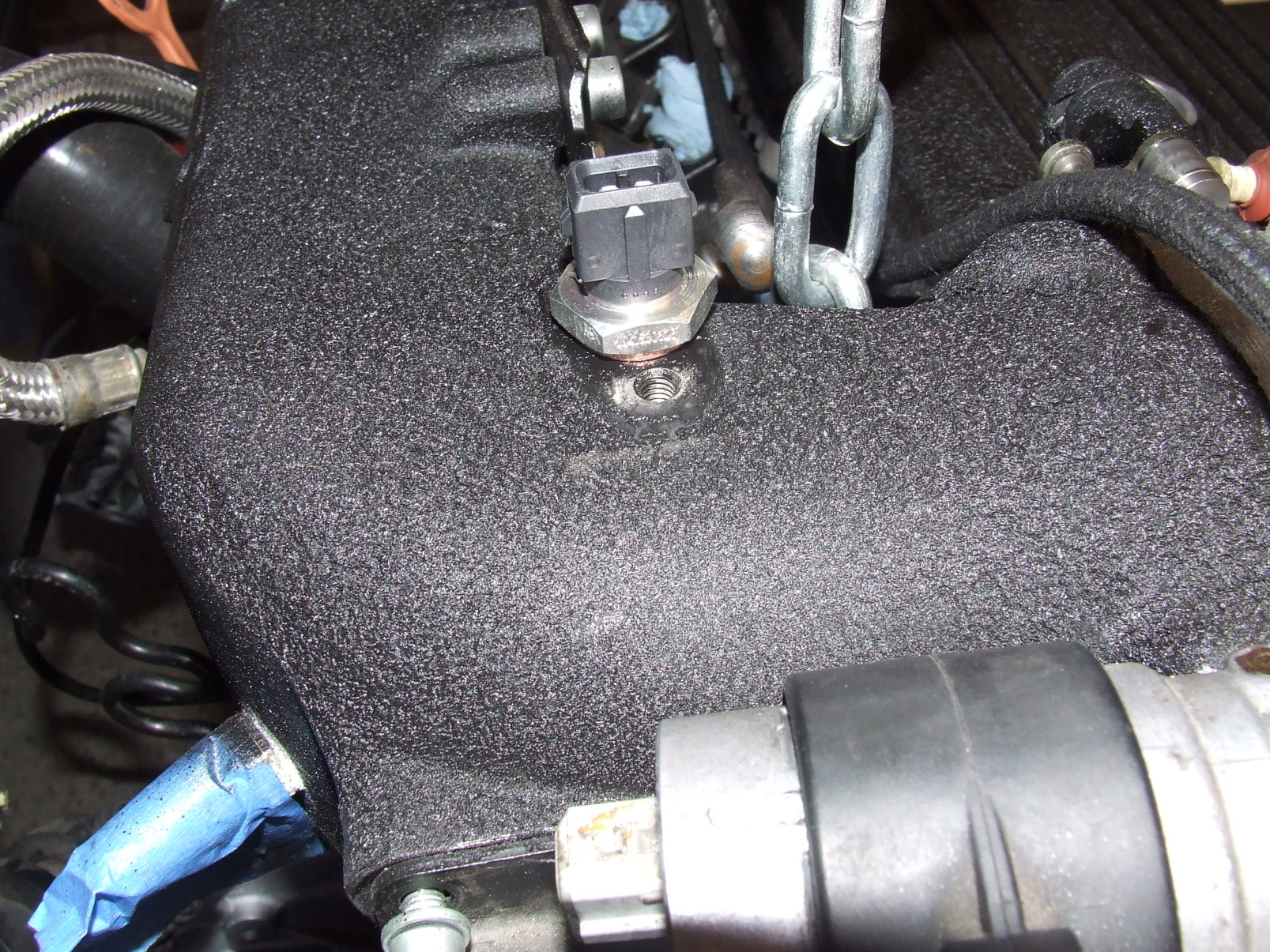

installed a new NTC IAT sensor, had to tap a tread

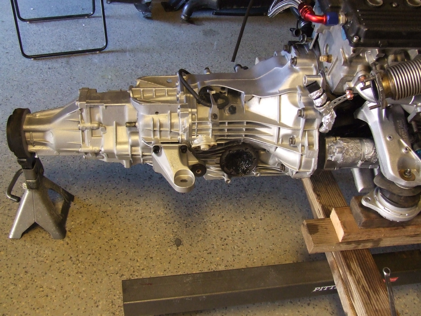

Cleaned and painted the tranny
Not much i could do....

90quattrocoupe
Posts: 269
I like the bracket for the crank sensor bracket. :D You might want to change the plastic zip tie out to stainless ones.

varia wrote:its a usa 1991 cq. the plate came with the taillight inner section
Cool, well you managed to get a 1991 'J' reg plate so it matches the year of build perfect! :-)
That's looking very spangily! How did you clean up the transmission? What product do you like to use?
'91 200 20v TQ - Pearl the leggy old girl - 242k miles
'61 Austin mini - rusty barnfind racecar
varia
Posts: 354
Location: Los Angeles
Post by varia »
I cleaned it with soft scrub + 3m scotch brite; rinsed it, then let dry.
I used VHT cast aluminum caliper paint, nice coverage and super fast dry time, not too sensitive for oil residue
¯\_(ツ)_/¯

Nice work , That tranny looks like it was cast yesterday.

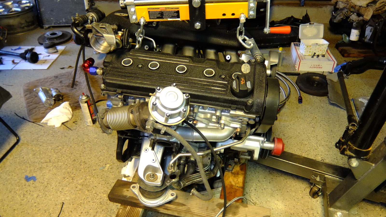

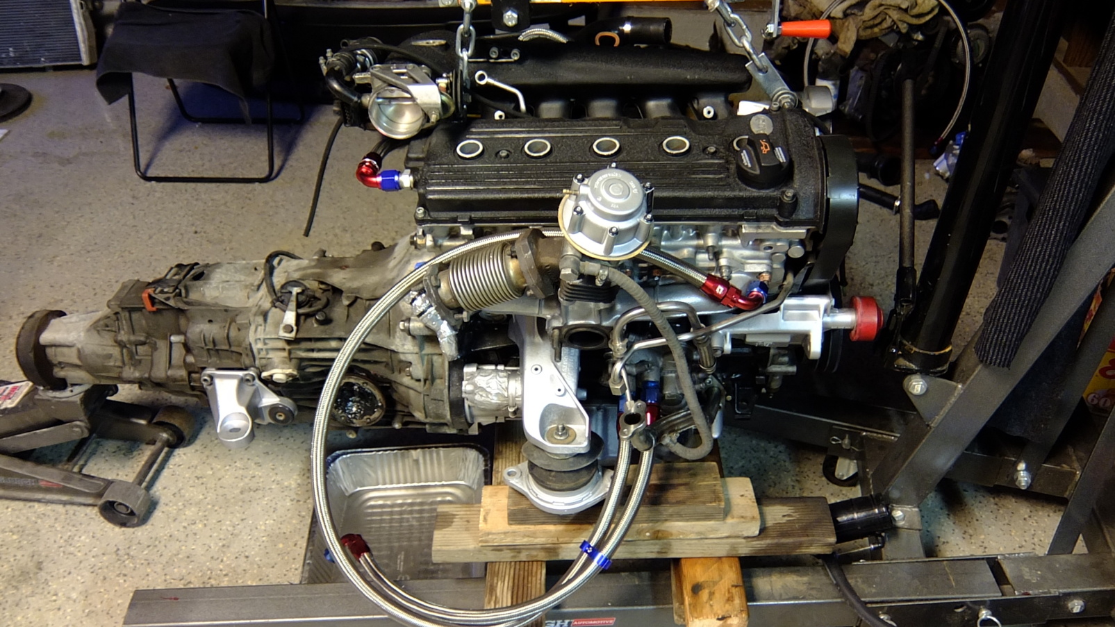

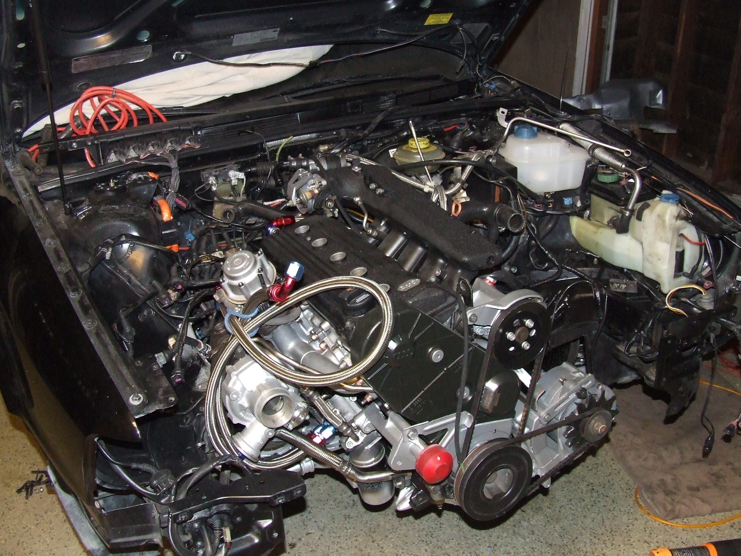

Turbo bolted on:
engine bolted on:
