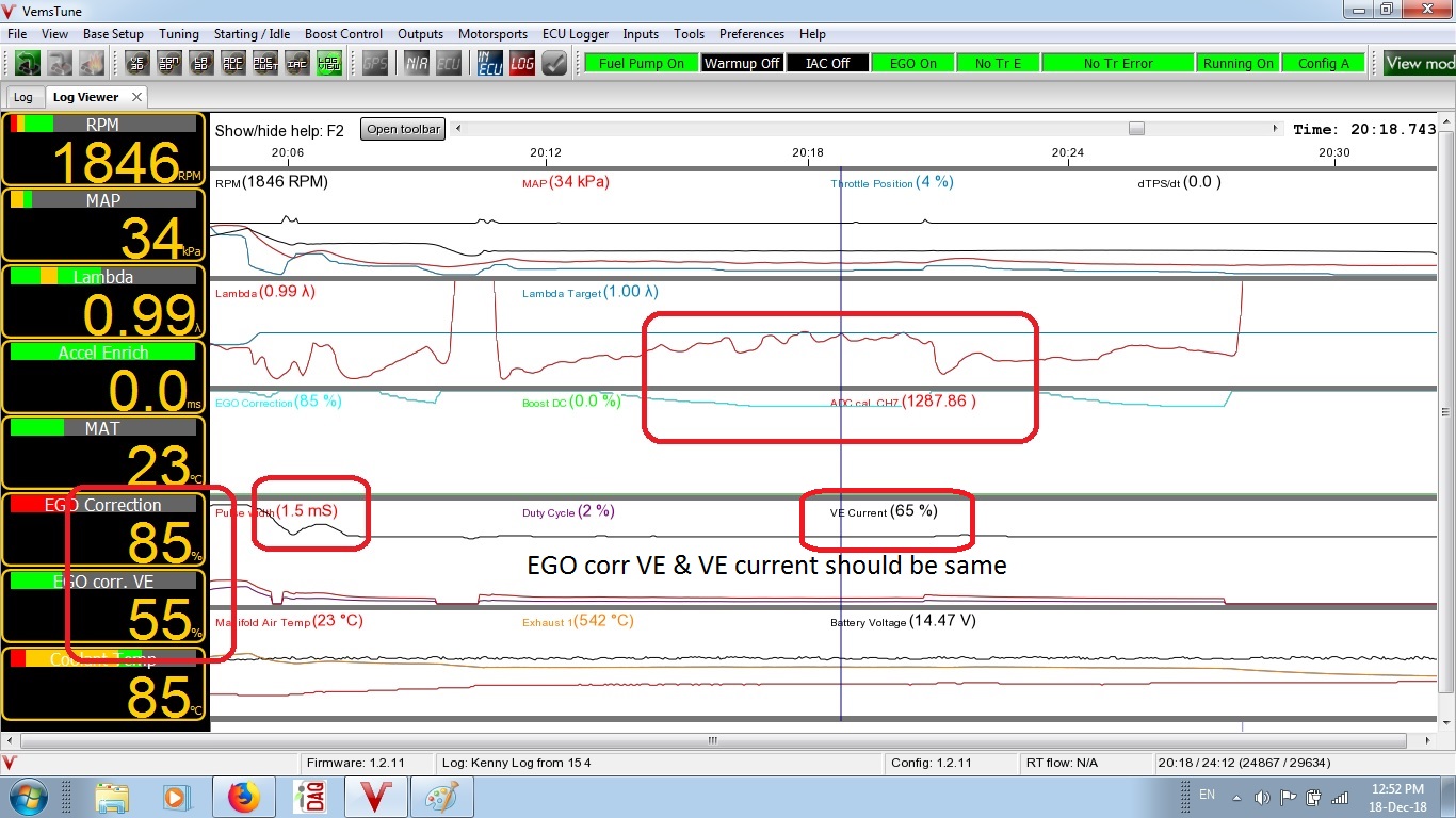

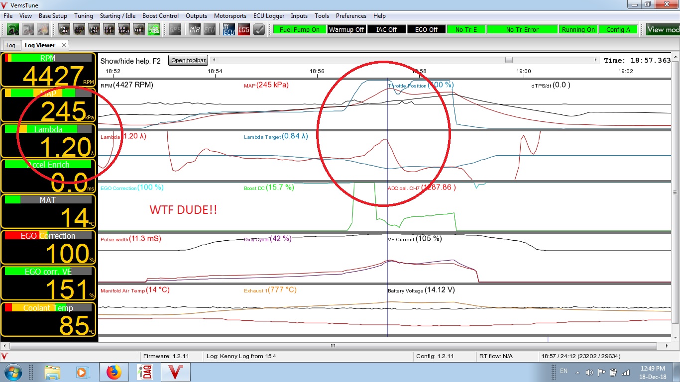

That lean peak has nothing to do with your compressor wheel. It is just injector and AE settings. Your AE settings don't go high enough. Highest dTPS you have is 26, while when you mash it, it shows 66! That is why you go crazy lean! See pictures.
Another reason you have lean peaks on accel is because EGO is pulling a lot of fuel. It is canceled on throttle input, but it does have an effect.
I hate to say this, but your VE table needs a lot of work. You say it maintains target lambda with EGO on or off. Why does the log then show EGO correction 85%? I can see in the log with my settings that it pulls fuel almost everywhere. EGO correction should be 100% if on target. Another thing is that you reach very low IPW. Just 1.4-1.5ms. The Dekas are not really linear that low. They start to go unstable at 1.7ms I have noticed. That is why you have that weird oscillation in lambda and MAP between time mark 11.30 and 12.20, I think.
Is your thermostat new? Coolant never goes above 87C. I recommend you get a stock 87C 'stat.
I see the on/off EGO issue at the end. That is odd, but not because of the higher enable temp. That is something else.

You also need more AE. For sure. You WILL melt a piston if you keep going like this. The lean condition is quite long actually.
You are too rich in vacuum and too lean in boost. See attached config to get an idea of what I mean. You don't have to use it, but I do recommend it.

If it goes too rich in boost, it is not as bad as very lean. 1.2 @ 245kpa is not good.

for the thermostat, yes its new. the 87c is normal for my car, also remember were dealing with temps here right now of -10c as well. in the dead of summer here id expect to see that number higher for sure. but its brand new and its correct as the one i pulled out was not correct lol.
with the EGO correct not matching the current VE... what could be this cause? i see its off by about 10%. where should i look to solve this issue?
with the EGO on/off issue, it only started when i raised the temp from 26c to 60c. ill review other logs as well to see if the issue was there... but this was the first time i recall this issue

Well, that is it! Current VE is what you have in the table, but the ECU says you need 144 in order to hit the requested lambda target. If corrected VE asks for 144, put that in. Then try again. EGO control tells you what you should aim for. It's not always spot on, but you get close.
The idea is to hold in certain cells so that fuel requirement stabilizes. Any sharp transitions cannot give good information for tuning.
That is why dyno-tuning is so much faster. You can hold the engine in the cells you want. It brakes down the car by applying load so opening the throttle further to go up the MAP axis at one RPM column. You do something like this with brake boosting. I cannot do that here because of traffic.

That 144% is only during the 1/2 second spike. After that the car at 220kpa pulling hard, the current VE is at 99 and corrected VE is 99. So I think if i make 230kpa 144% its going to bog really hard up high.
Something is up with the acceleration en. After tomorrow when I test the acceleration en changes I made I'll post results. After playing with the AE today at idle I do feel adding more AE in the higher rpm will help me alot and get rid of that spike.

here is a run from today. as you can see the AE kicks in alot as i start to push the throttle, as it gets to 100% AE is gone and when i over boost to 205kpa i run lean for a split sec. thoughts?
I did 3 pulls and all were the same issues. This lean issue is my main concern right now so I'm trying to nail this down. Really need some help on the AE side of the house.
I've since adjusted the dTPS/map in a hope that it helps. Chris you said the if the dtps reads higher then the scale, say 50 and I only have valve for 26 it will use that 26 value... my issue is that my 26 value was 198%...198% seems like alot to me. Either way, I checked my log and I dont see dtps anywhere near the lean spot not near 100% WOT . I guess I could say...I'm lost on this one.

morris400 wrote:here is a run from today. as you can see the AE kicks in alot as i start to push the throttle, as it gets to 100% AE is gone and when i over boost to 205kpa i run lean for a split sec. thoughts?
I understand tuning AE is frustrating. I struggled with it too for a while.
Kenny, I don't want to be a dick, but you really are not listening. Like I said many times, those kind of lean spikes are going to kill your nice rebuilt engine.
That 198% is the max. Cannot go higher. It is too much actually.
The reason for it not being enough is because of your AE RPM table. It is subtracting enrichment again because it is (way) below 100% which is the base line.

That log was perfect. What you see happening there is correct. What you call overboost is no issue. It is not causing the lean spike. AE is only for the initial jump from low kpa to high. I'm a little jelly that you can hold boost so steadily.
Almost stalling out is not completely because of very rich, that also has to do with timing. Remember I put in 3 degrees more at 700? That is to "catch" it and push it back to idle.
If you touch the throttle and it rich bogs, then you need to reduce AE % at that dTPS. Say dTPS of 4 or 5. As discussed already, if at higher rpm, like 2000 it is not enough, that is when you adjust the RPM scale like you are.
In the mean time, cruise around at very low RPM to tune your VE table. I mean 1000-2000rpm. Find a quiet road and just cruise along in 2nd gear between 1000-2000, then 3rd, then 4th. These gears will cover different MAP rows. Try to limit throttle movement as much as possible. Hold certain RPM or MAP points. Do this with EGO off. This way will dial in VE and daily driving will be much smoother. Same with above 2000.
If your VE table is off, it will mess up the AE.
You have an interesting event in your log from timemark 35.00 to 35.8. There you can see the effect of EGO control messing with your fueling. EGO correction is at 95%. Then, a small change in kpa makes it go a tad lean, 1.07, even though VE in that cell is nearly the same as requested. This why nailing the cells as accurately as possible is key. The same can occur everywhere.
Then, at tm 38.4 you can see why your low dTPS is too rich. Only 4 to 6, but lambda drops to 0.81 in the trough. So, reduce the AE %.

Took a nice long hour drive today. Had to revert back to config 16.4 as the changes I made in 16.6 would not allow the car to start. So I went back to 16.4 which I knew worked. I
Changed the AE settings on both dtps and rpm. Then turned ego off and drive away. Everything felt pretty good. Was able to cruse around at 20kmh 40kmh 60kmh 100kmh and 120kmh for extended periods of time.
The only issue I could see was it's still rich so ill have to change the AE a bit but also...after coasting at 0% throttle for a few seconds, once I add throttle it stays very lean for almost a full second or longer before the lambda corrects.
Now with that I'm wondering if the fadeout time has something to do with that? I adjusted fade out from .48 to .75 as I needed more enrichment when I depress the throttle... it apears that by adding fadeout time I increased the lean period. Or am I reading this log wrong?
If crusing at lower throttle (15 or 20% say) if I press the gas to 80 or 90% i get no lean spot from what I can see...now I still get the rich dump before it comes back to normal. For this I'm confused if this Is dtps adjustment or rpm AE adjustment.
I ran tune by statistics today as well after my run. Pretty much said to drop the VE by 10% so I've done that and will log again on the same config with the VE changes.
Logs from this morning Attached.
