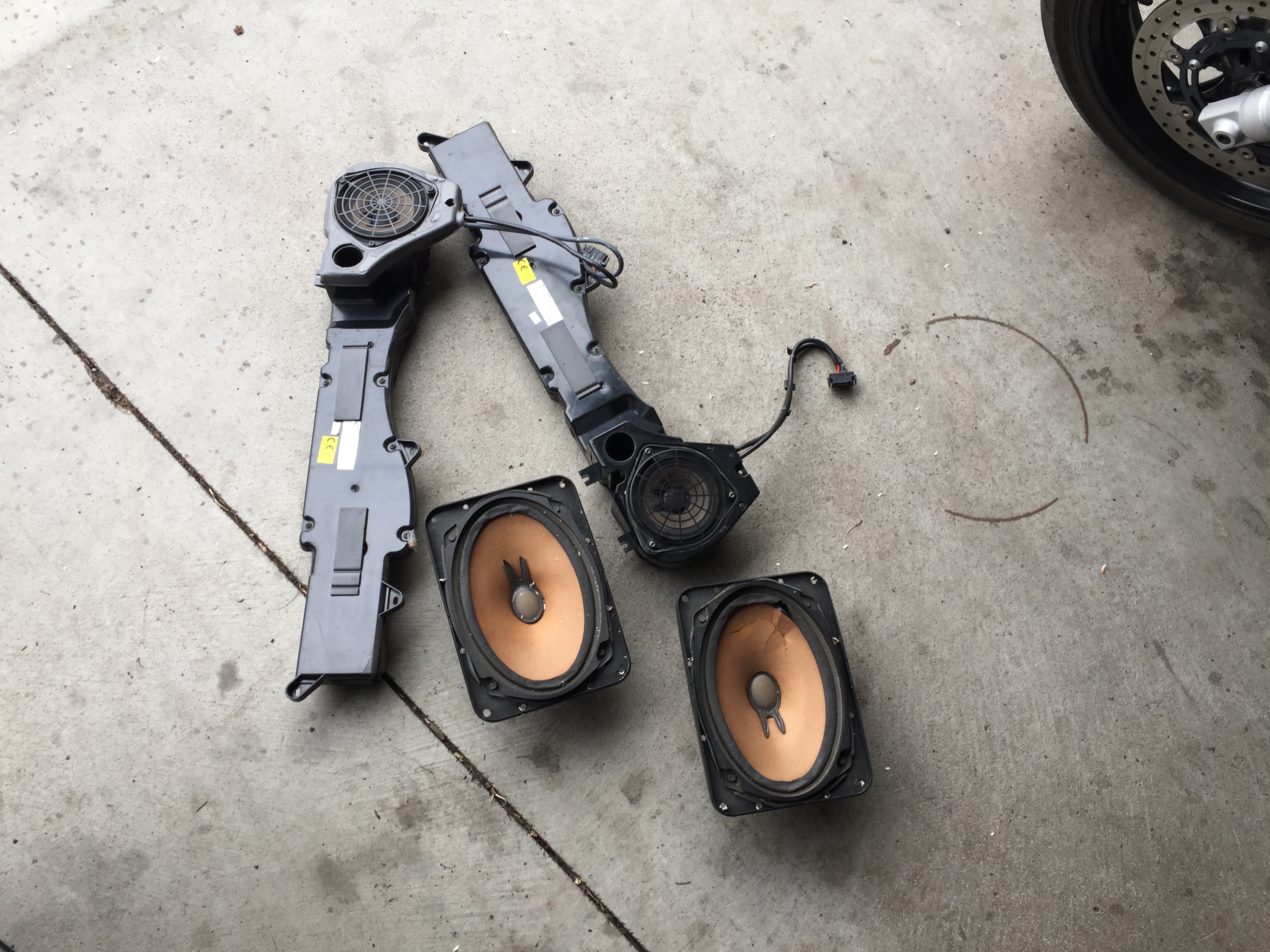

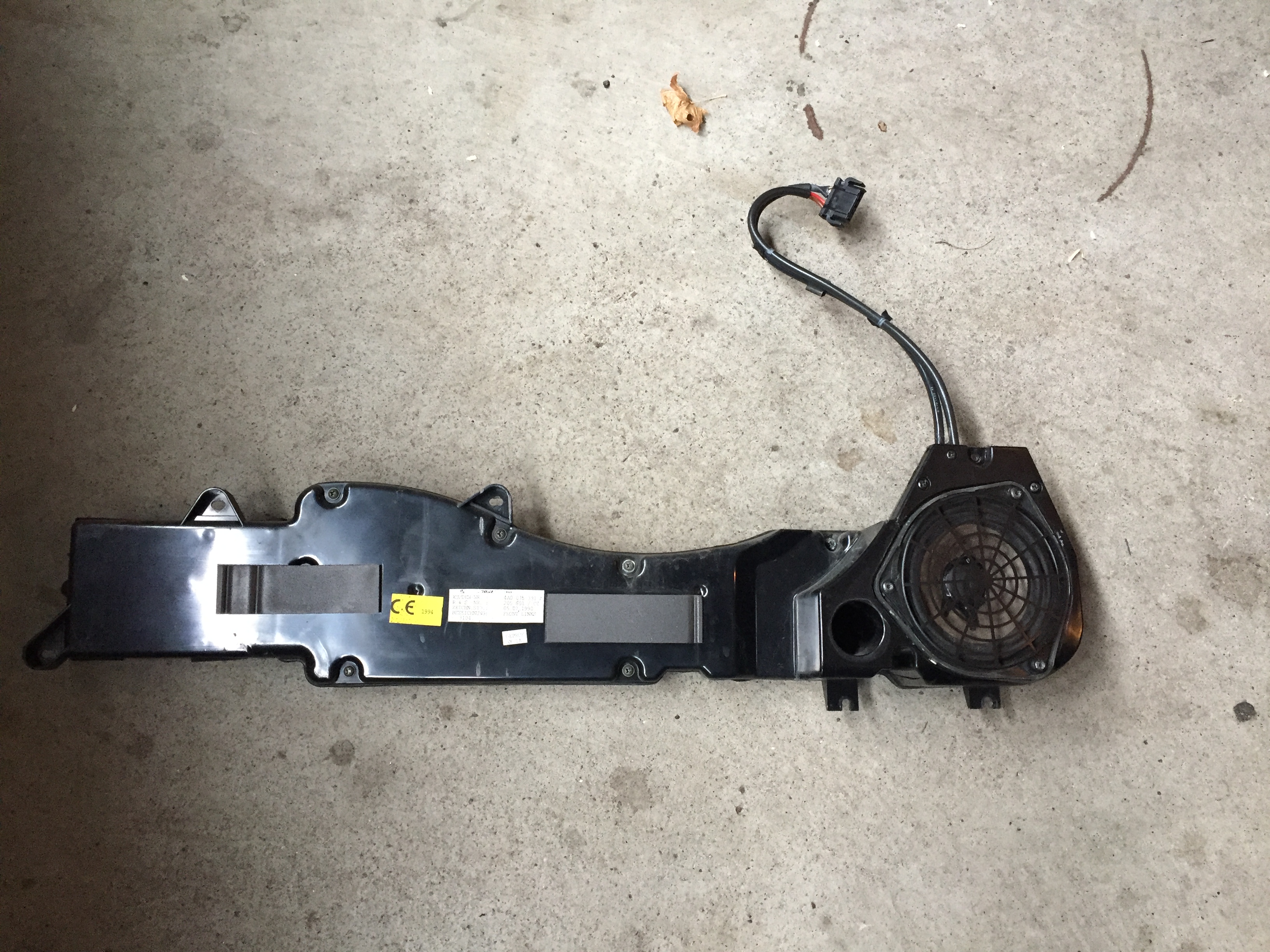

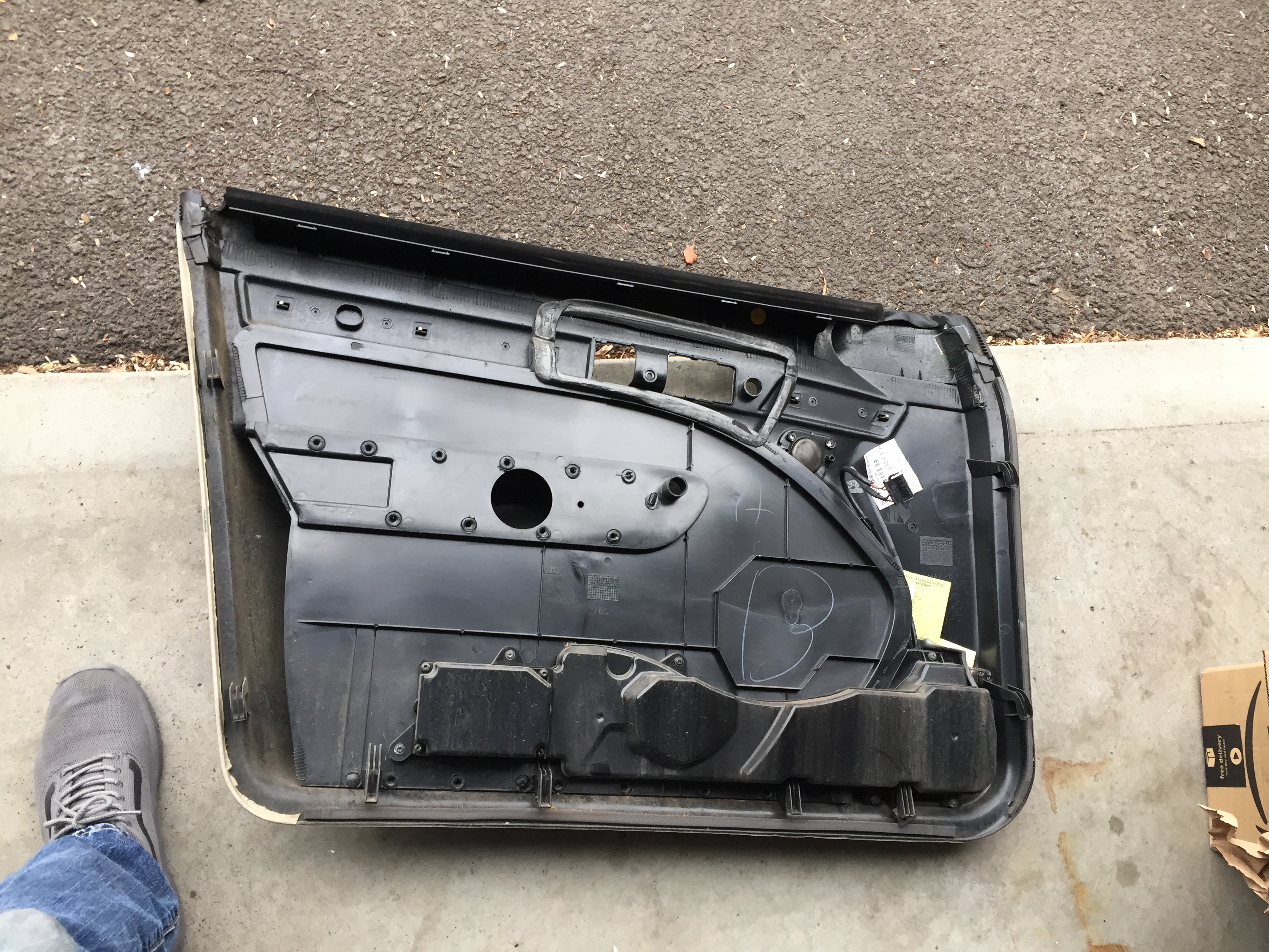

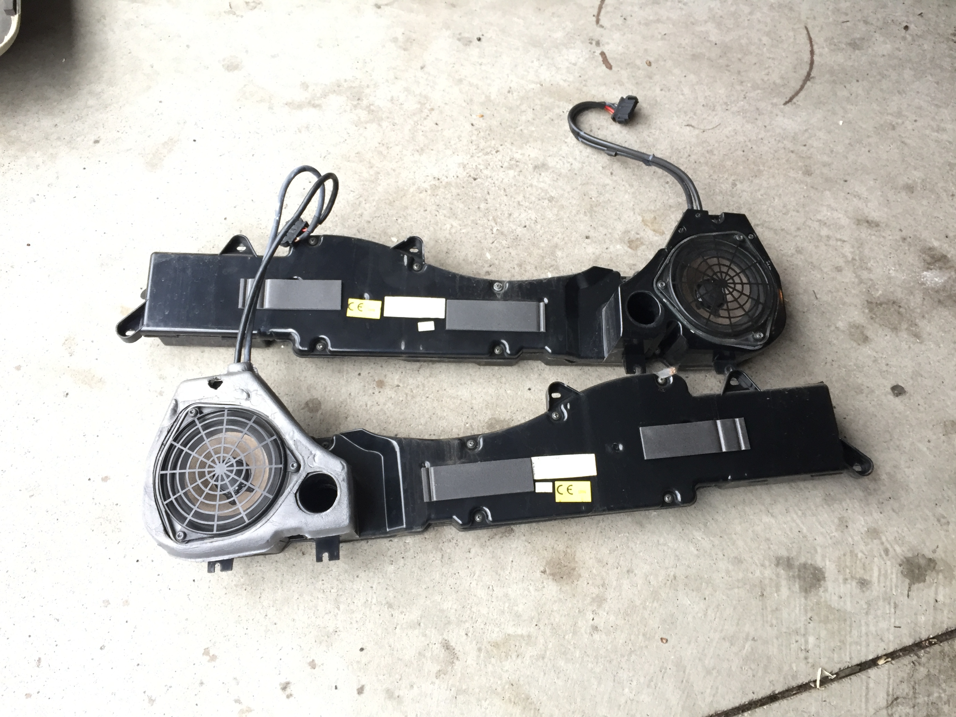

Had some time yesterday and decided to take out the factory speakers and amps. The relay for my amps was staying open and that’s what was causing my battery drain issue. I haven’t had a radio for a couple months now anyway so I just pulled them out. It was pretty straight forward. I used a thread that I found somewhere. It was about a “bosectomy”. Super helpful.
Eventually I will get some new speakers, and the plan is to custom make a bezel for a double din for apple car play. But there are other things on the list to take care of first.

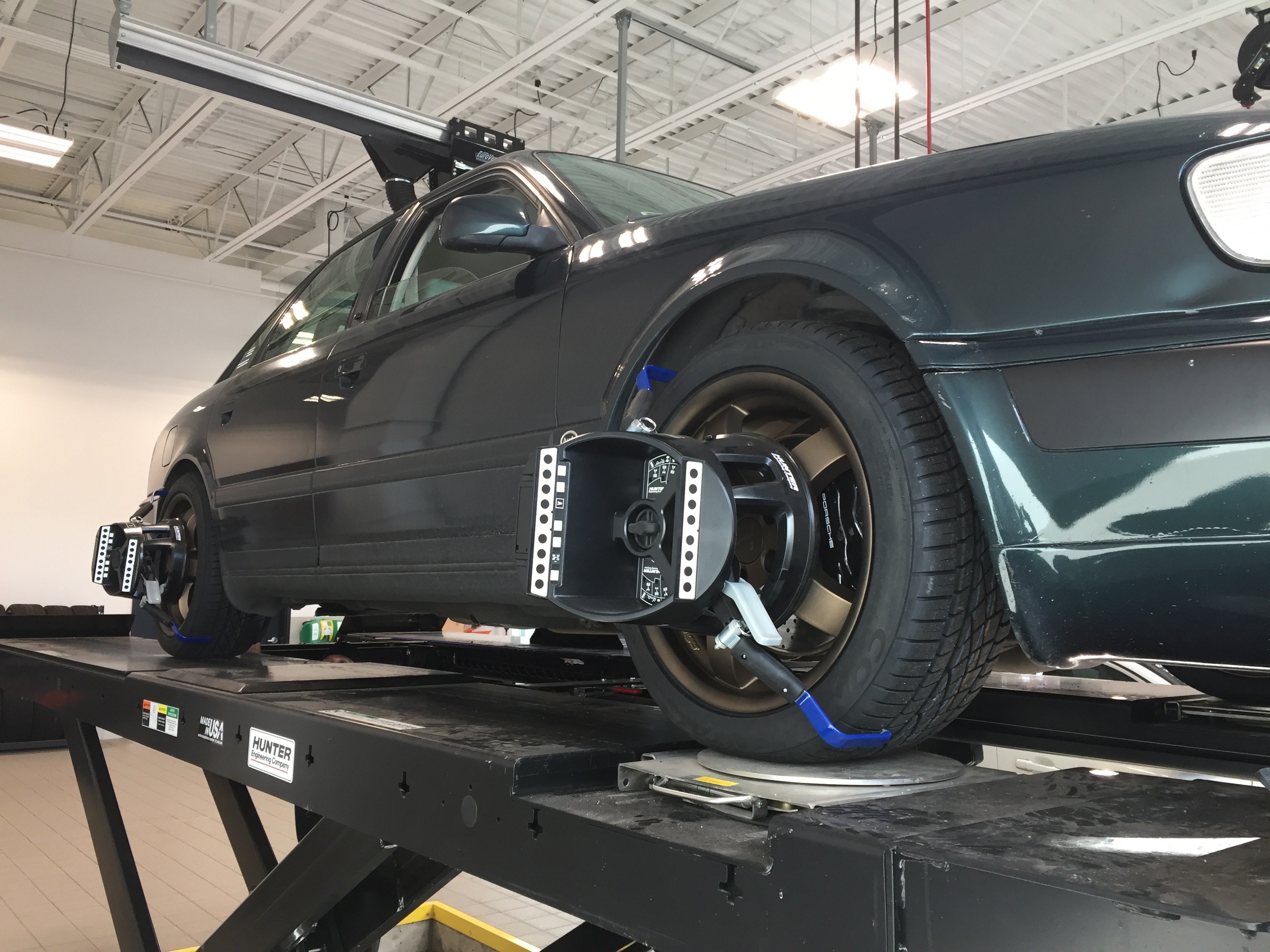

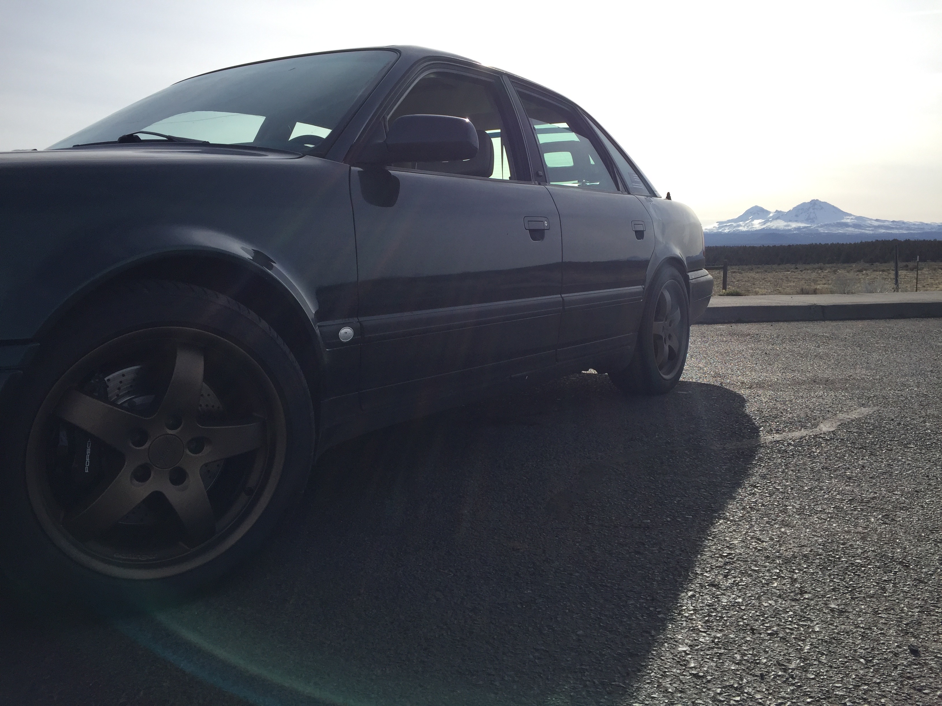

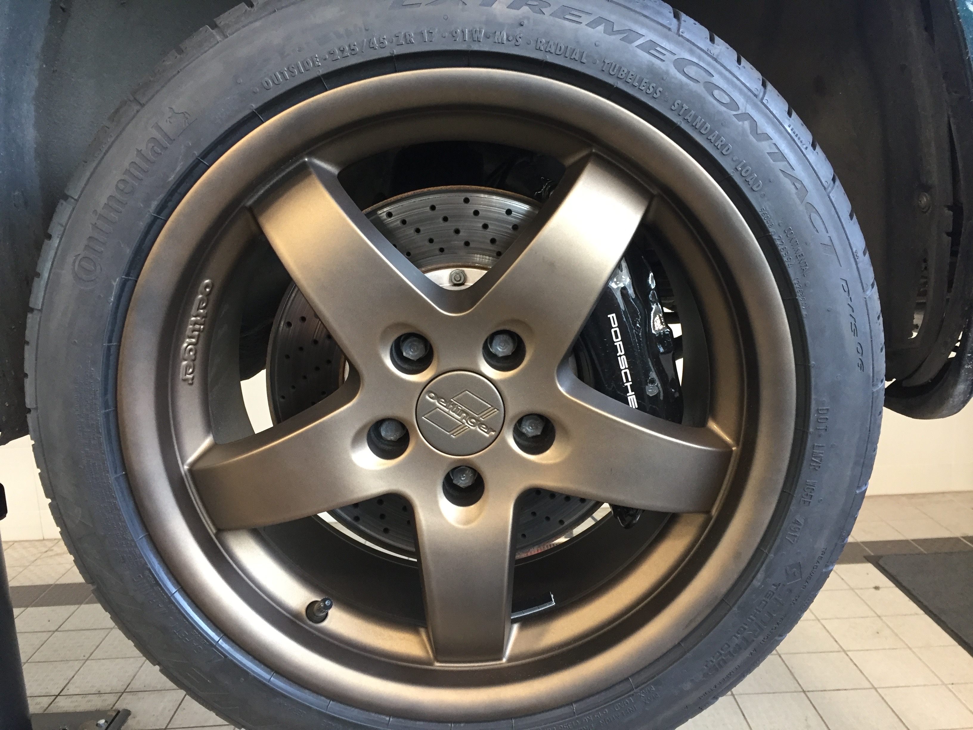

I realized, I have yet to post any pictures of my wheels. I got the wheels powder coated earlier this year with brand new Conti Contact DWS 06! I also got the car aligned just to make sure everything was good to go and also so I don't destroy my brand new tyres! I love the color of the wheels. I think they turned out super good, and I am very happy with them. I think they go great with the green, but that is just my opinion
I dropped off my motor mounts today to get powder coated. Should be done by the week's end.

Re: TCombs UrS4, Summer wheels and tires on.
Very nice!
Love it, bronze wheels pop on dark cars.

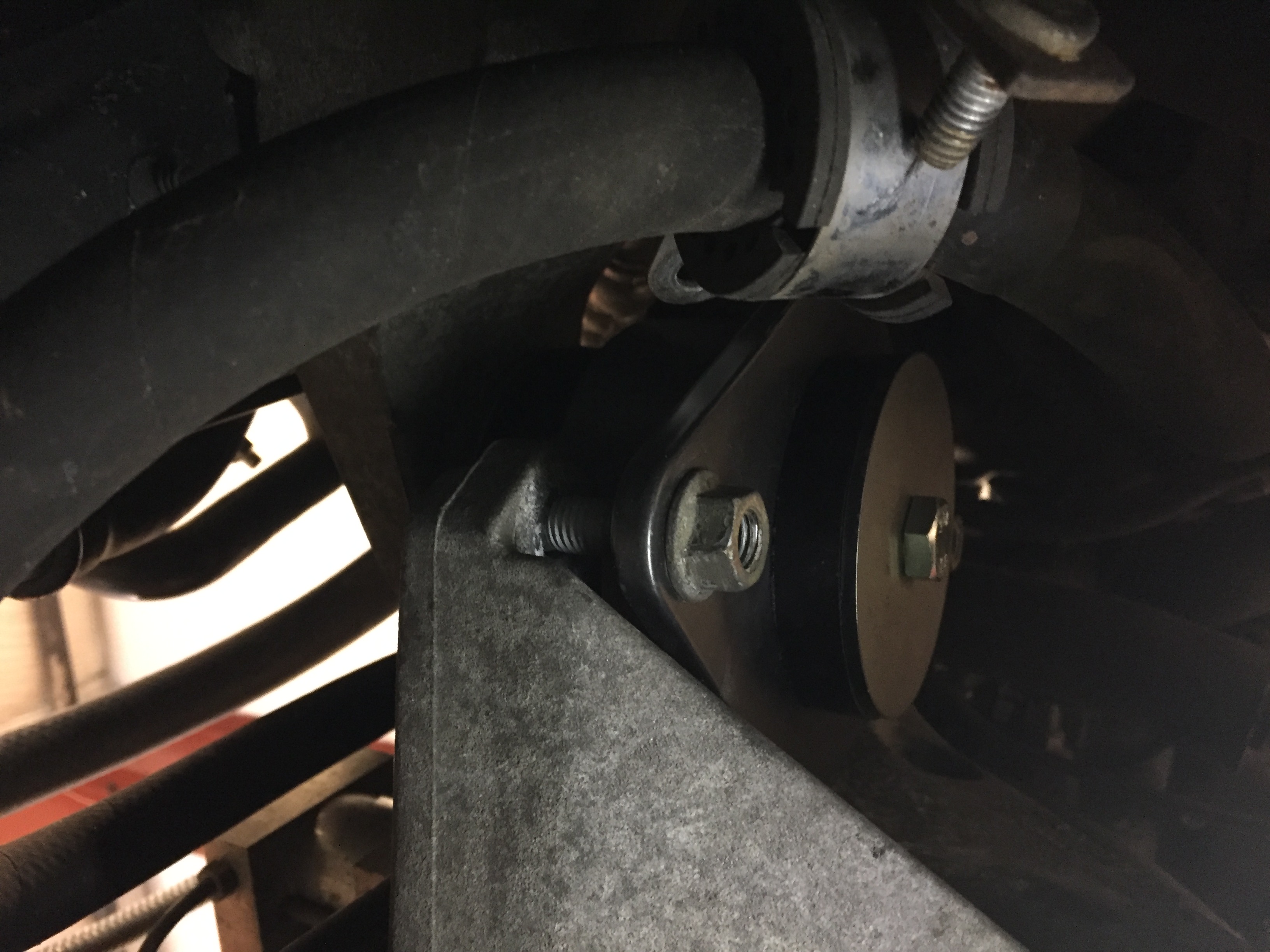

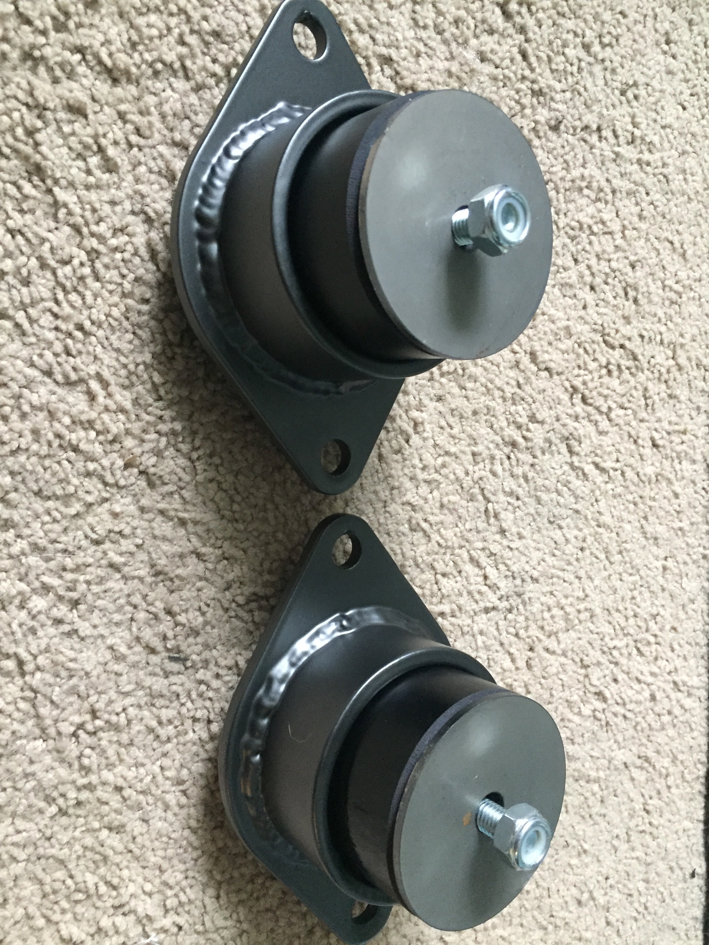

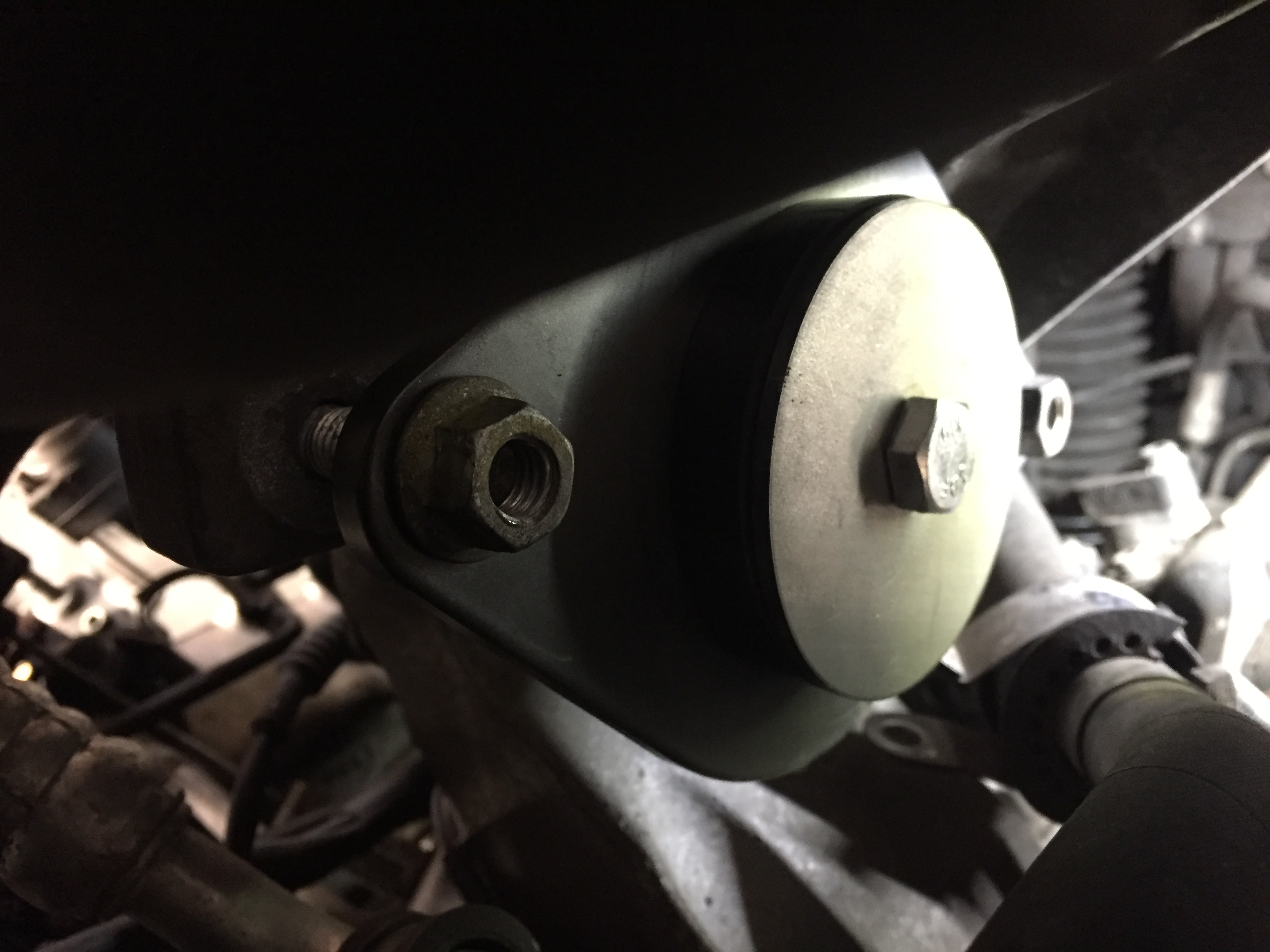

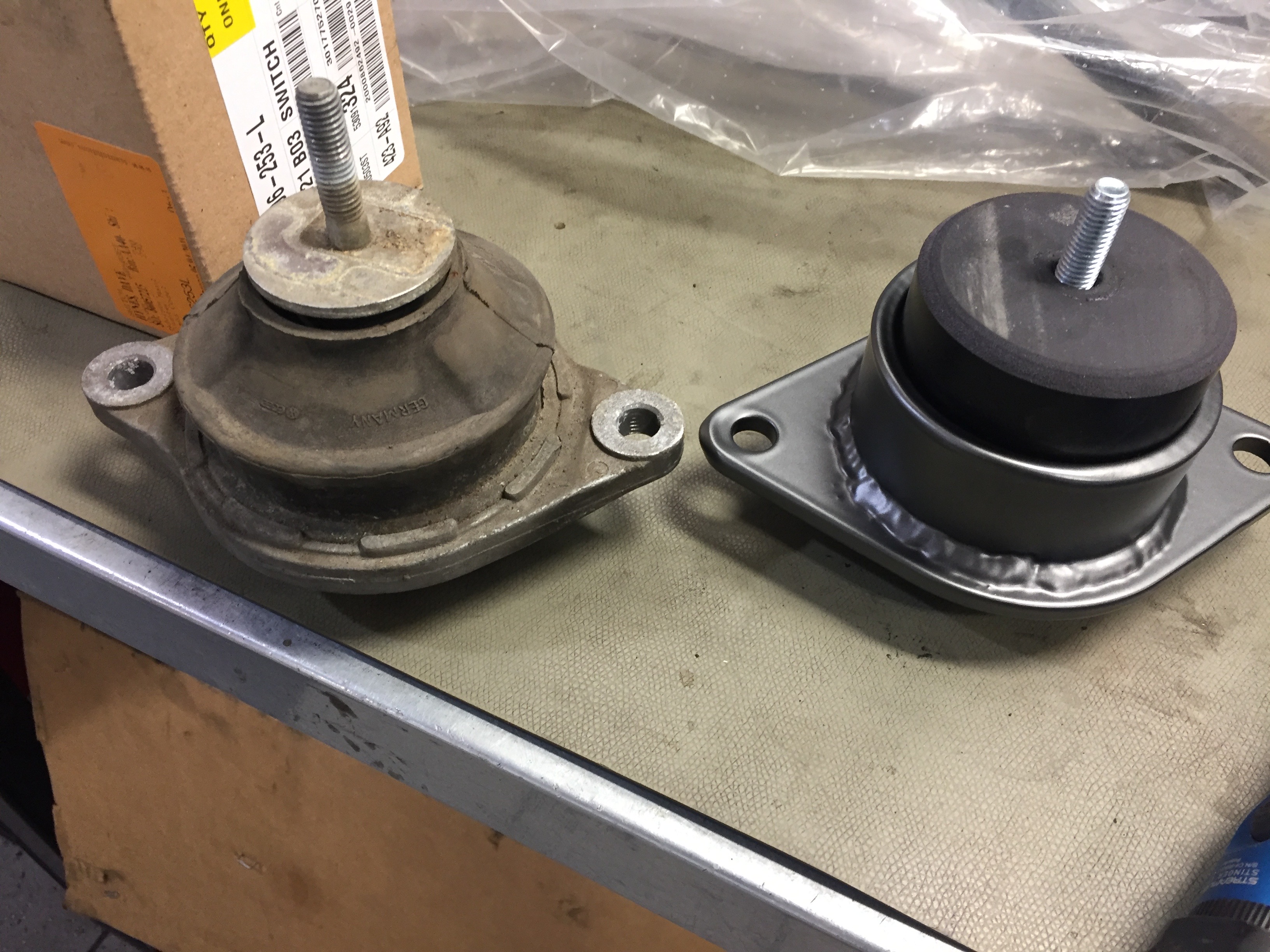

Maybe I am an idiot or something but I can't get my Hersh motor mounts to fit. The factory motor mounts angle in up at the top but my new ones don't and they get caught up at the top and I can't mount them in. Is there any trick to mounting these in?
EDIT: I can get them in, but they don't sit flush at the bottom with the two bolts. Do I just tighten down until they are flush?
EDIT2: Nevermind. I am "learning" and didn't know that I needed to suck them down to sit flush! All is good now!

Re: TCombs UrS4, Can't get motor mounts in.
I got the mounts in. Little harder then I expected but I got them taken care of. The P/S was pretty bad. There is some more vibration at idle and in 1st and 2nd. You can feel it in the footwells but I am happy they are new.
Had some trouble installing the passenger side, but once I took the snub mount off it was pretty easy. All in all a good day, bit frustrating but good. Next is the power steering pump and intake manifold spacer.

Re: TCombs UrS4, Hersh motor mounts in.
Something you can try to reduce the vibration is unbolt the mounts so they're loose. Start the car and let it idle. Now torque down the mounts to final spec and see if that helped by going for a rip around the block.
