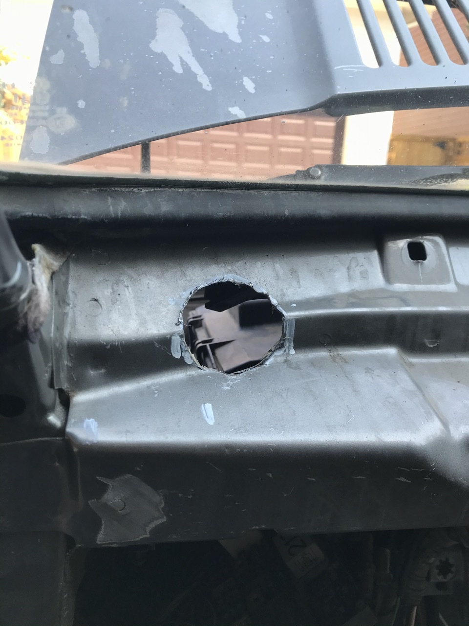

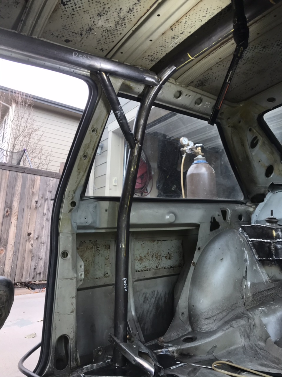

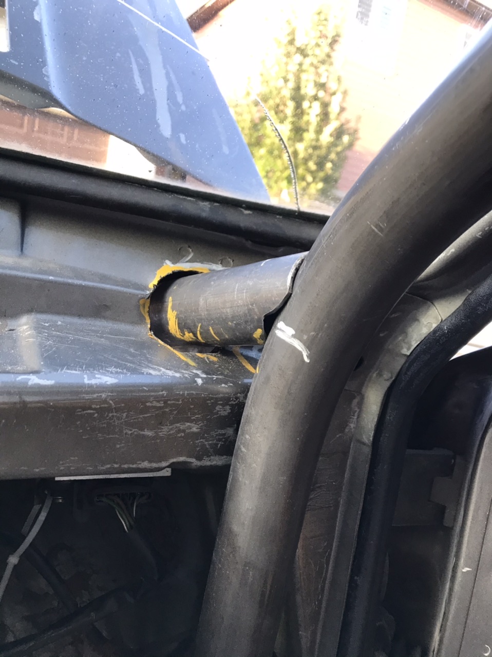

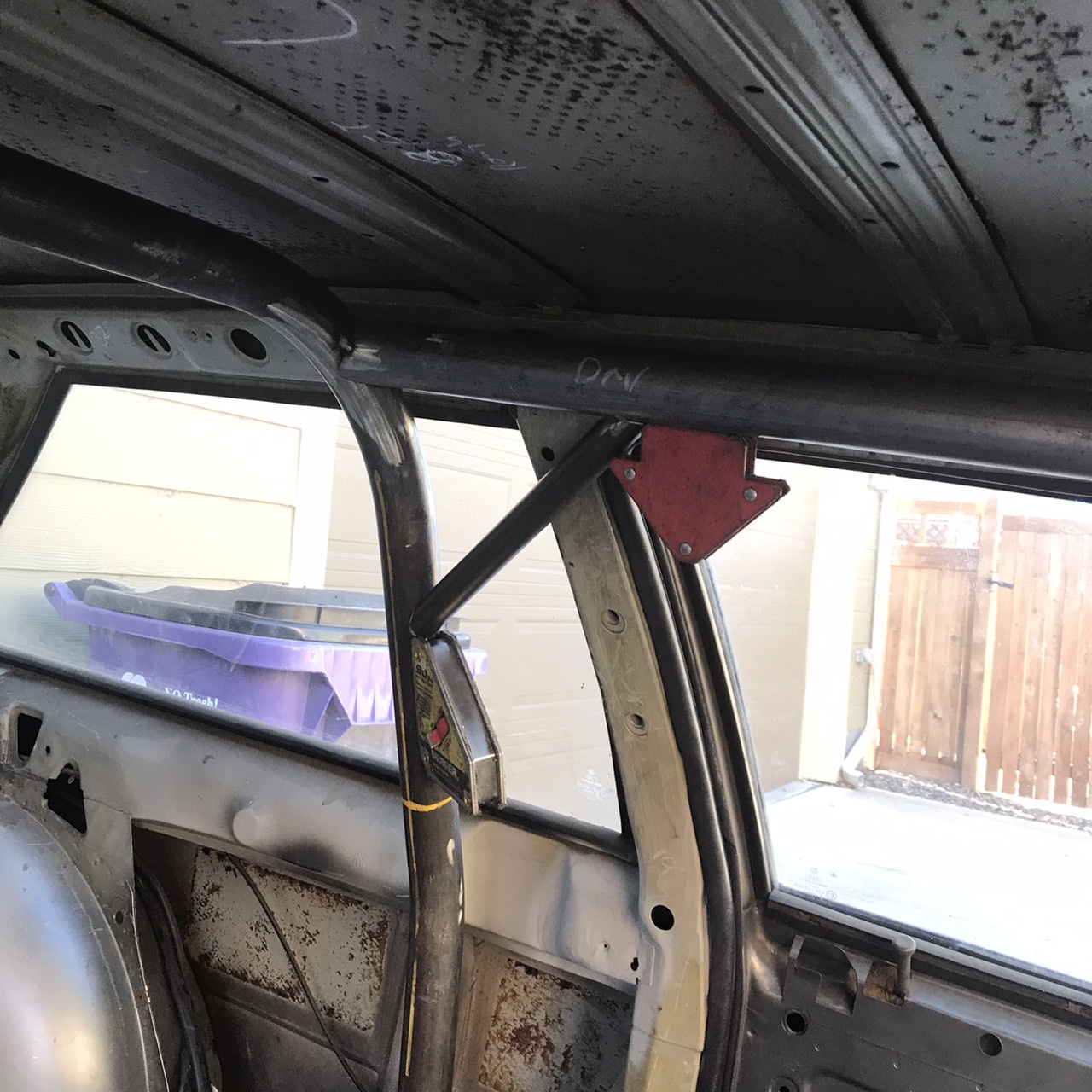

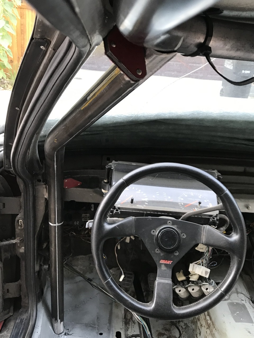

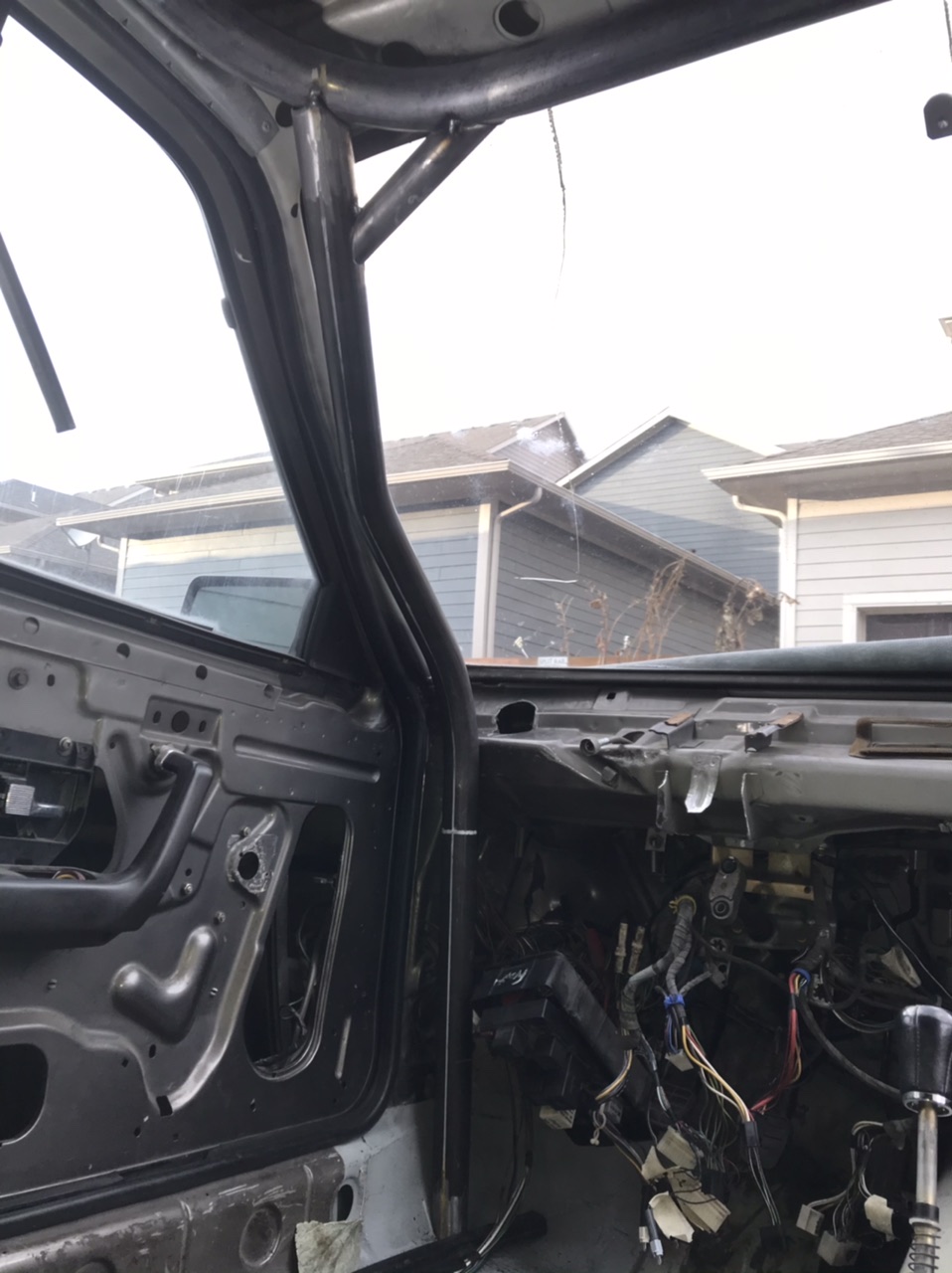

Doing the best I can with what the good lord gave and the tools I have. Got the A pillar down tubes bent, drilled holes through the dash to connect forward tubes to the shock towers. Drivers sideTube will interfere with the fuse box and wiper arm. I’ll probably remove wiper motor assembly and use the rear wiper motor. Not too worried about right now.

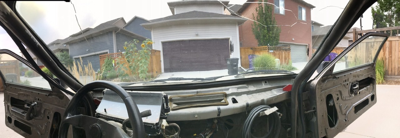

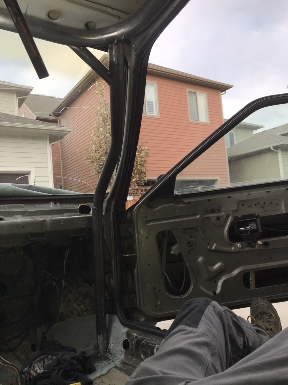

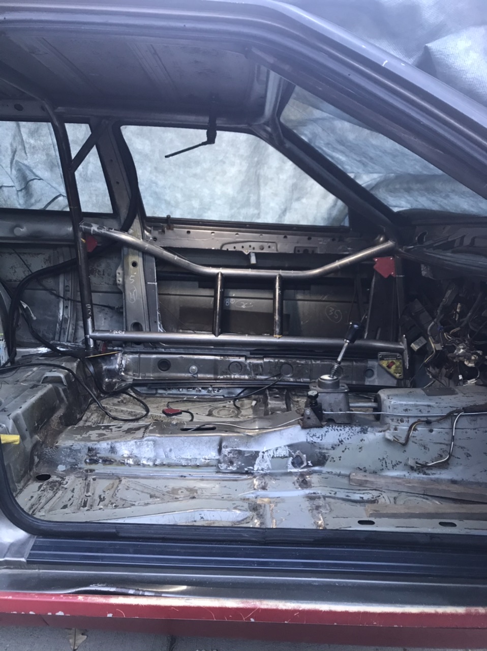

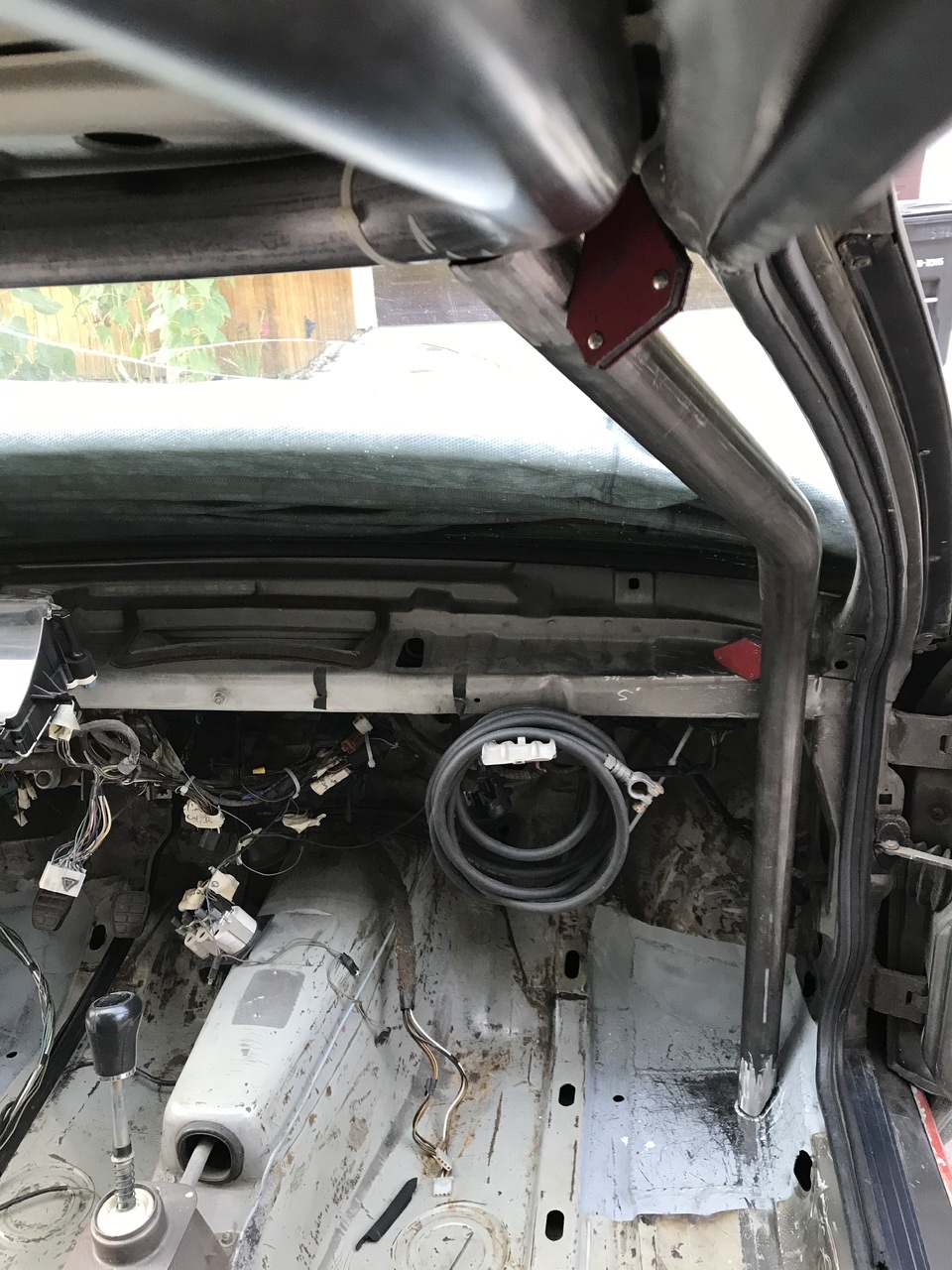

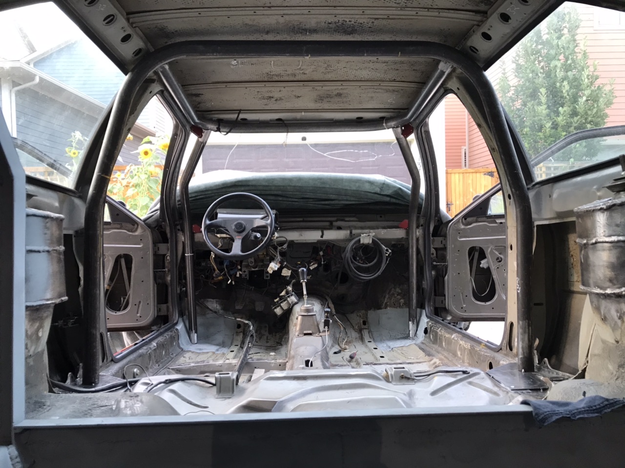

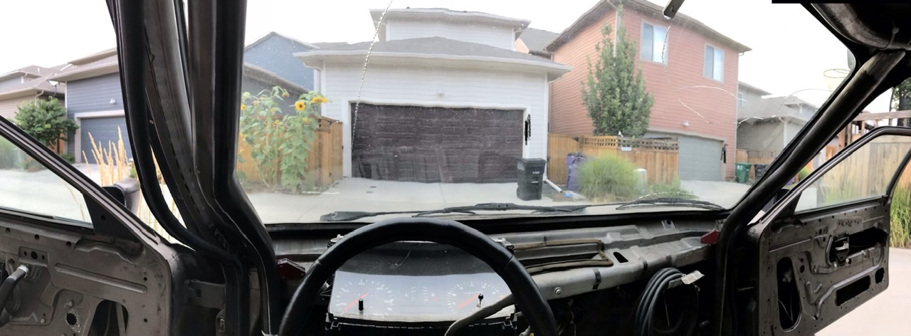

Some panoramic shots from drivers seat and center of inside.

Re: '84 Audi Coupe Gt grp2

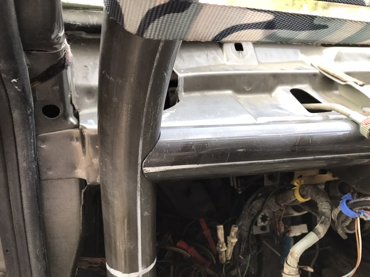

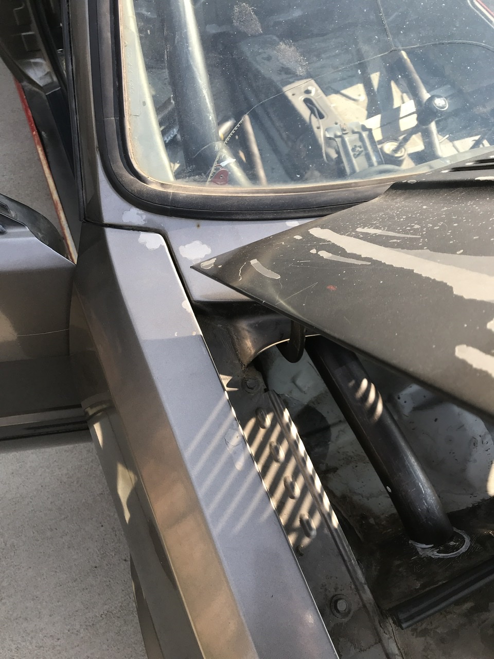

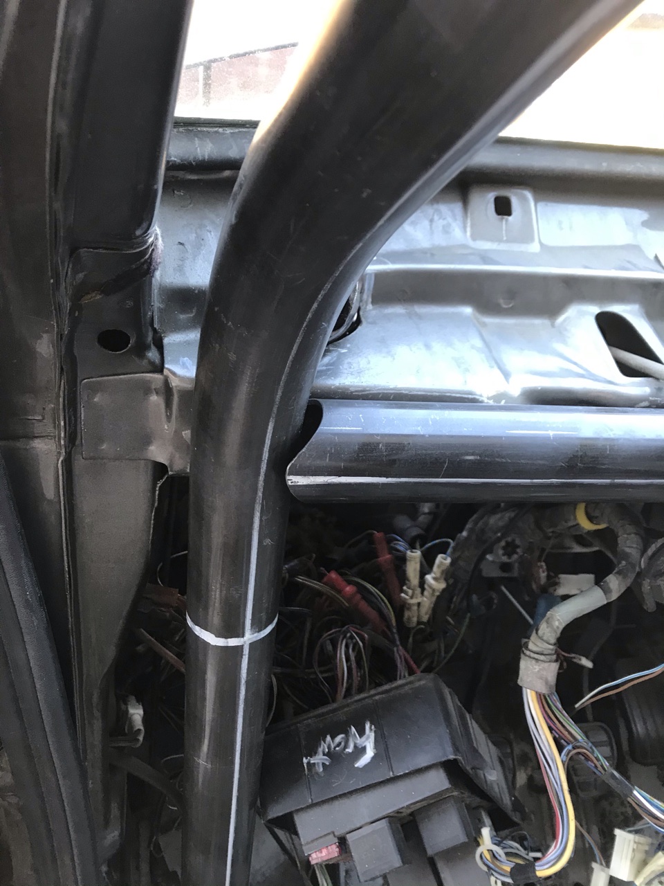

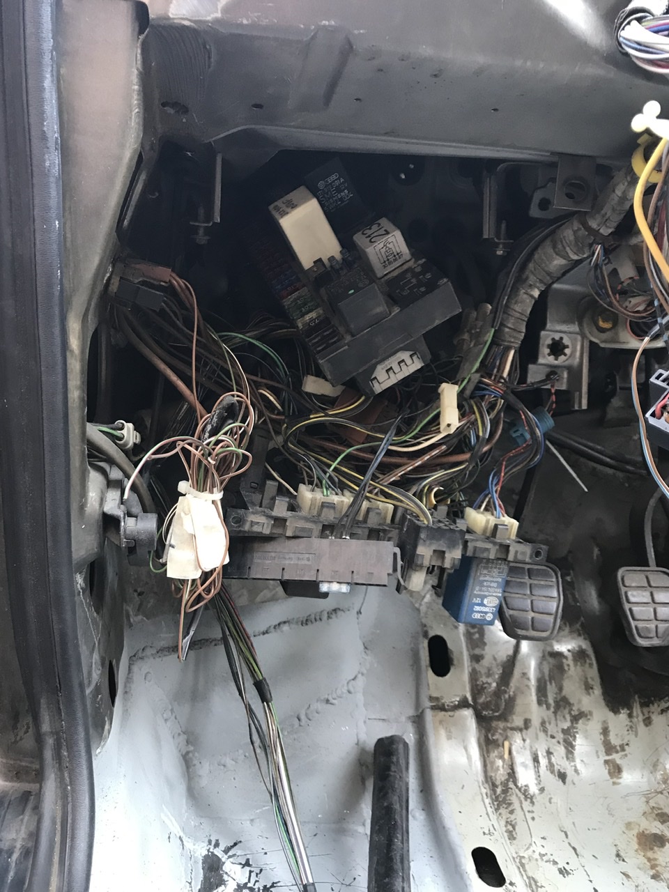

You can see here that the tube well hit the fuse box. Anyone have any experience with relocating that rats nest?? Thanks for looking and the input!

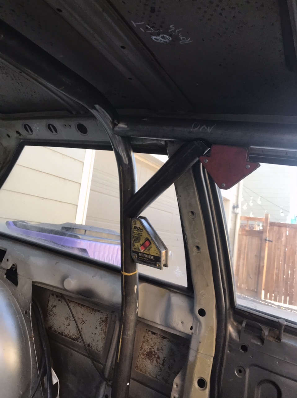

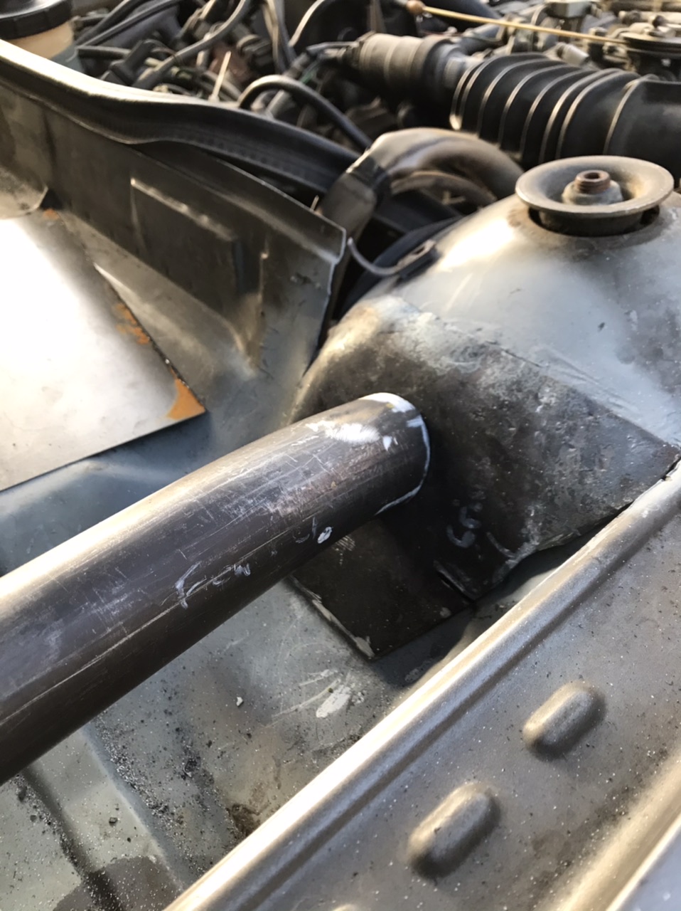

Strut tower tubes. Might need to add some other forward tubes???

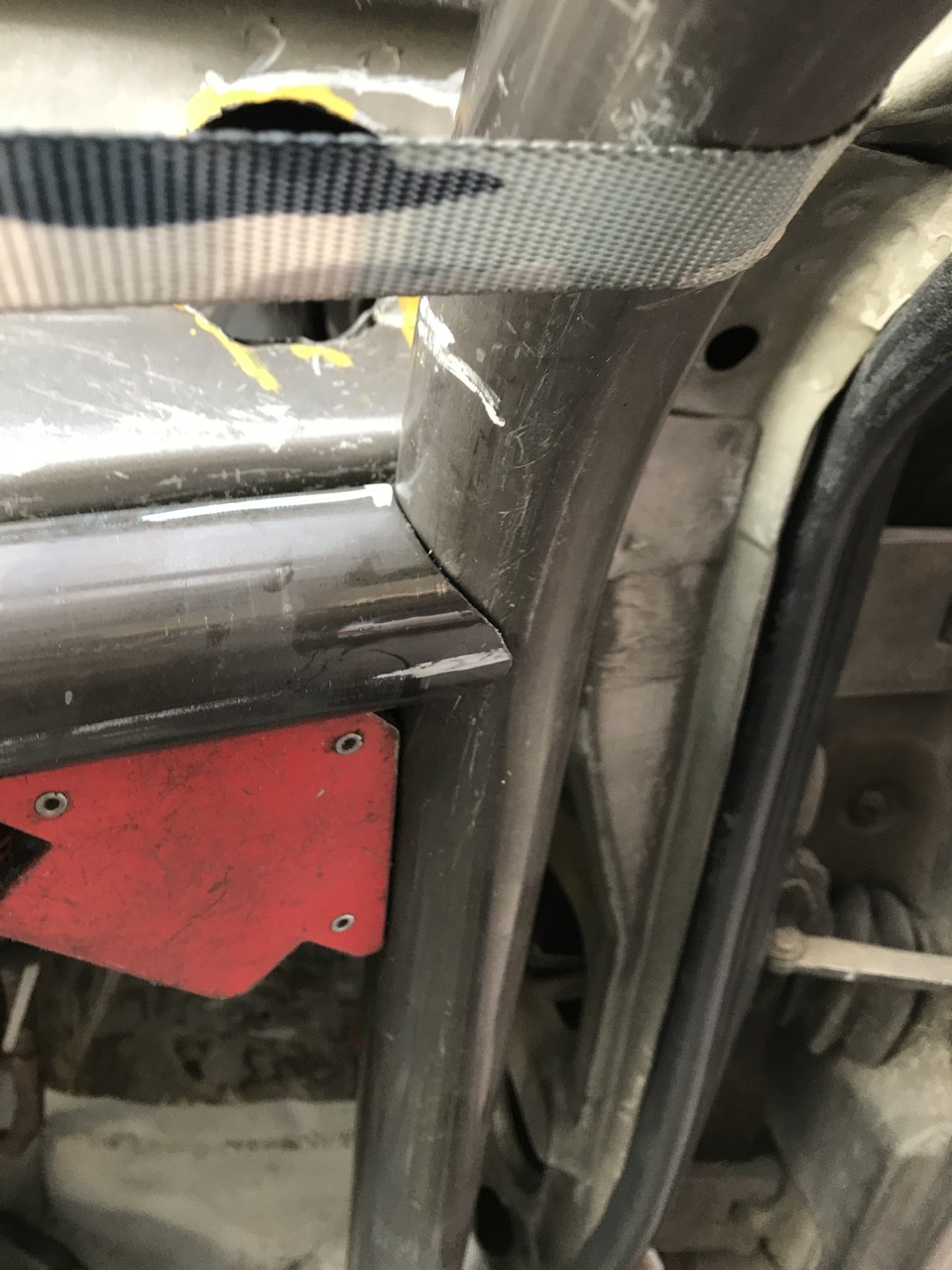

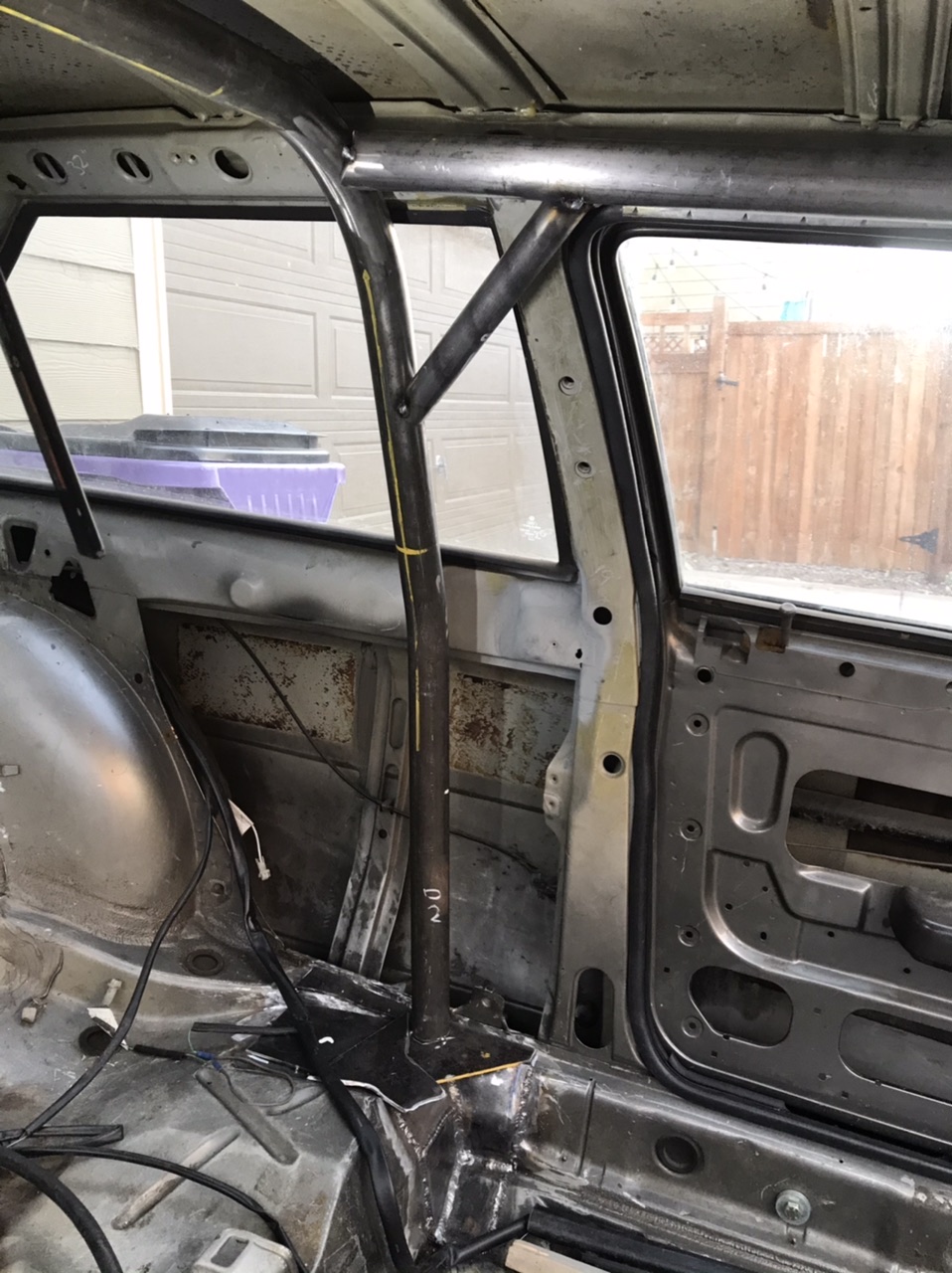

Knee bar. Little bit of a gap, used a ratchet strap to close it up. I’m sure it will change something some where.

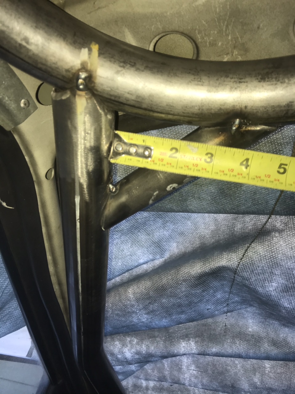

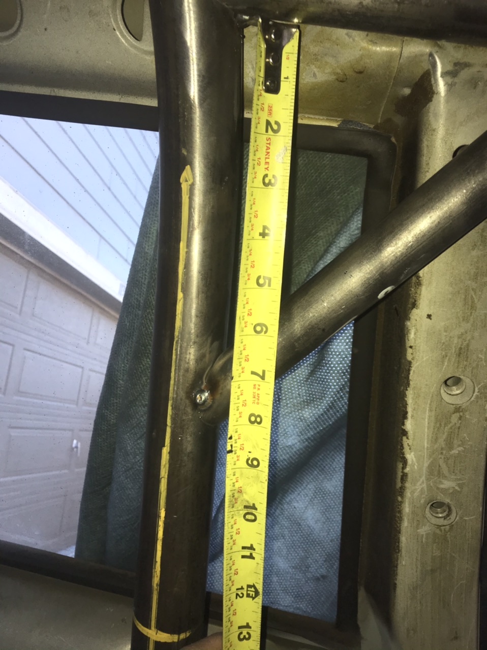

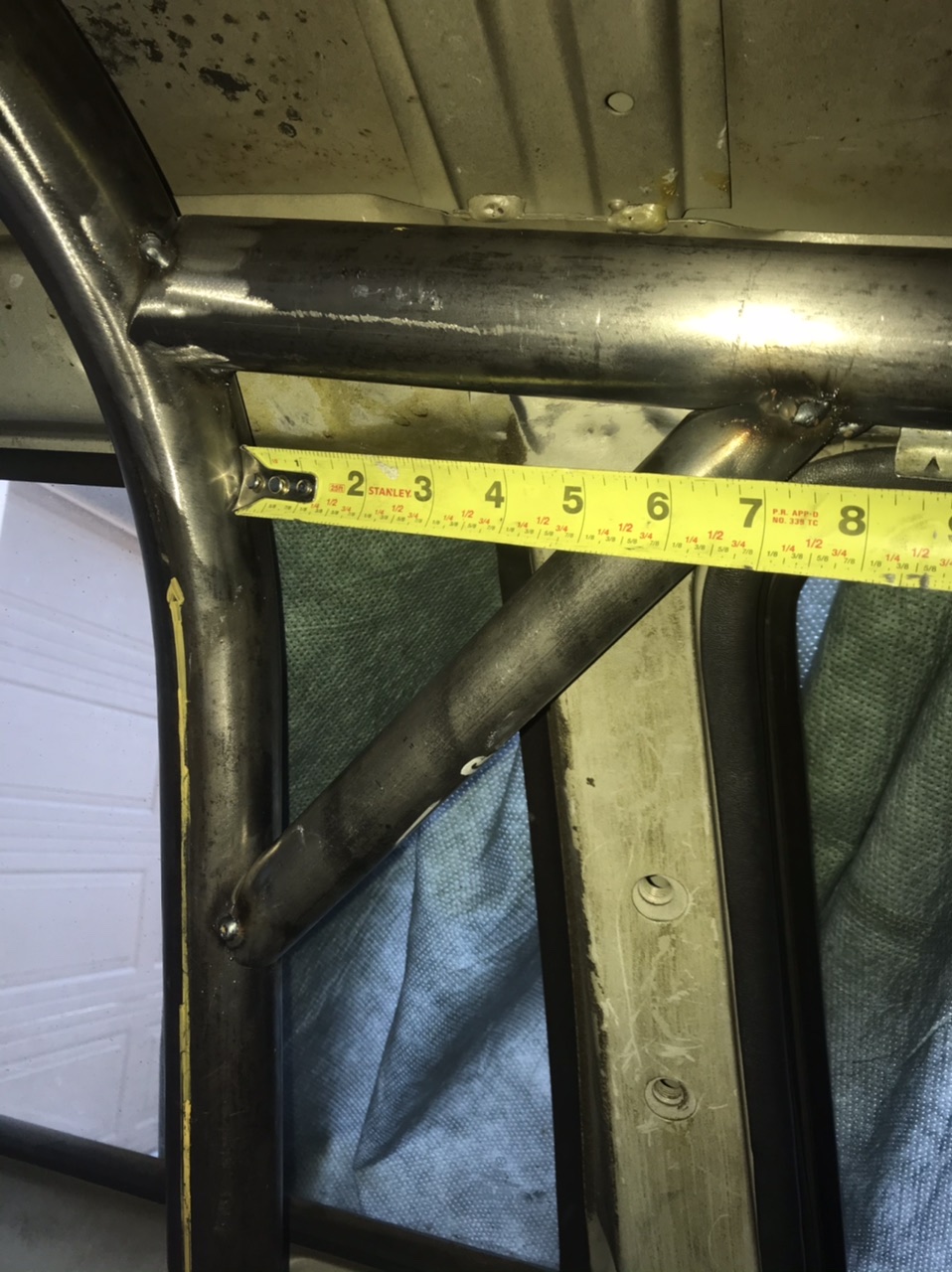

Got my gusset on. 1” too small, 1.750 too big, hit my head, already done that and it hits the b pillar. 1.025 just right.

not sure what spec you are building to, but NHRA/drag racing specs call for corner bracing like those on the main hoop to be no more than 4" from the intersect.

Thanks for your input!! Going by the SCCA GCR ITB Class, at the top of this page. The ITB rules are kinda vague. They give basic roll cage design specs. You read other class roll cage specs it gets a little more in-depth. I’ve read/been told that the minimum length of the tube gusset be 3x the tube diameter. Which tube diameter do I go by?? All My main tubing is 1.750x.095, gusset tubing is 1.025x.095. I went with the gusset diameter which gives me a minimum length of 3.075. Please correct me if my calculations are wrong or if I’m miss interrupting it. The A pillar gusseting was starting to hinder the vision that’s why those are shorter.speeding-g60 wrote:not sure what spec you are building to, but NHRA/drag racing specs call for corner bracing like those on the main hoop to be no more than 4" from the intersect.

So my regional SCCA tech inspector said things are looking good. I had asked him about dimple die gusseting and he said that’s a no go. Class rules say 8 attachment points. Anything more is considered additional attachment points and is therefore none compliant. Mmmeh.

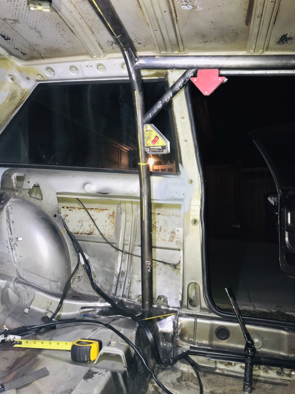

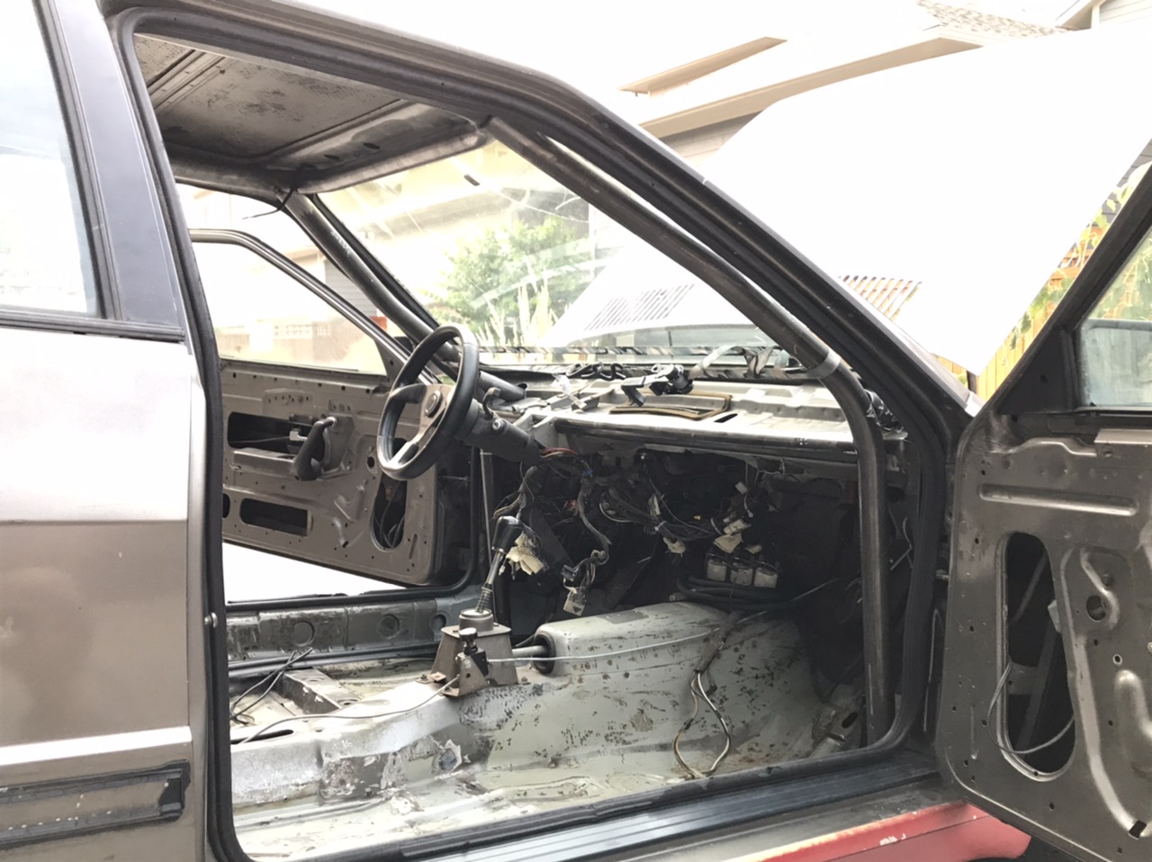

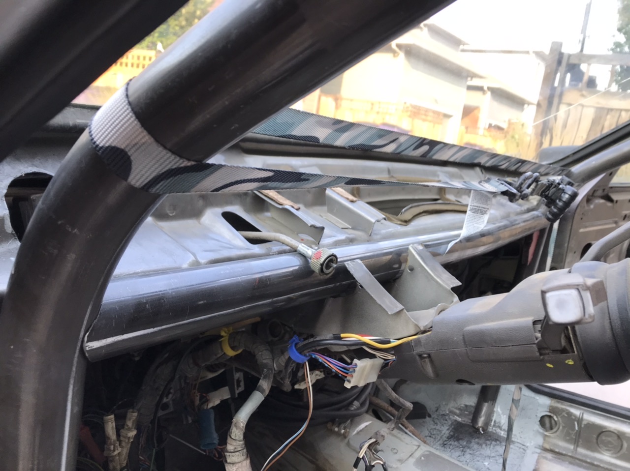

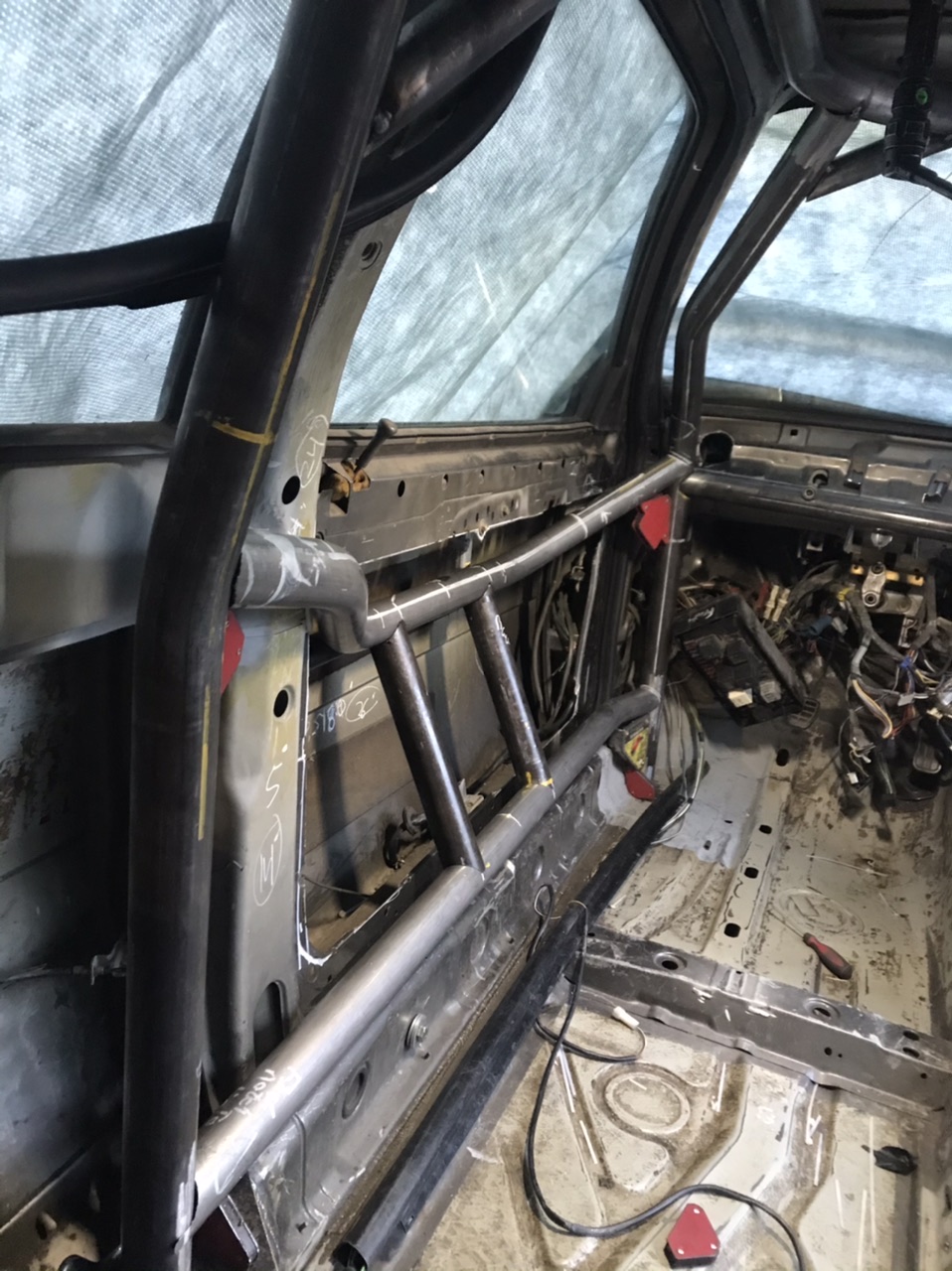

Happy Holidays gear heads! It’s been cold here, had a break in weather and got some side protection mocked up. I’ll add some extra diagonal tubes from the bottom of the main hoop and A pillar down tube to the 2 vertical door tubes. Might do the passenger side the same way. I didn’t accomplish this in one day, 3rd times a charm! That goes the same for the A pillar tubes. You have to notch a little bit at a time and for door tubes use things to hang the tube to make sure it’s placed in the same location. I mark the tubes because a lot happens in between the car and the tube bender or notcher and then the tool I need is not in the car.
Mr.
Previous cars:
Previous cars:
Side protection
- 10F08E94-19BD-4EBB-A1A8-68FE5EF8D760.jpeg (333.5 KiB) Viewed 55851 times

More
