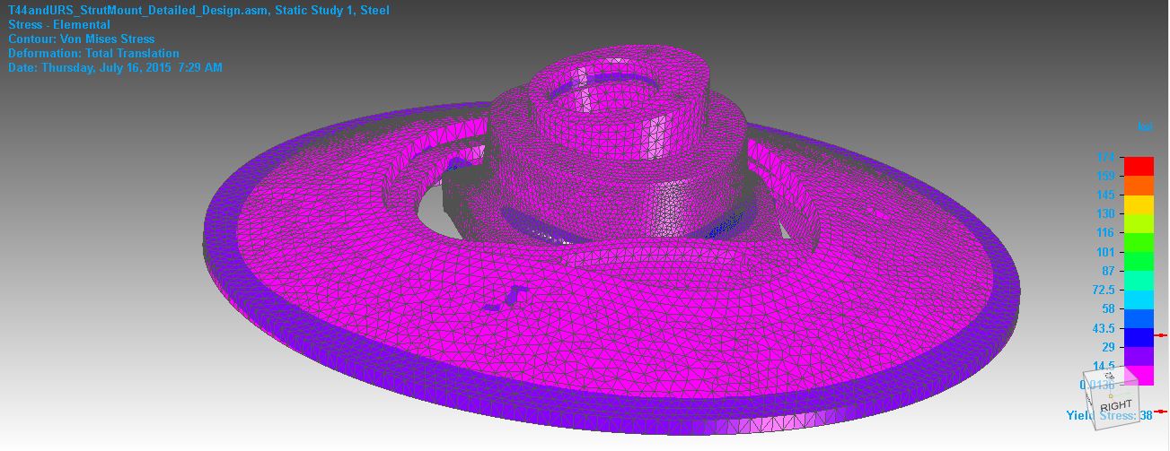

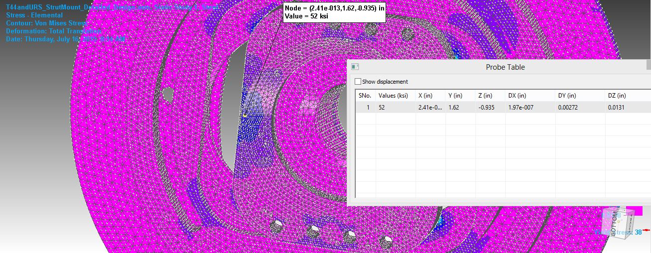

Current events involve trying to get the latest iteration of the design to pass structural analysis. It's really hard to estimate the forces the mount will undergo, but I think I am running it with numbers which are conservative enough. Even so, is proving difficult. I'll get it there though!
Also, I'm currently getting a price quote from a job shop I've used before. No idea what they're going to come back with. I'm hoping under $500 per set, but I'm not making any promises.

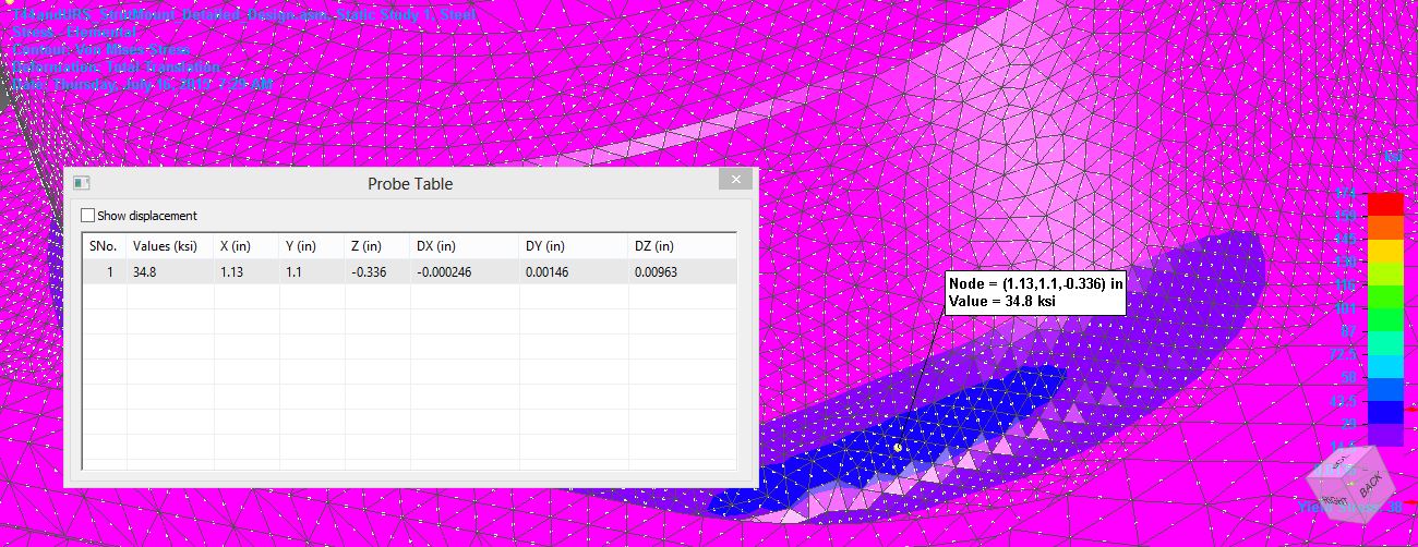

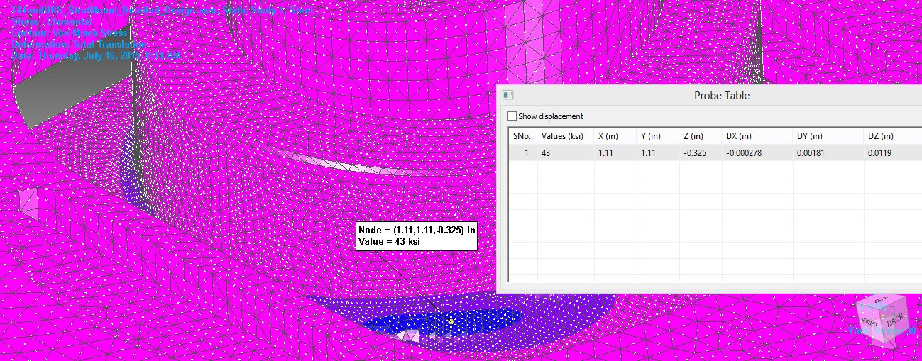

I've been struggling a little bit to get the slider with the cutout in it to pass the finite element analysis with what I feel are pretty conservative assumptions. That was until I realized I was comparing my results with the yield strength of really crappy steel. I was shooting to have stresses under 36,000 psi. I got it there for the most part, but then realized that regular 1080 steel is around 53,000 psi for yield strength. Now I have lots more room to play, but I'm going to leave the design pretty much as it sits now for extra factor of safety. These should still put the struts up higher with more adjustment with any other mount out there which doesn't require modifying the strut tower.
Here are some details.
The mesh is made with tetrahedrals, with subjective size of 0.1". I didn't spend a whole lot of time on it, but the solution has converged reasonably at this level. Special care was given to the variable radius on the "slider" part with about double the density of tets used there to ensure a good solution in that area.
The outside edge of the mock strut tower part was constrained as fixed in all 6 degrees of freedom (it's connected to the rest of the metal in the car, so this is a good assumption).
A force of 6500 lbf was applied uniformly to the upper snap ring groove upper surface. This is really the only thing I'm not sure how to approximate to be honest. Obviously around 25% of the car's weight will be there on a regular basis, so figure roughly 925 lbs. However, that load can be multiplied quite a bit when hitting bumps, etc. I'm sure it might see the full 3500-3700 lbs of car at times, but there may also be times where it is subjected to a shock or impulse load which can really amplify things. The bearing I have spec'd is one of the higher strength bearings availble in this size, and it can withstand about 7700 lbf safely. When this load is applied to the strut tower, it starts getting close to yielding, so I think what I ran the analysis at is a fairly safe bet. There is room left over of course.
Since I'm running the analysis on the assembly rather than on individual parts (more accurate this way), connections had to be made so that the parts know where they should be making contact with one-another. I won't go into detail, but the contacts were handled as standard.
That's pretty much it from the analysis set up. I ran this probably 20+ times in the past day or two trying to figure out how to modify the design to suit the chosen material.
This shows the overall mesh and a general view of the Von Mises stresses seen in all the parts involved. Notice that the scale goes rather high... that is due to localized stresses in the model which are not "real."
Localized stresses along the contact between slider and lower plate
FEA_Localized Stress.JPG (144.18 KiB) Viewed 95339 times
These are the two critical areas for stress in this design. This is the downfall for this type of design as opposed to letting bolts carry the stress from the top. You get a lot of shear and bending stress in the member which crosses the gap in the lower plate.
Slider radius stress
Slider top hat cut-out stress
I may make some more tweaks to this, but at this point I think my analysis is conservative enough that these are not going to fail under any conditions a car will ever see.
I've also just about (97%) finalized all of the fits and clearances for all parts. This should make for a really nice assembly as long as the machinists do their job properly! I just wish I didn't have to make all the drawings. That's a whole project in itself, but I will get quotes in the meantime.
Just ran the analysis quickly for 8000 lbf. This is more than the bearing is rated for, and this is a stronger bearing than I used in my previous design which I tested thoroughly by bottoming out the car one too many times haha! The previous bearing was rated for around 6750 lb axial load and I was told by Hoerr Racing that this is a very commonly used camber plate bearing in motorsport. So if you break these mounts, you probably jumped the car off of a cliff! :D
This design should keep the material within it's endurance limit under any normal driving conditions ensuring no possibility of fatigue failure unless you bottom out the suspension HARD thousands of times!

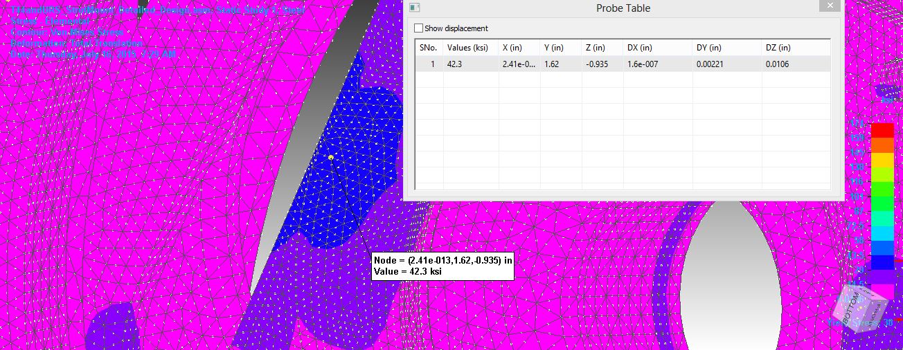

Slider radius at 8000 lbf load
Slider top hat cut-out at 8000 lbf load
I'm pretty comfortable with this.

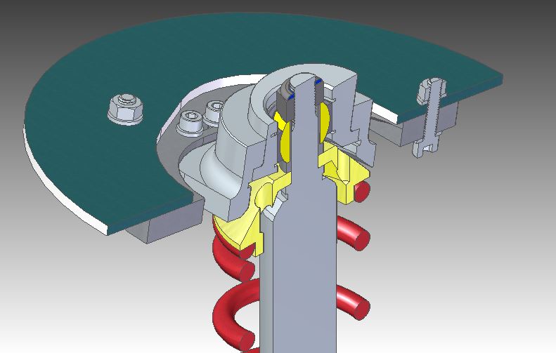

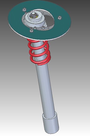

The only thing I'm really questioning right now is sort of a fundamental design feature of these mounts. It should be interesting to see how it works out with testing. The bearing housing is not rotationally constrained in the slider piece in any way. However, the fact that the strut goes through it at an angle should mean that the bearing housing is always self-centered toward the outside of the car (to the fender) as is intended. Of course if you try to turn the wheels while there is no weight on this part, it may want to turn. I'm hoping this self-centering action will prevent that. If not, I can always add some kind of clocking feature. No big deal. What do you guys think? I think it should work well as-is, but there is a chance it wont.
Here's the 99% finished design.
These look like the A1 hats... would Bicknell hats sit any different ?
Yes, I forgot to mention that. The design will make A1 hays mandatory unless you want to sacrifice suspension travel a lot. The steeper angle of the A1 hat made it better to use once I had to incorporate the lower snap ring groove. The mounts would include modified A 1 hats for minimal price or I can tell you how they need to be modified.

That looks like an awfully low clearance between the hat and the mount...are you sure there won't be interference there under compression?
I agree the bearing housing should remain self-centered based on directional suspension force, but I'd look into adding a set screw or something to keep it in place. Also, is there a circlip or something planned to keep it from moving downwards? I see a groove there?
EDIGREG wrote:Yeah, I have been on vacation and forgot to ship those to you prior to leaving. I figured at this point they wouldn't be of much help to you.
Yes, there will be a circlip on the bottom. The problem with any indexing feature like a set screw or a key is that I'd have to have them in several places on the "slider" part to account for different castor angles.
The clearance between the hat and the mount has been calculated very carefully. Remember, this is an engineered part, not an "engineered" part. I'm coming from designing jet engine parts with clearances down to the gnat's ass :D There is clearance in all positions. It gets closest at full POSITIVE camber. It still has clearance there, but I haven't truly accounted for the few mils which might be taken up by compression of the mount. That is one reason it's so thick in the area which would affect that clearance, but if there was an issue at full positive camber, a simple washer or a sleeve with a slightly thicker shoulder would be the only thing which needs to be changed. I don't foresee any issues, but I have definitely designed it so that it is easily fixed if there is a clearance problem in any condition. :beer:
Sorry about the hats OB! I thought they would be better to use too, but the way the design panned out, I just can't use them.
loxxrider wrote:The problem with any indexing feature like a set screw or a key is that I'd have to have them in several places on the "slider" part to account for different castor angles.
Why? You don't need the threads to go into the bearing housing, just have the set screw drilled through the slider and press onto the bearing housing (or cut a small channel into the bearing housing for it to ride in).
loxxrider wrote:The clearance between the hat and the mount has been calculated very carefully. Remember, this is an engineered part, not an "engineered" part. I'm coming from designing jet engine parts with clearances down to the gnat's ass :D There is clearance in all positions. It gets closest at full POSITIVE camber. It still has clearance there, but I haven't truly accounted for the few mils which might be taken up by compression of the mount. That is one reason it's so thick in the area which would affect that clearance, but if there was an issue at full positive camber, a simple washer or a sleeve with a slightly thicker shoulder would be the only thing which needs to be changed. I don't foresee any issues, but I have definitely designed it so that it is easily fixed if there is a clearance problem in any condition. :beer:
I wasn't questioning your engineering abilities and it's not a matter of dealing with small tolerances. I realize you've designed it to have clearance in all positions while static, I was referring to the increase in positive castor that occurs when the suspension is compressed. Unless you've modeled the full sway bar/control arm/strut assembly for simulation, or measured those angles in real world scenarios, then it is difficult to know. Plus, it depends on the ride height and spring rate.
Agreed it would be easy to fix by spacing the hat further from the mount, just an observation. :wave:
I was thinking about more of a positive engagement feature, so I hadn't really thought about a set screw just yet. I think that might be the solution. I will add that to my design unless we can come up with a better option which doesn't increase machining costs substantially.
I didn't mean for that to come off as defensive. I was just explaining my reasoning for the design features. To answer your question, no it doesn't account for much in the way of this kind of movement directly, because noone ever gave me any specs for it. However, all of the clearances were done with the strut at full extension. At full extension, all of the angles involved would be amplified compared to at full compression or anywhere in-between. For that reason, I *think* it should be OK. If not, different spacers will be made :)

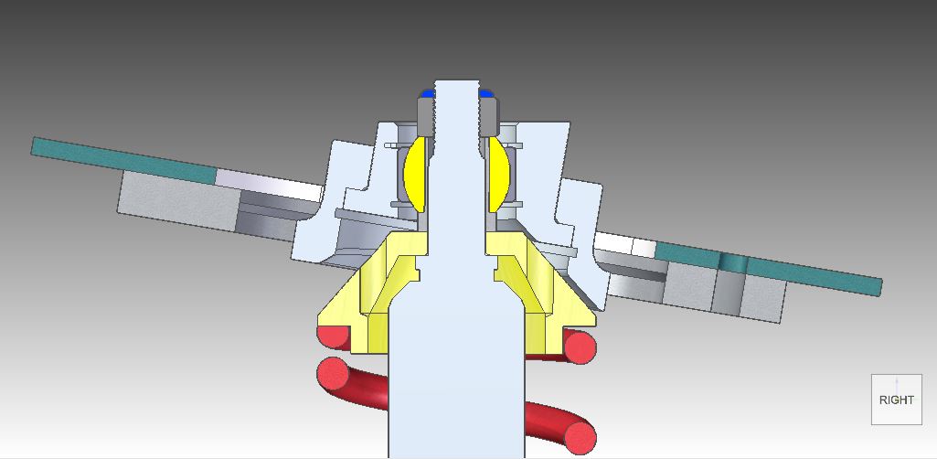

Here is the way it is constrained at the bottom. There is a sleeve which allows for vertical movement of the strut and rotation along the transverse axis of that little sleeve. This is as close as I could get to emulating a worst case scenario of suspension movement without having more information. I realize the point that sleeve is constrained at can move a little bit, but it should only pose a potential problem when the mount is at full POSITIVE camber which I don't think too many people will use. At neutral or negative camber, there is pleeeenty of space!
full camber.JPG (24.68 KiB) Viewed 95242 times
