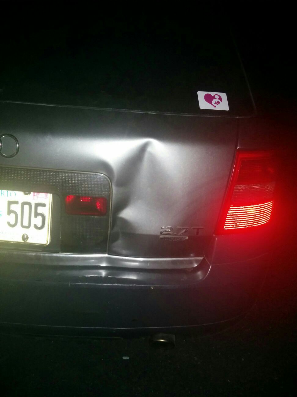

Then I find out later that night that it did this to itself:
Damn! I'm now looking for a hatch in Atlas Grey.

Posted: Wed Sep 09, 2015 3:07 am
How did that happen?
Re: Matt's WIFE'S 01 6 speed Allroad
Posted: Wed Sep 09, 2015 9:12 pm
What the? Hit and run?
Posted: Wed Sep 09, 2015 9:24 pm
It rolled 50 feet backwards into a tree. :sad:
Posted: Wed Sep 09, 2015 9:28 pm
You mean a branch broke off a tree in a recent windstorm, and hit the car... right? RIGHT!?! (Act of God coverage carries no fault/no premium increase)
Posted: Wed Sep 09, 2015 9:30 pm
The tree chased it up the hill is what I mean
