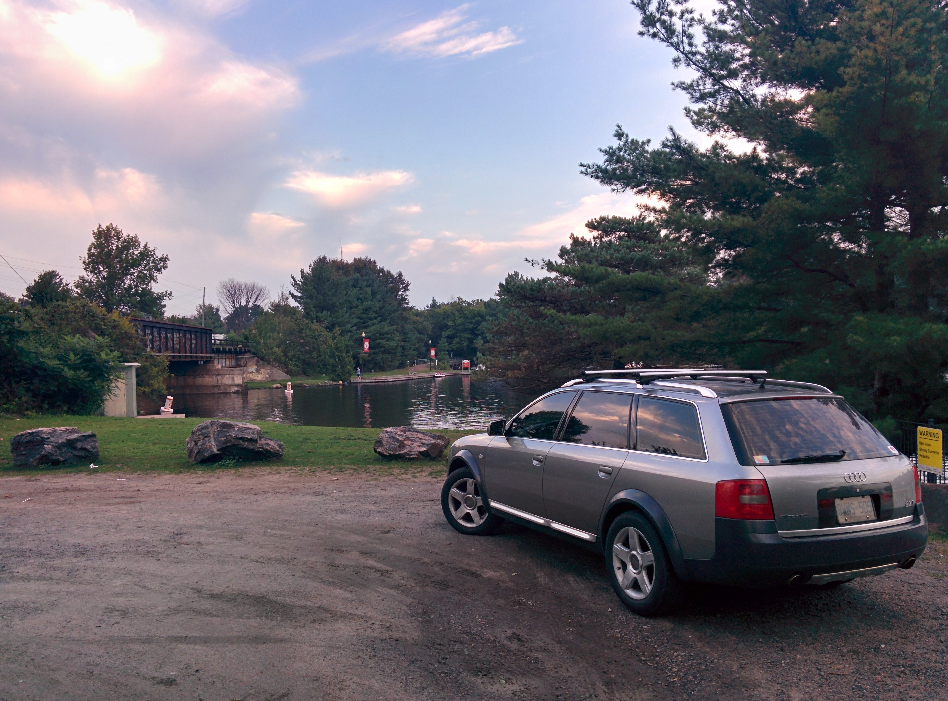

So I took this picture there other day thinking, dang the car looks pretty good in stock form, it just needs some wheels:

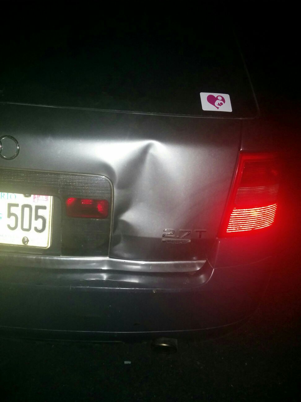

Then I find out later that night that it did this to itself:
Damn! I'm now looking for a hatch in Atlas Grey.

How did that happen?
Re: Matt's WIFE'S 01 6 speed Allroad
What the? Hit and run?
It rolled 50 feet backwards into a tree. :sad:
You mean a branch broke off a tree in a recent windstorm, and hit the car... right? RIGHT!?! (Act of God coverage carries no fault/no premium increase)
The tree chased it up the hill is what I mean
