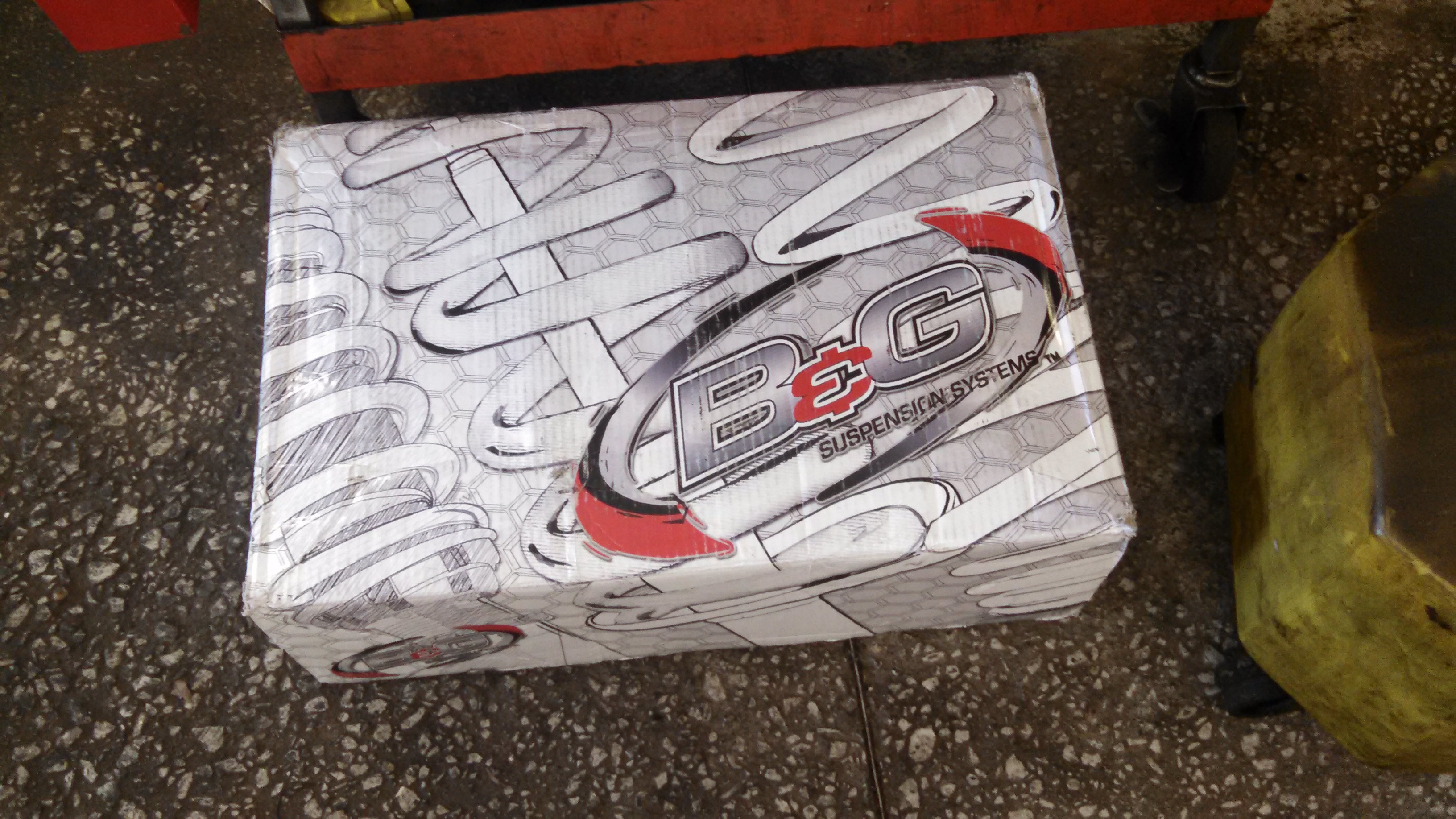

by RS4Tech
Got one major part i was waiting for today....
One more box away from this thing being on the road
