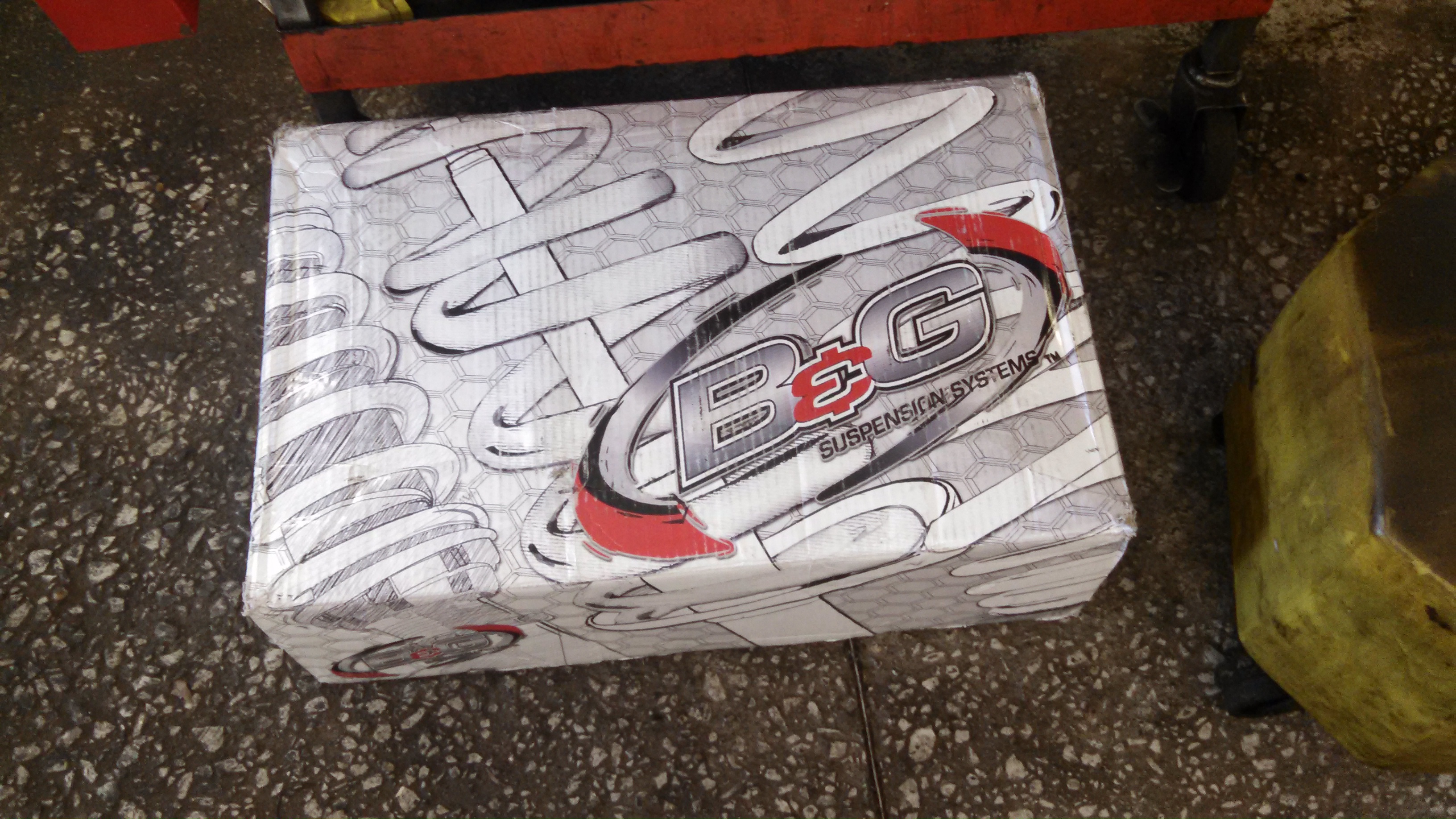

Got one major part i was waiting for today....
One more box away from this thing being on the road

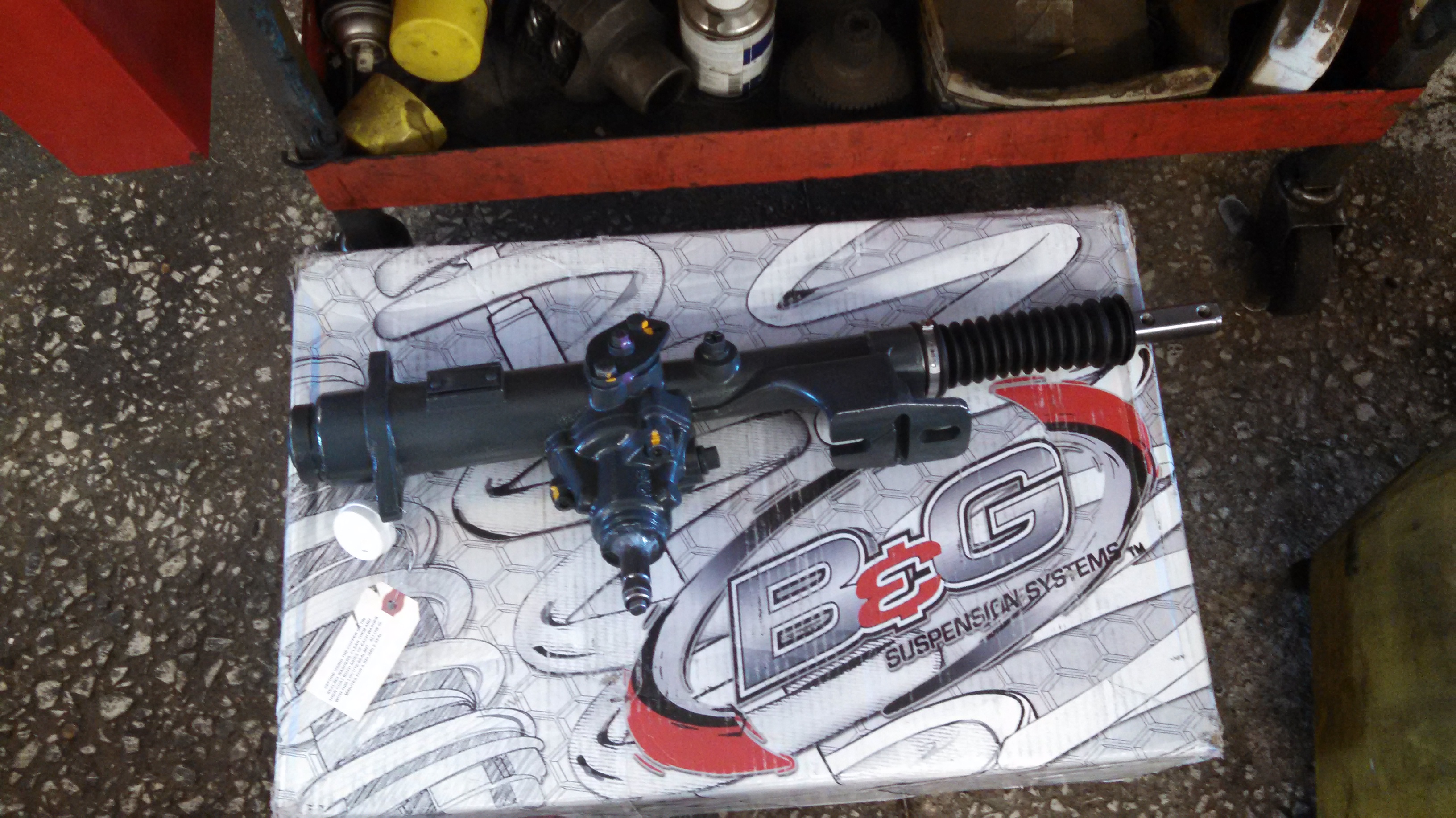

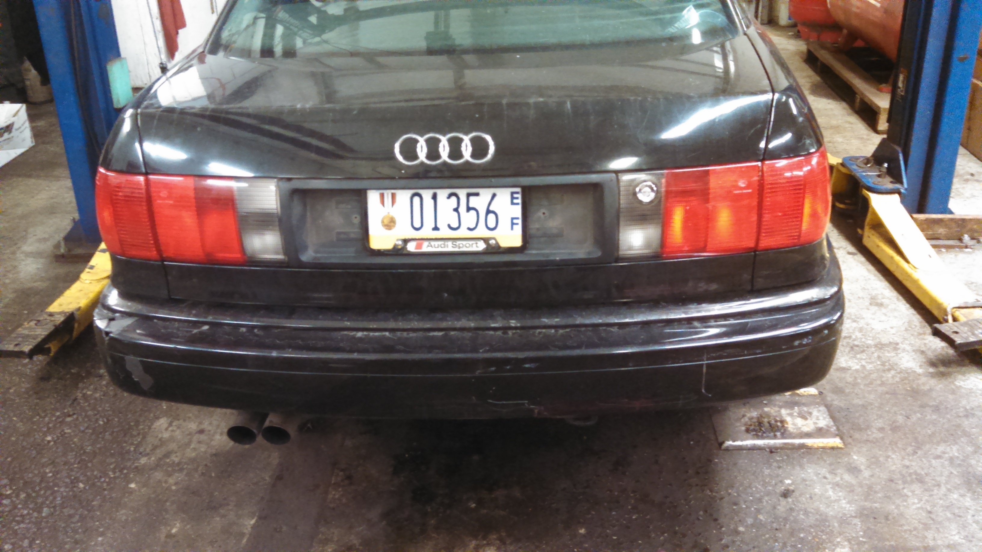

Got my euro inner tails and licence plate bracket installed today...
Now for my dilemma...in my order from across the pond I got sent the euro outer tail lights. They weren't part of the order, so they are kind of a bonus to me. They are the ones that look like they are red but light up amber. The question is do I install them or sell them? What is the market for just the outer lights for a B4? I am impartial since I do not mind the red US spec lamps.
I also got my rebuilt B4 sport short ratio steering rack from Morgen Automotive the other day. That was the last part I needed to get this car on the road...now to just get working on it so I can drive it.

PRY4SNO wrote:Nice. Always thought it was just the RS2 rack.
How much for a rebuild w/ core charge?
$337 shipped to my door including core charge, bit they are running low on core stock so unless you have a core they are hesitant to sell them. Luckily both of my B4's came with sport racks as cores. They are 2.6 turns lock to lock opposed to the standard 3.2 turns
