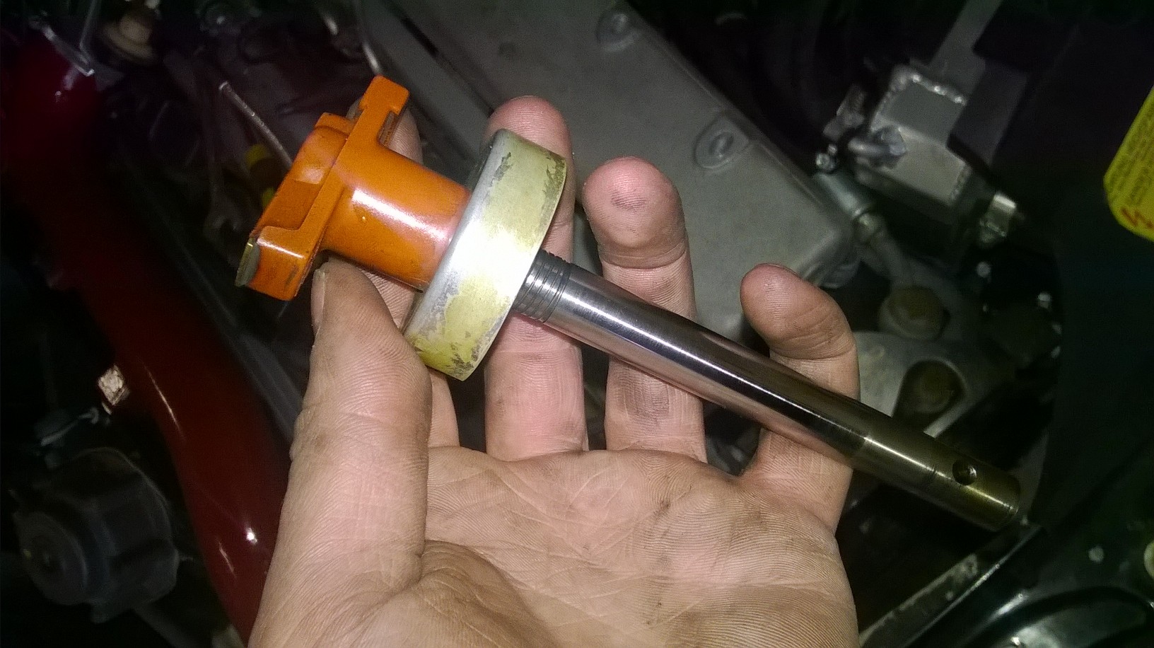

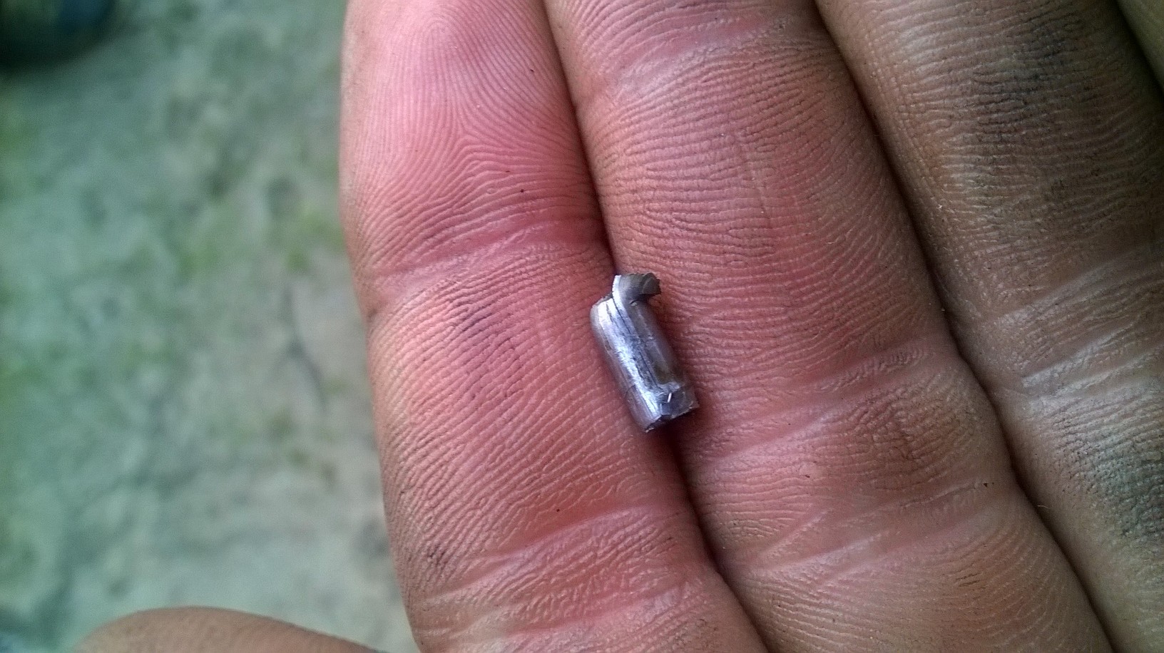

Next, remove the distributor.
Got scared when the distributor axle ( or what would you call it.. ) came off whitout the distributor gear.
The pin was gone and all I found was this:
Gotta hope the rest of it is in the oilpan..

Suprise, suprise.. It's the hall sender. Got the code again from vag-com.
Re: 220vt from Finland
Posted: Sat Jul 11, 2015 10:41 am
Makes sense. Good luck with the fix. These old girls are really showing their age these days!

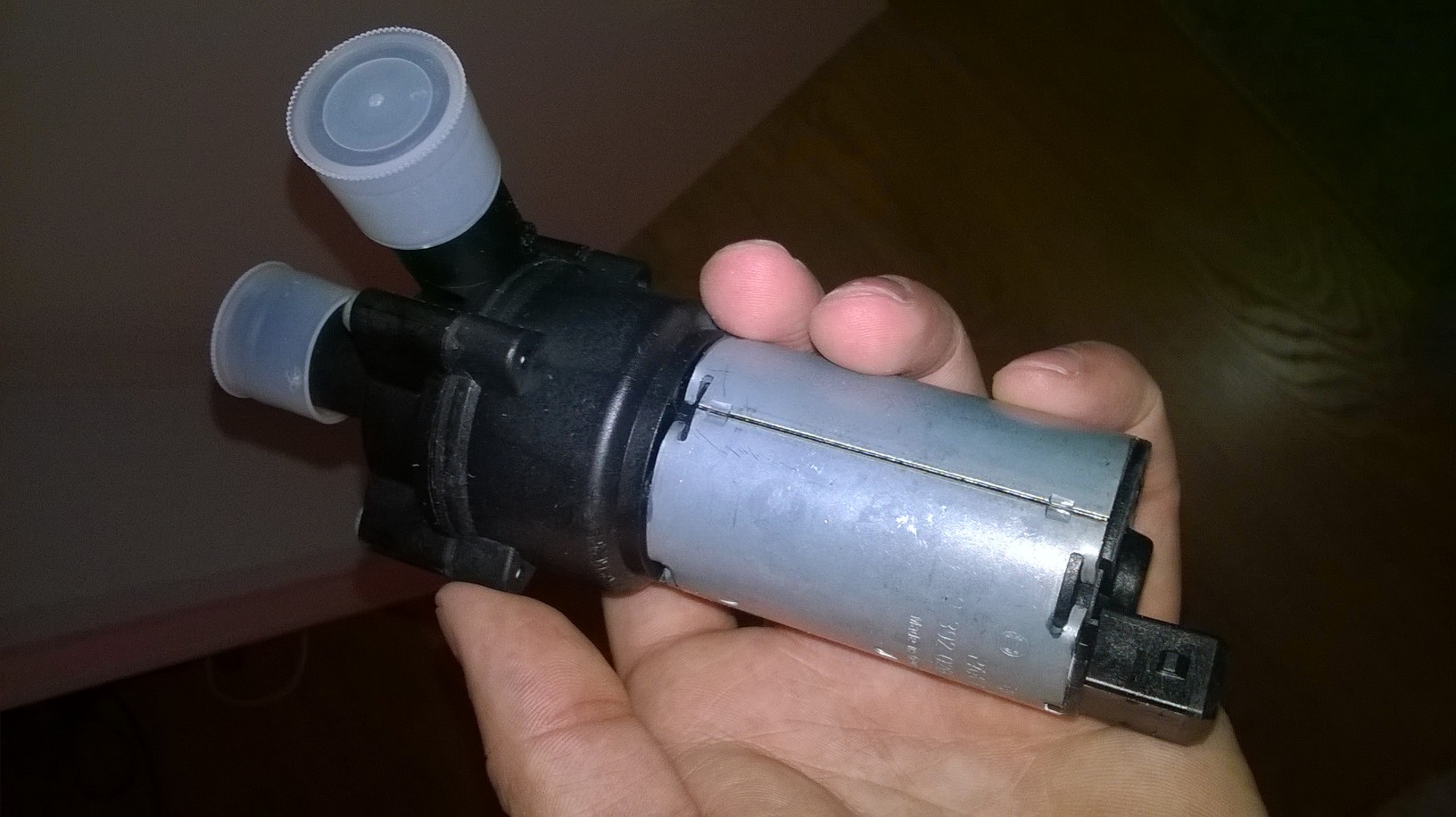

Also bought new after run pump which is a bit shorter than oem part, but fits nice and does the job. Replacement was also quite much cheaper, an Opel or Saab part I believe.. :roll:
Bosch part no: 0392020034

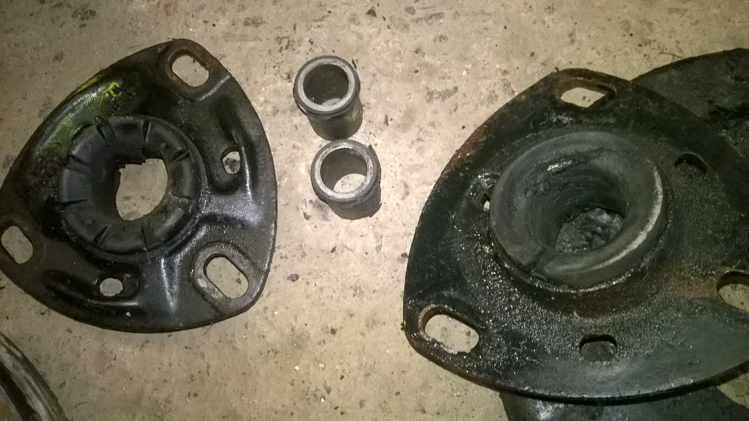

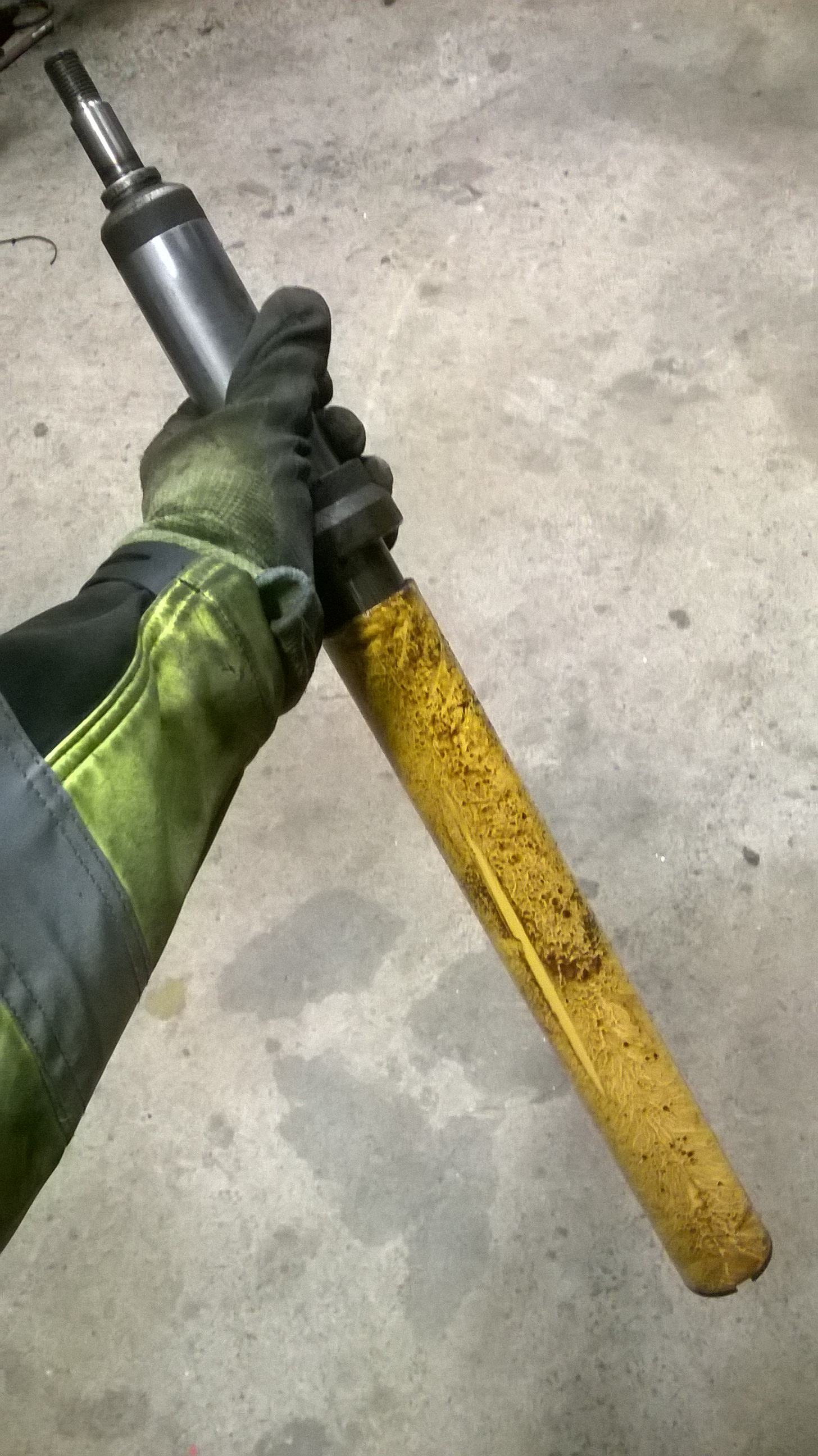

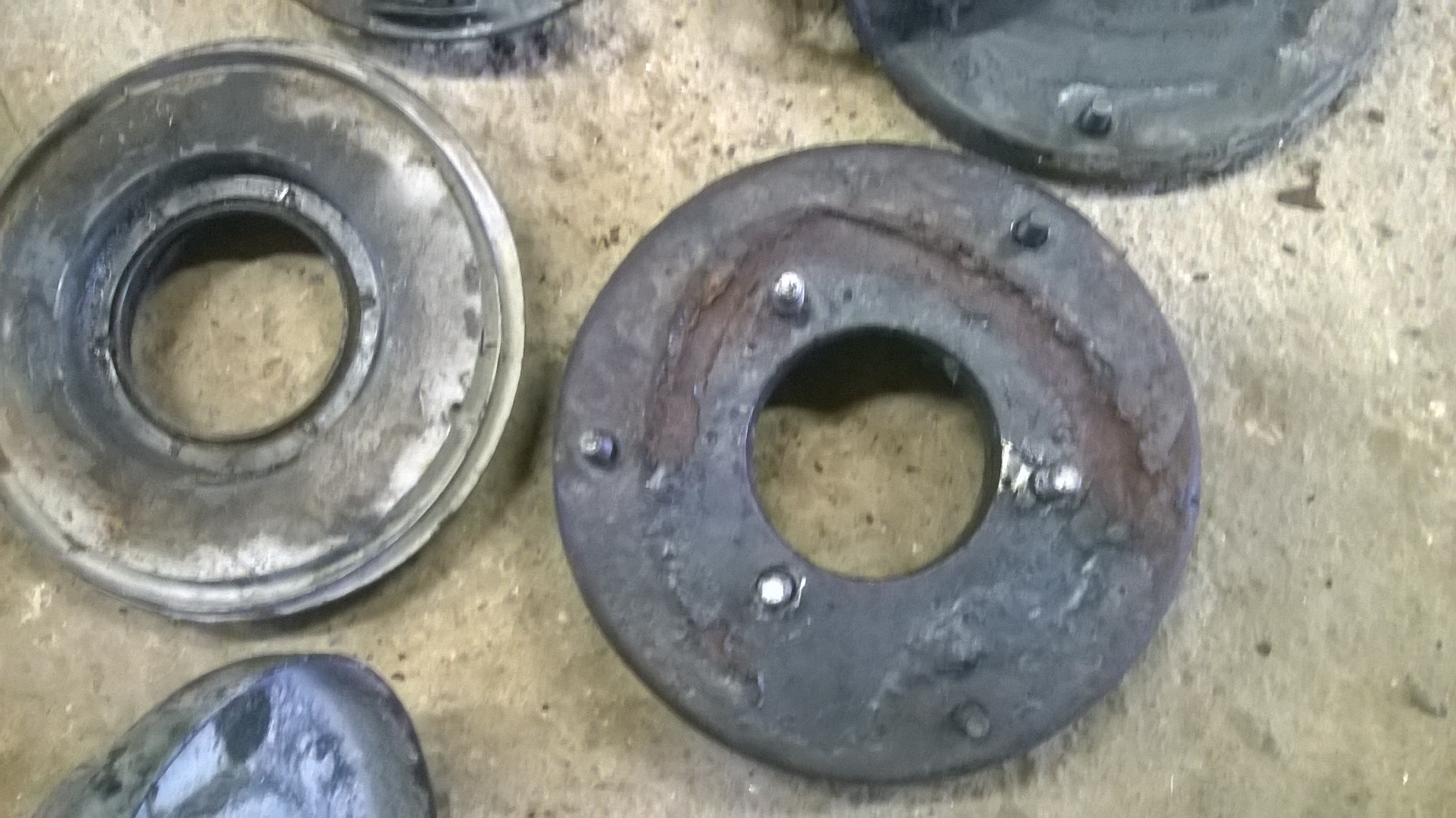

Seems it was about time to change the shocks.
old shock.jpg (1.51 MiB) Viewed 52714 times
The upper mounts were also in grade a shape..
top notch top mounts 2.jpg (1.47 MiB) Viewed 52714 times
top notch top mounts.jpg (1.56 MiB) Viewed 52714 times
As well as every other bushing. No wonderthe car was interesting to drive around. :roll:
Should have done this a long time ago..

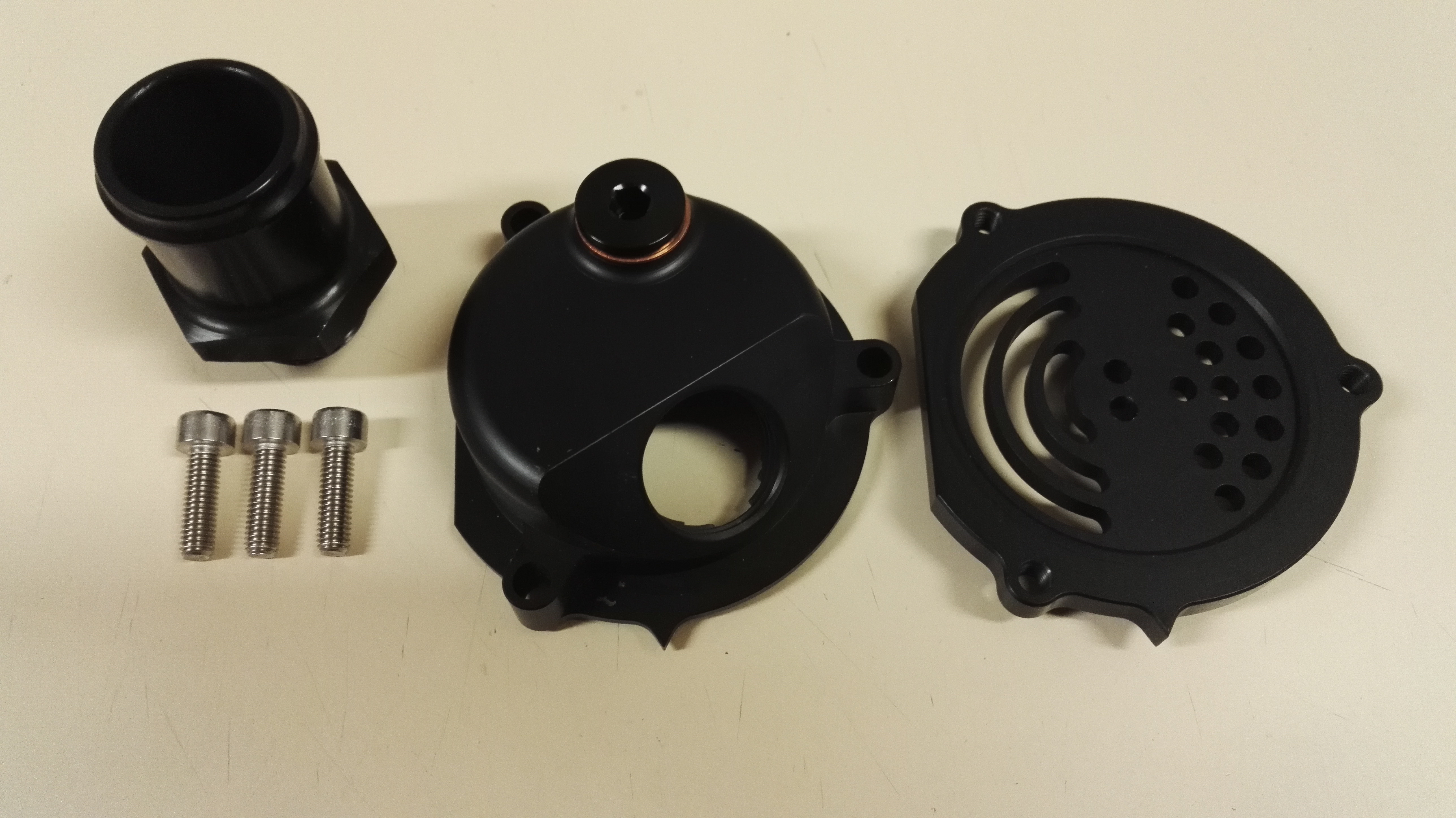

Already got some goodies from iABED Industries through S2forum group buy, the crankcase breather :
Big thanks to Issam for these, gotta love some billet goodies.
