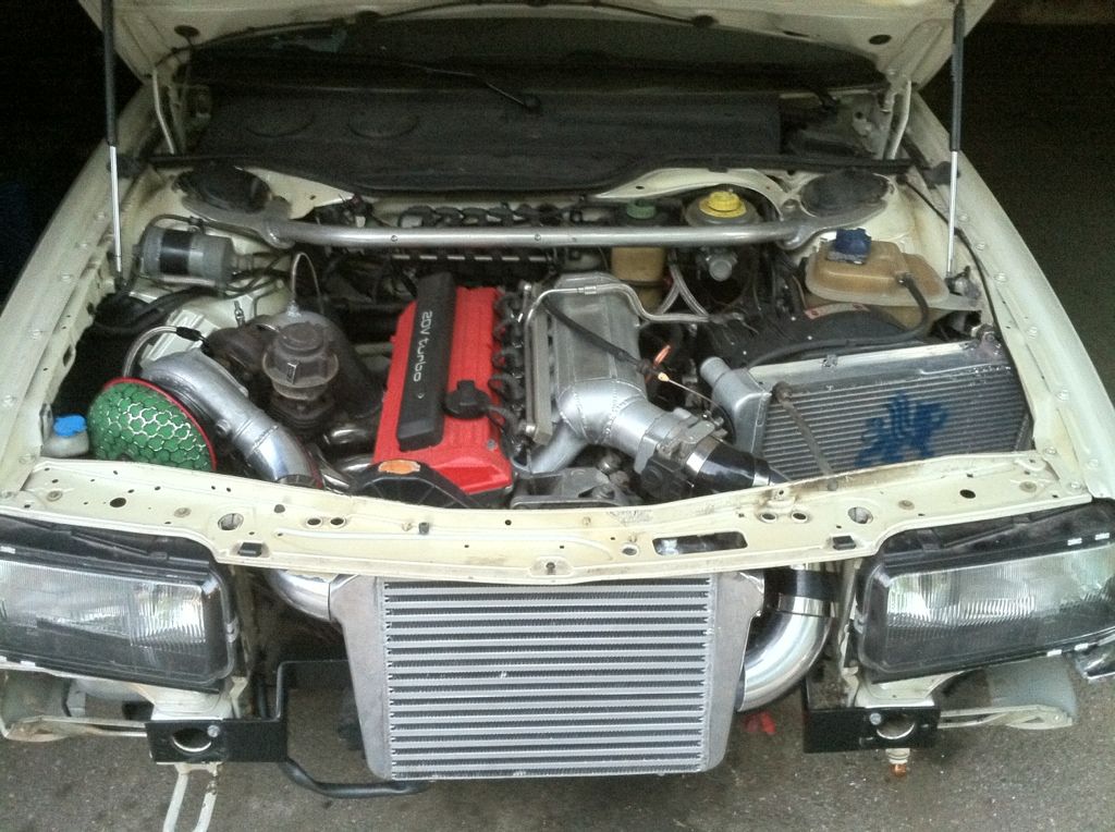

I would be very surprised if that wagner manifold cleared the hood. It sticks pretty darn high in the bay. If you look at the manifold I built for Casey's 200 20vt, we had to put the throttle cable on the side instead of vertical like the Wagner, plus add width to the plenum, as the height was limited. It is a very tight squeeze, even with a custom radiator.

Hank! Any other surprises you know of coming my way? No, really... Before I bought the manifold, I started looking at flow numbers for each runner in stock form, googled pics of them installed in 200's which most ere in Europe, and read some forums about guys who had th in the cars. The general conclusion was that they were having problems getting them to fit with the phenolic spacer. I read where one guy actually had his spacer milled down some to give him the clearance he needed. There was one horror story where the guy didnt know he had a torn engine mount and when he launched, the motor torqued bumping the bottom side of the hood. I'm sure it is close, but this is one time I hope you are wrong. :-). If you are right, it will only force me to fab that custom cowl hood I was talking about. It sure would look good with a cowl hood and v8 front and rear fenders.

I have never seen a wagner on a 200, so if you have, I am sure it is fine. It iwll be very close though

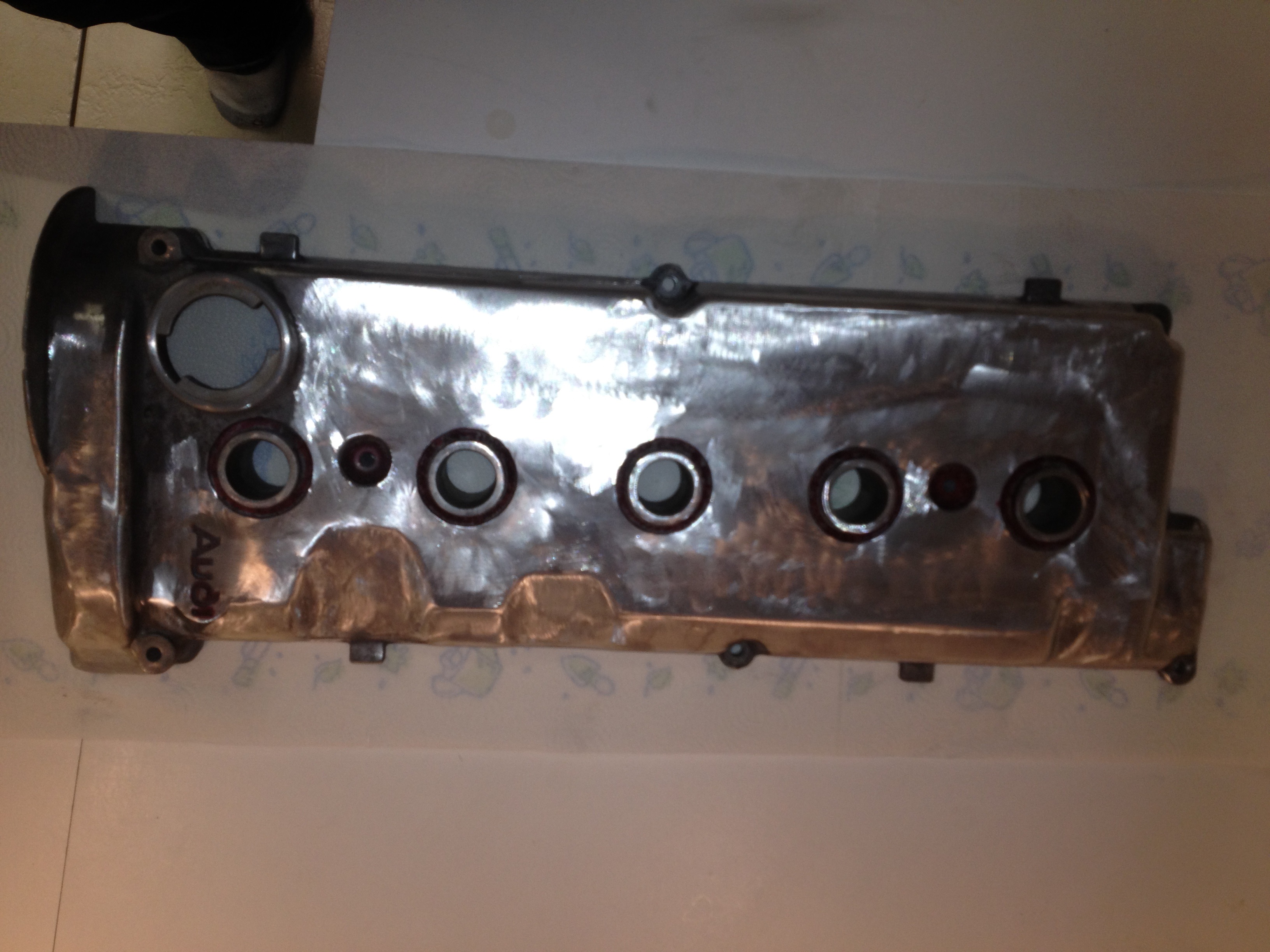

I said I was going to post some ideas I was kicking around for the valve cover. I didn't know which Audi emblem to use and what location. I want it to look almost factory placed if possible. Here is a pic when I started grinding and another when I was getting closer.
