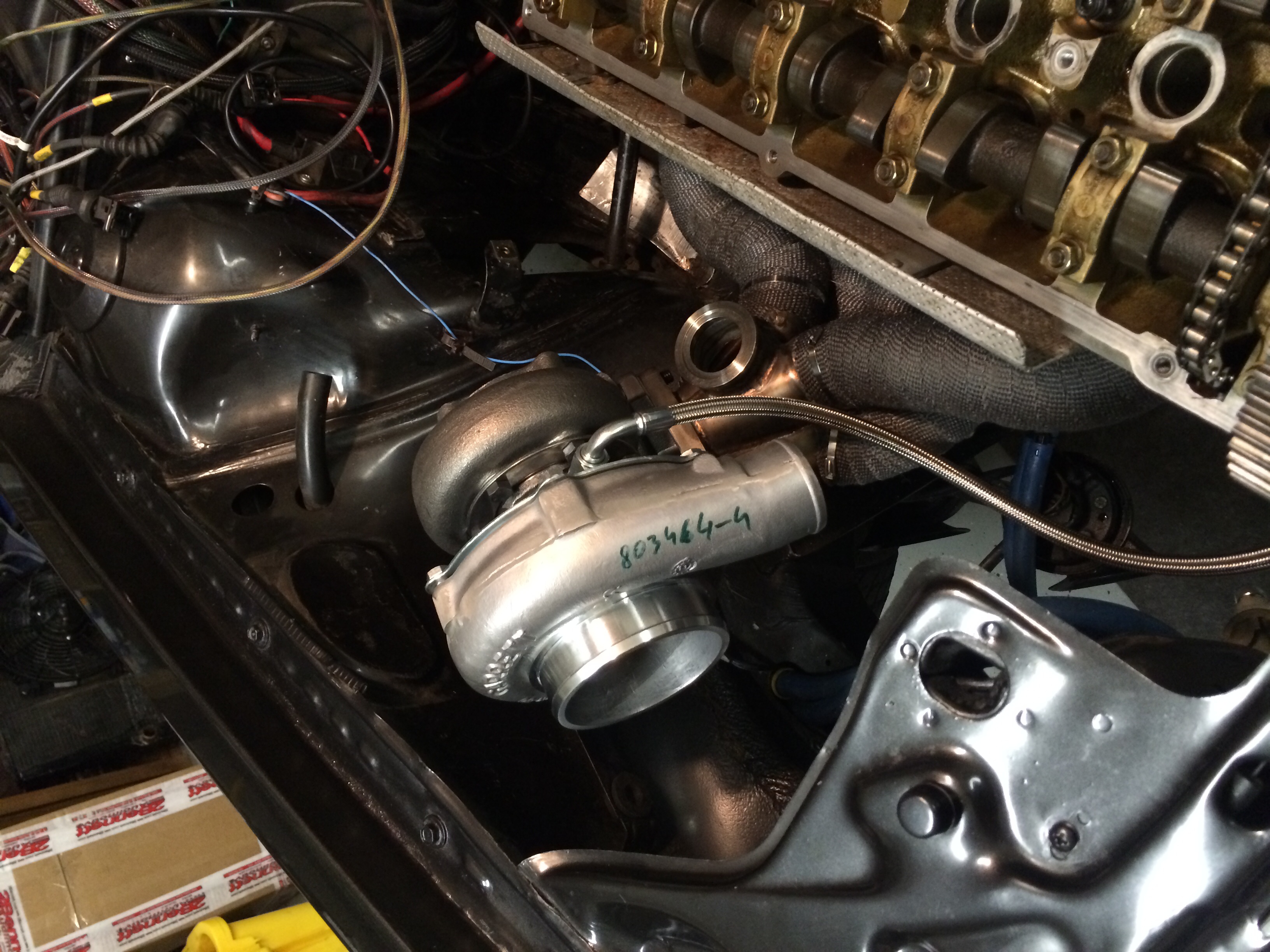

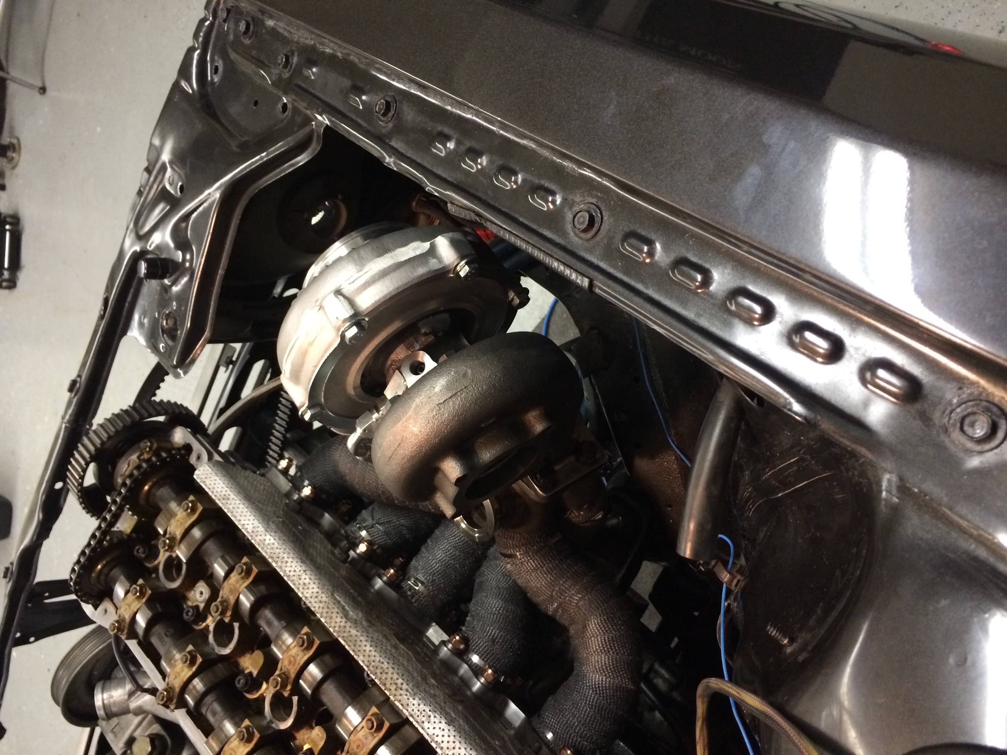

Making "headway"
- image.jpg (2.15 MiB) Viewed 52807 times

Nice! Getting right at it, I like your style. Running by Monday? lol.
You will love that turbo. If you thought it was fast before, you're in for a treat. What fuel pressure regulator are you using, an AAN one? You'll need that slight bump in fuel pressure for all the fuel you can get. I was at 86% DC with a 4bar 7a and the 60lb Siemens. Oh, and are you using a bigger fuel pump? 044?

I have a new 4 bar FRP. I also got those 60lb Siemens. From what I have read the stock Bosch fuel pump will work well beyond my needs so I am just putting a new one in as well as a filter.

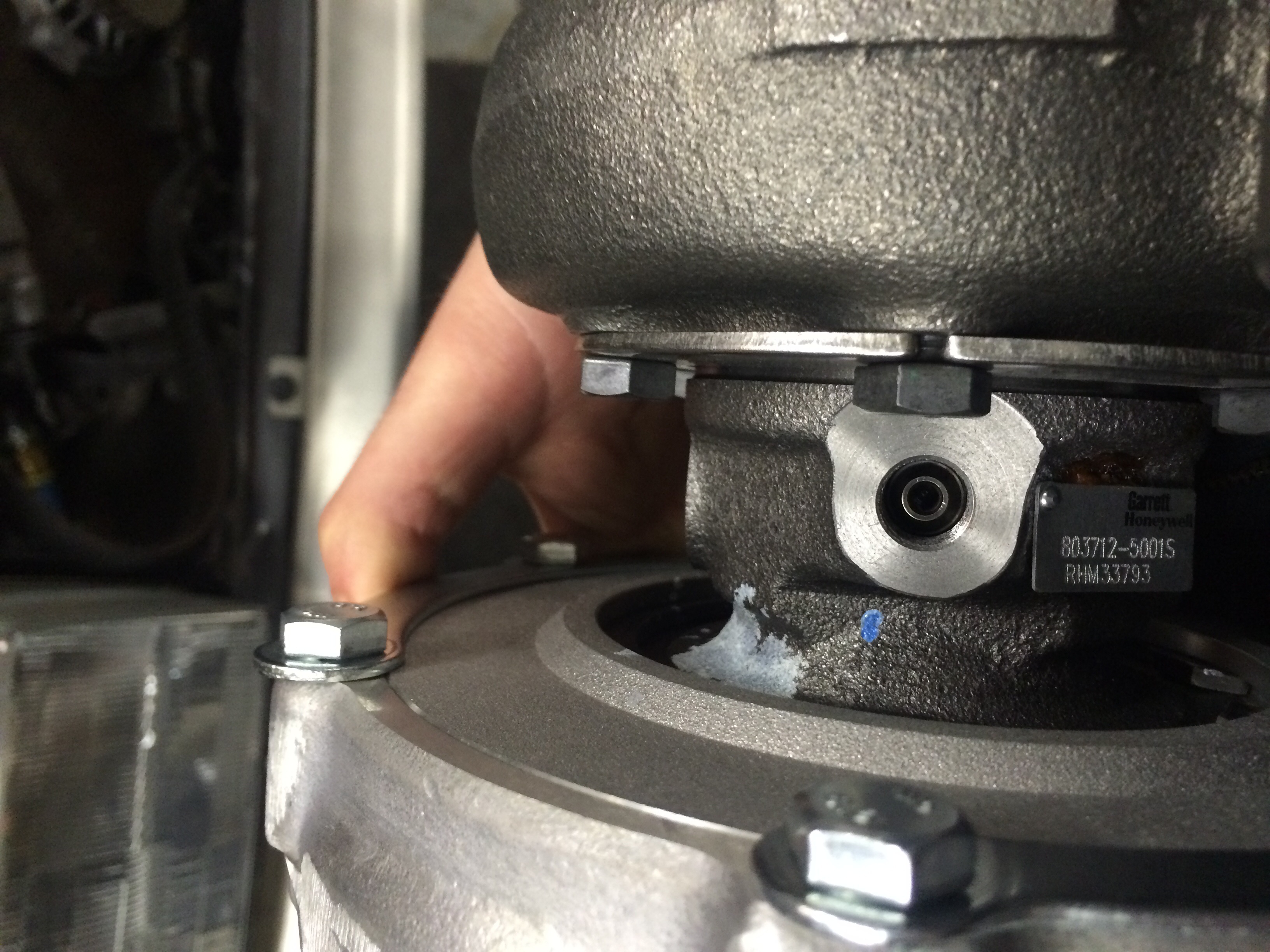

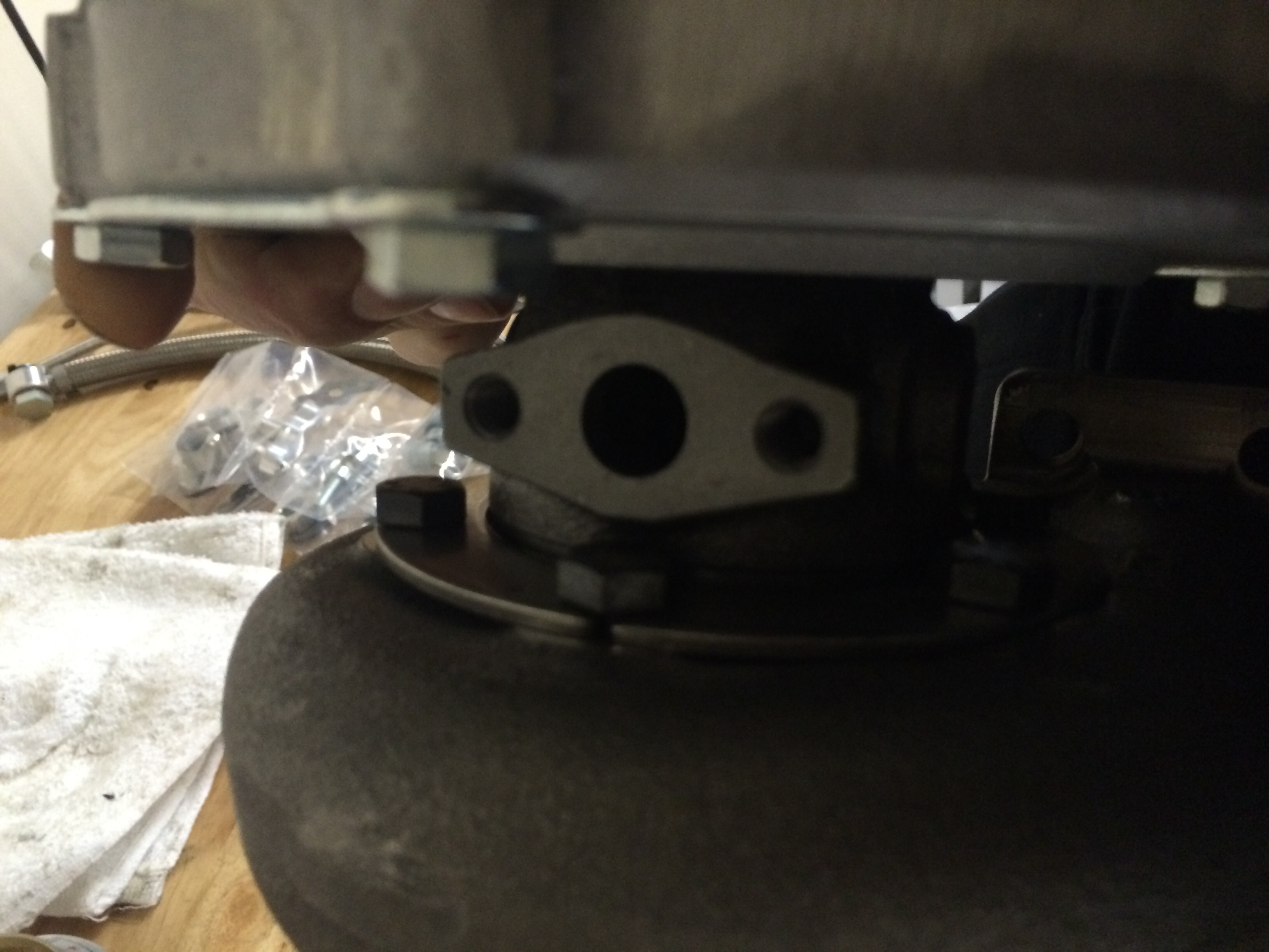

I have a question for you: How do you know which connections on the GTX housing are the oil supply/return and coolant supply/return? I need to get this thing oriented right and can't even figure out what hole in the turbo goes to what.

Oil inlet is the smallest and should have a restrictor fitting, oil drain is largest and needs a flange, use -10 hose at least.

Is this the oil inlet? What is that little piece on the inside? It's not a built in restricted is it?
This is the smallest hole on the turbo
- image.jpg (1.64 MiB) Viewed 52776 times

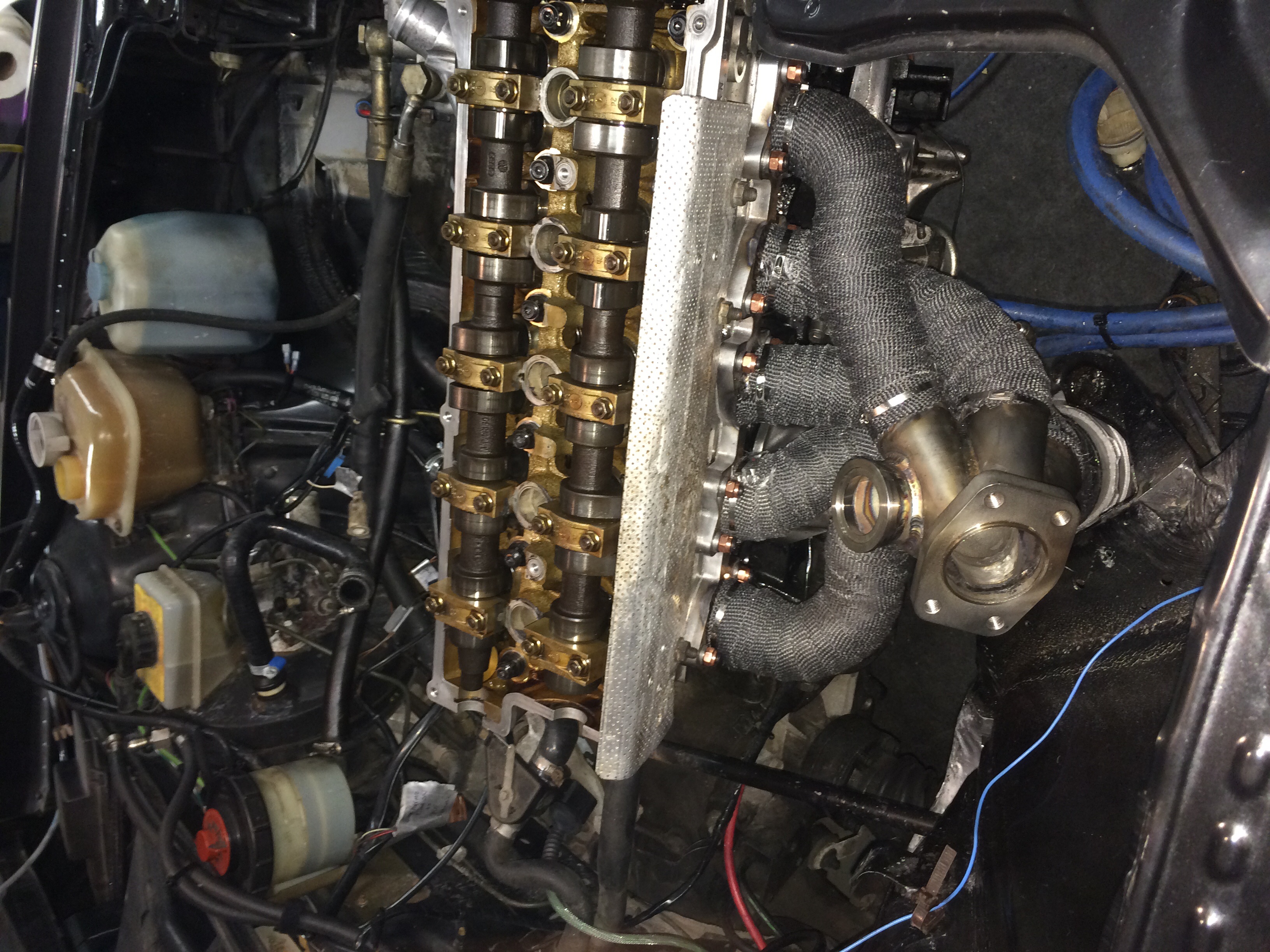

And then the opposite side would be the drain. It has provisions for a little flange

Like this
- image.jpg (1.13 MiB) Viewed 52776 times

Yes, that's the inlet and drain. You need fittings like these

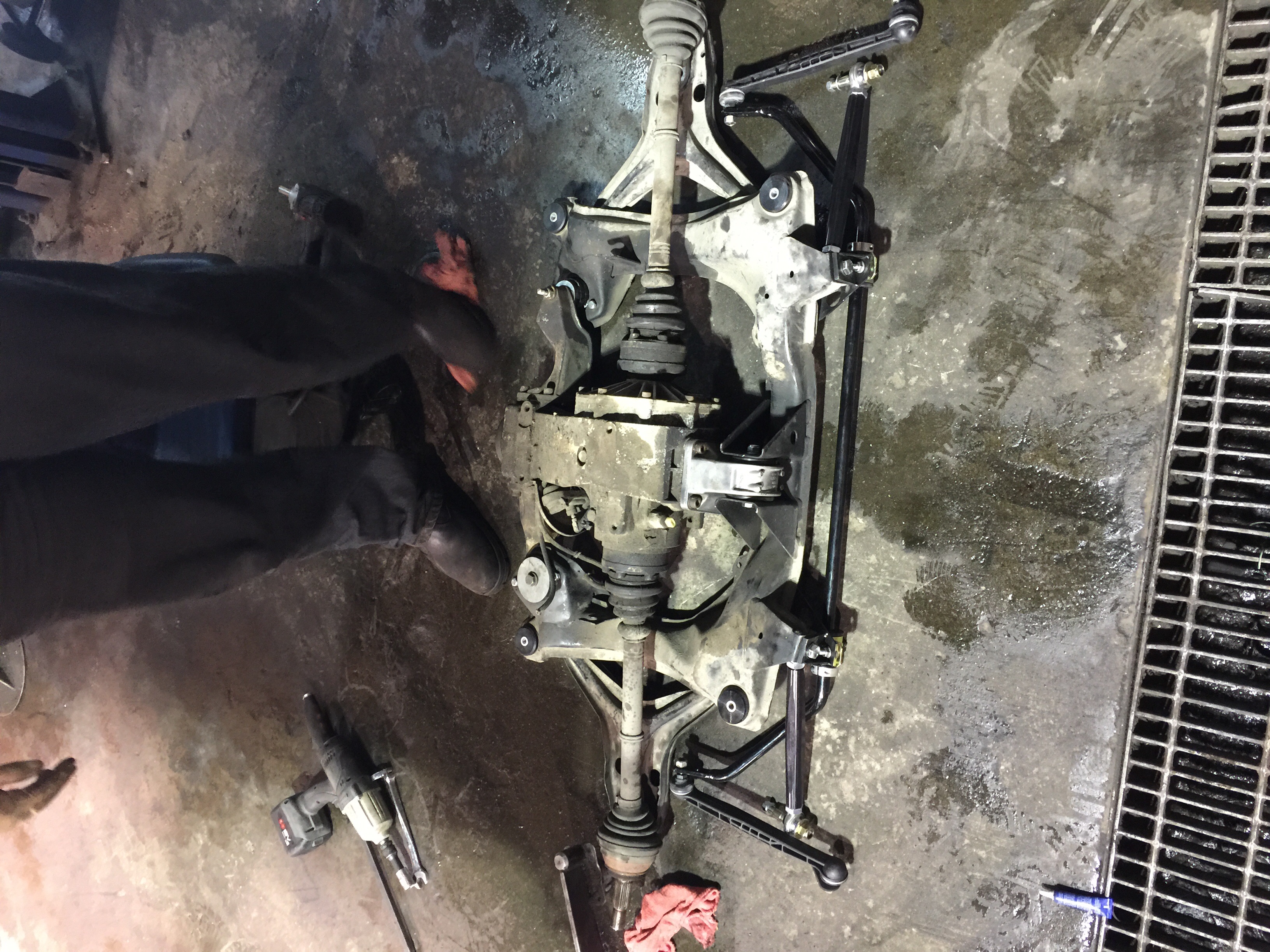

chassis work starts tomorrow, we will see how Taco's bushings and mounts work out...
- Chassis work starts tomorrow.......
- IMG_2641.JPG (2.2 MiB) Viewed 52387 times

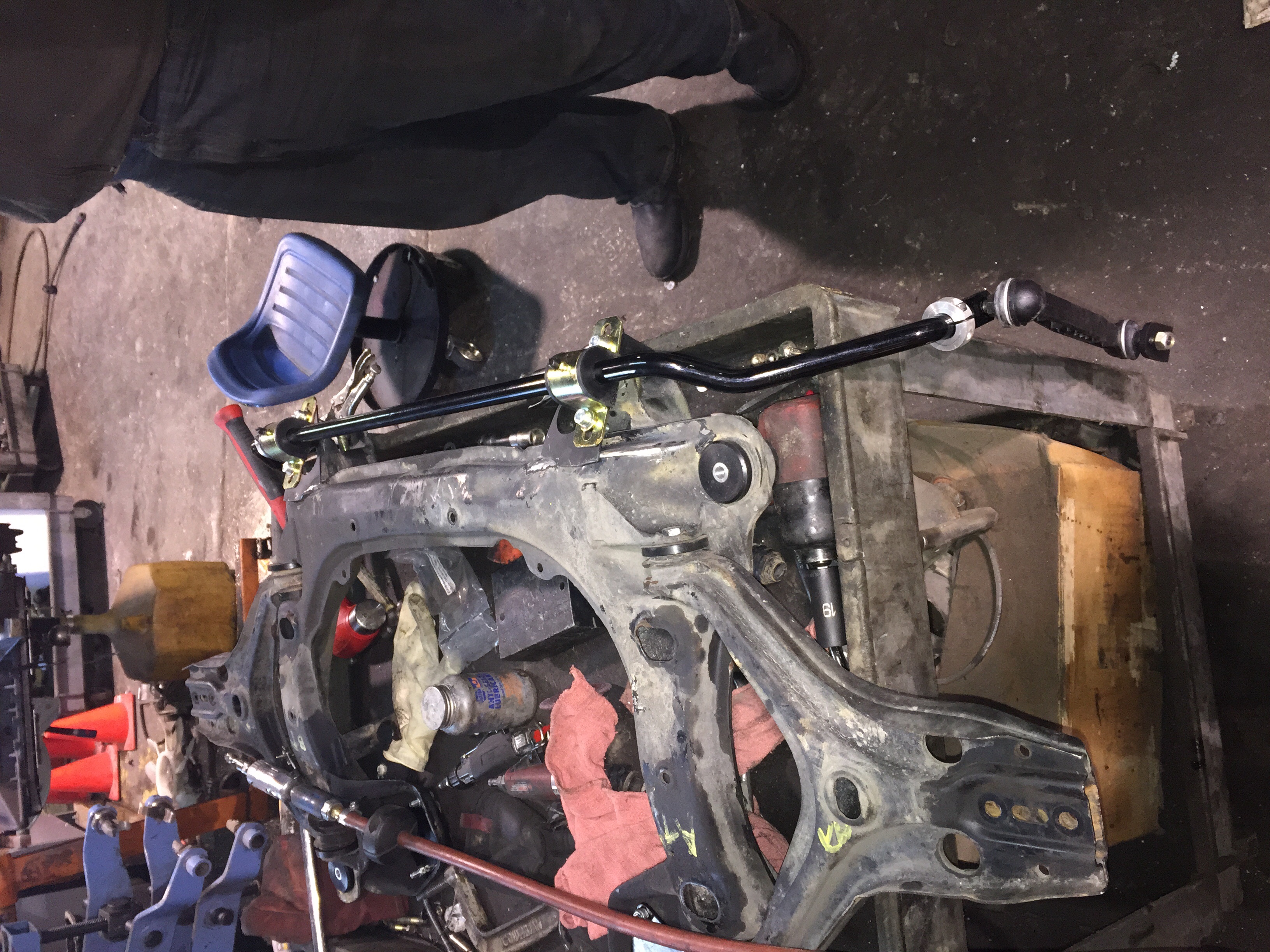

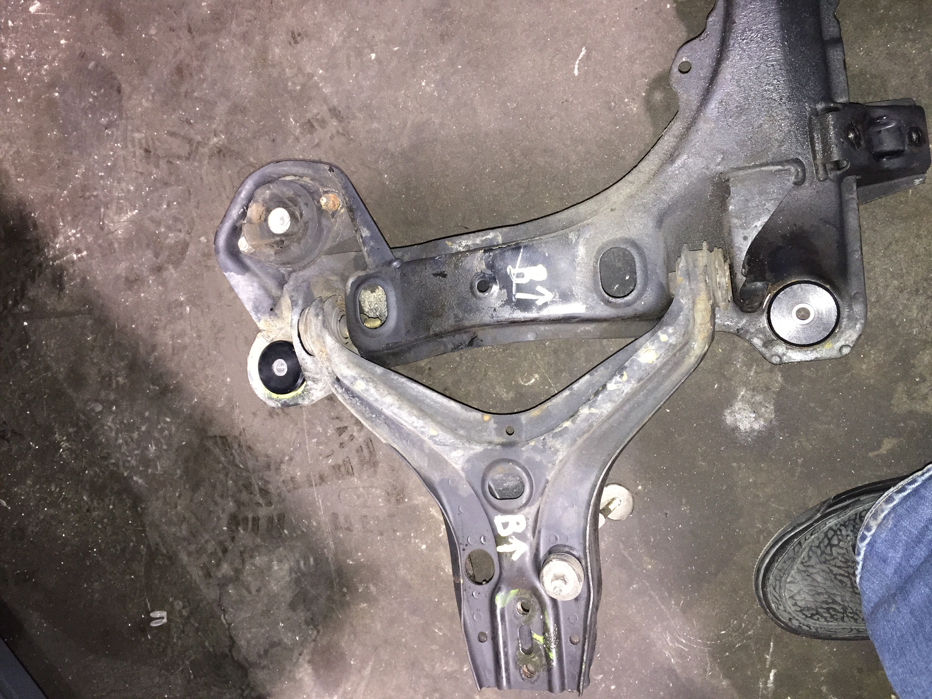

Subframe bushings and tranny/diff mounts ala HERSH performance. Subframe bushing were a dream to install. 2 piece setup, awesome.
Installed a rear sway bar and replaced everything that can be replaced under the car.
Installing my coil overs tomorrow then I'll report how awesome this thing drives.
