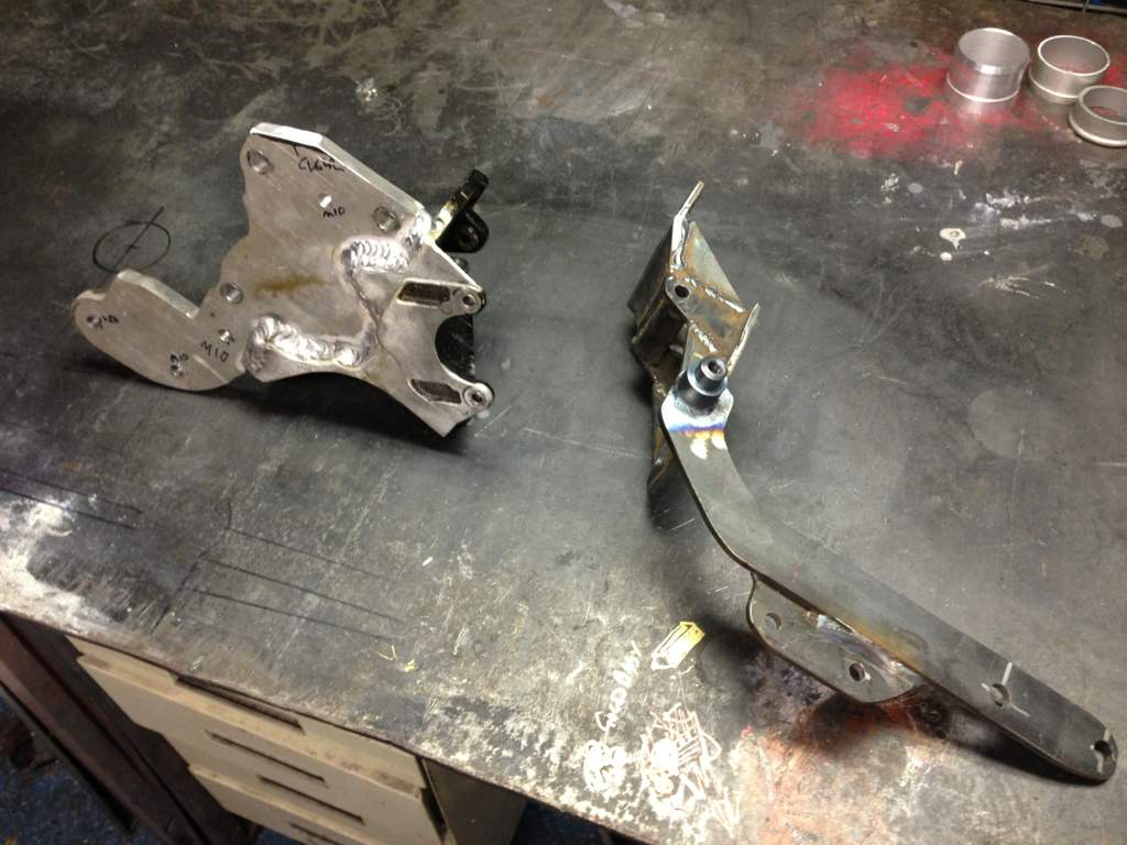

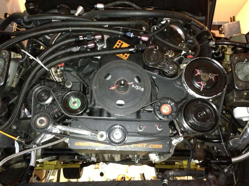

Been over run with billable work, but have been sneaking in a few hours here and there.
Should wrap up the serpentine belt rebuild rev 6+ tomorrow

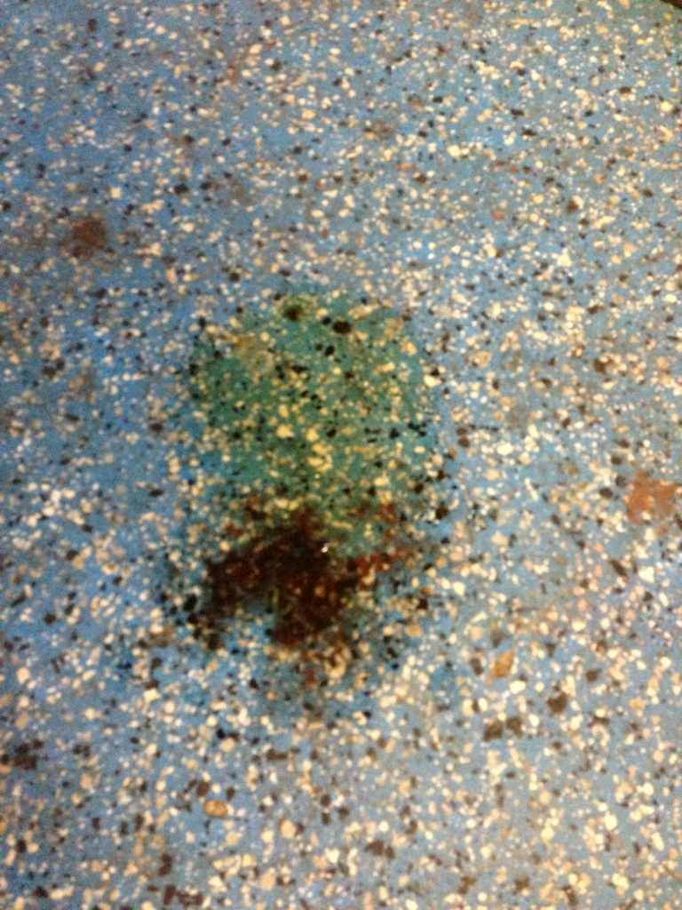

I was seeing oil out of one tailpipe and my custom sight glass on that turbo drain was full. That turbo was leaking oil past it's seals. Ordered a pair of t3 rebuild kits with upgraded thrust bearings and seals, again from eBay for $30 a kit. Interested to see what the bearings etc look like.

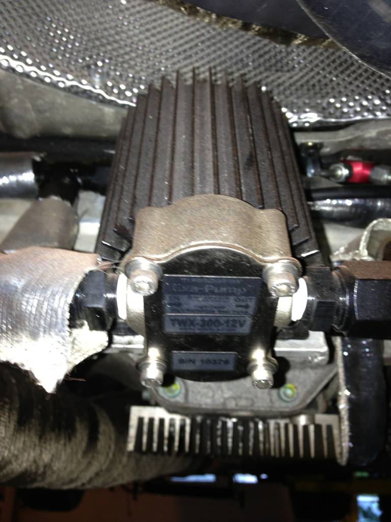

What are you using for a sump pump to get the oil back to the oil pan? It is extremely hard to blow out seals on a turbocharger, and usually if they are leaking, it is because they are not getting proper evacuation of oil or have improper oil restriction.
HT Motorsport
Posts: 350
Re: 'Judas' 2003 Audi RS6 with 383 stroker TT
Post by HT Motorsport »
Remember these are Chinese eBay turbos. Interested to see what they look like inside.
Pump is an all singing and dancing unit by exa
In tests it will pull 30in vac, but this pool of oil on floor after 30 seconds run time today illustrates the leaking seals well

I fired it up today and the new belt setup is perfect so far. Tomorrow I will rebuild turbos and refit the radiator for a test drive

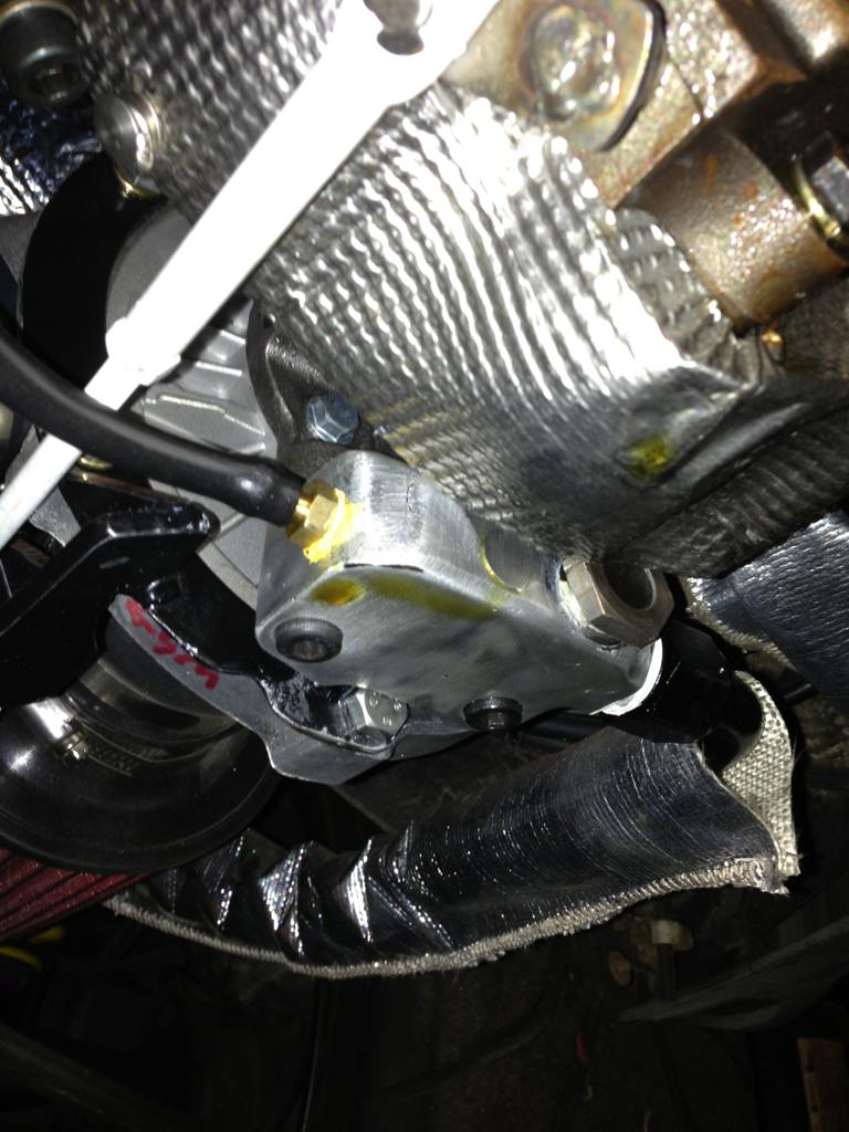

Today I pulled the turbos for review and install of the turbo bearing kit with upgraded bearings and seals.
When I pulled the passenger side turbo about a quart of oil came out of the hot side, so the seals were toast for sure.
I was interested to see how these eBay turbos looked inside and overall they were not bad. The seals and shaft seal rings were certainly sub par quality compared to the parts in the rebuild kit.
Both turbos are rebuilt and back in now. I did a leak vacuum leak test and they are way better. The pump will pull about .5" vac without the motor running.u have to wait overnight for the gasket sealant in the drain to cure. Tomorrow I will put the radiator etc back in and fire it up and see how the pump scavenged the turbos. If all is good ill take it for a road test for the new serpentine belt setup, and hopefully all will be good so I can button it all up to get it roadworthy.
