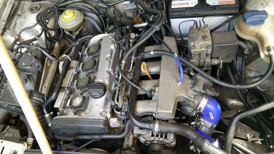

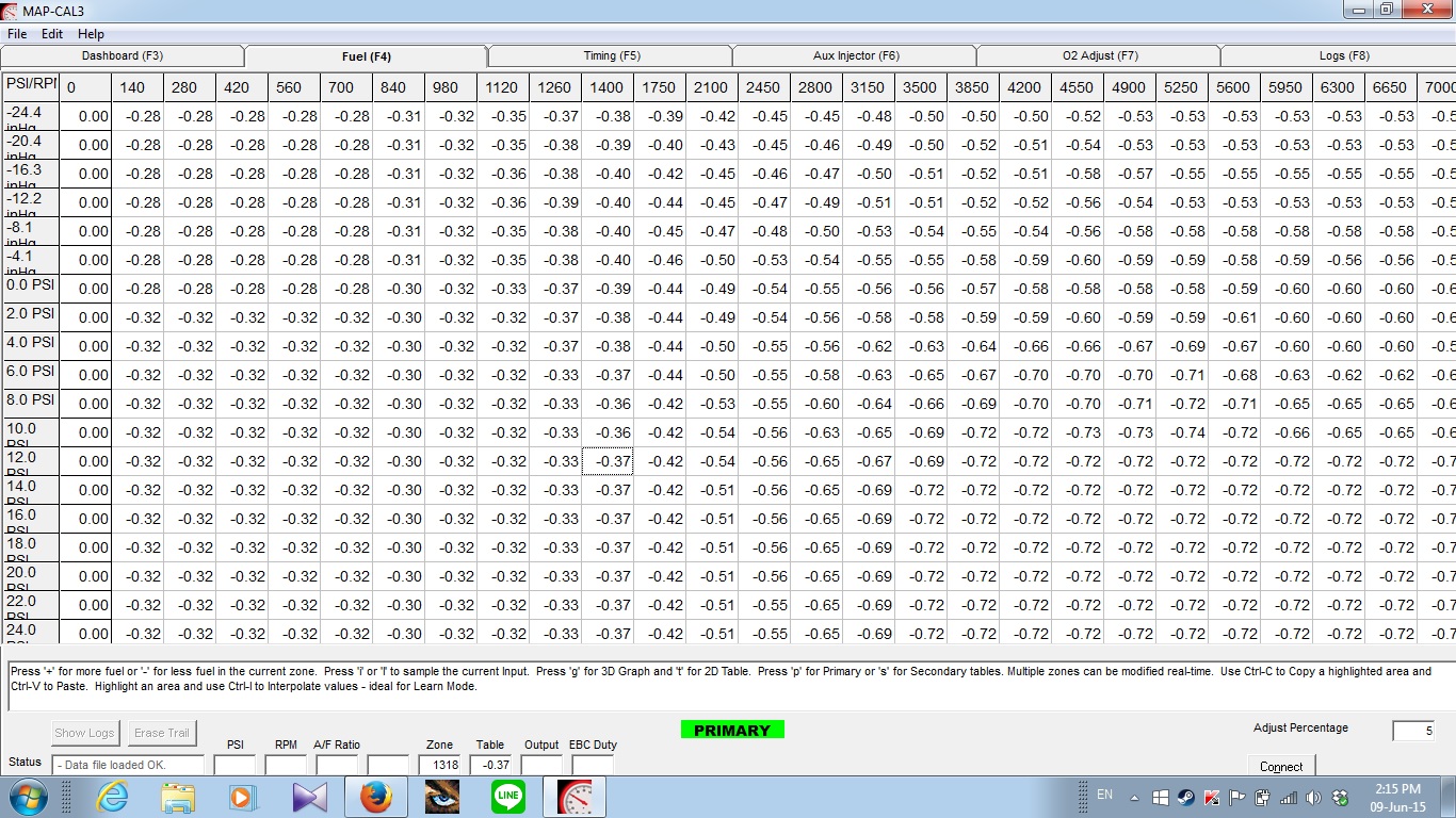

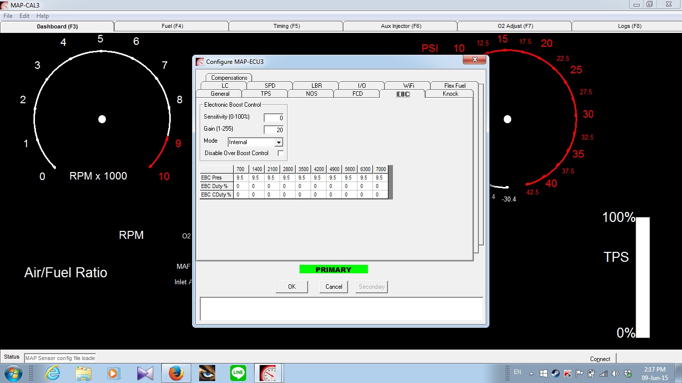

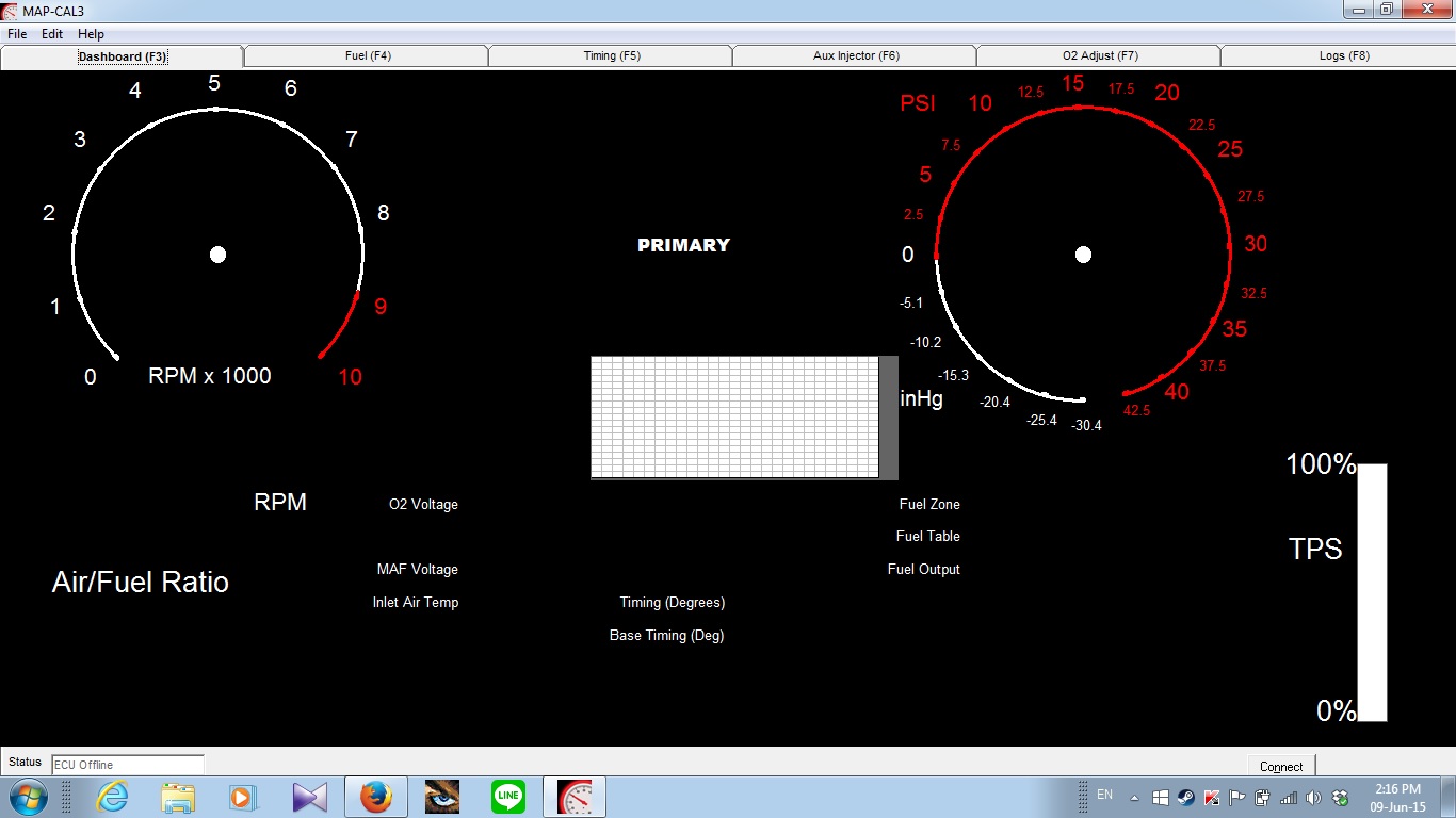

I have attached a few pictures of how she sits now and some screenshots of the MAP ECU3 application. I have one of my spare slightly damaged CF hoods on there now. My own prototype hood is borked.

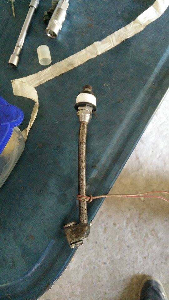

Included a pic of a neat tool for removing the injector cups safely without cracking. They seeped a bit so my buddy sealed them up with white plumber tape. Worked great.

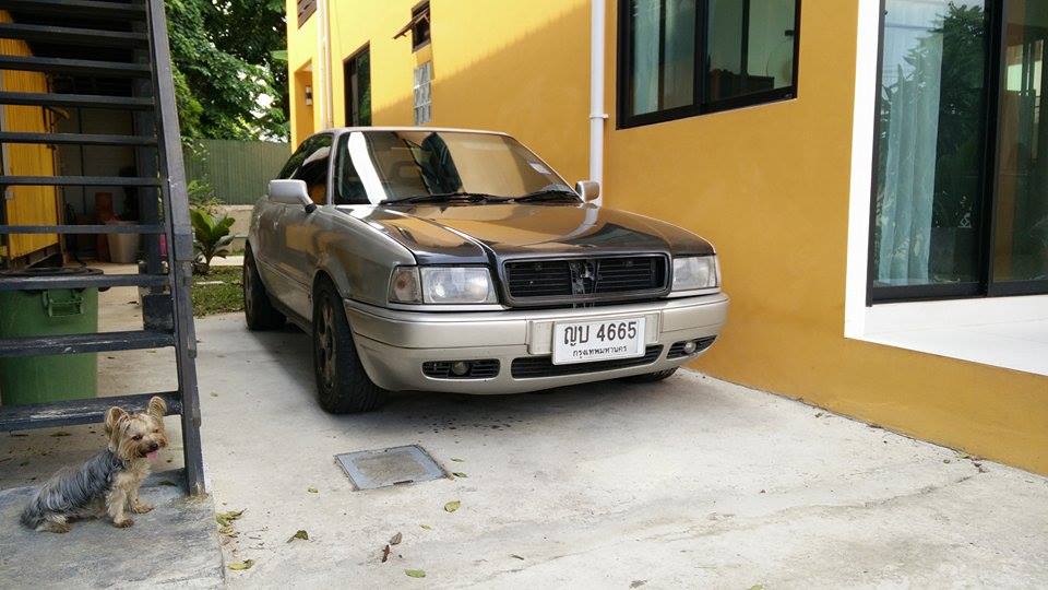

- Front with gratuitous Yorkshire Terrier called Candy
- 11419716_851089014938327_425126450_n.jpg (79.42 KiB) Viewed 58830 times
- ghetto engine bay
- 11428965_851089034938325_586460460_n.jpg (105.97 KiB) Viewed 58830 times
- These values are voltage adjustments of the MAF signal
- Fuel table.jpg (531.33 KiB) Viewed 58830 times
- The MAP ECU boost controller
- EBC.jpg (166.66 KiB) Viewed 58830 times
- Dash of MAP CAL
- Dashboard.jpg (143.54 KiB) Viewed 58830 times

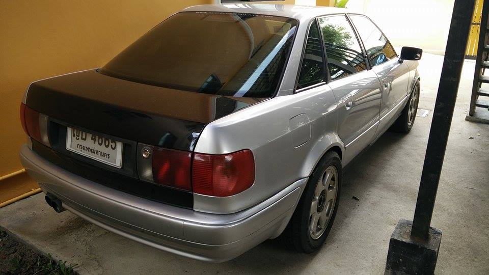

Obligatory ass shot
- injector cup removal tool and tape
- 10723575_851089168271645_2015295760_n.jpg (65.21 KiB) Viewed 58830 times
- Dirty ass
- 11414780_851089018271660_1394337477_n.jpg (70.19 KiB) Viewed 58830 times

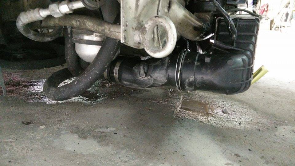

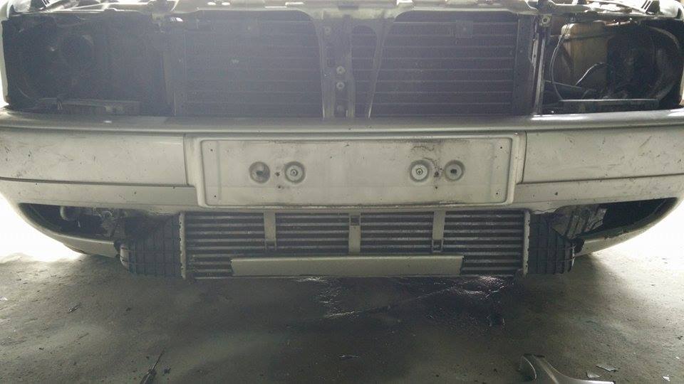

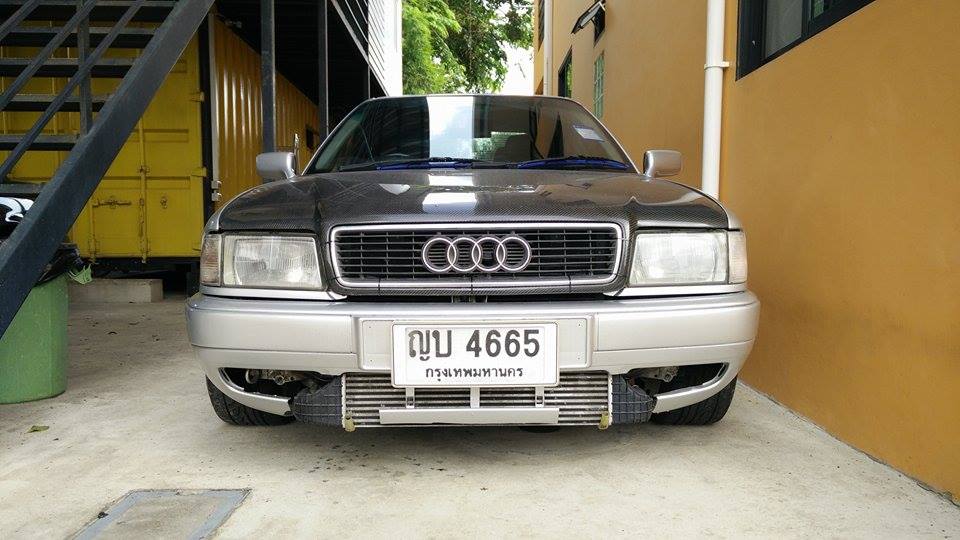

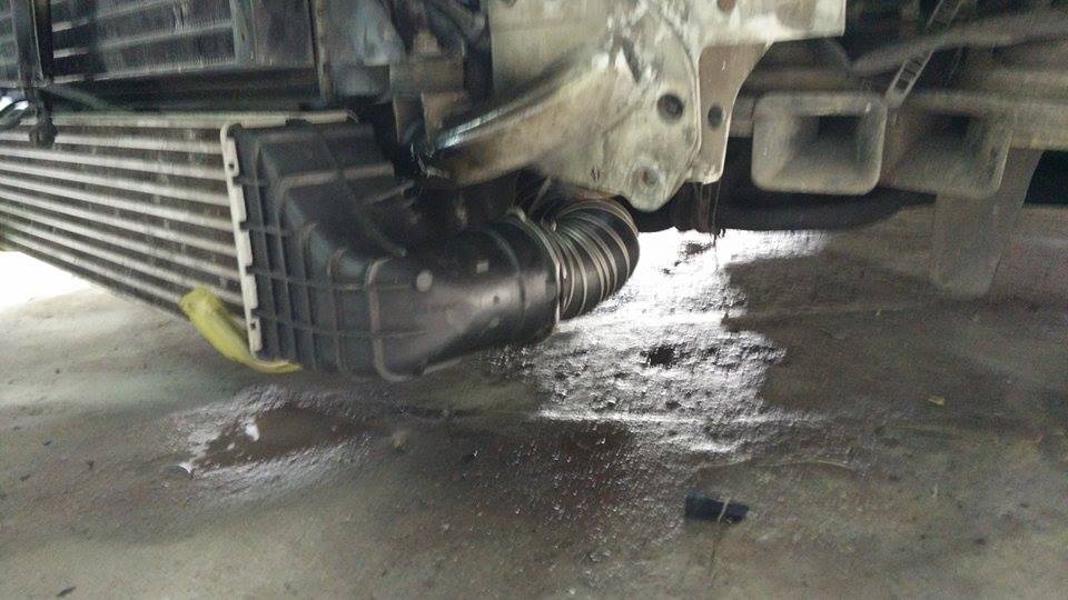

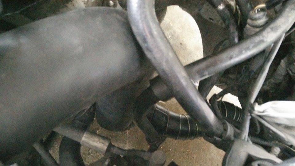

Re: B4Q 80-AEB; Finally FMIC!!
After running the 440s for a while it is clear that they work better going into boost. Much more stable boost.
Today I installed a front mount IC with a lot of help from my buddy! The car is getting new paint, recovered back seat and door cards. That should be done in 10 days or so.
Managed to find just the right one at the largest Bangkok second hand car parts market last Friday. Its an IC from a Benz W203 Kompressor. I got the IC and the stock clip-in hoses for about 180 bucks. The core is good quality and about twice the size of the stock AEB SMIC. 25.5"x2.75"x5.4"
It was a piece of piss to mount, really. Some cutting and welding needed to be done, but the hoses were quite easy. Had to find a long 2.5" L hose.
Found a radiator hose from a truck that worked well. 10 bucks for hose and clamps. New.
Pics!
Pics!
- 11846014_874432182604010_1098487464_n.jpg (53.78 KiB) Viewed 58606 times
- 11798417_874432165937345_1734061727_n.jpg (61.7 KiB) Viewed 58606 times
- 11823707_874432162604012_1264244157_n.jpg (72.91 KiB) Viewed 58606 times
- 11816000_874432149270680_1876545126_n.jpg (79.82 KiB) Viewed 58606 times

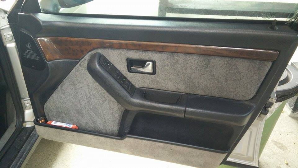

Re: B4Q 80-AEB; FMIC, New Paint and interior DONE!
Alrightythen...
New paint: Done
Newly covered door cards: Done
Newly covered back seat: Done
FMIC: Done

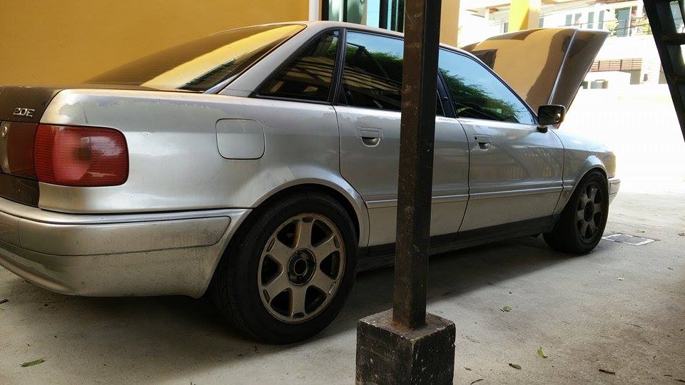

Here are the pictures
- shiny ass shot.jpg (71.09 KiB) Viewed 58509 times
- new door card cover.jpg (70.33 KiB) Viewed 58509 times
- new back seat.jpg (62.82 KiB) Viewed 58509 times
- FMIC with hacked up bumper.jpg (76.97 KiB) Viewed 58509 times
