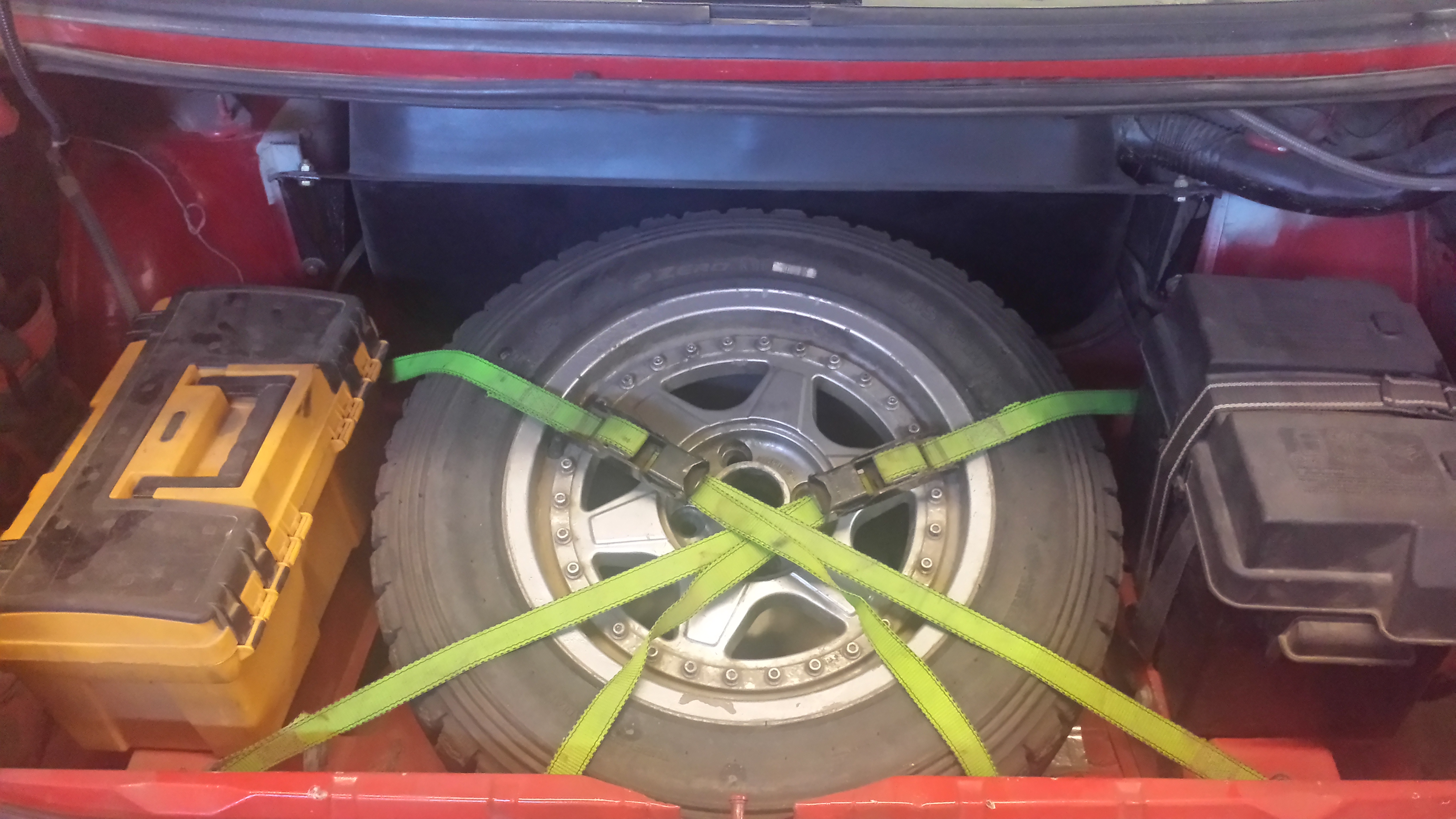

how are you fitting a spare tire in the trunk? The b3 is nearly a no go. I'm considering mounting on top of the trunk!

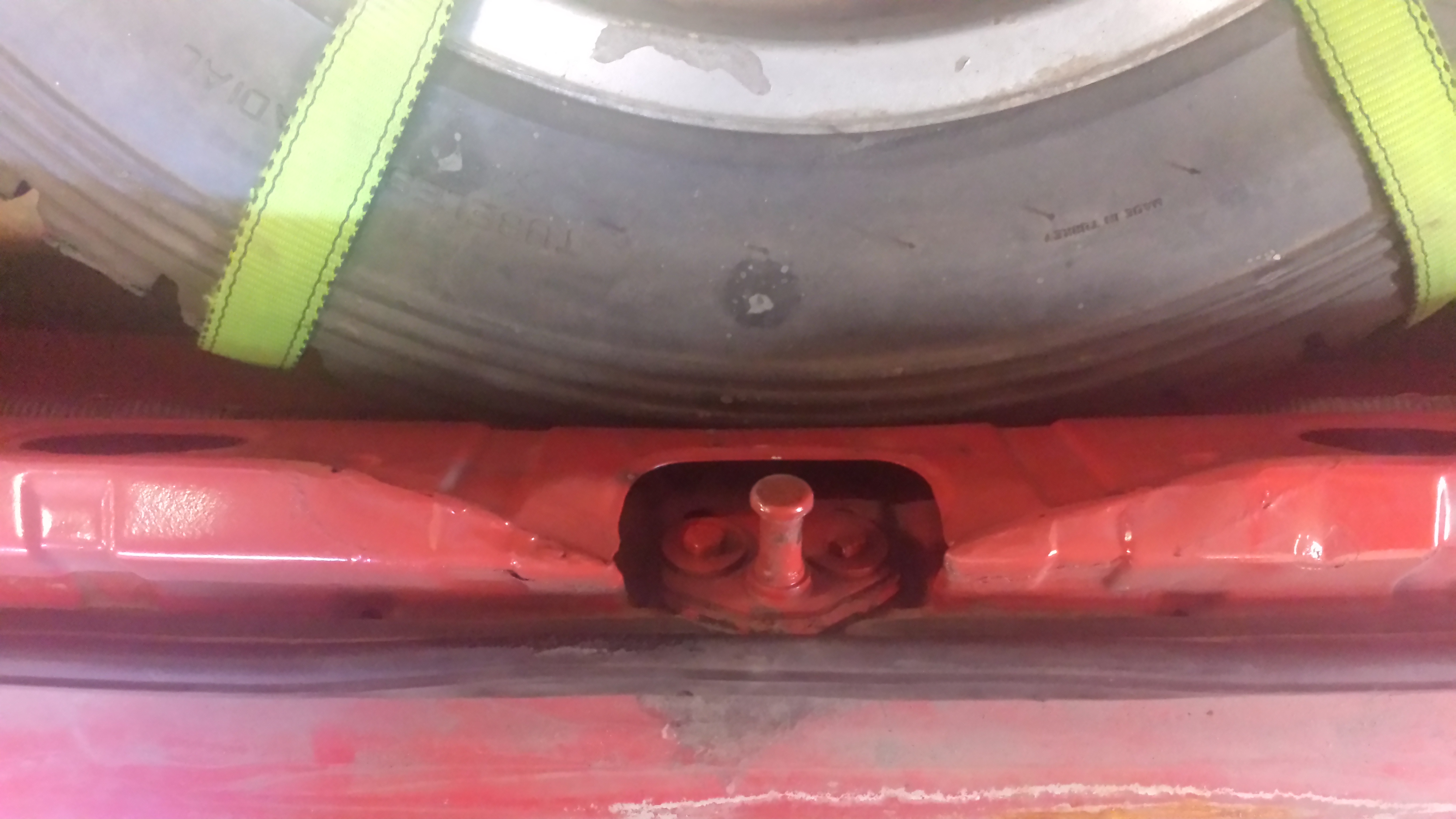

I'll take some pics tonight - its a tight squeeze and I cut some body material near the lock pin...
2015-10-08 12.10.42.jpg (1.54 MiB) Viewed 49423 times
2015-10-08 12.10.25.jpg (2.25 MiB) Viewed 49423 times
I just remembered that I moved the gas tank backwards by modifying the brackets (I'll look for those pics too) - plus you'll see that I cut the trunk a bit in a wide v-shape in order to facilitate in-out.
2 195/15 fit, but only 1 205/15 will fit

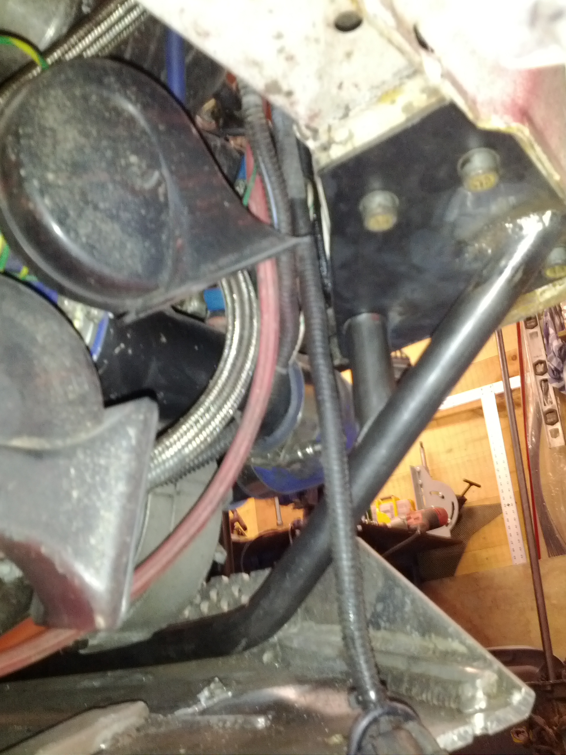

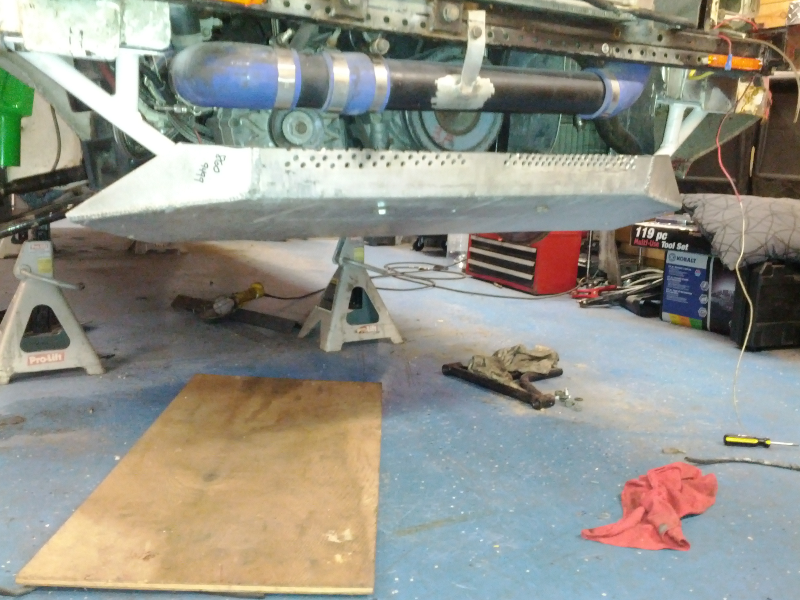

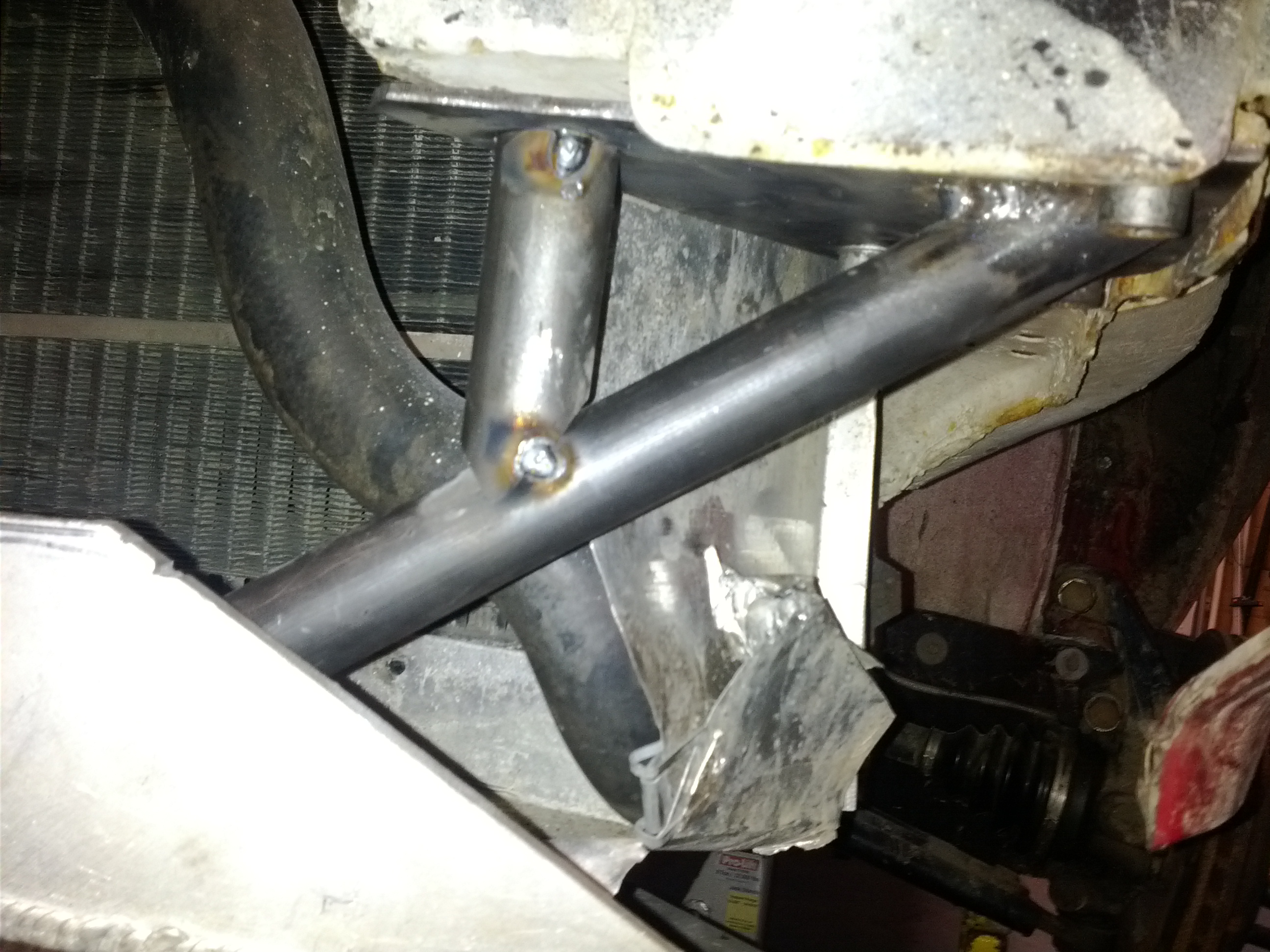

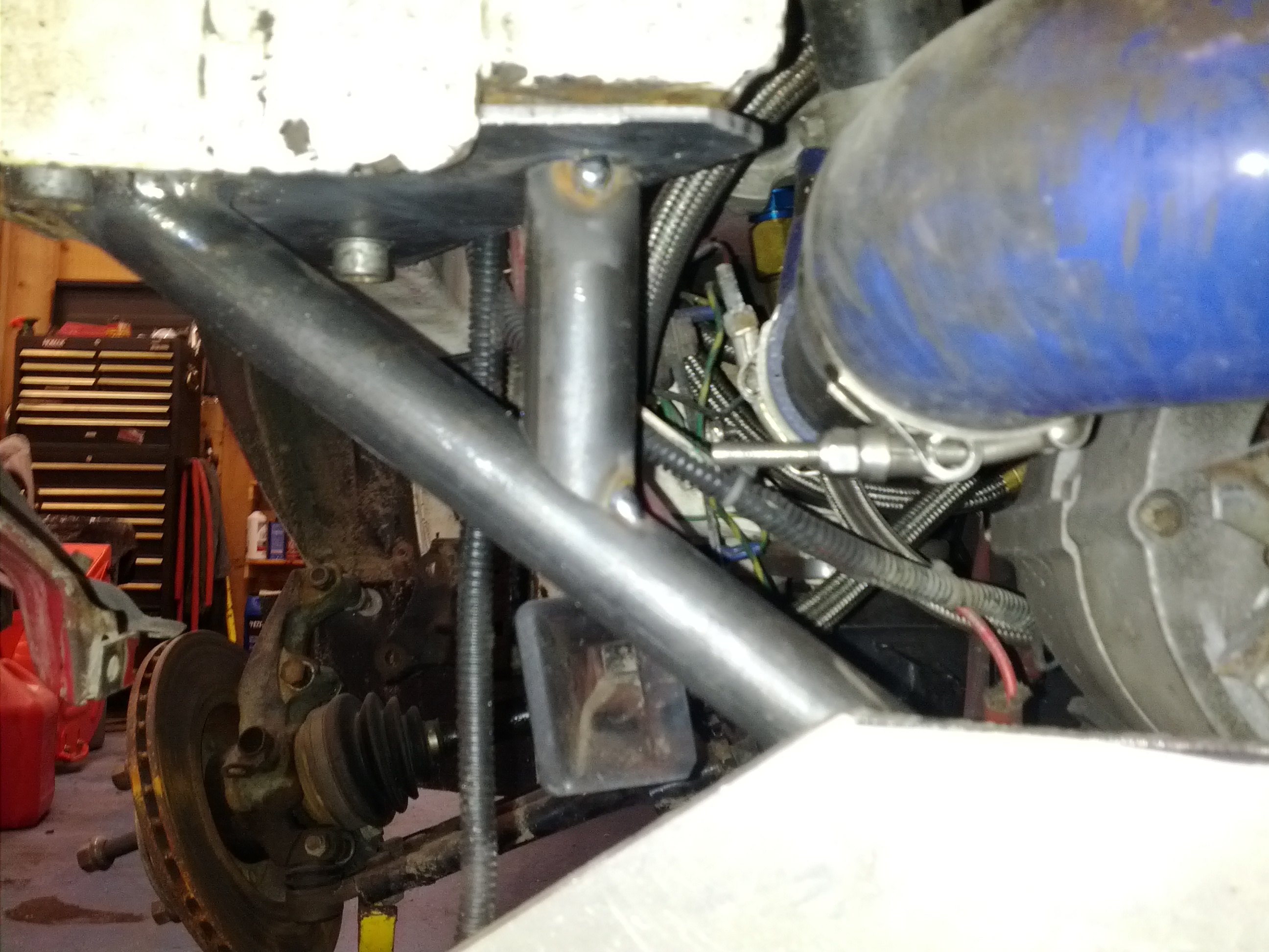

Posting pics of my skid plate setup as several folks have asked:
FIrst I built a support frame from 1" DOM.
2012-03-23 21.58.18.jpg (1.34 MiB) Viewed 49322 times
2012-03-23 22.51.12.jpg (1.3 MiB) Viewed 49322 times
2012-03-23 22.52.14.jpg (1.38 MiB) Viewed 49322 times
Re: 4kRR Audi 4000 Rally Rig
Posted: Wed Oct 21, 2015 10:29 am
by vbares
2012-03-23 22.52.32.jpg (1.18 MiB) Viewed 49322 times
Also made some high mis-alignment nut holders using old sockets...this has proven to be invaluable.
2012-03-23 21.59.34.jpg (1.26 MiB) Viewed 49322 times
2012-04-07 14.20.59.jpg (1.41 MiB) Viewed 49322 times
Posted: Wed Oct 21, 2015 11:09 am
by vbares

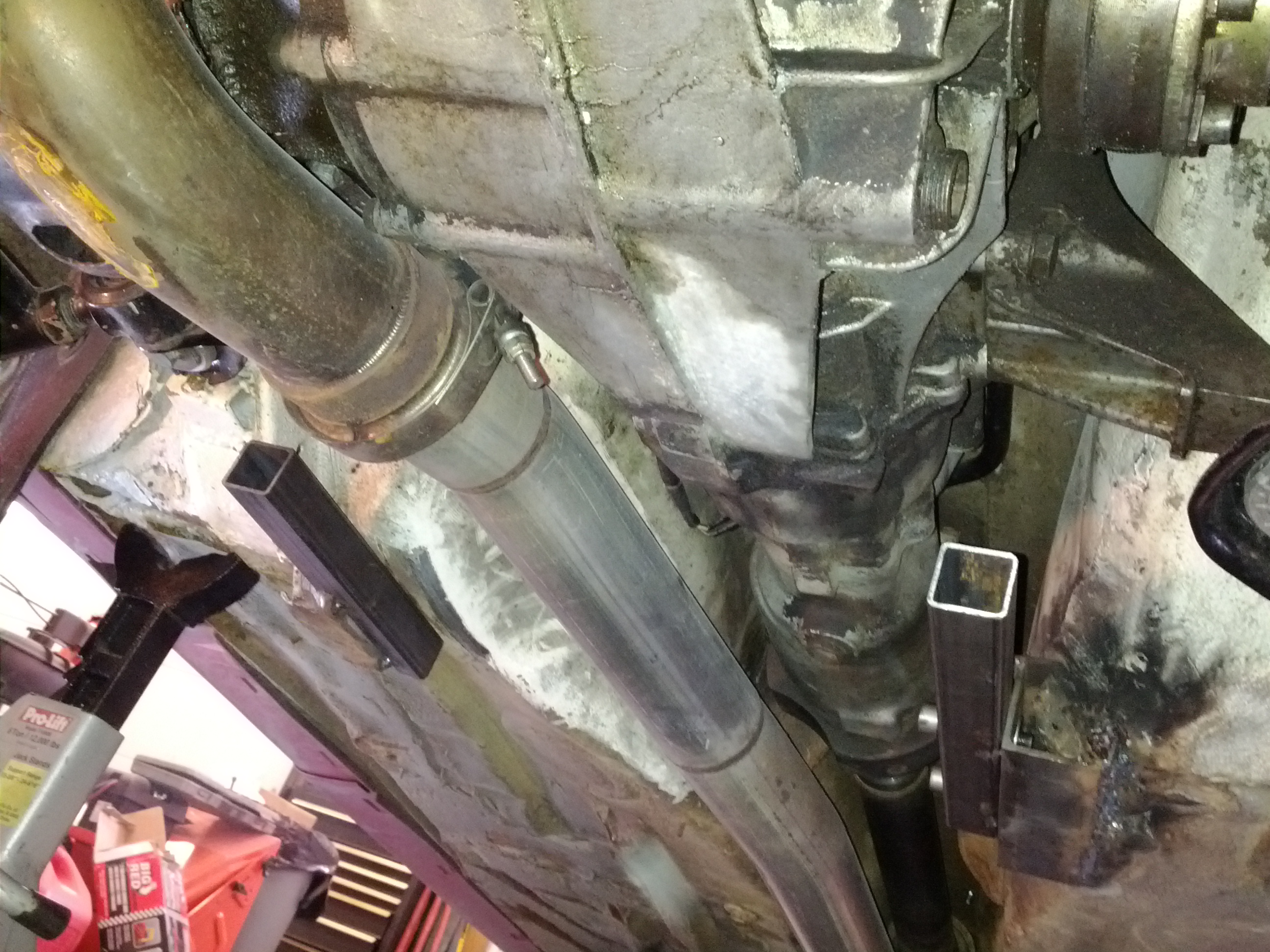

Square tube to the underbody
2012-04-06 16.42.39.jpg (1.59 MiB) Viewed 49319 times
Smaller square tube to the skid plate
2012-04-06 16.43.00.jpg (1.41 MiB) Viewed 49319 times
Slip square tubes into each other, 2 bolts - and you're good (I also have hitch pins that go through the square tube in case I do loose the front somehow)
2012-04-17 20.16.32.jpg (1.21 MiB) Viewed 49319 times
