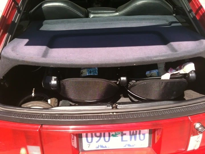

Two seat stroller fits with room to spare. It would be even easier without the strutbar (I think it is in backwards, bends back not forward).
Still making some parts choices but I need to start pulling the trigger to have it together for Vegas in Sept!
