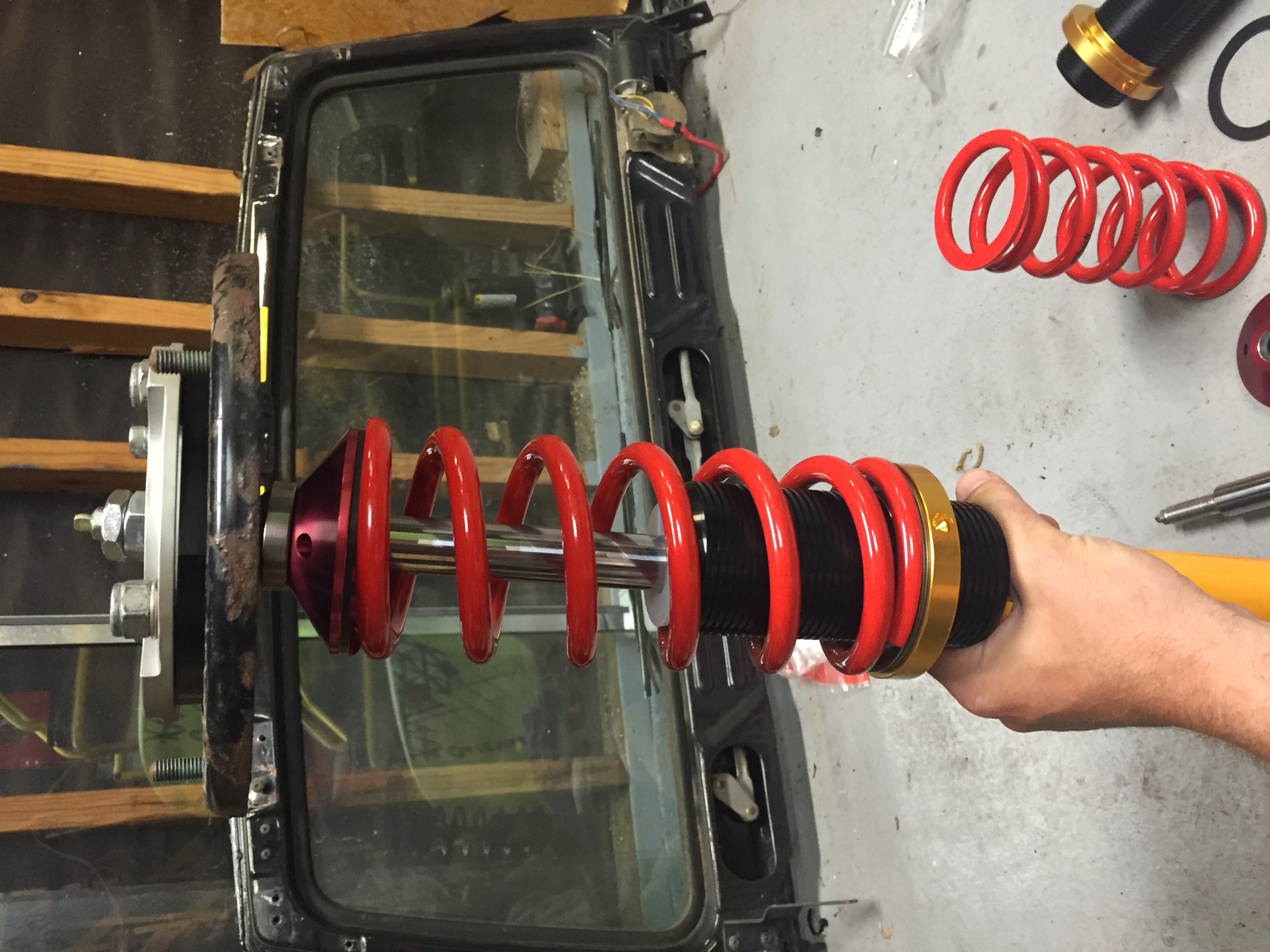

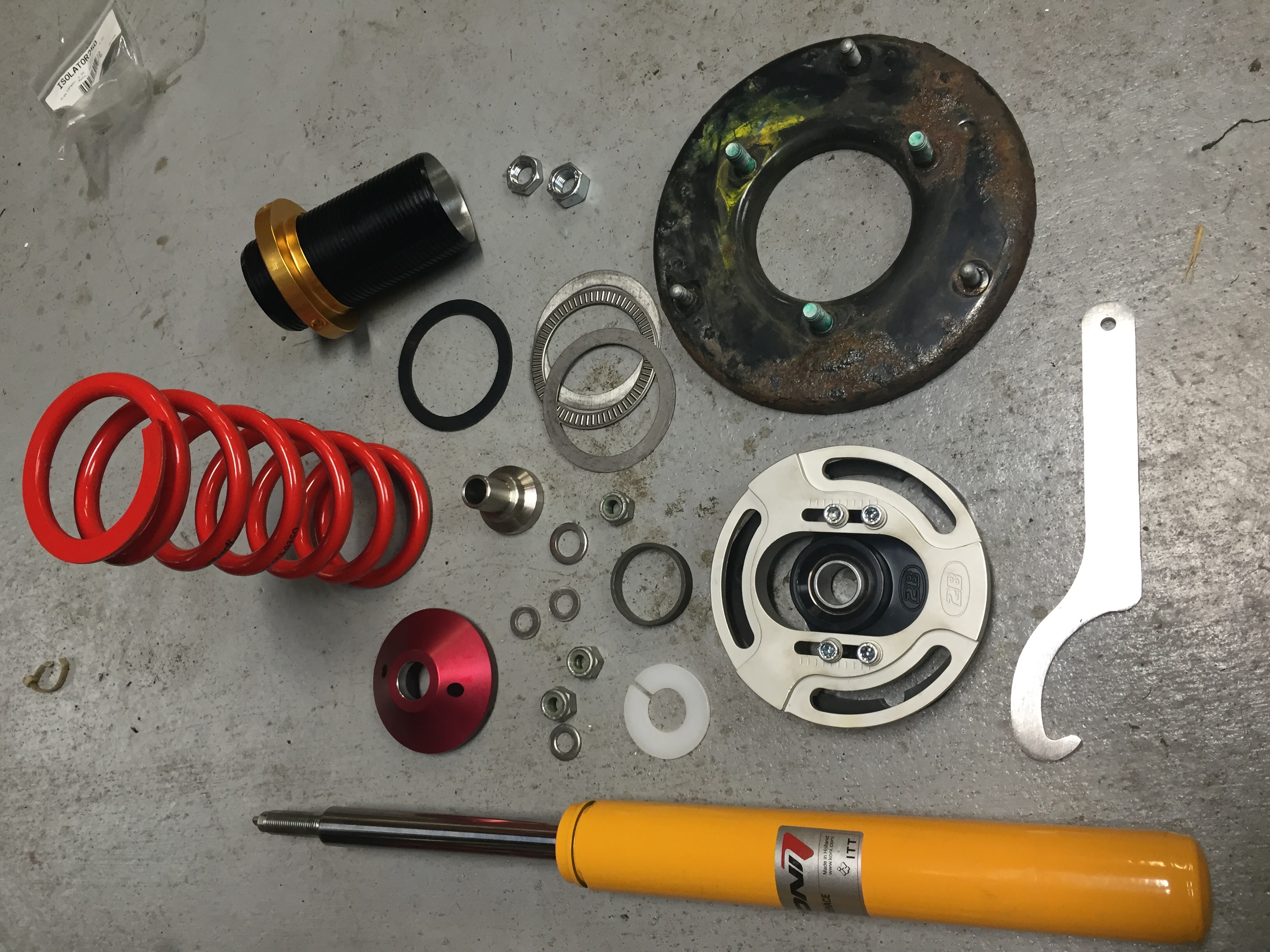

Got a broken strut mount which feels and sounds horrible and is downright dangerous during boost so I got some stuff to take care of the loosey goosey stuff. Just need to clean up the A6 sub plates and pull the V8 sway bar from my other car so I can put it in while I have it all torn apart.

Nice, do you have the spacer for the bottom of the upright? That strut is shorter than OE struts.
2.5TYPE44
Posts: 461
Re: Josh's 2.5 200QT.
Post by 2.5TYPE44 »
Not yet, I wanted to shorten the strut housing so I don't know and lengths right now to have spacer inserts made until I get it torn down and take some measurements. I thought about aluminum stock with delrin washers on both sides of the insert
I did this to my 635csi. It's fine to just use a cut to length piece of aluminum tube in the bottom of the strut housing.

Any advantage of shortening the strut housing to match the Koni or is it better just to drop the spacer in and go?
1157 Or 1159?
1157 is too short to take all of it out of the housing.

They are 8610 1436RACE

2.5TYPE44 wrote:Any advantage of shortening the strut housing to match the Koni or is it better just to drop the spacer in and go?
Yes absolutely. You will gain much more suspension travel by shortening the housing. The only problem is you probably wont be able to shorten it enough to match it as has already been mentioned. I think the most you can take out is about 1.5" if I remember the measurement correctly on mine. You want to section out the part below the steering arm. That way you gain some tie rod geometry back after lowering the car.
Also, I wouldn't put delrin in there. It will squish down too much after some driving. You'll end up with a rattly strut in the housing.
I am not sure of the length of the struts you are running but the 1157 without a spacer and the housing shortened will leave the strut at the top of its travel on a low UrS. The person who shared this with me said it felt like he was driving a pogo stick. He now runs 1159s as they are longer.
Of course you still have to put a spacer in there to take up the remaining space!

Post by 2.5TYPE44 »
Ok, so I will leave the delrin out beside the one the provided for the top. And yeah, I see shortening the housing under the arm would definitely bring the angle of the tie rods back close to where they were to begin with. Thanks for the advice.
