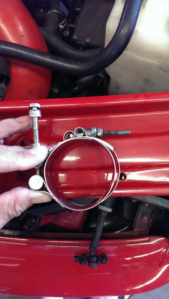

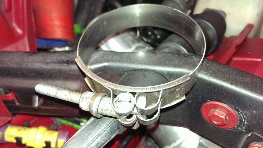

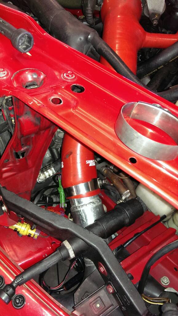

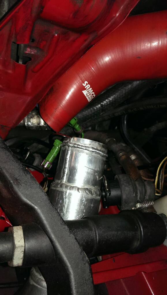

Oh, hi there slipped off silicone hose! Are you experiencing increased levels of pressure?
It's hedged up...
Maxed out clamp...
Slightly smaller one found...
Done

I'm going to start stocking the vanjens. they are indeed badass.
Or, use a constant torque clamp of correct size. better than t-bolts.
