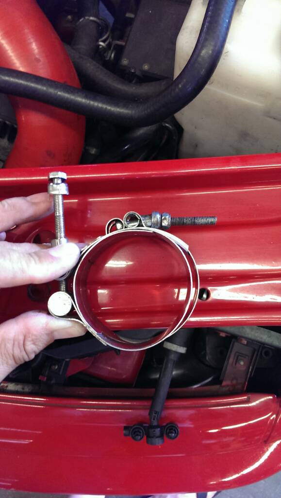

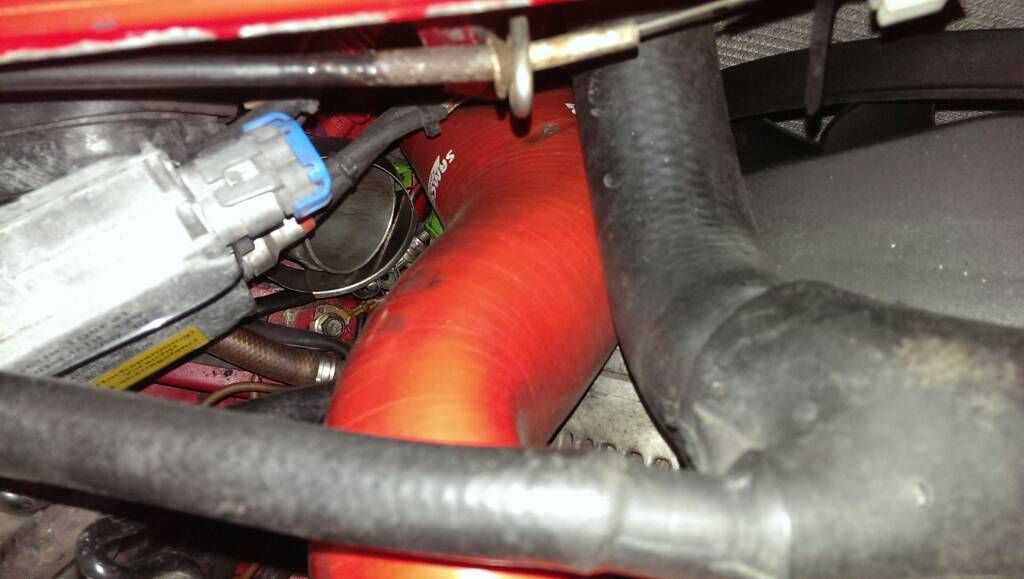

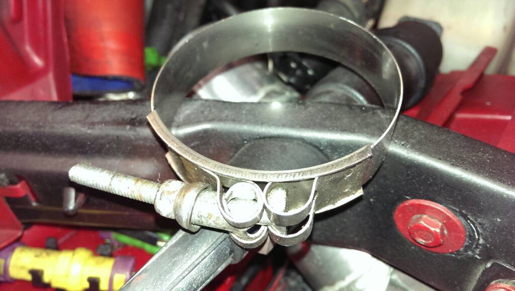

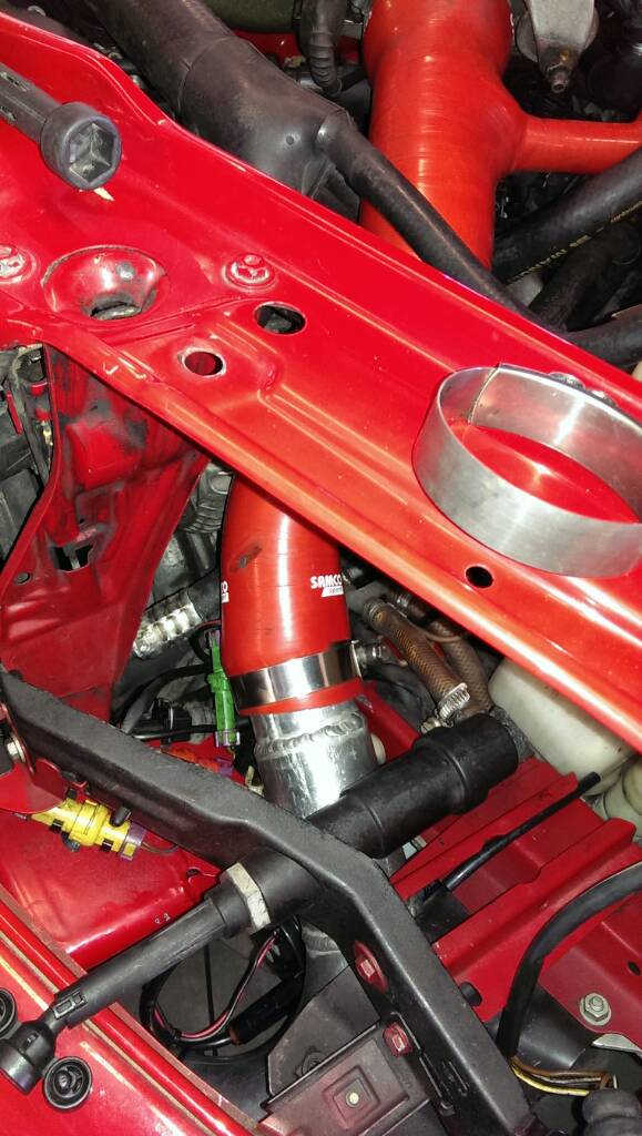

Oh, hi there slipped off silicone hose! Are you experiencing increased levels of pressure?
It's hedged up...
Maxed out clamp...
Slightly smaller one found...
Done

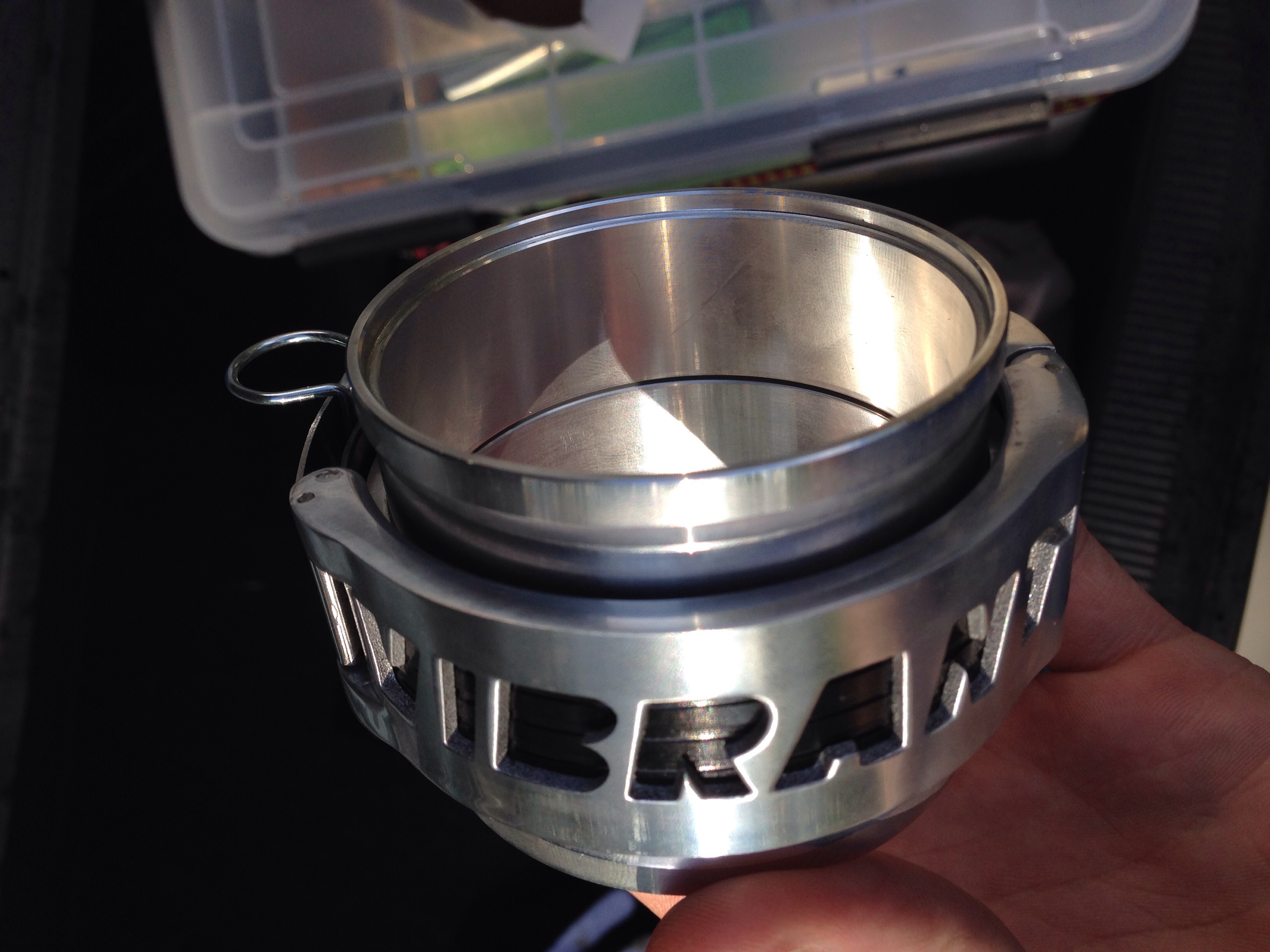

I vote for Vanjens!
Re: A tale of Rubí... Oil Residue and Meth Pump w/PICs
loxxrider wrote:I vote for Vanjens!
If I blow a Samco, I would... Till then tho....
Marc
Posts: 1586
Post by Marc »
I'm going to start stocking the vanjens. they are indeed badass.
Or, use a constant torque clamp of correct size. better than t-bolts.
Marc wrote:I'm going to start stocking the vanjens. they are indeed badass.
Of course you would... You're enabler #1...
On another note...
Eh, it's tough between Marc and Hank for that #1 spot.
Vanjen ftw. Quality was better than I expected, they're pretty slick. Now I just need 3 more for my boost piping...
You're not helping Ed... Lol...They sure do look nice... Maybe in the next Rubí revision...
