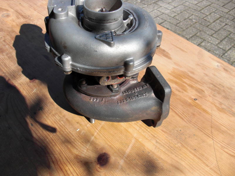

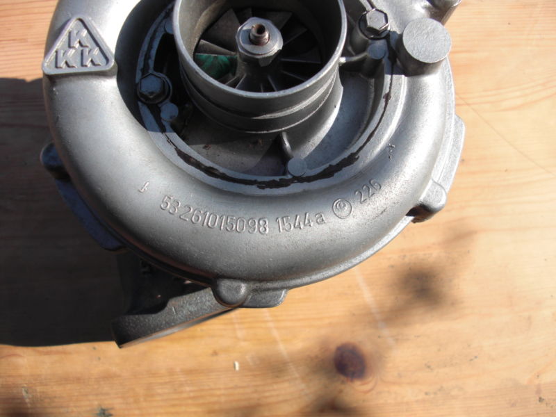

Can anyone identify this turbo plz? These are the best shots of the #'s. Thanks all!
- $_3 (1).JPG (76.81 KiB) Viewed 30224 times
- $_3.JPG (61.27 KiB) Viewed 30224 times
What I'm seeing:
5326101 5098 1544a 226
5326101 5367
Is this an RS2 turb?
5326101 5367
Ya I wasn't as excited when I'd found that either poor german to English translaton or poor listing skills were responsible for this turbo (from a euro 200) seeming to be an rs2...
Well it looks to be in decent shape anyway.. Did you buy it?
