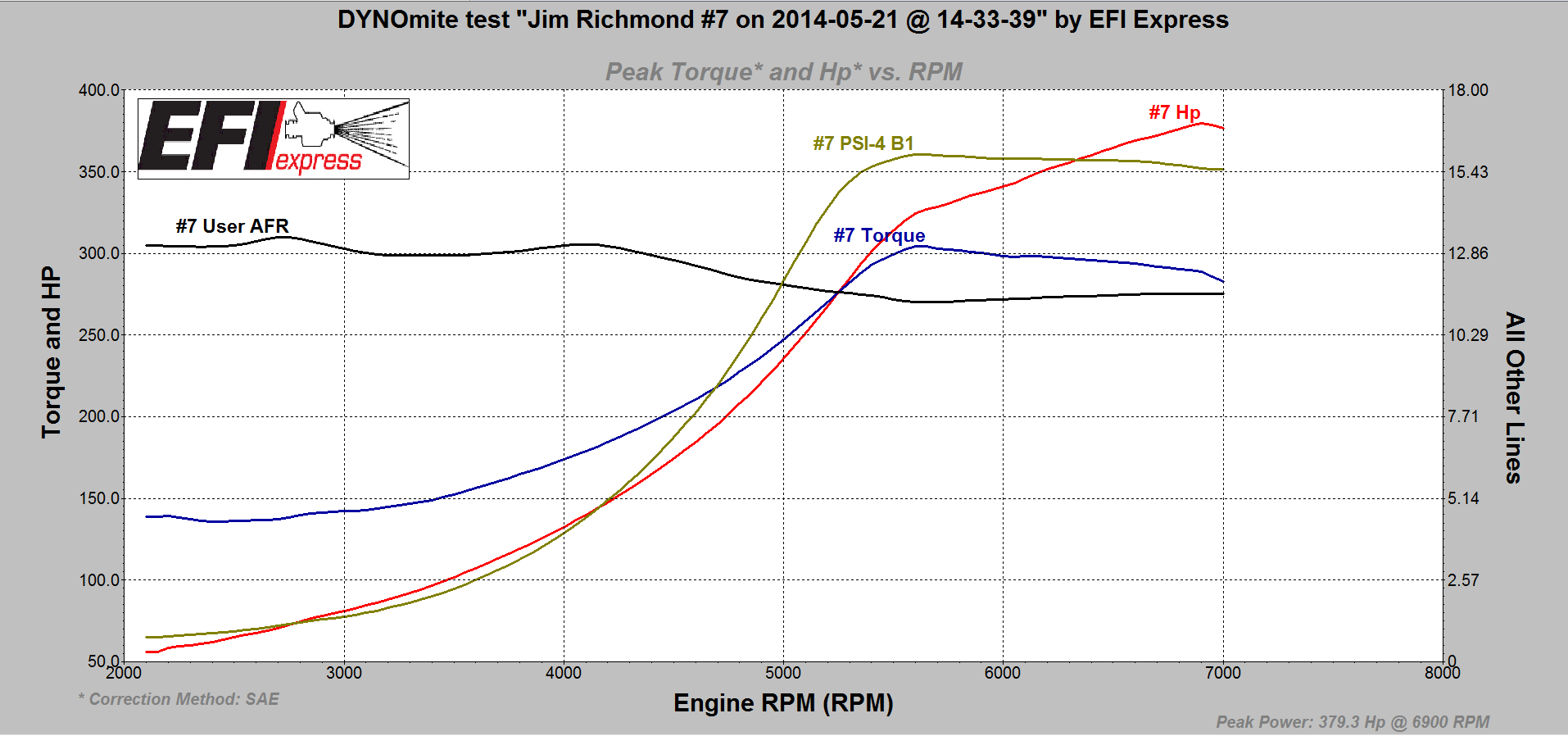

Soo.... dyno sheet?

Also in case I didnt mention I DID weigh the car recently. This car has no PS no A/C, front mount rad and good size FMIC. Fairly heavy turbo manifold and turbo too... Stock manuyal rear windows. Full interior, 1/4 tank of gas and my 270 lb ass. 3020lbs. Impressive if you ask me :-)
no "more" boost yet. FW ring gear needs to be....fixed. Mine hasnt come apart but Seans ring gear has exploded on his car.....

or did you mean just in general?PRY4SNO wrote:Soo.... dyno sheet?

The masses want validation of output lol... gimme dat curve.
Tunnel or on-ramp videos will suffice in the meantime

Its at Marcs. I dont have one atm. Ill post it tomorrow unless Marc does first.
Re: Jim's 07K 84 Super HX40 4kq. Back in business
why does it still say 16 psi and not 25+ ??!?!?!!?!?!?!?!?
Wow, 380 at the wheels... and "only" 16psi. Can't wait to see that HX40 really open up with more boost.
