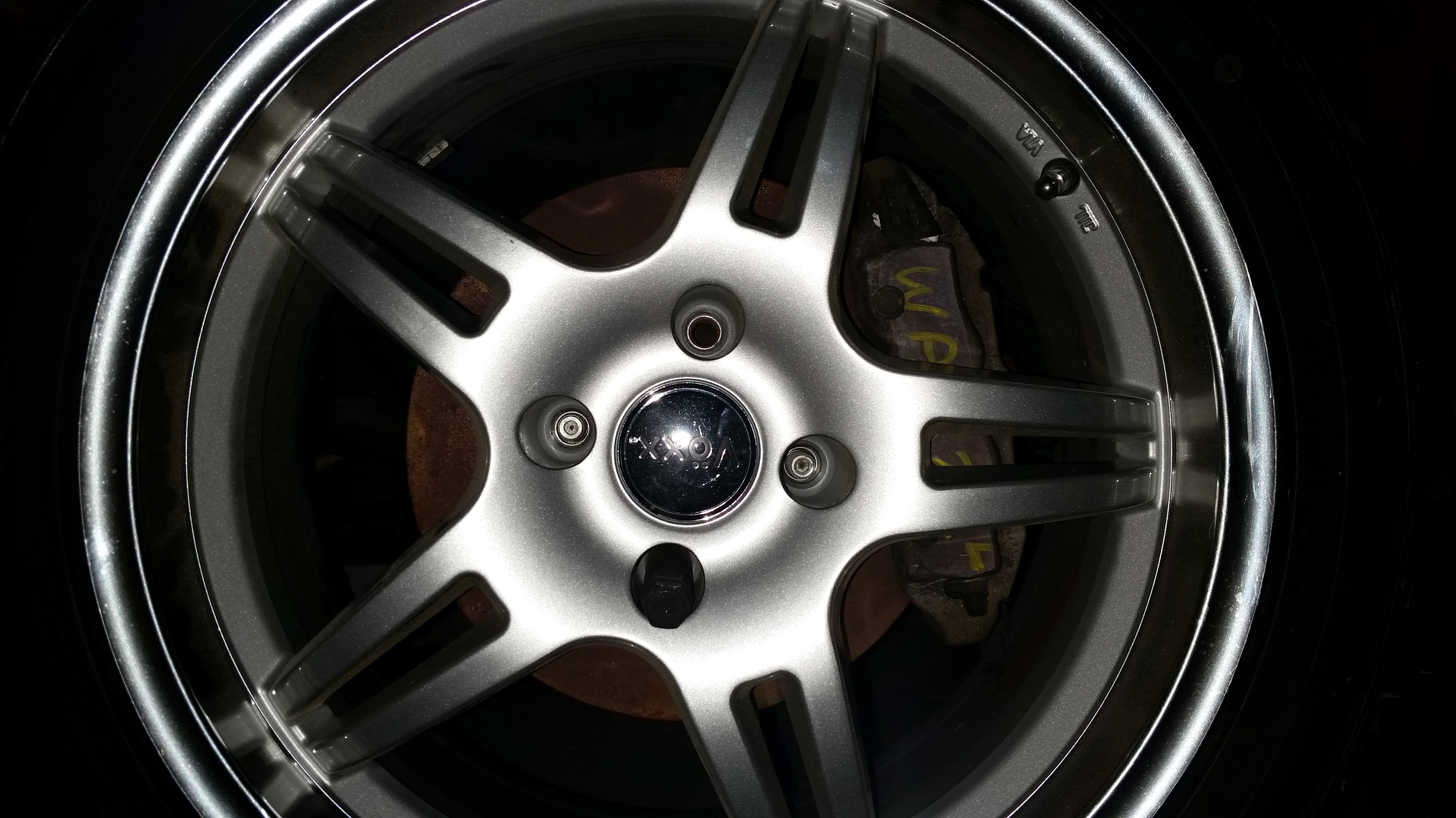

So...I just bought another pair of Brembo calipers off fleabay. Plan is to make a simple adapter to fit them up using Wilwood two-piece rotors, using one of their pre-made hats (undrilled). I have a shop literally right down the street from my office that can make all the hardware for me. Cost of the calipers was $142 with shipping, they are sized for 330x28 rotors, I plan on running 310x28 as that should fit under my wheels (barely). More to come on the suspension as well. Figured some items out, not good ones, on 000292's suspension. All fixable, but it explains lots of things...

Calipers came in, should work just fine over 310x28 rotors. Adapter should be pretty straight forward, I just have to work out the rotor hat (Wilwood has many off the shelf hats that just need the bolt patter milled in an a hub-centric spacer inserted). I believe the calipers even have the same port size for the flex line, pads even have wear sensors that I can adapt to the old Audi wiring (versus the new Audi wiring that these have). Brake pad size is similar to the G60, though I have not measured the two pads. These have four smaller pistons than the two large pistons of the G60's, but since I'm adding 17mm of rotor radius I should end up with better braking and most certainly better heat management.

I had time tonight to mock up the caliper adapter out of some of the scrap aluminum. I have a final design set, so I'll draw it up and get it ready for the local machine shop. I do need to call Wilwood and double check one dimension on the rotor ring before I have the adapter machined.
It looks like, based on my 17x8 Voxx wheel, that my 16x7 wheel will have plenty of clearance.
Also may look into running studs. I borrowed four of the M14 studs from my Adapt-it bolt pattern adapters from my V8q to make mocking the brakes up easier. Man is that nice to not fight the wheel/rotor/wheel bolt...

I talked to Wilwood this afternoon...
Rotors, hats, rotor/hat bolt kits and caliper adapters are all ordered. The bolt kits are back-ordered until 10/20. That sucks. I'll have under $800 in this setup once it's on the car. If I would have had to buy pads too, it would have been around $800. Not too shabby...

Re: Eric's V8 CQ
Teaser...wrong rotors, but you get the idea.
- teaser
- 20160928_224357.jpg (2.37 MiB) Viewed 59431 times
