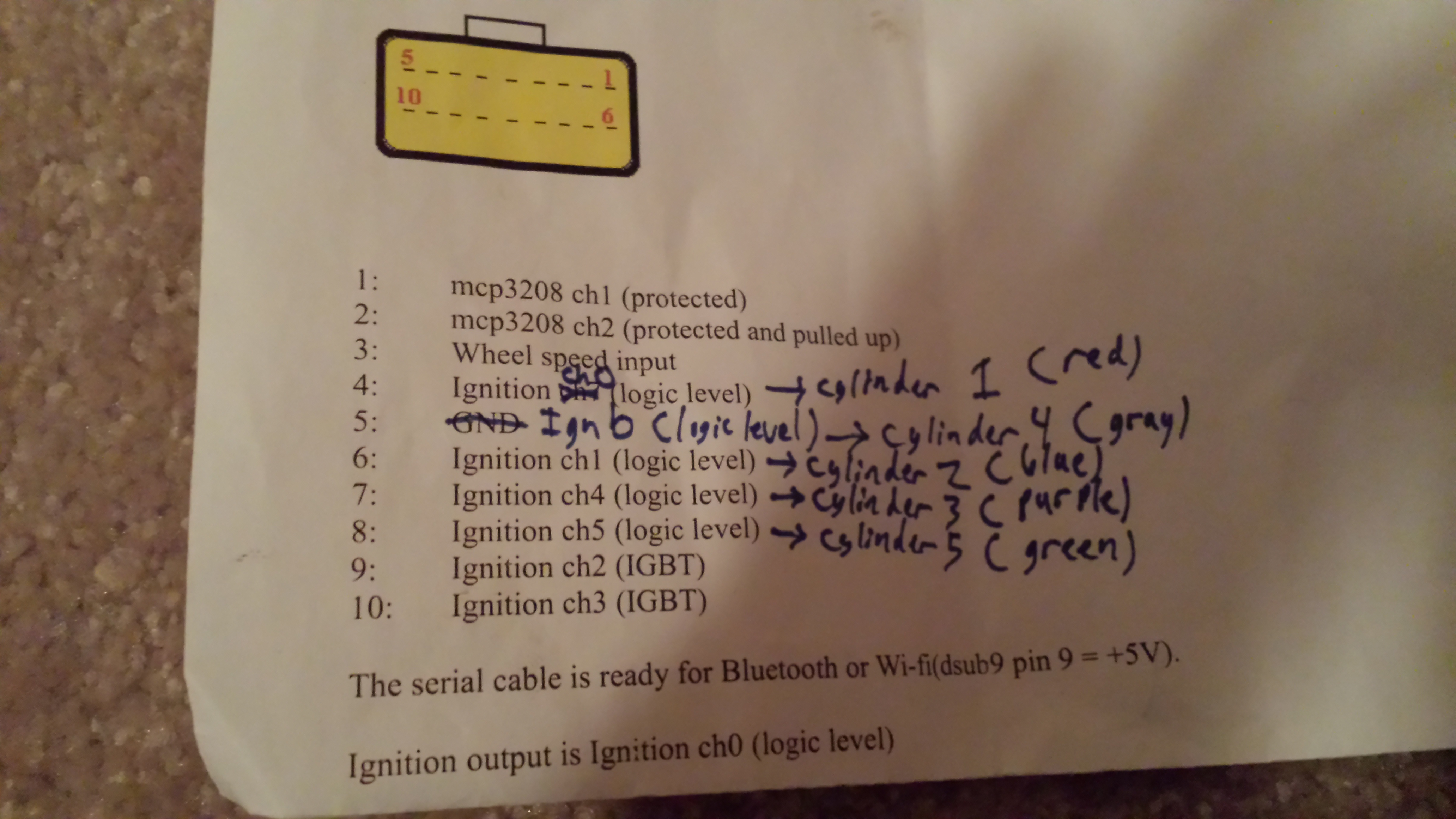

One thing for sure. My launch control circuit wiring is solid. Did several tests with my multimeter and still concluded that I didn't destroy this chip.
Just frustrated at this time I guess.

My pin out sheet
- 20150503_213632.jpg (1.61 MiB) Viewed 30990 times

In the spirit of helping the people on here that still haven't transitioned to VEMS, here is Marc's advice on how to spot if you've fried your chip that controls launch control:
"you can easily test your inputs to see if they are working. go to view->groups->analog inputs raw. this will show you all of your input channel voltage readings. some of them should be sitting at or near 0, some will be sitting at or near 5v. the ones that are sitting at 5v are the ones you use for launch control. when you ground one of these inputs, you should see the 5v reading on the live display go to 0 for the corresponding channel. hope that helps."
This was hugely helpful in my venture to troubleshoot my "problem." It wasn't actually a problem you see, since when the vehicle is not running, the light for launch control in VEMStune WILL NOTT light up. So keep that in mind when you go to figure out a problem with you aux in chip in the ECU.
I was able to watch my channel 2 voltage drop from 5 v to 0 V when I was initiating the L.C. circuit so I figured I had better start the car since I had yet to check it while running

My actual data from the voltage page in case anyone is curious: "It goes from raw 5 v and cal. 255.xx v to 0 v for both readings."
