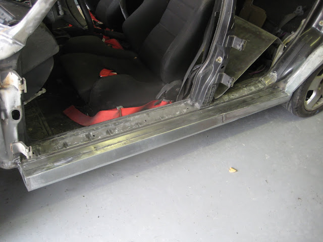

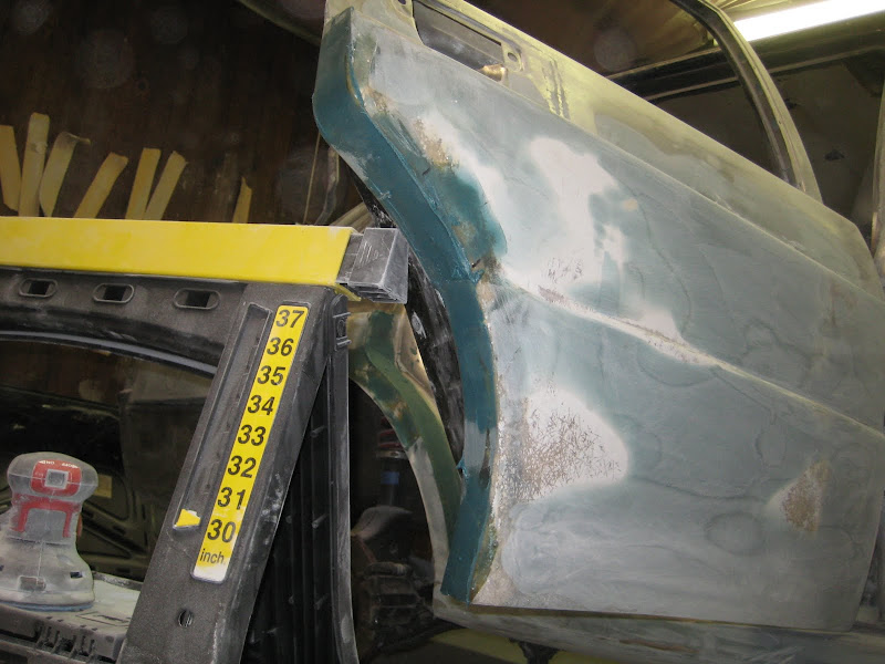

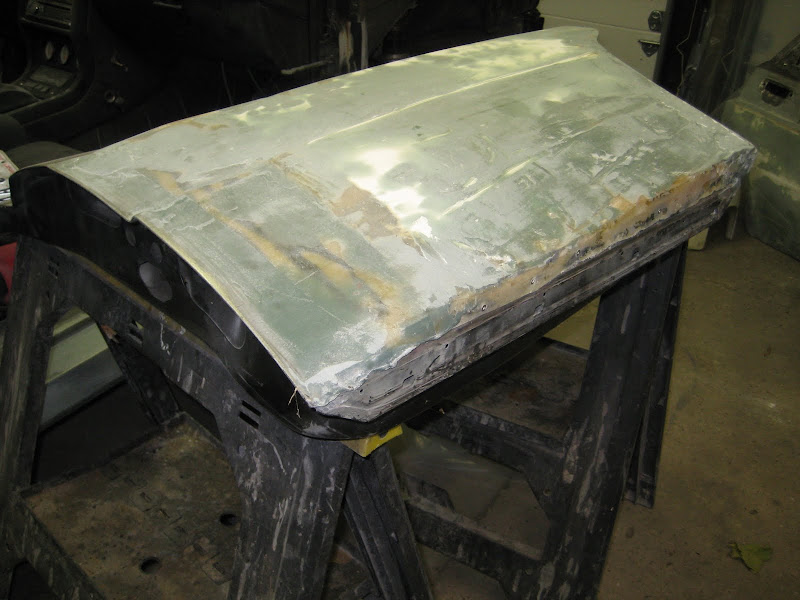

First thing I tackled was the rocker panels. As you might recall, there was a bit of welding involved to get these attached, and my seams weren’t as flawless as a more skilled craftsman, so filler was def required. Not a TON, mind you, but they still needed work. I believe I had about 15-20 hours into the two rocker panels, and I'd go out on a limb to say they're about 90% flat. I just don't have the talent to get them that last 10%, and this is where I will more than likely bring in a body guy on the side to work a little bit of his magic.
But after getting the 'ol girl home, I started in. My ability to mix and spread the filler has gotten a lot better than when I initially started, so that's at least ONE bonus:
Here's what I was starting with. As you can see, there was some filler required, though really not terrible in the grand scheme of things:
slimed:
sanded and reslimed:
These steps were repeated ad-nausea until I got them almost to where I liked them. It is a painstaking and aggravating process where you think you have it good, then run your hand over again and find a dip/bump/etc. I have to skim it w/ a final filler, and then maybe I can get it almost smooth.

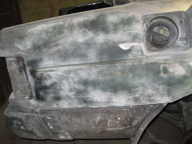

I also started messing with smoothing out the front clip a little bit. This is a good excuse to call practice w/ filler. I had shaved all the unnecessary holes/clips/etc on the front of the car... only b/c I could, not b/c I had to. Pretty sure no one will really NOTICE this, but what have you.

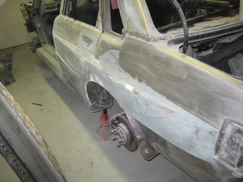

Next up was after I moved the car at my friend's garage. I had full intents of building a crazy dust booth around the car, as after cleaning my cousin's garage I had a new appreciation for how fine this dust was and that it went EVERYWHERE! I mean, even the ceiling had a layer of dust so thick that I could write my name in it. But three days after I moved the car, I got a contract on a 3 car garage w/ a house on the same lot
More to follow on that after more progress reporting (yes, I'm a tease).

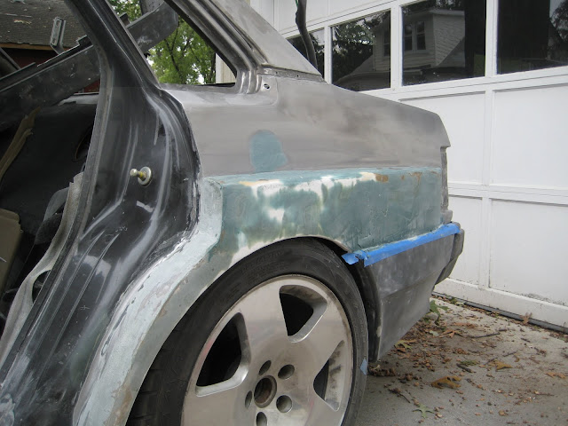

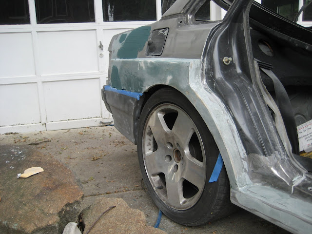

This work happened over Labor Day... and I got about 8ish hours in before the heavens unleashed... as I didn't want to destroy his garage, and given this was the only day I was going to have to work on the car before I moved into the new house, it wasn't worth the effort to build the dust booth.

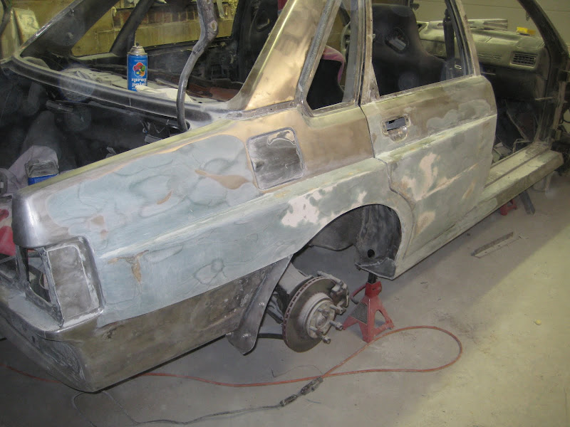

My goal was to tackle and finish the front clip, and then address the rear quarter panels. I got the fiberglass portions really close to where they needed to be, but the gaps and how they fit w/ the bumpers still wasn’t perfect in my mind. So I went at it w/ duraglass in hand and had at it, so to speak.
This also gave me the chance to address and fix the remainder of the dents I had pulled from hitting the tire wall last year. I was really impressed w/ how well I was able to pull the dents w/ a tree and slide hammer, honestly… as it didn’t require THAT much filler to get it smooth again.
At this point, that’s about as far as I was able to get before the skies had opened and left me with nowhere to go/work… but I did get a solid 8-9 hrs working on the car, and made some solid progress in the grand schemes of things.

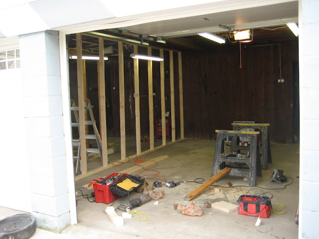

Next comes the newest life news… I officially have my own house again
!!! After living with my cousin for two years, and looking for houses for the past 8+ months, I finally was able to find a perfect house that suited all my needs, and will be something to grow into as time goes on.

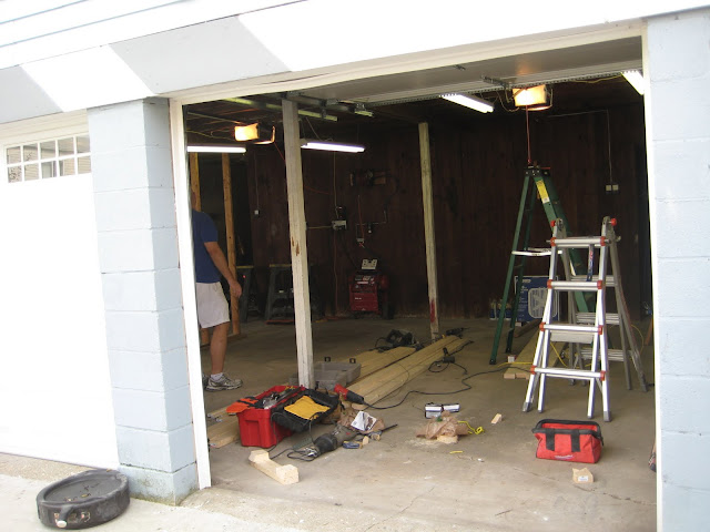

Obviously… this was the most noticeable part of the home:
It's a 28'wide by 30' deep garage. Unfortunately, the bays are on the narrower side of things (9' give or take), which isn't really conducive for the kind of work I've been getting myself into. To fix this issue, I made the decision to take over the middle garage bay and build a new supporting wall to hold up the 750sq ft room above the garage (yes, you heard that right… lot of potential in the garage too, not to mention the house!). This new supporting wall was also to allow me to build a containment booth in the garage… both for dust as well as for a future redneck spray booth as time allows.
The garage started life looking like this:
And with the help of my buddy, we were able to build the wall and remove the necessary supports to really open up the bay:
Once the wall was up and all supports were removed, out came the plastic and I started wrapping everything. This is just a pic before I finished everything. All seams are now “sealed” with duct tape, so this is as airtight as I can possibly make it. Not perfect by any means, but will be more than ample for the work that I will be doing in the garage.
The only thing left that I need to do is install air filters along this wall so the fan I have in the window on the right side of the garage can pull “clean” air across the bay and hopefully vent the dust/fumes out of the garage. It all works in theory, so hopefully it will work suitably in reality.

Once everything was set up as best I could, I started the fun I have grown to hate… making things flat. I originally had planned on getting this just flat enough and letting the body shop finishing the rest (90% solution). I started using a 6” orbital palm sander to get things flat, but after a few attempts I gave up and went for broke. After attempting to make things not to wave, I realized it was essentially impossible for me to get things right w/o using blocks. Initially I had purchased a set of sanding blocks that weren’t the best out there, but were still decent. Well, they proved very quickly to be VERY inadequate for what I had in front of me. Within the first few uses, the hard plastic support that you stuck the sandpaper to ended up separating from the handle and then cracking… so I bit the bullet and got “the good stuff” so I won’t have to deal with this again. I also picked up a 30” block to do the larger surfaces as well, though no picture:
With the tools in hand, I was ready to tackle the mess I had initially made w/ the filler when I put the first coat on before sending it off to the body shop the first time:
Needless to say, that alllll got sanded off and I started from scratch again. To say I’ve learned quite a bit since I’ve started is a wee bit of an understatement… but regardless, headway is being made!
The process went pretty consistent: apply filler, orbital sander to take off the high spots, block sand 90% of it off, dust w/ a light coat of primer to reveal low spots, sand and repeat. The amount of filler I’ve wasted doing this is sort of sickening, unfortunately… but it’s a learning process to say the least… but I digress.
Idea of what I did w/ the primer (a suggestion from the body guy when I initially brought the car in… as he said, there’s nothing like a cheap can of black primer vs. the expensive stuff!!!).
This honestly did a great job helping me find the high/low spots. The bad part is it has a tendency to gunk up the paper pretty quickly (so you need to clean it after a couple swipes), which I’m not sure if the proper stuff would do. Regardless, it’s a minor inconvenience and in all honesty, for the 97 cents a can it costs me… is worth the trade off.
But after countless hours sanding away at the two rear flares and the rear doors… I hit a milestone last night. The ‘ol bird got her rear doors back!
Here they are all finished up:
And installed!!!
