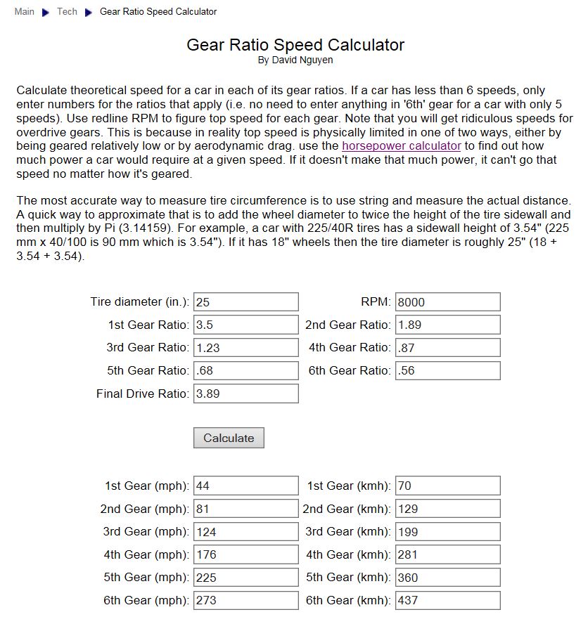

I got bored/curious and entered my information into an online calculator gear/speed calculator. I believe Jeff Gerner reached over 260 mph for a short time at Bonneville and I believe he has a 4:11 final drive. So when I put the numbers in for my European Turbo Diesel O1E 6 speed with a 3:89 final drive (Not 4:11) and a 6th gear being .56, I see these numbers being pretty achievable. I put the shift RPM at 8,000 RPM. I am not saying my motor is capable spinning up to 8,000 rpm in 6th gear and reaching over 270 mph but it gives me a good idea for lower speeds/lower gears. I am thinking I will realistically settle for diving the car at 750 wheel horsepower once everything is dialed in . Miles Per Hour is listed in the lower left hand side of the table...
1st gear = 44 mph
2nd gear = 81 mph
3rd gear = 124 mph
4th gear = 176 mph
5th gear = 225 mph
6th gear = 273 mph
It should be fast enough to put me at risk of getting a speeding ticket... or two...

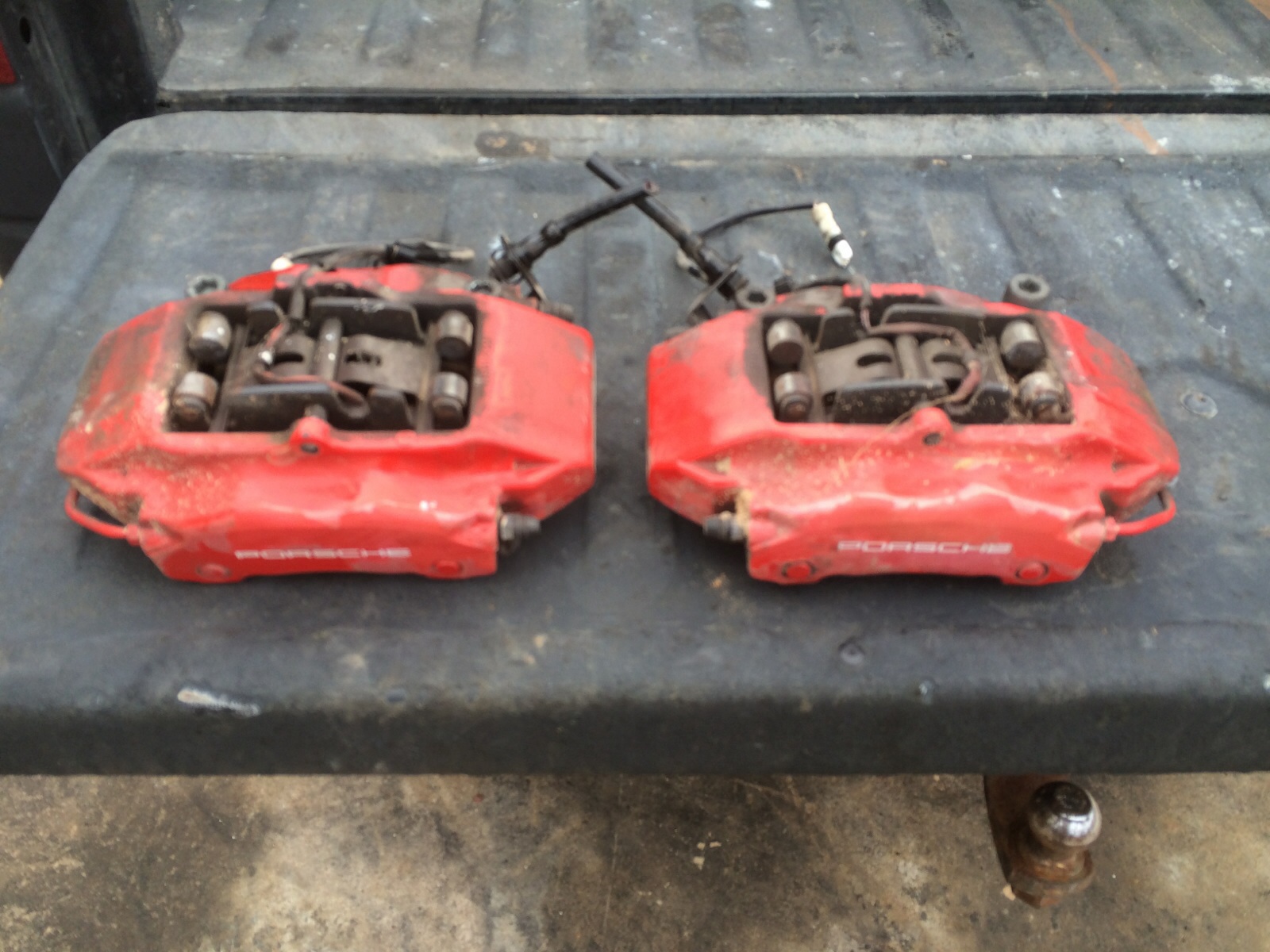

I picked up a loaded set of Porsche 996 calipers today for a big brake upgrade. I hope and plan on "needing" and using these. I just need to clean them up a little and re-clear them to make them look new again.
- image.jpg (413.01 KiB) Viewed 38966 times

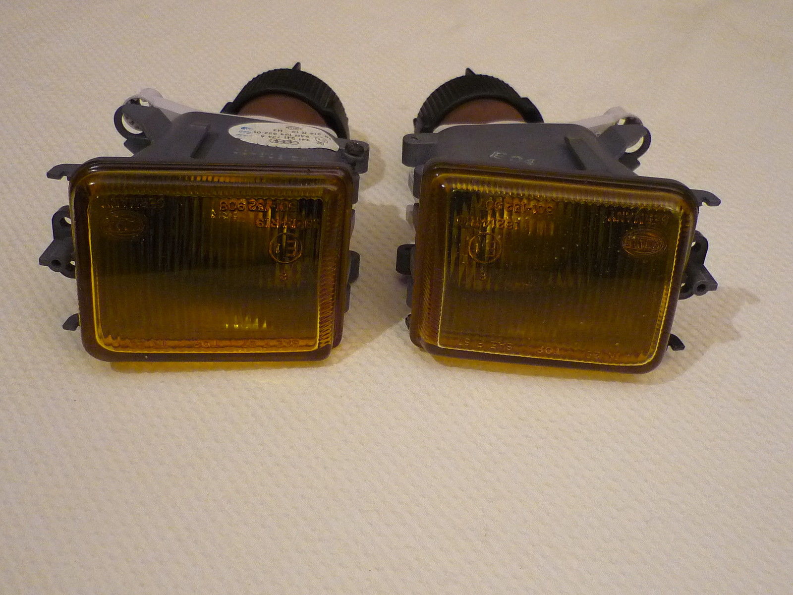

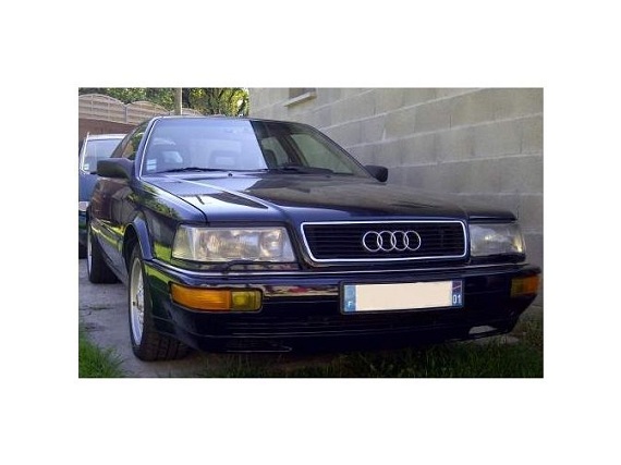

I might have a deal on these mega rare amber D11 V8 fog lights. Whenever I get my car back, I will see if they will look ok next to the clear turn signals. These were supposedly a limited edition for D11's in France. Here is the only picture I could find of them. I'm thinking it will look better next to the CAC clear turn signals rather than the standard turn signals.
- french fog v8.jpg (49.35 KiB) Viewed 38947 times
- french fog.jpg (269.67 KiB) Viewed 38947 times

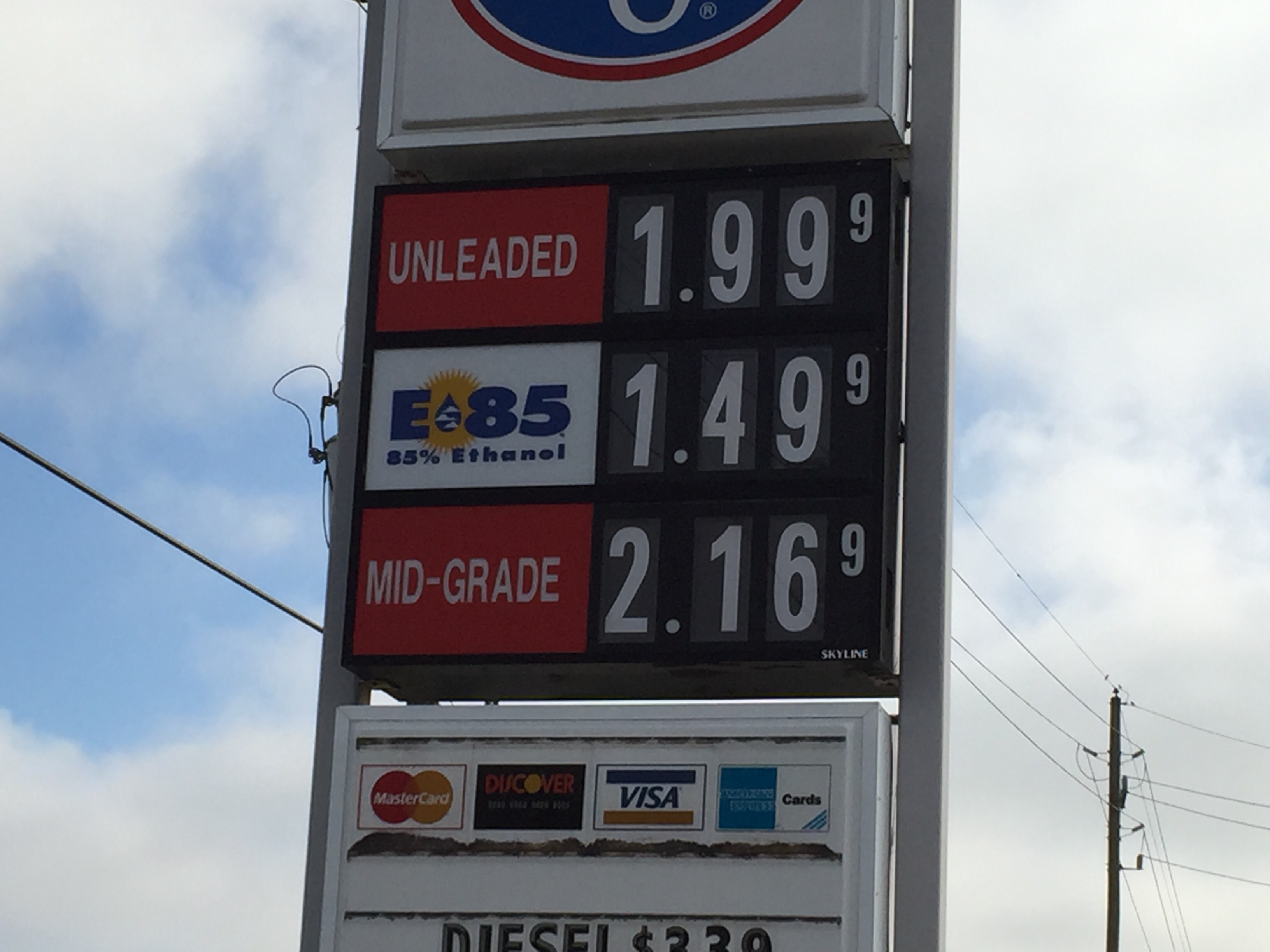

Damn! E85 is cheap! I was getting gas today and noticed E85 at my corner gas station is $1.49. I hear E85 burns cooler and makes more power than premium. It looks like it is much cheaper too. Win win situation... Man I wish I had a car that runs on E85!
- image.jpg (770.81 KiB) Viewed 38751 times
