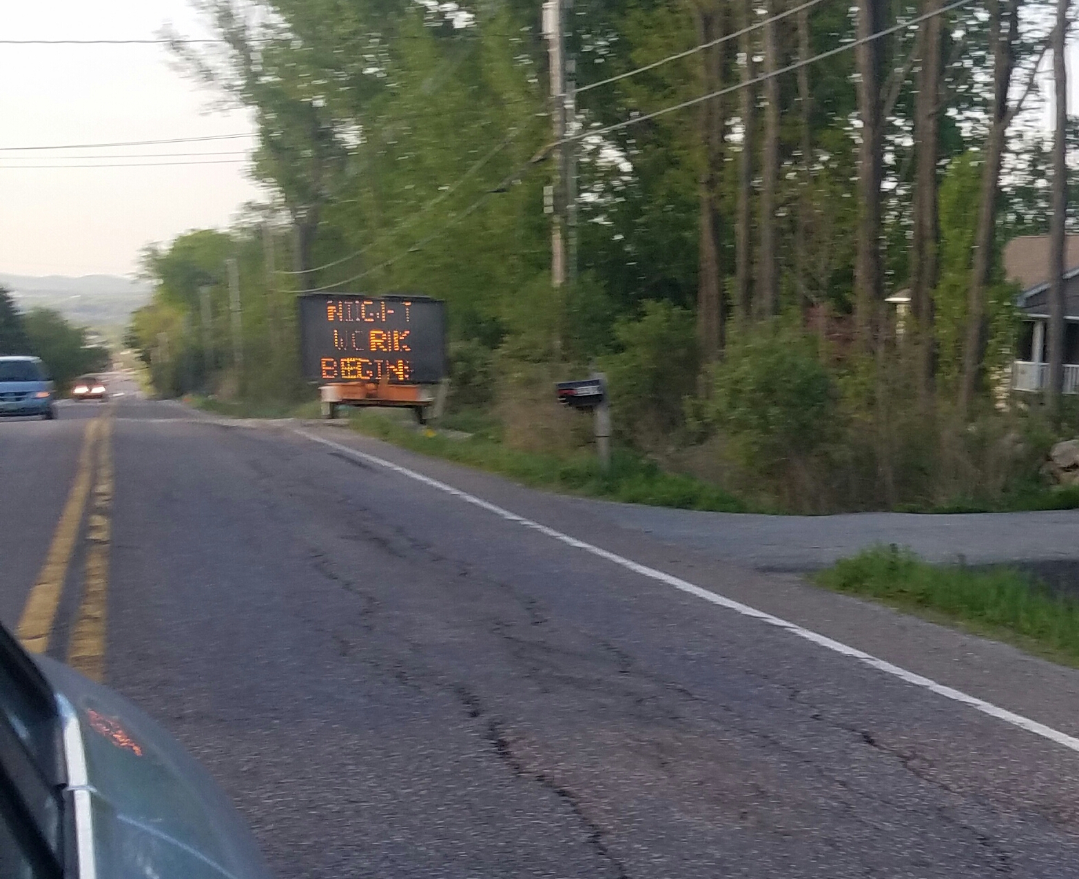

They put up a sign for the part of missing road Dana's brand new wheels found. That crevasse was no joke, I'm really impressed with how well the fifteen52's took it.

awesome pic Ben, thanks!
