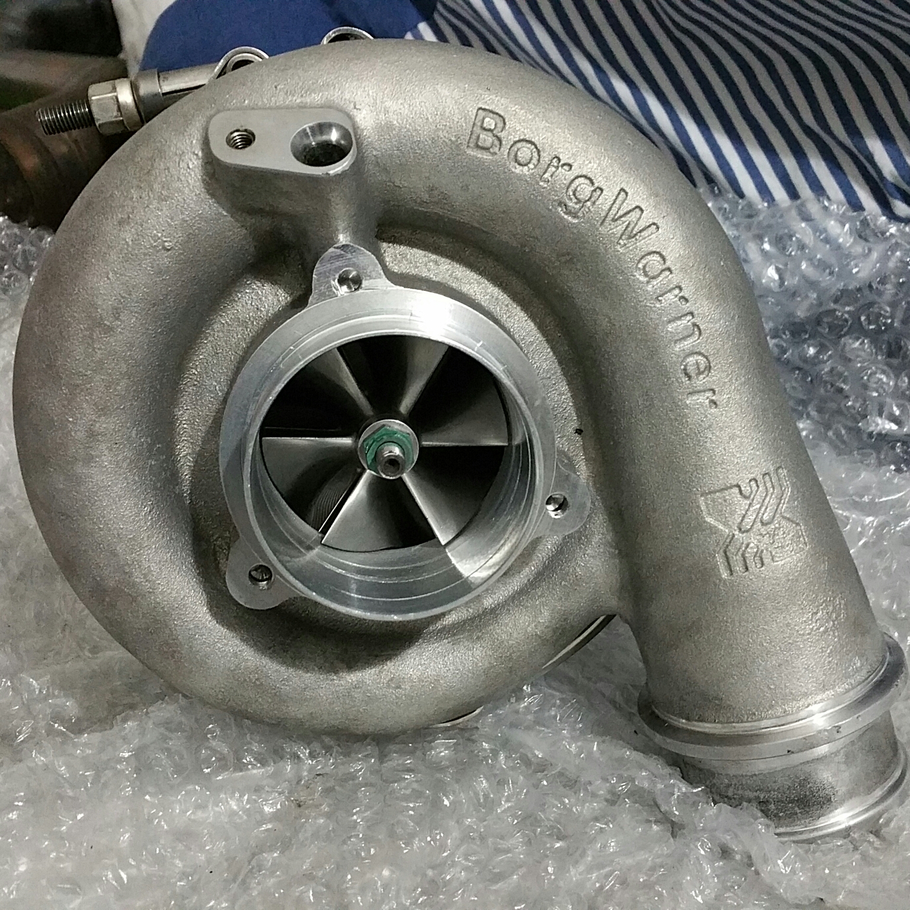

Hi
- 20160716_223130.jpg (2.2 MiB) Viewed 34941 times

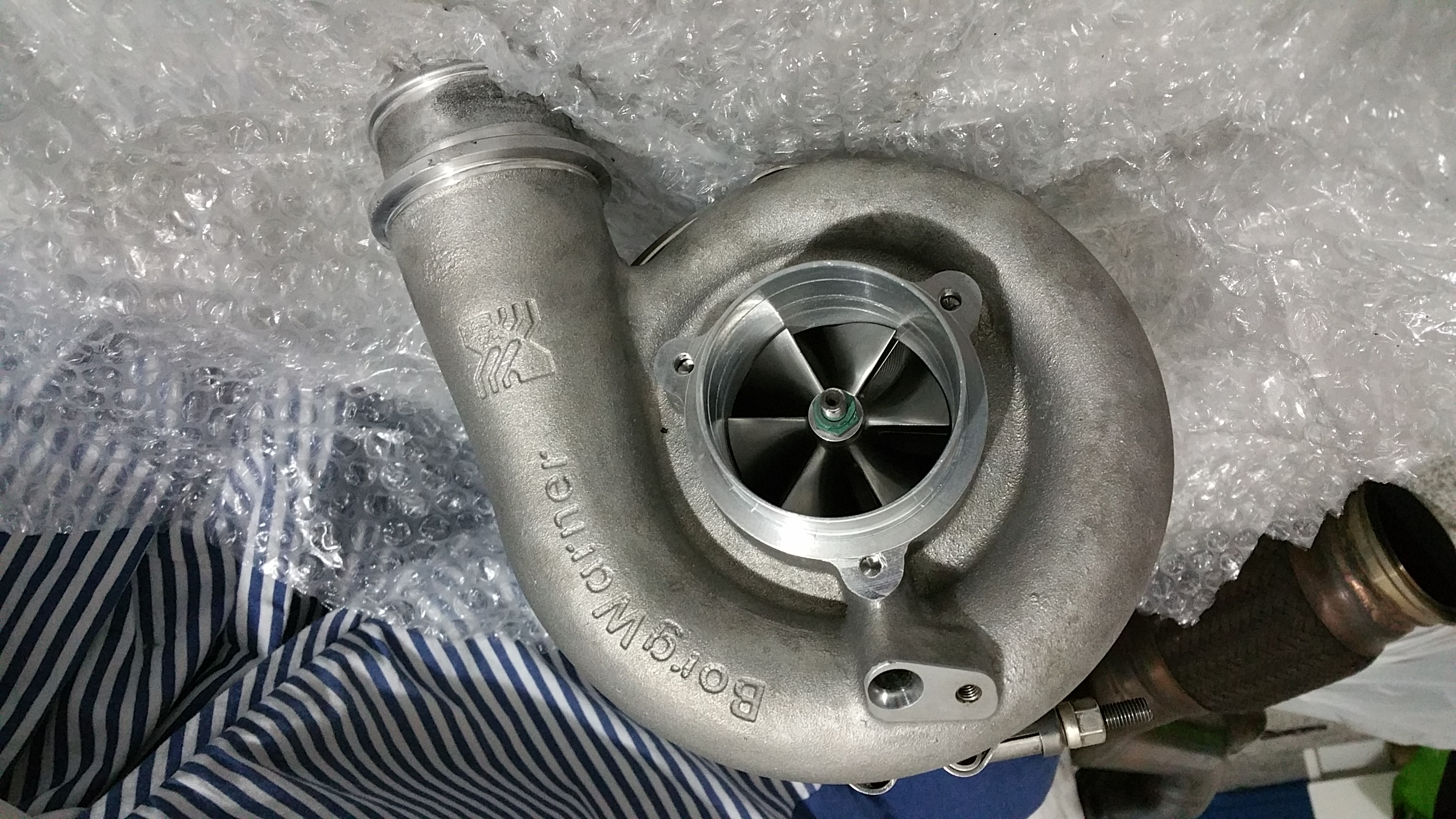

Hmm
- 20160716_223130-1.jpg (2.34 MiB) Viewed 34932 times
Someone had a good waterfest
Did you choose an EFR?
Is that a 9180?
Is that a 9180?
Haha no, just a little 6758.
According to Marc, spools like stock but then HOLY S****!
Can confirmloxxrider wrote:Haha no, just a little 6758.
they're a damn hoot and a half.

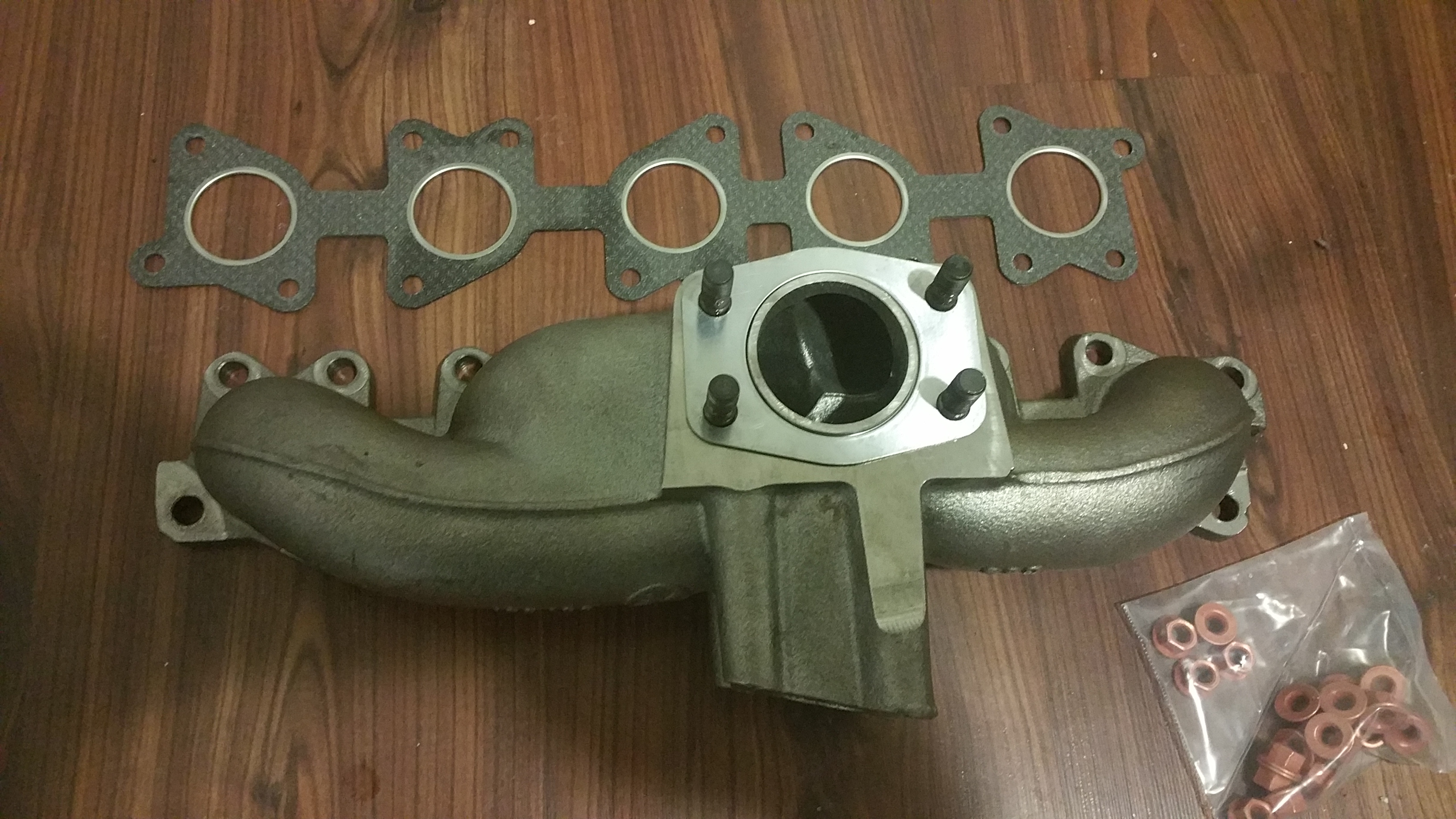

Manifold is on (only snapped one stud :/) all lines are run except I'm still trying to modify the oil return (it got too late to be making Dremel noises outside), and I still need a few wastegate studs. The ones I got were too short.
I do have at least a picture of the manifold and one of the car to hold you over.
