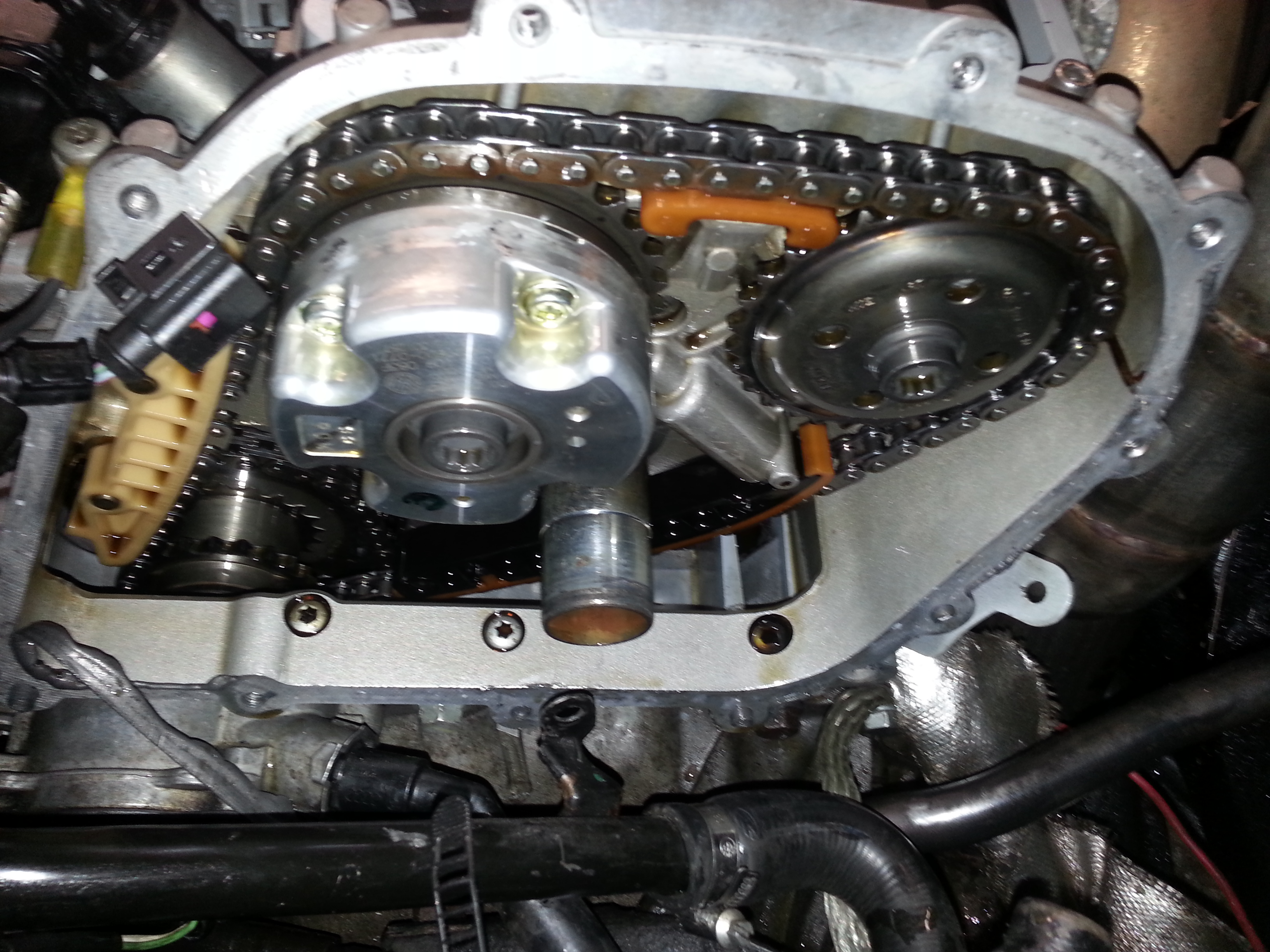

glibobbo21
- Posts: 659
Re: Jims 07K 84 Super HX40 4kq "breakin'"?
Upper chains look ok. Now to check timing...
- 20140630_122107.jpg (2.01 MiB) Viewed 28052 times
