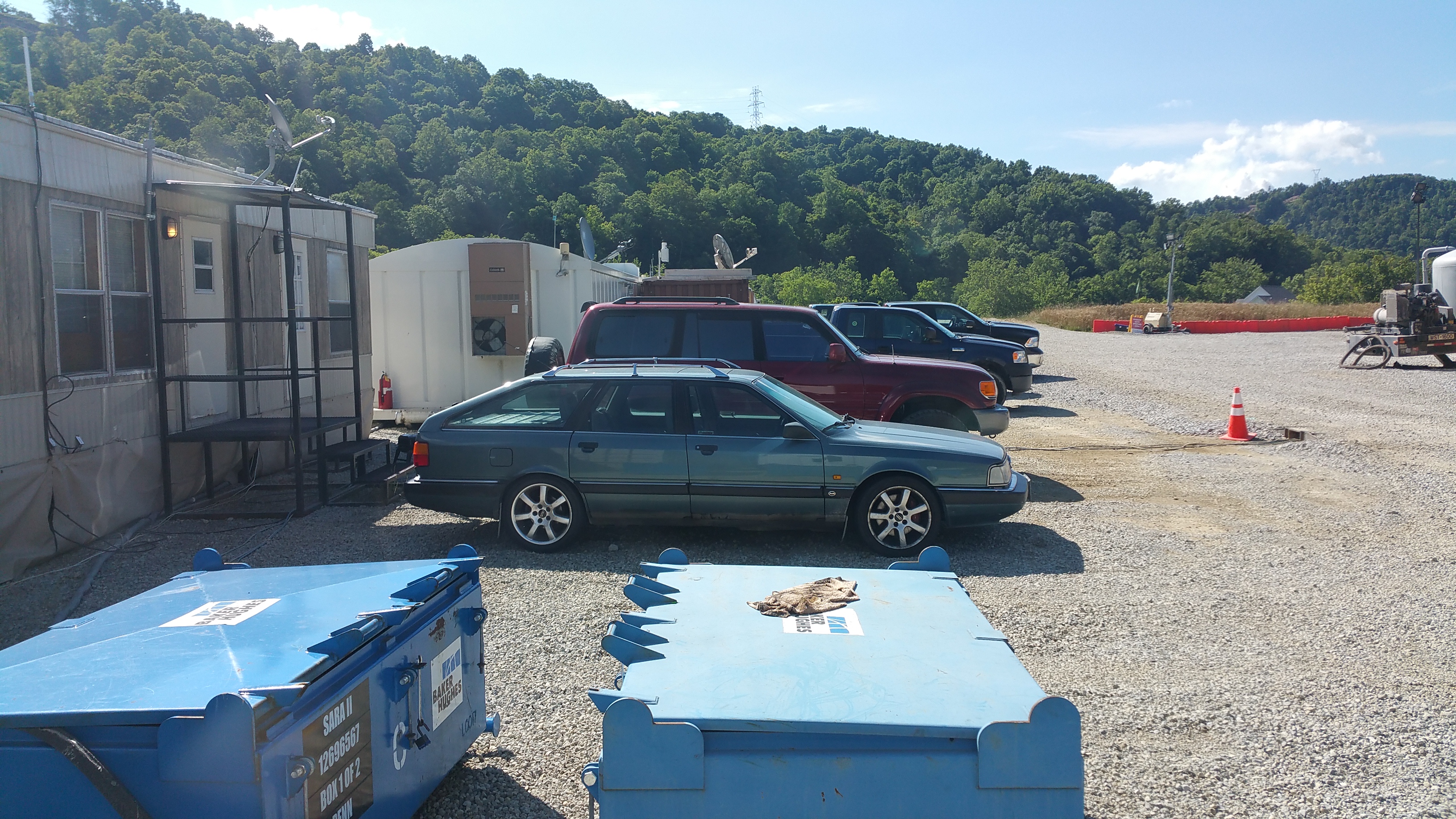

In the meantime, here's a picture of the ole wagon in its broken yet still gettin-it-done state.

Even broken, it still looks badass!

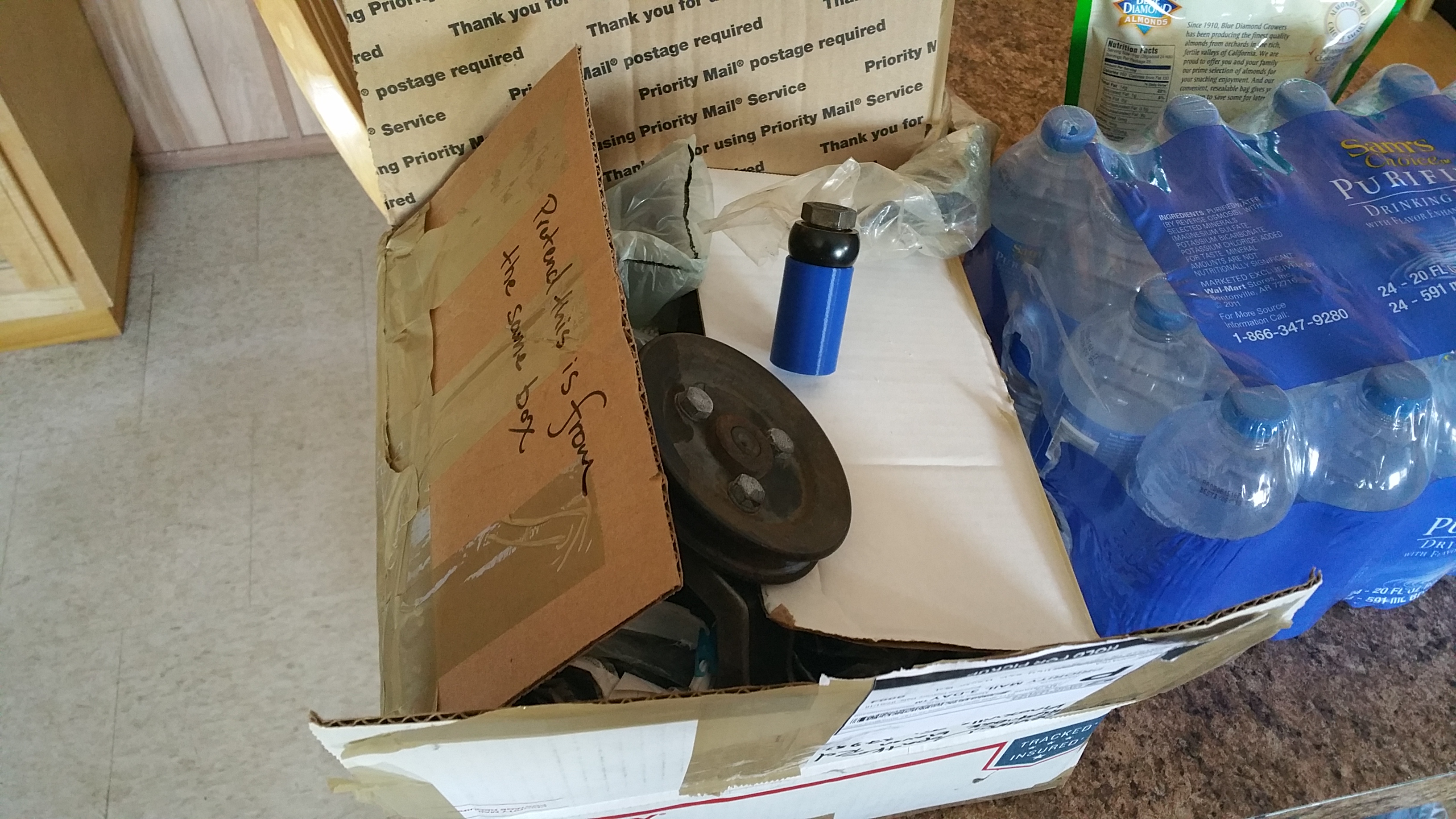

Just got the pumps today along with some of the other parts. I can't thank you enough Kevin!
Love the box lol
You can also see one of the temporary banjo plugs (blue) I made on the 3d printer so I could plug the lines in between getting the pumps swapped out. I love that printer!

Good as new. It seems like there might be a little air in the system because the steering is a little bit... What's the word... discrete? It has a notchiness to it, but I think it's going away. I think it is quieter than the other pump too. Thanks Kevin, you're a lifesaver!
Good thing I got a few options for backup too becuase only 3 out of 6 packages I had sent to that post office for general delivery actually got there and stayed there long enough for me to pick up... Don't ask. :bangshead:
It was pretty easy using the 5k pump on the 200. All went smoothly, especially with the steering line caps. If anyone wants some let me know and I'll print some!
