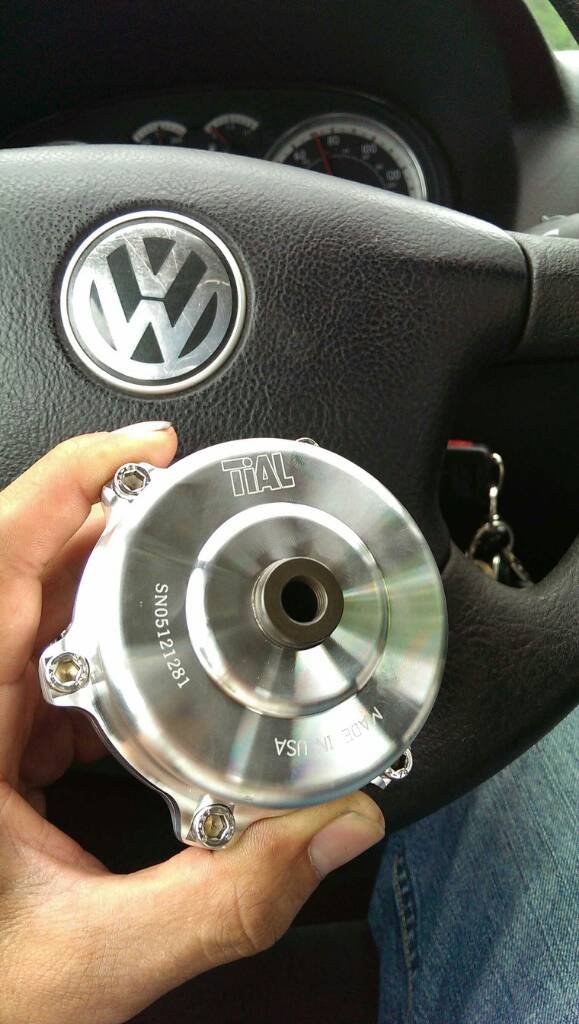

by urs6ville
mushasho wrote:... Funds, time & effort going toward going solid pipe from compressor to FMIC...
And the Tial BPV..... :D
