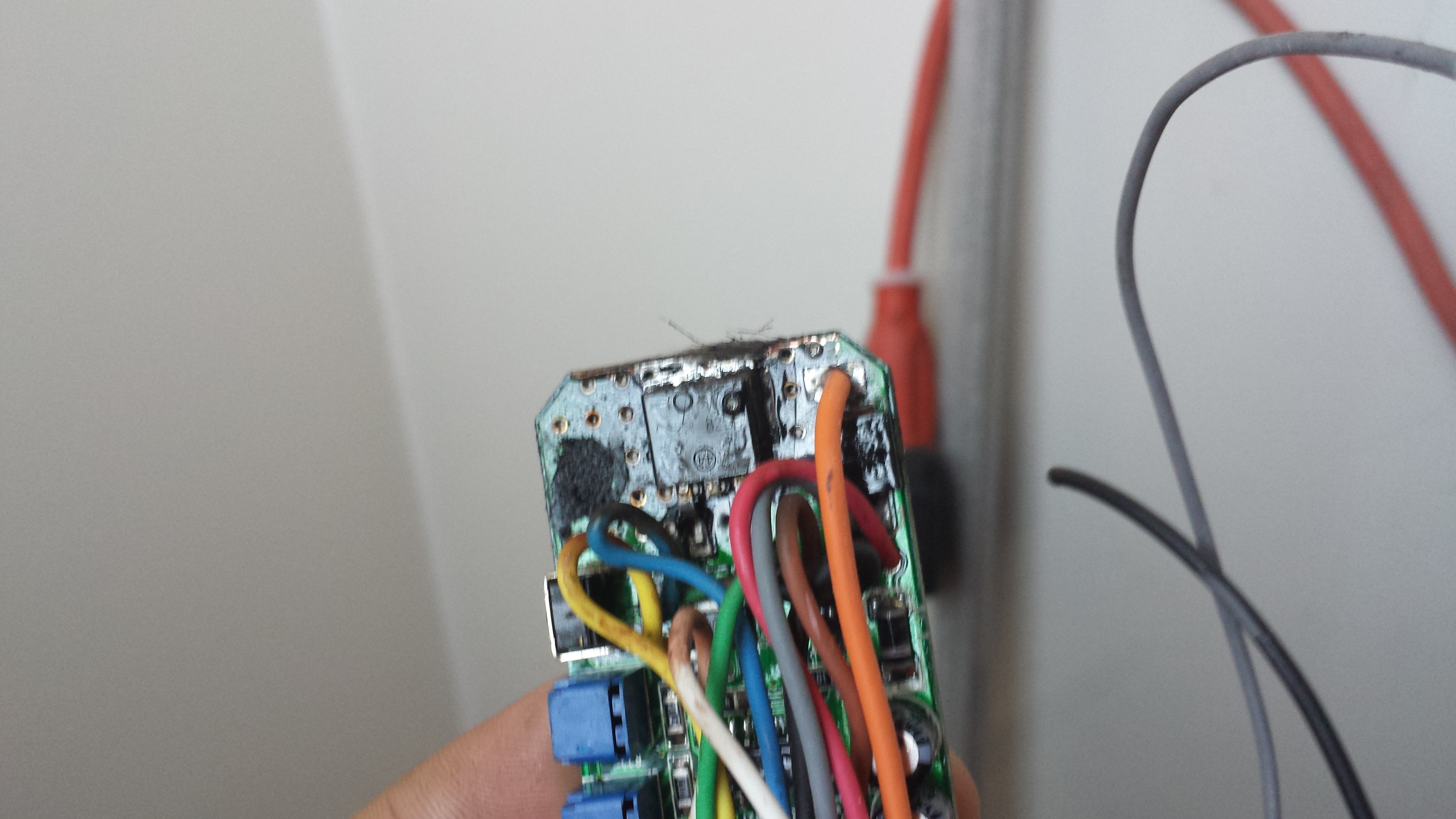

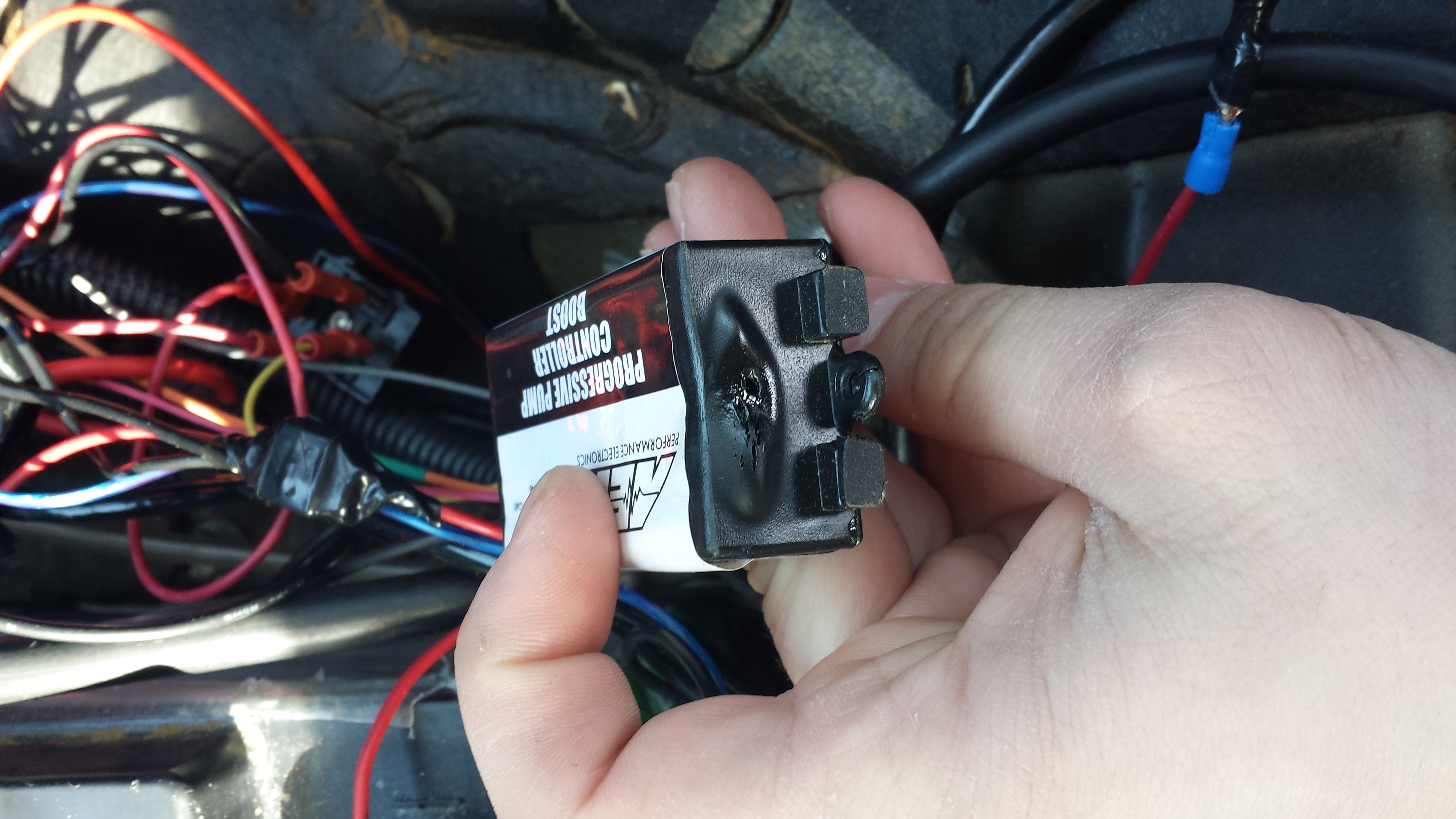

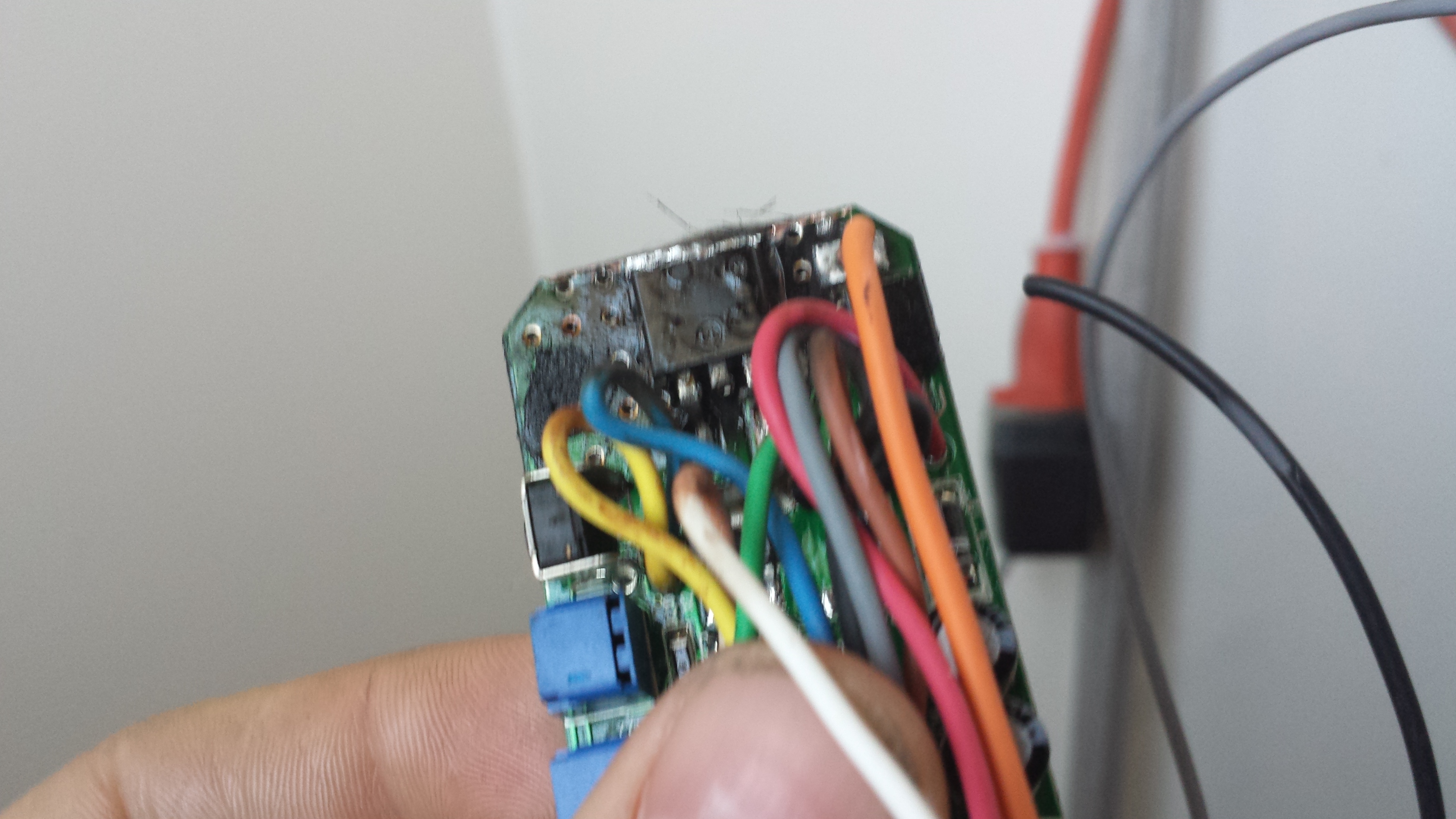

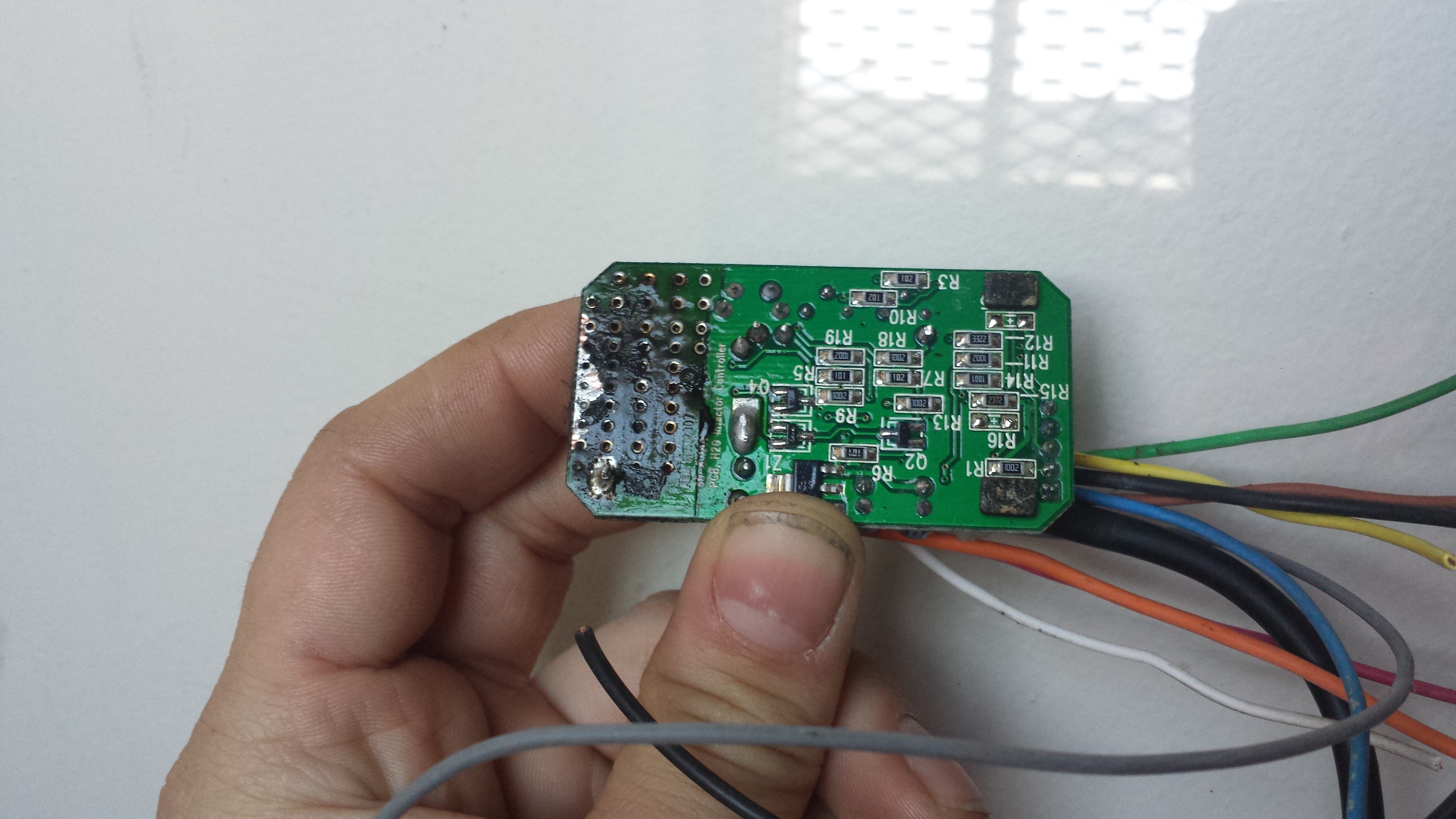

right so today my 5 year old used AEM meth controller went full retard while drifting through a Walmart exit light. It shorted out and was sending full voltage directly through the methanol pump in the trunk where I couldn't hear it. It had an internal electrical fire and baked itself right into a delicious crispy treat. I smelled it first and drove a few blocks when I looked behind me at the area where a back bench seat would normally lay and saw a small plume of smoke coming from next to the battery where the controller sits. Holy F$#@!! Now rewind 24 hours...
Im in the back seat of my car following the wiring instructions of an AEM phone tech support guy from memory and that's why my back bench seat was out/still out 24 hours later. I ended up not liking his idea when the relay that was to run my new coolingmist (could be described as awesome and billet!!) methanol solenoid started clattering and the controller would skip a beat twice at high duty cycle during testing. screw that it sounds ridiculous and looks dangerous! I did it my own way using an adjustable pressure switch I had left over from my archaic "audiworld boxerfan audi 5000 aux cold start fuel injector mod days" and Im sure a very select few actually are aware of what Im talking about lol. I essentially separated the circuit for the solenoid completely from the rest of the methanol system.
I left the seat off today simply because it was about -10 F outside. So the way I wired my solenoid combined with the leaving of the seat bench out of the car, saved my very healthy 3b motor today from an ignorant AEM phone support guy's "guess"
Anyway, to thank AEM, I went ahead and bought the new v2 controller on amazon an hour ago...

Just got off the phone with AEM and they said I am the first EVER to report such a failure. Crazy. They say the ONLY failure mode of these controllers is they just plain stop working lol. There's a first for everything I suppose
Seems like you always find new ways for things to fail
Ouch man haha. Well I also inquired about the v2 controller I ordered and it's external fuse. Turns out it would protect my pump from ever behaving in the same way again. maybe I'll break that one too lol

Don't mind this post. I'm just putting these supplemental pictures up for AEM to examine.
- 20150220_165026.jpg (2.36 MiB) Viewed 37760 times
- 20150220_165007.jpg (2.41 MiB) Viewed 37760 times
- 20150220_164951.jpg (2.61 MiB) Viewed 37760 times

Just a quick update. AEM looks like they are genuinely concerned about why the controller failed the way it did so they emailed me a shipping label. Pretty good guy Stephen (sp?) has been heading up the inquest Over there. I am glad I bought the updated controller so far and their show of concern only instills those feelings more so.
