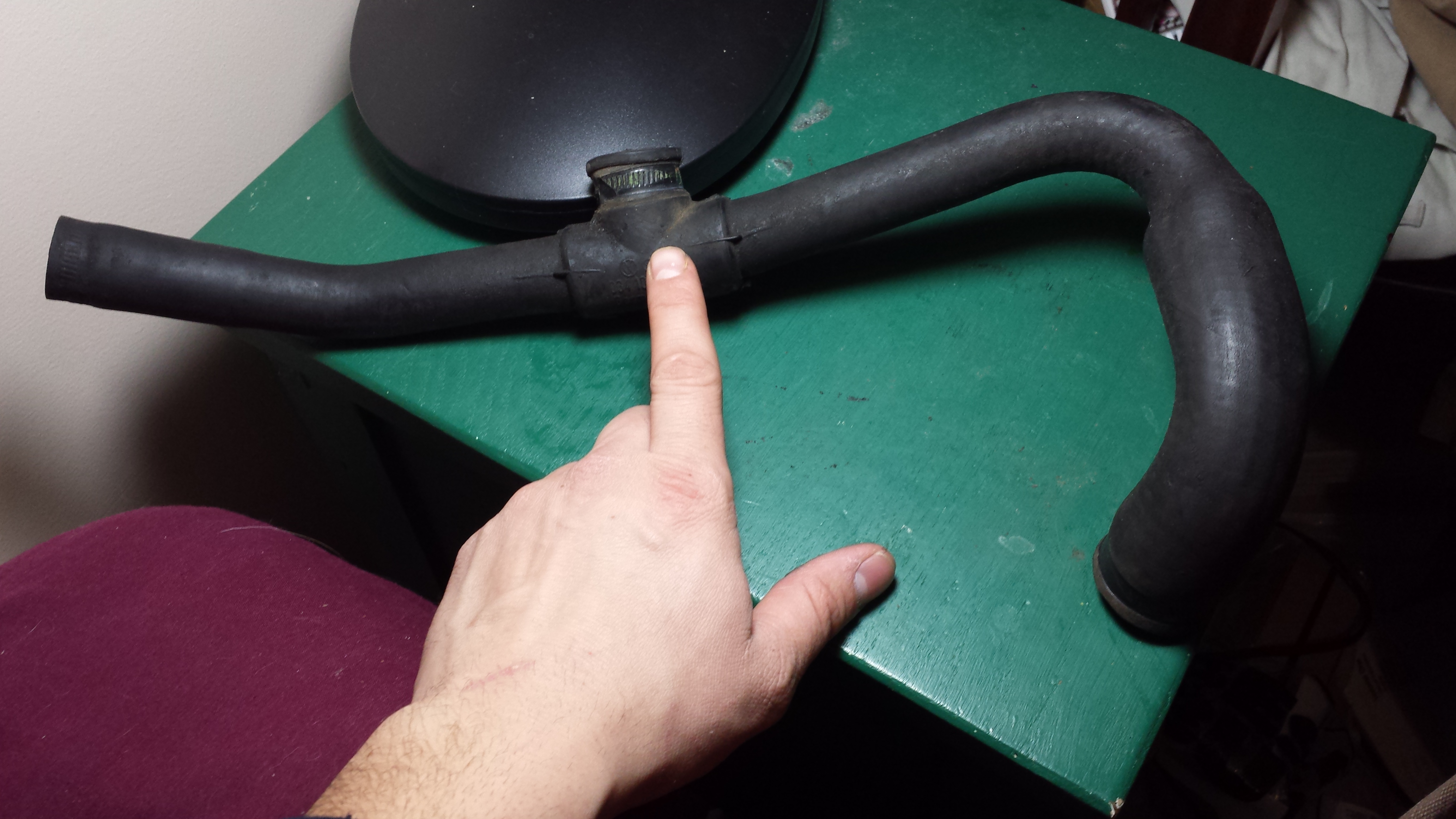

I'm still investigating the CCV system. All of you who are familiar with the hose below, will me blocking off the port leading to the intake manifold (preventing high boost from playing a role) cause the valves to not allow crank vacuum to take place? Is my free flowing k&n filter not allowing as high a vacuum to occur? "Path of least resistance" and all that. The stock airbox surely made higher vacuum possible with its slightly higher air resistance, right? Thanks to anyone who chimes in
